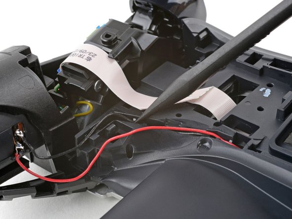

  66. PlayStation Portal Vibration Motor Replacement, Loosen the motor wires: crwdns2935265:066crwdnd2935265:01crwdnd2935265:03crwdne2935265:0 PlayStation Portal Vibration Motor Replacement, Loosen the motor wires: crwdns2935265:066crwdnd2935265:02crwdnd2935265:03crwdne2935265:0 PlayStation Portal Vibration Motor Replacement, Loosen the motor wires: crwdns2935265:066crwdnd2935265:03crwdnd2935265:03crwdne2935265:0
    • Use the point of a spudger to gently lift the two vibration motor wires out of their groove.

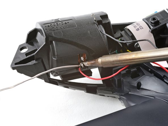

  67. PlayStation Portal Vibration Motor Replacement: crwdns2935265:067crwdnd2935265:01crwdnd2935265:02crwdne2935265:0 PlayStation Portal Vibration Motor Replacement: crwdns2935265:067crwdnd2935265:02crwdnd2935265:02crwdne2935265:0
    • Use a soldering iron to desolder the two wires from their motor contacts.
    • The wire ends are hook shaped. You may need to wiggle the wire slightly as you desolder to unhook it.
  68. PlayStation Portal Vibration Motor Replacement, Reassembly information: crwdns2935265:068crwdnd2935265:01crwdnd2935265:01crwdne2935265:0
    • When you solder the wires during reassembly:
    • Flip the Portal over such that its back side faces you.
    • The black wire should be soldered to the upper contact on the vibration motor.
    • The red wire should be soldered to the lower contact on the vibration motor.
    • This is true for either vibration motor and ensures that they spin in the proper direction.

    • Solder the two wires to the new vibration motor.
    • Use the point of a spudger to carefully tuck the motor wires back into the groove.
