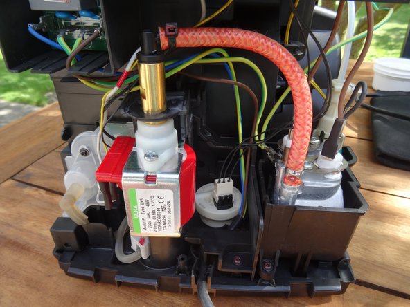

  7. Philips EP models: pump replacement, Pump: crwdns2935265:07crwdnd2935265:01crwdnd2935265:03crwdne2935265:0 Philips EP models: pump replacement, Pump: crwdns2935265:07crwdnd2935265:02crwdnd2935265:03crwdne2935265:0 Philips EP models: pump replacement, Pump: crwdns2935265:07crwdnd2935265:03crwdnd2935265:03crwdne2935265:0
    • The pump is clearly visible in the back. It is installed in a vertical position and held by a rubber bracket.

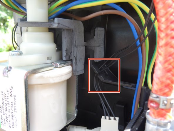

    • To be on the safe side, remove the three black cables of the flowmeter from their holder so that the pump has a free path.

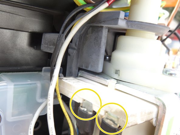

    • Pull the two flat connectors off the pump.

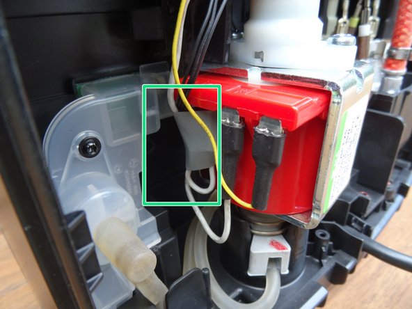

    • The thermal fuse on the cable is glued to the pump at the factory. Carefully scrape off the adhesive and pull the thermal fuse out downwards.
    • When reassembling, attach the thermal fuse to the new pump with a piece of electrical tape.

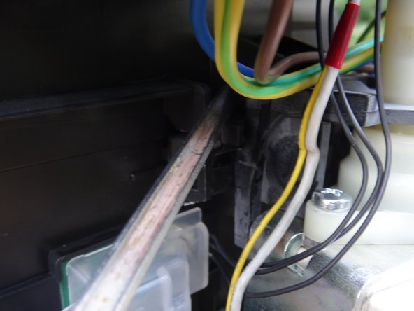

    • The rubber holder for the pump is hooked at the top. Push the rubber hook away from you with a metal spatula and leave the metal spatula in place.

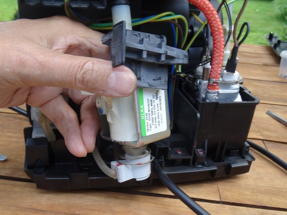

    • Take a strong screwdriver and now push the bracket with a lot of force towards the water tank side until it gradually comes out together with the pump.
    • Lift out the pump. It is still connected with two hoses.

    • The factory-installed pump was an Ulka EP5FMGW. Replace it with an Ulka EX5, which has a metal fitting.
    • Ulka pumps can be opened and possibly repaired, but replacement is usually better.
    • Secure the thermal fuse to the pump with electrical tape.
