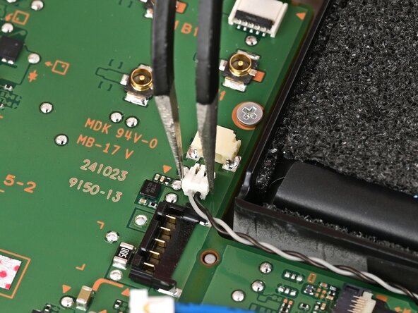

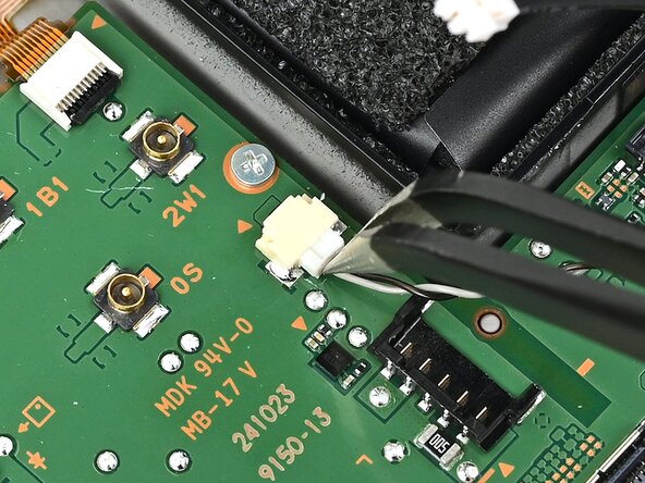

  23. Nintendo Switch 2 Left Joy-Con 2 Connector Replacement, Disconnect the lower antenna cable: crwdns2935265:023crwdnd2935265:01crwdnd2935265:03crwdne2935265:0 Nintendo Switch 2 Left Joy-Con 2 Connector Replacement, Disconnect the lower antenna cable: crwdns2935265:023crwdnd2935265:02crwdnd2935265:03crwdne2935265:0 Nintendo Switch 2 Left Joy-Con 2 Connector Replacement, Disconnect the lower antenna cable: crwdns2935265:023crwdnd2935265:03crwdnd2935265:03crwdne2935265:0
    • Insert an arm of angled tweezers under the metal neck of the white interconnect cable coaxial connector (located beneath the lower antenna) and lift straight up to disconnect it.
  24. Nintendo Switch 2 Left Joy-Con 2 Connector Replacement, Disconnect the remaining antenna cables: crwdns2935265:024crwdnd2935265:01crwdnd2935265:03crwdne2935265:0 Nintendo Switch 2 Left Joy-Con 2 Connector Replacement, Disconnect the remaining antenna cables: crwdns2935265:024crwdnd2935265:02crwdnd2935265:03crwdne2935265:0 Nintendo Switch 2 Left Joy-Con 2 Connector Replacement, Disconnect the remaining antenna cables: crwdns2935265:024crwdnd2935265:03crwdnd2935265:03crwdne2935265:0
    • Repeat this procedure to disconnect the three central coaxial connectors from the board.

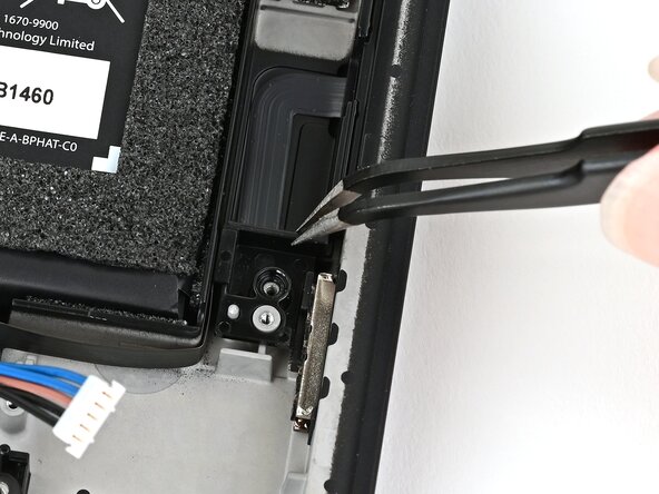

  29. Nintendo Switch 2 Left Joy-Con 2 Connector Replacement, Unroute the gray antenna cable: crwdns2935265:029crwdnd2935265:01crwdnd2935265:03crwdne2935265:0 Nintendo Switch 2 Left Joy-Con 2 Connector Replacement, Unroute the gray antenna cable: crwdns2935265:029crwdnd2935265:02crwdnd2935265:03crwdne2935265:0 Nintendo Switch 2 Left Joy-Con 2 Connector Replacement, Unroute the gray antenna cable: crwdns2935265:029crwdnd2935265:03crwdnd2935265:03crwdne2935265:0
    • Insert one arm of angled tweezers underneath the gray antenna cable at the bottom-right corner of the console.
    • Lift the cable out of the black clip securing it to the frame.

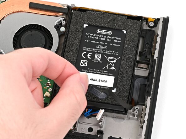

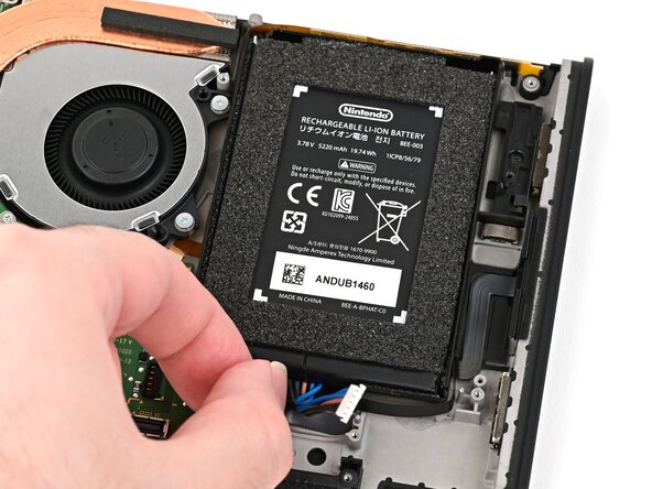

  33. Nintendo Switch 2 Left Joy-Con 2 Connector Replacement, Disconnect the battery: crwdns2935265:033crwdnd2935265:01crwdnd2935265:02crwdne2935265:0 Nintendo Switch 2 Left Joy-Con 2 Connector Replacement, Disconnect the battery: crwdns2935265:033crwdnd2935265:02crwdnd2935265:02crwdne2935265:0
    • Insert the flat end of a spudger underneath the flat-topped battery connector, located next to the battery, and pry up to disconnect it.

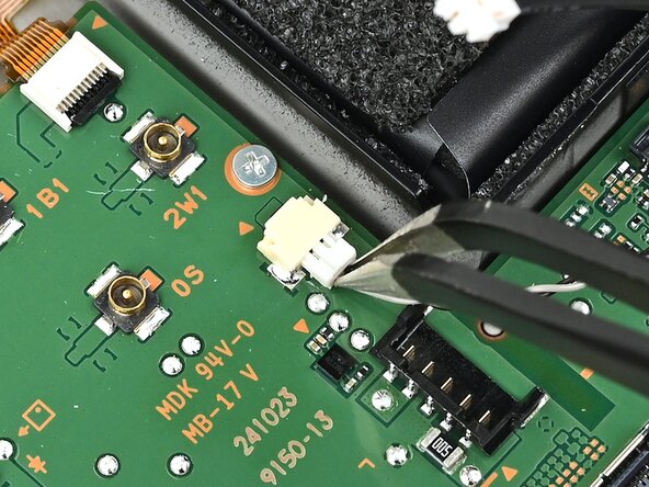

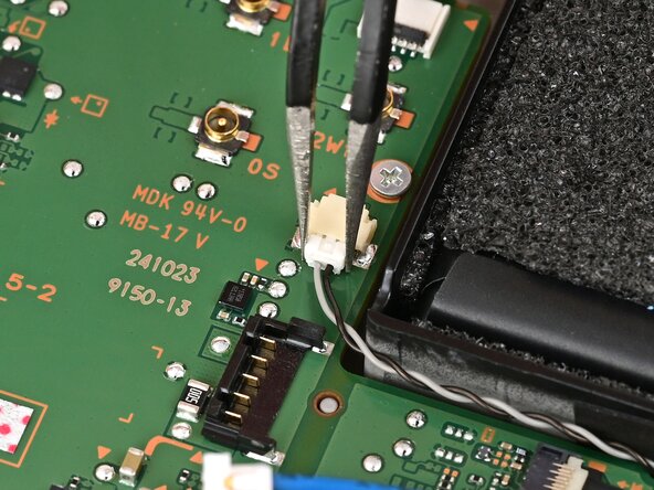

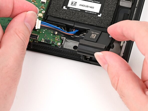

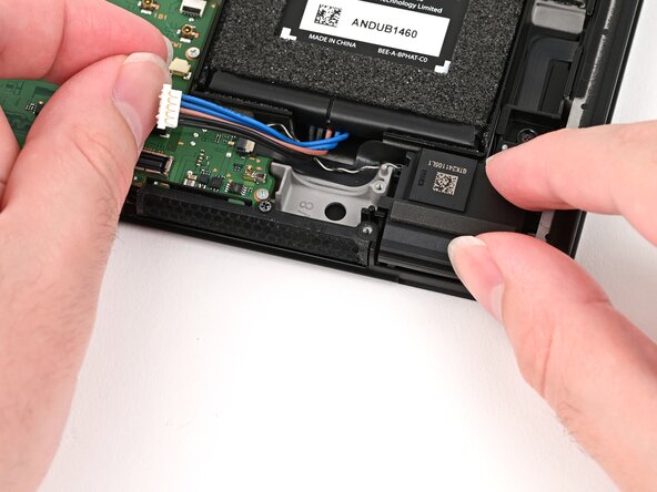

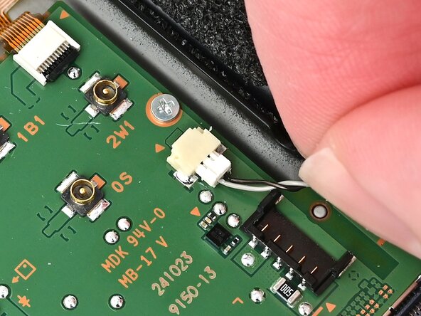

  35. Nintendo Switch 2 Left Joy-Con 2 Connector Replacement, Disconnect the left speaker: crwdns2935265:035crwdnd2935265:01crwdnd2935265:02crwdne2935265:0 Nintendo Switch 2 Left Joy-Con 2 Connector Replacement, Disconnect the left speaker: crwdns2935265:035crwdnd2935265:02crwdnd2935265:02crwdne2935265:0
    • Use tweezers or your fingers to firmly grip the left speaker cable's white JST connector and pull straight away from its socket to disconnect it.

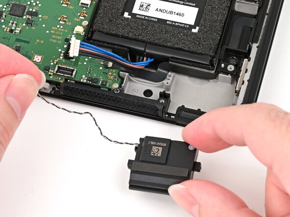

  36. Nintendo Switch 2 Left Joy-Con 2 Connector Replacement, Remove the left speaker: crwdns2935265:036crwdnd2935265:01crwdnd2935265:03crwdne2935265:0 Nintendo Switch 2 Left Joy-Con 2 Connector Replacement, Remove the left speaker: crwdns2935265:036crwdnd2935265:02crwdnd2935265:03crwdne2935265:0 Nintendo Switch 2 Left Joy-Con 2 Connector Replacement, Remove the left speaker: crwdns2935265:036crwdnd2935265:03crwdnd2935265:03crwdne2935265:0
    • Lift the speaker out of its recess and route its cable out from beneath the battery cable.
    • Remove the left speaker.

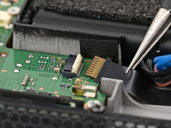

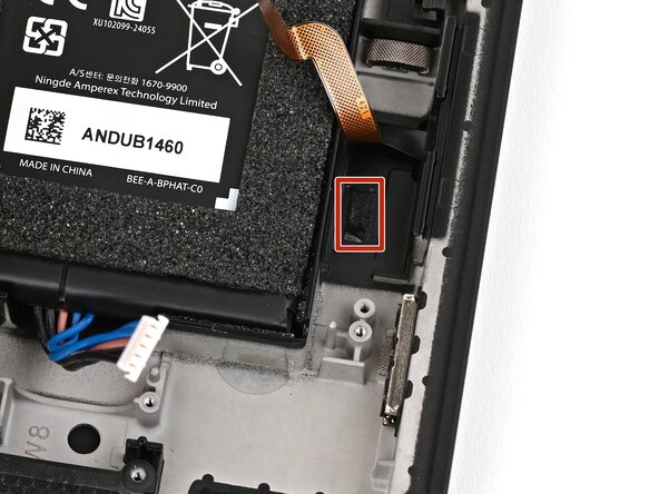

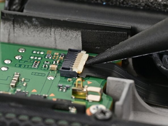

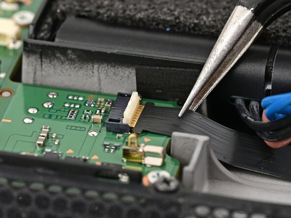

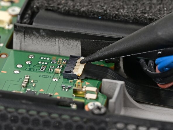

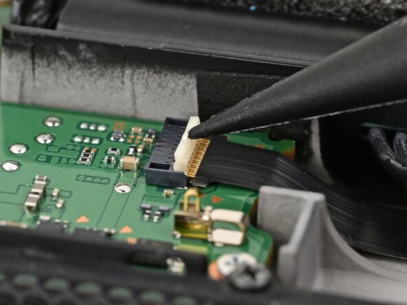

  37. Nintendo Switch 2 Left Joy-Con 2 Connector Replacement, Disconnect the left Joy-Con 2 connector: crwdns2935265:037crwdnd2935265:01crwdnd2935265:02crwdne2935265:0 Nintendo Switch 2 Left Joy-Con 2 Connector Replacement, Disconnect the left Joy-Con 2 connector: crwdns2935265:037crwdnd2935265:02crwdnd2935265:02crwdne2935265:0
    • Use the point of a spudger to flip up the locking flap on the left Joy-Con 2 connector cable ZIF connector, located beneath the battery on the console's board.
  38. Nintendo Switch 2 Left Joy-Con 2 Connector Replacement: crwdns2935265:038crwdnd2935265:01crwdnd2935265:02crwdne2935265:0 Nintendo Switch 2 Left Joy-Con 2 Connector Replacement: crwdns2935265:038crwdnd2935265:02crwdnd2935265:02crwdne2935265:0
    • Use tweezers or your fingers to gently pull the cable out of its connector.

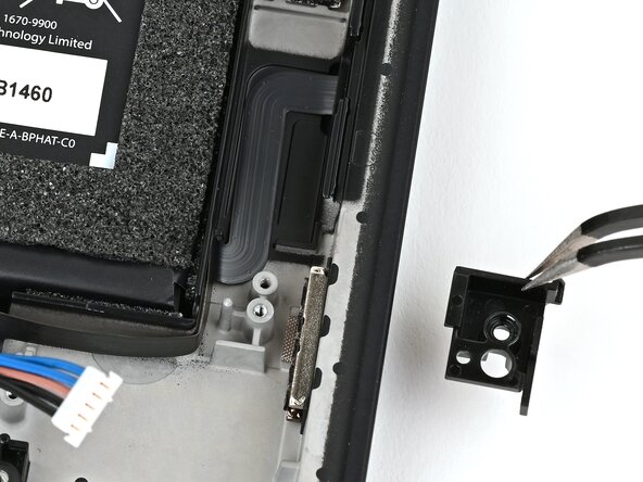

  39. Nintendo Switch 2 Left Joy-Con 2 Connector Replacement: crwdns2935265:039crwdnd2935265:01crwdnd2935265:03crwdne2935265:0 Nintendo Switch 2 Left Joy-Con 2 Connector Replacement: crwdns2935265:039crwdnd2935265:02crwdnd2935265:03crwdne2935265:0 Nintendo Switch 2 Left Joy-Con 2 Connector Replacement: crwdns2935265:039crwdnd2935265:03crwdnd2935265:03crwdne2935265:0

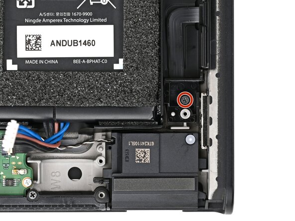

    • Use a JIS 00 driver to remove the 2.3 mm‑long black screw securing the left Joy-Con 2 connector cable's bracket.
    • Remove the bracket.

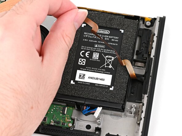

  40. Nintendo Switch 2 Left Joy-Con 2 Connector Replacement, Unroute the left Joy-Con 2 cable: crwdns2935265:040crwdnd2935265:01crwdnd2935265:03crwdne2935265:0 Nintendo Switch 2 Left Joy-Con 2 Connector Replacement, Unroute the left Joy-Con 2 cable: crwdns2935265:040crwdnd2935265:02crwdnd2935265:03crwdne2935265:0 Nintendo Switch 2 Left Joy-Con 2 Connector Replacement, Unroute the left Joy-Con 2 cable: crwdns2935265:040crwdnd2935265:03crwdnd2935265:03crwdne2935265:0
    • Unroute the left Joy-Con 2 cable from around the battery well.
    • The cable is secured to the frame with a small piece of adhesive.

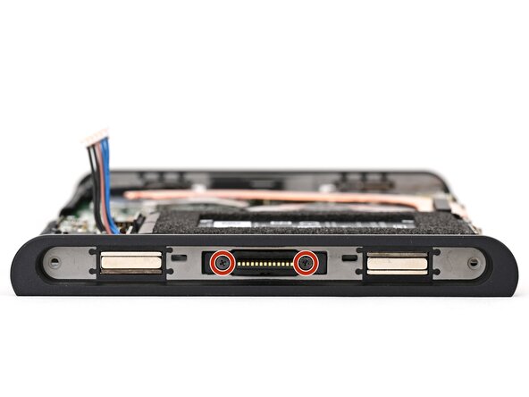

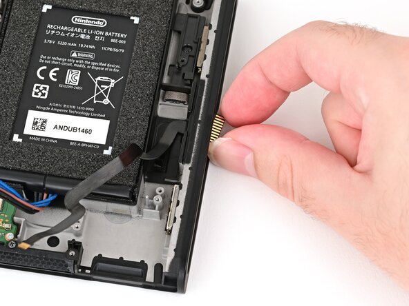

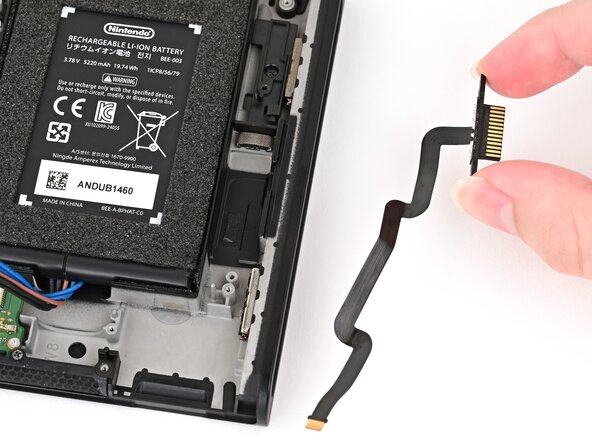

  41. Nintendo Switch 2 Left Joy-Con 2 Connector Replacement, Remove the left Joy-Con 2 connector screws: crwdns2935265:041crwdnd2935265:01crwdnd2935265:02crwdne2935265:0 Nintendo Switch 2 Left Joy-Con 2 Connector Replacement, Remove the left Joy-Con 2 connector screws: crwdns2935265:041crwdnd2935265:02crwdnd2935265:02crwdne2935265:0
    • Remove the two 3.2 mm‑long black screws securing the left Joy-Con 2 connector.

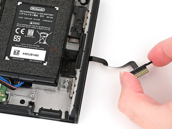

  42. Nintendo Switch 2 Left Joy-Con 2 Connector Replacement, Remove the left Joy-Con 2 connector: crwdns2935265:042crwdnd2935265:01crwdnd2935265:03crwdne2935265:0 Nintendo Switch 2 Left Joy-Con 2 Connector Replacement, Remove the left Joy-Con 2 connector: crwdns2935265:042crwdnd2935265:02crwdnd2935265:03crwdne2935265:0 Nintendo Switch 2 Left Joy-Con 2 Connector Replacement, Remove the left Joy-Con 2 connector: crwdns2935265:042crwdnd2935265:03crwdnd2935265:03crwdne2935265:0
    • Grab the left Joy-Con 2 connector and carefully pull its cable out of the frame.
    • Remove the left Joy-Con 2 connector.

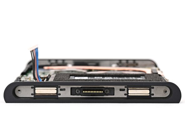

  43. Nintendo Switch 2 Left Joy-Con 2 Connector Replacement, Disassembly complete: crwdns2935265:043crwdnd2935265:01crwdnd2935265:01crwdne2935265:0
    • Congratulations on completing disassembly! The remaining steps will show how to reassemble your console.

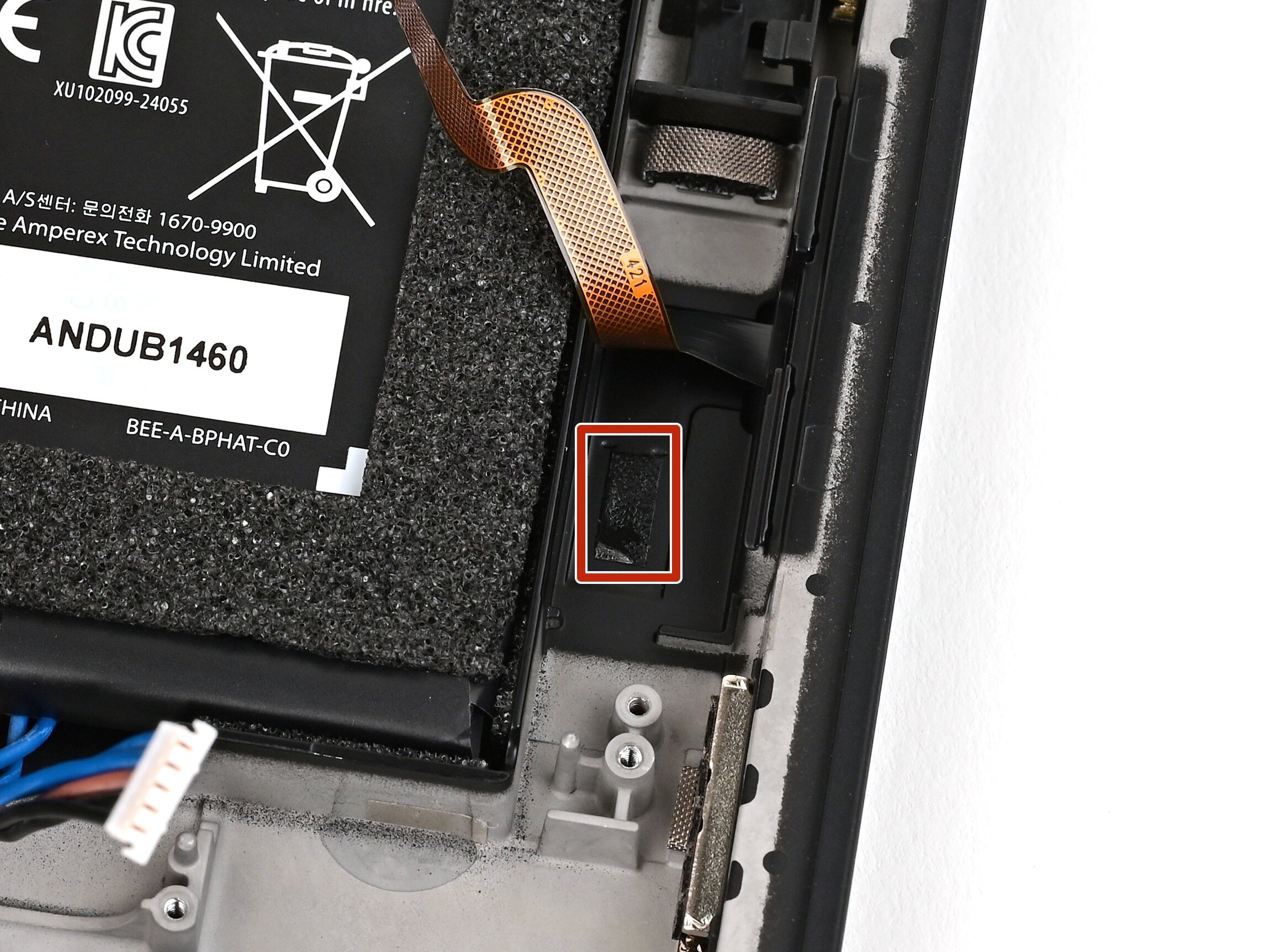

  46. Nintendo Switch 2 Left Joy-Con 2 Connector Replacement, Route the left Joy‑Con 2 cable: crwdns2935265:046crwdnd2935265:01crwdnd2935265:03crwdne2935265:0 Nintendo Switch 2 Left Joy-Con 2 Connector Replacement, Route the left Joy‑Con 2 cable: crwdns2935265:046crwdnd2935265:02crwdnd2935265:03crwdne2935265:0 Nintendo Switch 2 Left Joy-Con 2 Connector Replacement, Route the left Joy‑Con 2 cable: crwdns2935265:046crwdnd2935265:03crwdnd2935265:03crwdne2935265:0
    Tesa 61395 Tape
    $2.99
    • Stick the cable onto its adhesive securing it to the frame.
    • If the adhesive got lost or damaged, replace it with a piece of thin, double-sided tape.
    • Route the connector's cable beneath the battery cable.

    • Use tweezers to insert the left Joy‑Con 2 connector cable into its ZIF connector on the board until it's fully seated.
    • Flip the hinged locking flap down to secure the cable.
  49. Nintendo Switch 2 Left Joy-Con 2 Connector Replacement, Install the left speaker: crwdns2935265:049crwdnd2935265:01crwdnd2935265:03crwdne2935265:0 Nintendo Switch 2 Left Joy-Con 2 Connector Replacement, Install the left speaker: crwdns2935265:049crwdnd2935265:02crwdnd2935265:03crwdne2935265:0 Nintendo Switch 2 Left Joy-Con 2 Connector Replacement, Install the left speaker: crwdns2935265:049crwdnd2935265:03crwdnd2935265:03crwdne2935265:0
    • Set the left speaker in its recess and route its cable beneath the battery cable.
  50. Nintendo Switch 2 Left Joy-Con 2 Connector Replacement, Connect the left speaker: crwdns2935265:050crwdnd2935265:01crwdnd2935265:03crwdne2935265:0 Nintendo Switch 2 Left Joy-Con 2 Connector Replacement, Connect the left speaker: crwdns2935265:050crwdnd2935265:02crwdnd2935265:03crwdne2935265:0 Nintendo Switch 2 Left Joy-Con 2 Connector Replacement, Connect the left speaker: crwdns2935265:050crwdnd2935265:03crwdnd2935265:03crwdne2935265:0
    • Align the left speaker cable's white JST connector with its socket on the board.
    • Use tweezers or your fingers to fully seat the connector into its socket.
  51. Nintendo Switch 2 Left Joy-Con 2 Connector Replacement, Connect the battery: crwdns2935265:051crwdnd2935265:01crwdnd2935265:02crwdne2935265:0 Nintendo Switch 2 Left Joy-Con 2 Connector Replacement, Connect the battery: crwdns2935265:051crwdnd2935265:02crwdnd2935265:02crwdne2935265:0
    • Align the battery connector over its socket on the board.
    • Use your finger or the flat end of a spudger to press the battery connector onto its socket until it's fully seated.
