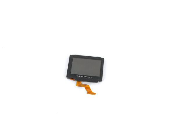

  26. Nintendo Game Boy Advance SP Screen Lens Replacement, Remove the screen: crwdns2935265:026crwdnd2935265:01crwdnd2935265:03crwdne2935265:0 Nintendo Game Boy Advance SP Screen Lens Replacement, Remove the screen: crwdns2935265:026crwdnd2935265:02crwdnd2935265:03crwdne2935265:0 Nintendo Game Boy Advance SP Screen Lens Replacement, Remove the screen: crwdns2935265:026crwdnd2935265:03crwdnd2935265:03crwdne2935265:0
    • Use your fingers to lift and remove the screen, threading the cable through its cutout.
    • If your screen stayed attached to the shell, you may need to gently pry it up with a spudger before removing it.

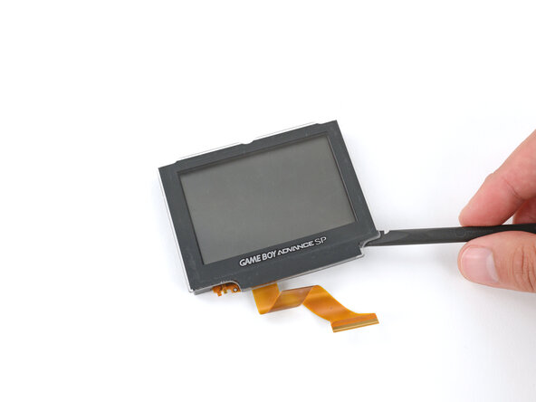

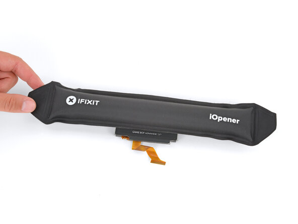

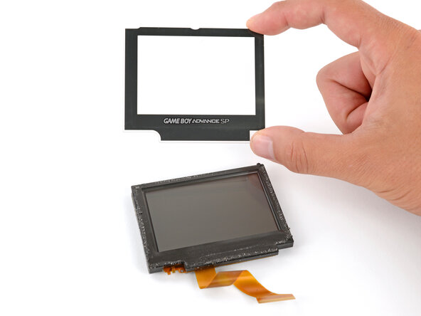

  27. Nintendo Game Boy Advance SP Screen Lens Replacement, Heat the screen lens: crwdns2935265:027crwdnd2935265:01crwdnd2935265:02crwdne2935265:0 Nintendo Game Boy Advance SP Screen Lens Replacement, Heat the screen lens: crwdns2935265:027crwdnd2935265:02crwdnd2935265:02crwdne2935265:0
    • Mild adhesive secures the screen lens to the screen. Heating the lens will soften the adhesive, making it easier to separate.
    • Heat an iOpener and lay it on the screen lens for two minutes.
    • Alternatively, you can use a hair dryer on the Low heat setting—be careful not to apply too much heat, or you may damage the screen.

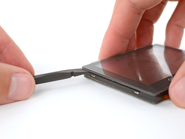

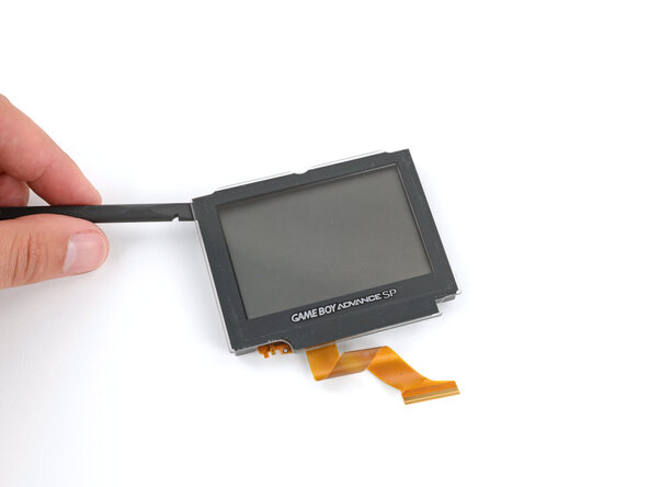

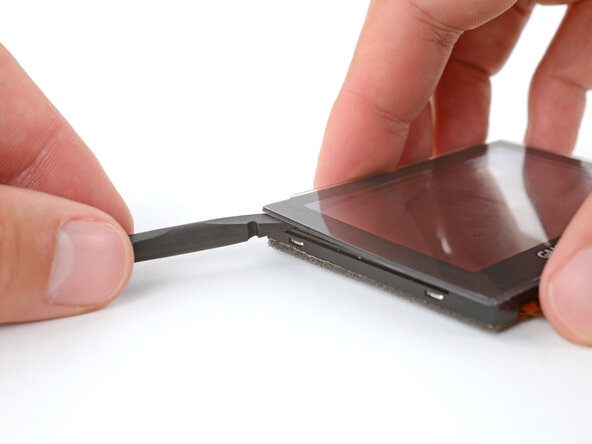

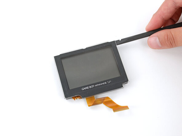

  28. Nintendo Game Boy Advance SP Screen Lens Replacement, Separate the adhesive: crwdns2935265:028crwdnd2935265:01crwdnd2935265:02crwdne2935265:0 Nintendo Game Boy Advance SP Screen Lens Replacement, Separate the adhesive: crwdns2935265:028crwdnd2935265:02crwdnd2935265:02crwdne2935265:0
    • Slide the flat end of a spudger under the screen lens.
  29. Nintendo Game Boy Advance SP Screen Lens Replacement: crwdns2935265:029crwdnd2935265:01crwdnd2935265:03crwdne2935265:0 Nintendo Game Boy Advance SP Screen Lens Replacement: crwdns2935265:029crwdnd2935265:02crwdnd2935265:03crwdne2935265:0 Nintendo Game Boy Advance SP Screen Lens Replacement: crwdns2935265:029crwdnd2935265:03crwdnd2935265:03crwdne2935265:0
    • Slide the spudger under the perimeter of the lens to separate all its adhesive.
    • If you're having trouble with a section, apply more heat and try again.

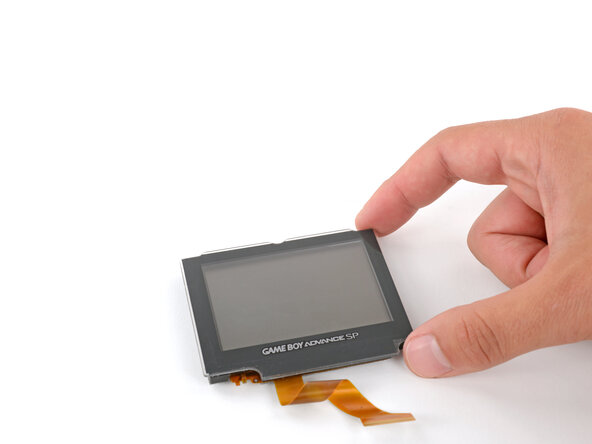

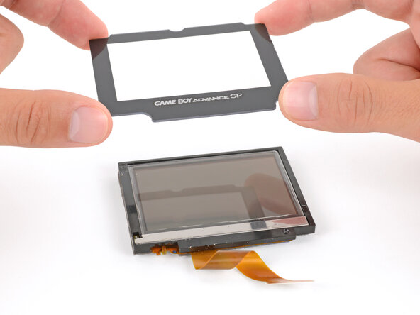

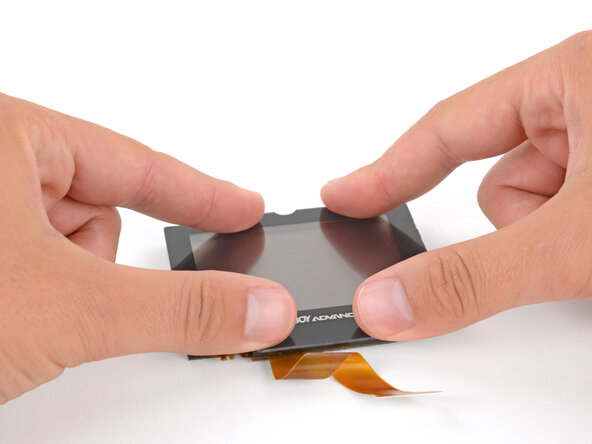

  30. Nintendo Game Boy Advance SP Screen Lens Replacement, Remove the screen lens: crwdns2935265:030crwdnd2935265:01crwdnd2935265:03crwdne2935265:0 Nintendo Game Boy Advance SP Screen Lens Replacement, Remove the screen lens: crwdns2935265:030crwdnd2935265:02crwdnd2935265:03crwdne2935265:0 Nintendo Game Boy Advance SP Screen Lens Replacement, Remove the screen lens: crwdns2935265:030crwdnd2935265:03crwdnd2935265:03crwdne2935265:0
    • Use your fingers to peel up and remove the screen lens.

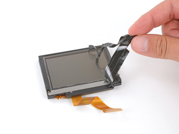

  31. Nintendo Game Boy Advance SP Screen Lens Replacement, Remove the old adhesive: crwdns2935265:031crwdnd2935265:01crwdnd2935265:02crwdne2935265:0 Nintendo Game Boy Advance SP Screen Lens Replacement, Remove the old adhesive: crwdns2935265:031crwdnd2935265:02crwdnd2935265:02crwdne2935265:0
    • Use a spudger and your fingers to peel up and remove all the old lens adhesive.

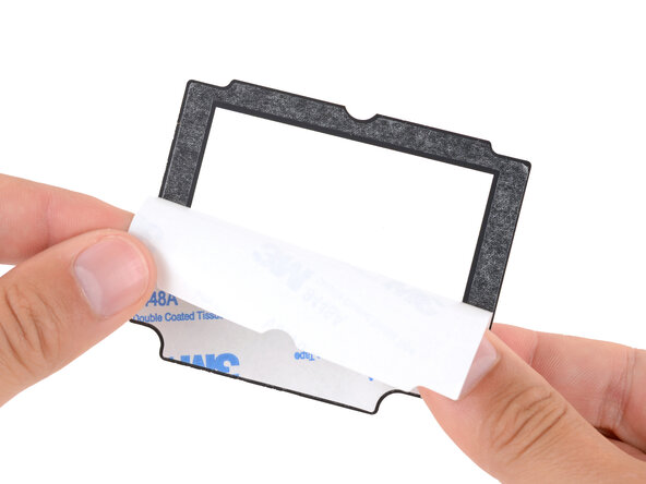

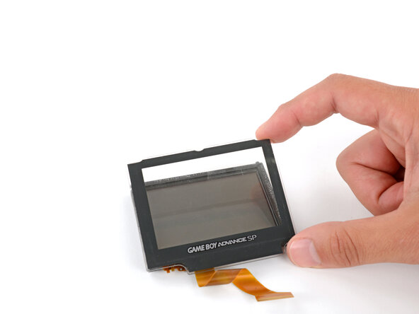

  32. Nintendo Game Boy Advance SP Screen Lens Replacement, Install the new lens: crwdns2935265:032crwdnd2935265:01crwdnd2935265:03crwdne2935265:0 Nintendo Game Boy Advance SP Screen Lens Replacement, Install the new lens: crwdns2935265:032crwdnd2935265:02crwdnd2935265:03crwdne2935265:0 Nintendo Game Boy Advance SP Screen Lens Replacement, Install the new lens: crwdns2935265:032crwdnd2935265:03crwdnd2935265:03crwdne2935265:0
    • Remove the liner from the back of the screen lens to expose its adhesive.
    • Align the lens over the screen and lay it in place.
    • Aligning the lens is tricky! Take your time—once the lens sticks to the screen, you won't be able to reposition it. Align the inner edge of the bezel with the outer edge of the screen panel.
    • Use your fingers to press firmly around the perimeter to secure it.
