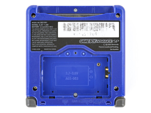

    • Slide the power switch to the OFF position and unplug any cables.
    • If you have a game cartridge in, remove it.
  2. Nintendo Game Boy Advance SP Buttons Replacement, Remove the battery cover: crwdns2935265:02crwdnd2935265:01crwdnd2935265:02crwdne2935265:0 Nintendo Game Boy Advance SP Buttons Replacement, Remove the battery cover: crwdns2935265:02crwdnd2935265:02crwdnd2935265:02crwdne2935265:0
    • Use a JIS 00 screwdriver to loosen the captive screw securing the battery cover.
    • You can try to use a non-iFixit Phillips driver in a pinch, but you risk damaging or stripping the screw. Push down firmly on the driver and twist slowly.

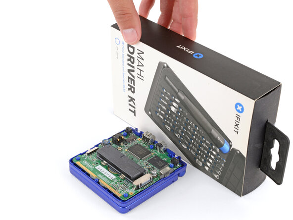

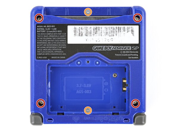

  5. Nintendo Game Boy Advance SP Buttons Replacement, Remove the bottom shell: crwdns2935265:05crwdnd2935265:01crwdnd2935265:02crwdne2935265:0 Nintendo Game Boy Advance SP Buttons Replacement, Remove the bottom shell: crwdns2935265:05crwdnd2935265:02crwdnd2935265:02crwdne2935265:0
    • Use a tri‑point Y0 screwdriver to remove the six screws securing the bottom shell:
    • Four 6.3 mm‑long recessed screws
    • Two 4.6 mm‑long screws

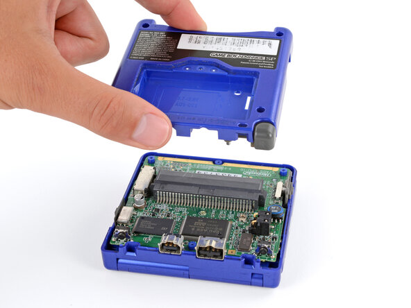

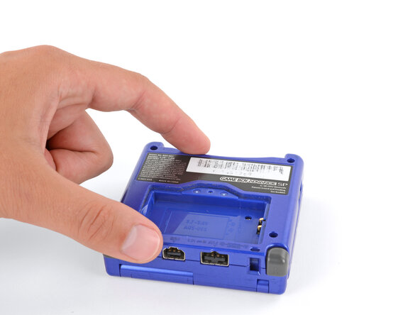

  6. Nintendo Game Boy Advance SP Buttons Replacement: crwdns2935265:06crwdnd2935265:01crwdnd2935265:02crwdne2935265:0 Nintendo Game Boy Advance SP Buttons Replacement: crwdns2935265:06crwdnd2935265:02crwdnd2935265:02crwdne2935265:0
    • Lift the bottom shell straight up and remove it.

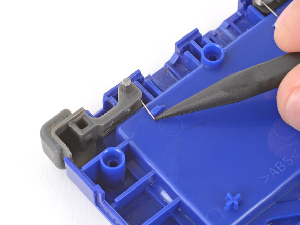

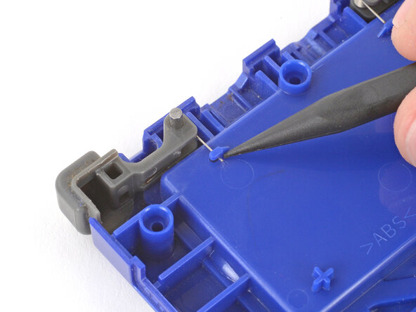

  7. Nintendo Game Boy Advance SP Buttons Replacement, Unclip the shoulder buttons: crwdns2935265:07crwdnd2935265:01crwdnd2935265:03crwdne2935265:0 Nintendo Game Boy Advance SP Buttons Replacement, Unclip the shoulder buttons: crwdns2935265:07crwdnd2935265:02crwdnd2935265:03crwdne2935265:0 Nintendo Game Boy Advance SP Buttons Replacement, Unclip the shoulder buttons: crwdns2935265:07crwdnd2935265:03crwdnd2935265:03crwdne2935265:0

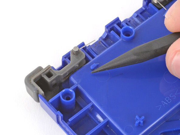

    • The shoulder buttons are located on the rear shell. They're made up of three parts—the plastic cover, a hinge pin, and a small spring.
    • Use the point of a spudger to push the spring arm out from under its clip.

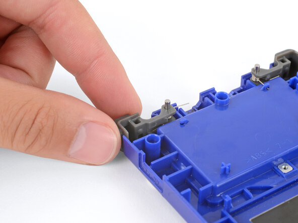

  8. Nintendo Game Boy Advance SP Buttons Replacement, Remove the shoulder buttons: crwdns2935265:08crwdnd2935265:01crwdnd2935265:02crwdne2935265:0 Nintendo Game Boy Advance SP Buttons Replacement, Remove the shoulder buttons: crwdns2935265:08crwdnd2935265:02crwdnd2935265:02crwdne2935265:0
    • The button’s three parts will likely fall out during removal—don’t worry, just set them aside for reassembly.
    • Lift the shoulder button straight up and off its hinge pin to remove it.
    • Repeat the process to remove the other shoulder button.
    • During reassembly, follow this guide to install the shoulder buttons.

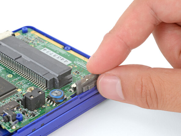

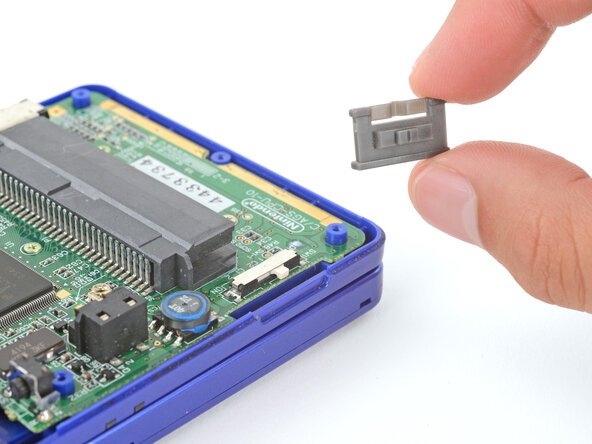

  9. Nintendo Game Boy Advance SP Buttons Replacement, Remove the power switch cover: crwdns2935265:09crwdnd2935265:01crwdnd2935265:02crwdne2935265:0 Nintendo Game Boy Advance SP Buttons Replacement, Remove the power switch cover: crwdns2935265:09crwdnd2935265:02crwdnd2935265:02crwdne2935265:0
    • Use your fingers to lift and remove the power switch cover.
    • During reassembly:
    • Use your fingers to put the power switch cover (notched side up) into place so the cutout goes around the actual switch.
    • Gently slide the cover back and forth to make sure it's positioned properly and moving the switch.
    • If the switch isn't properly in its cutout, you won't be able to power on your Game Boy.

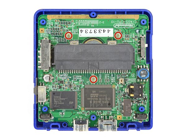

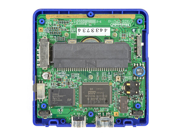

  10. Nintendo Game Boy Advance SP Buttons Replacement, Remove the motherboard screws: crwdns2935265:010crwdnd2935265:01crwdnd2935265:02crwdne2935265:0 Nintendo Game Boy Advance SP Buttons Replacement, Remove the motherboard screws: crwdns2935265:010crwdnd2935265:02crwdnd2935265:02crwdne2935265:0
    • Use a JIS 00 screwdriver to remove the three 4.1 mm‑long screws securing the motherboard.

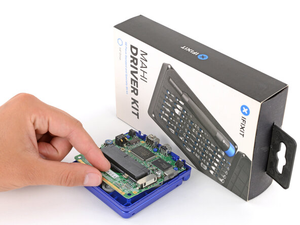

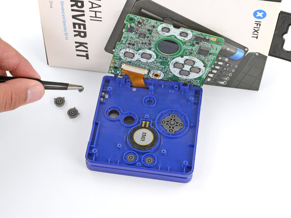

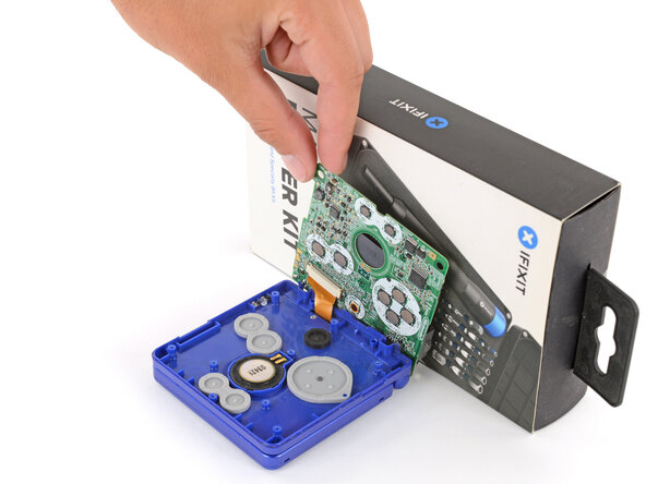

  11. Nintendo Game Boy Advance SP Buttons Replacement, Prop up the motherboard: crwdns2935265:011crwdnd2935265:01crwdnd2935265:03crwdne2935265:0 Nintendo Game Boy Advance SP Buttons Replacement, Prop up the motherboard: crwdns2935265:011crwdnd2935265:02crwdnd2935265:03crwdne2935265:0 Nintendo Game Boy Advance SP Buttons Replacement, Prop up the motherboard: crwdns2935265:011crwdnd2935265:03crwdnd2935265:03crwdne2935265:0
    • Place a sturdy object such as a stack of books or tool case along the edge of your Game Boy with the hinges.
    • Use your fingers to gently flip the motherboard over the hinges and prop it up.

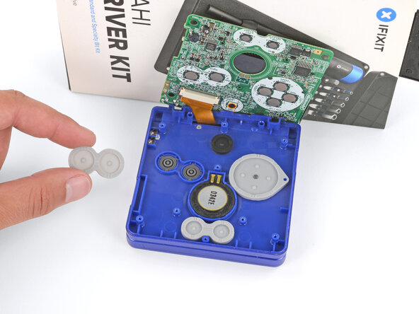

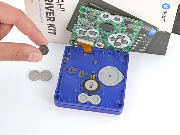

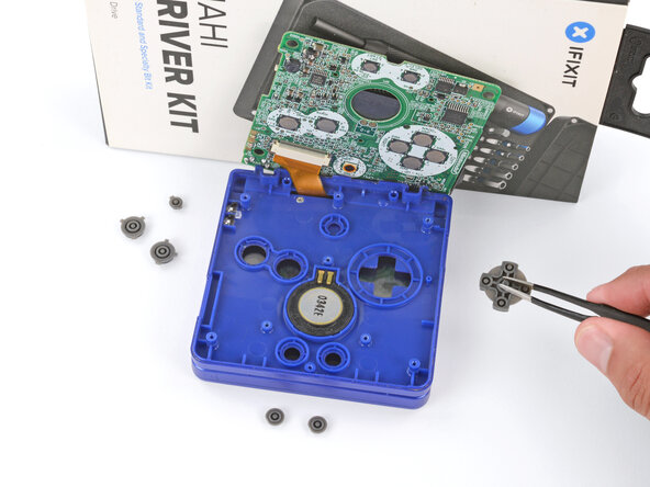

  12. Nintendo Game Boy Advance SP Buttons Replacement, Remove the silicone pads: crwdns2935265:012crwdnd2935265:01crwdnd2935265:03crwdne2935265:0 Nintendo Game Boy Advance SP Buttons Replacement, Remove the silicone pads: crwdns2935265:012crwdnd2935265:02crwdnd2935265:03crwdne2935265:0 Nintendo Game Boy Advance SP Buttons Replacement, Remove the silicone pads: crwdns2935265:012crwdnd2935265:03crwdnd2935265:03crwdne2935265:0
    • Use tweezers or your fingers to remove the four silicone pads covering the buttons (A and B, D‑pad, brightness, and Start/Select).
    • If any of the pads are missing, they may be stuck to their corresponding spot on the motherboard.

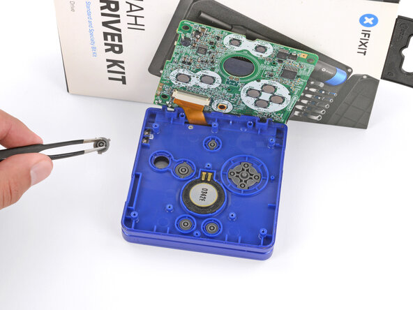

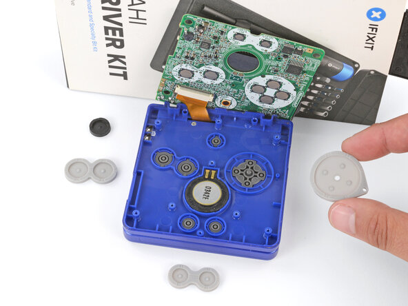

  13. Nintendo Game Boy Advance SP Buttons Replacement, Remove the buttons: crwdns2935265:013crwdnd2935265:01crwdnd2935265:03crwdne2935265:0 Nintendo Game Boy Advance SP Buttons Replacement, Remove the buttons: crwdns2935265:013crwdnd2935265:02crwdnd2935265:03crwdne2935265:0 Nintendo Game Boy Advance SP Buttons Replacement, Remove the buttons: crwdns2935265:013crwdnd2935265:03crwdnd2935265:03crwdne2935265:0
    • Use tweezers or your fingers to remove the buttons (A and B, D‑pad, brightness, and Start/Select).
    • When re‑inserting the action buttons, note that each one is keyed specifically for its recess and proper orientation.
