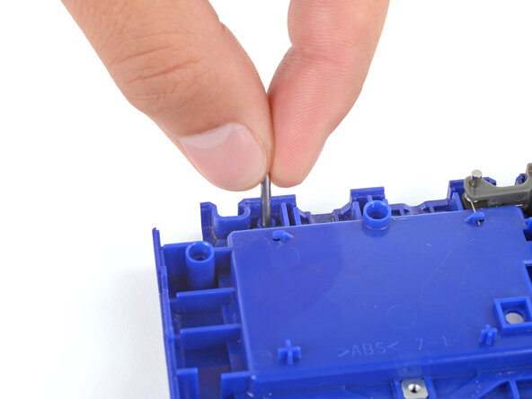

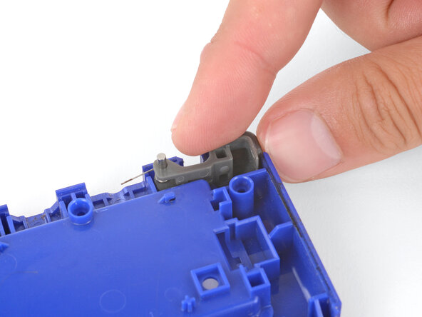

  1. How to Install Shoulder Buttons in Your Game Boy Advance SP, Install the hinge pin: crwdns2935265:01crwdnd2935265:01crwdnd2935265:02crwdne2935265:0 How to Install Shoulder Buttons in Your Game Boy Advance SP, Install the hinge pin: crwdns2935265:01crwdnd2935265:02crwdnd2935265:02crwdne2935265:0
    • If the hinge pin fell out when removing the shoulder button, put it back into place.

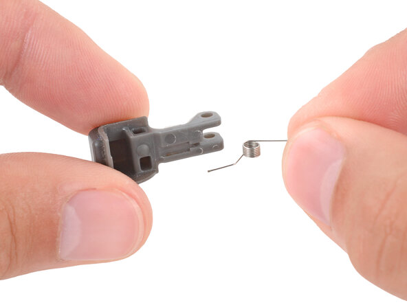

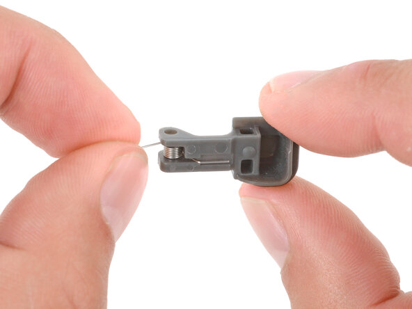

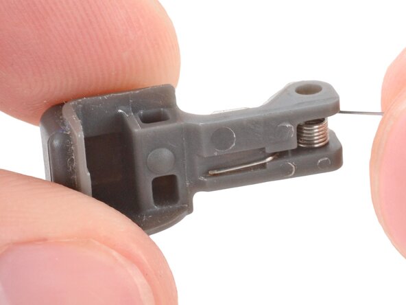

  2. How to Install Shoulder Buttons in Your Game Boy Advance SP, Install the spring: crwdns2935265:02crwdnd2935265:01crwdnd2935265:03crwdne2935265:0 How to Install Shoulder Buttons in Your Game Boy Advance SP, Install the spring: crwdns2935265:02crwdnd2935265:02crwdnd2935265:03crwdne2935265:0 How to Install Shoulder Buttons in Your Game Boy Advance SP, Install the spring: crwdns2935265:02crwdnd2935265:03crwdnd2935265:03crwdne2935265:0
    • The two springs are not interchangeable. It should be clear if you're trying to install the wrong spring, as it won't fit correctly in the button.
    • Slide the spring into the shoulder button so the bent arm goes into the cutout on the inside edge.

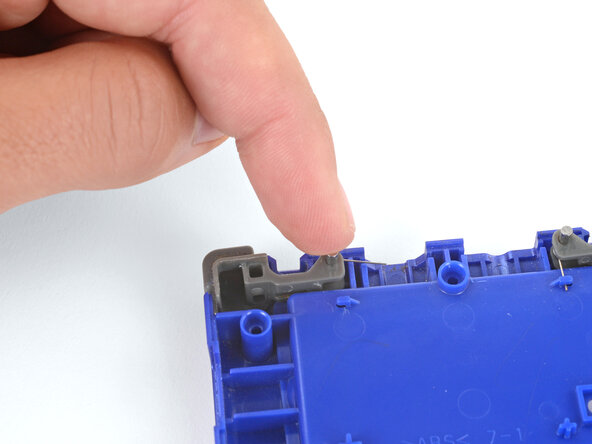

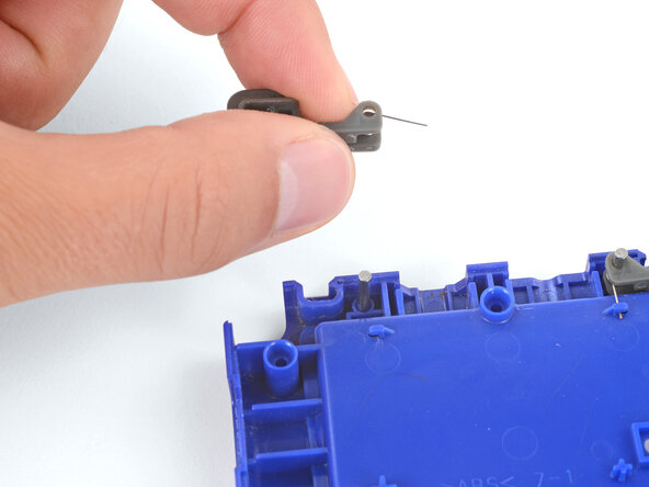

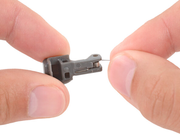

  3. How to Install Shoulder Buttons in Your Game Boy Advance SP, Put the shoulder button in place: crwdns2935265:03crwdnd2935265:01crwdnd2935265:03crwdne2935265:0 How to Install Shoulder Buttons in Your Game Boy Advance SP, Put the shoulder button in place: crwdns2935265:03crwdnd2935265:02crwdnd2935265:03crwdne2935265:0 How to Install Shoulder Buttons in Your Game Boy Advance SP, Put the shoulder button in place: crwdns2935265:03crwdnd2935265:03crwdnd2935265:03crwdne2935265:0
    • When installing the button, make sure it's oriented so the spring's straight arm is on top.
    • Use your fingers to hold the spring in place and slide the button over the hinge pin and into its recess.

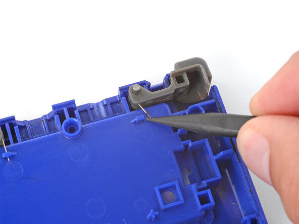

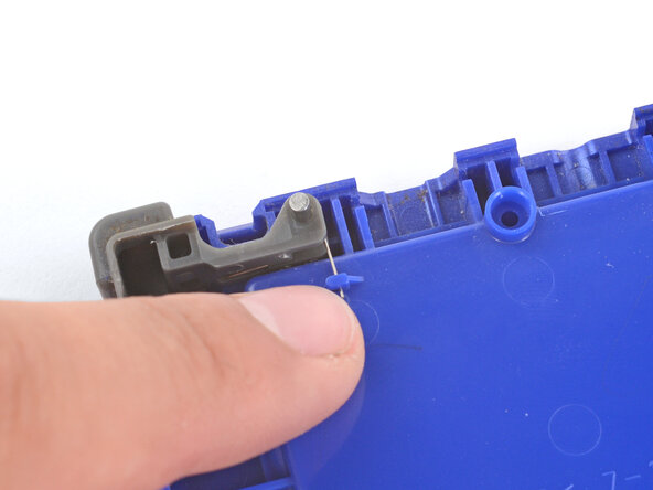

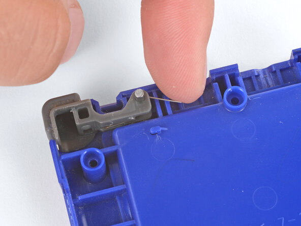

  4. How to Install Shoulder Buttons in Your Game Boy Advance SP, Push the spring arm into place: crwdns2935265:04crwdnd2935265:01crwdnd2935265:02crwdne2935265:0 How to Install Shoulder Buttons in Your Game Boy Advance SP, Push the spring arm into place: crwdns2935265:04crwdnd2935265:02crwdnd2935265:02crwdne2935265:0
    • Use your finger, a spudger, or a pair of tweezers to rotate the spring arm into its clip.

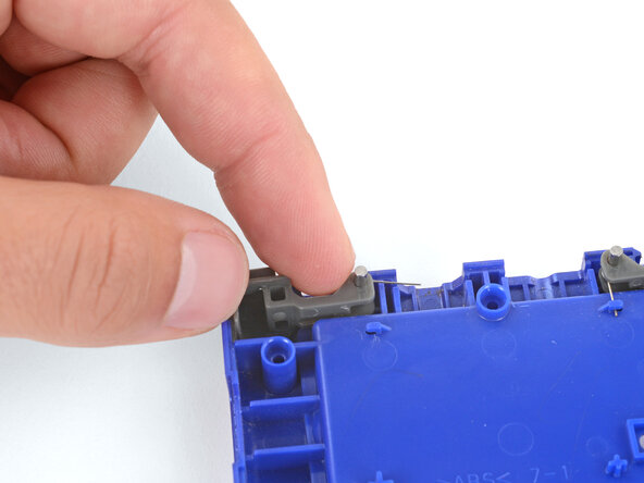

  5. How to Install Shoulder Buttons in Your Game Boy Advance SP, Install the other shoulder button: crwdns2935265:05crwdnd2935265:01crwdnd2935265:03crwdne2935265:0 How to Install Shoulder Buttons in Your Game Boy Advance SP, Install the other shoulder button: crwdns2935265:05crwdnd2935265:02crwdnd2935265:03crwdne2935265:0 How to Install Shoulder Buttons in Your Game Boy Advance SP, Install the other shoulder button: crwdns2935265:05crwdnd2935265:03crwdnd2935265:03crwdne2935265:0
    • Repeat the process to install the other shoulder button.
