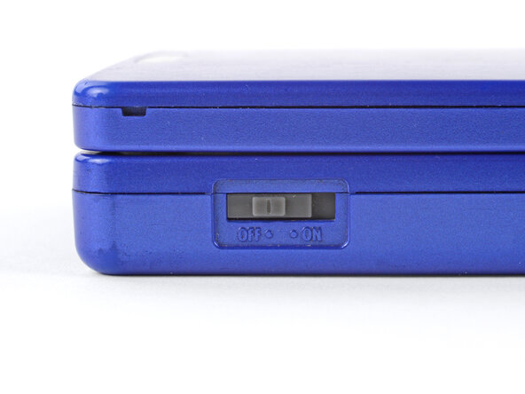

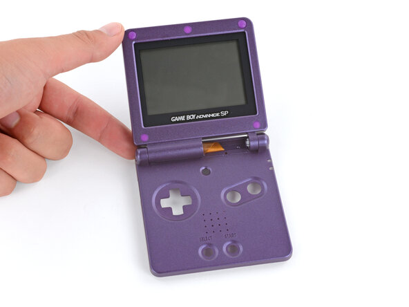

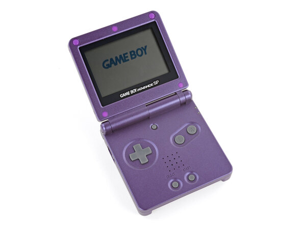

    1. How to Reshell Your Game Boy Advance SP, Prepare your Game Boy for disassembly: crwdns2935265:01crwdnd2935265:01crwdnd2935265:03crwdne2935265:0 How to Reshell Your Game Boy Advance SP, Prepare your Game Boy for disassembly: crwdns2935265:01crwdnd2935265:02crwdnd2935265:03crwdne2935265:0 How to Reshell Your Game Boy Advance SP, Prepare your Game Boy for disassembly: crwdns2935265:01crwdnd2935265:03crwdnd2935265:03crwdne2935265:0

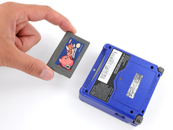

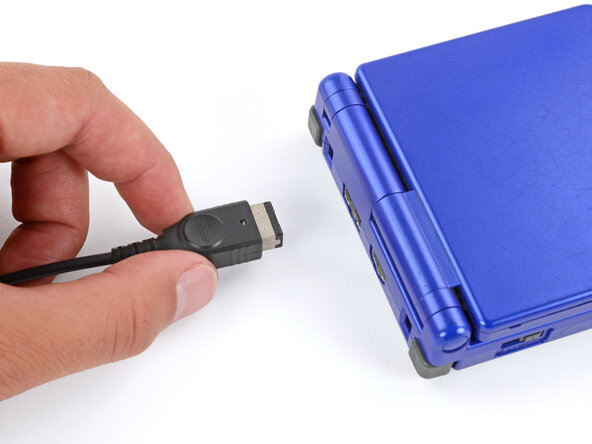

      • Slide the power switch to the OFF position and unplug any cables.
      • If you have a game cartridge in, remove it.

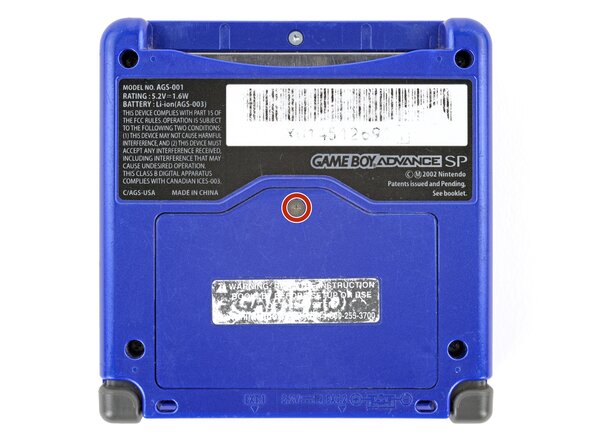

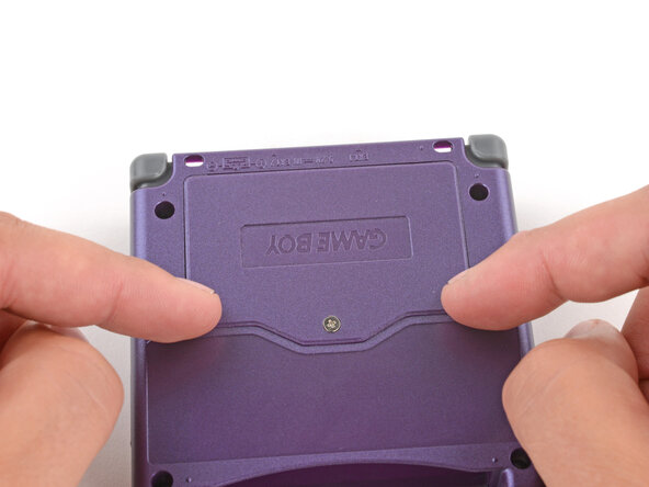

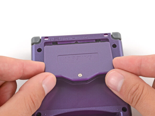

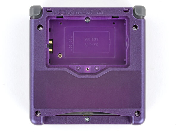

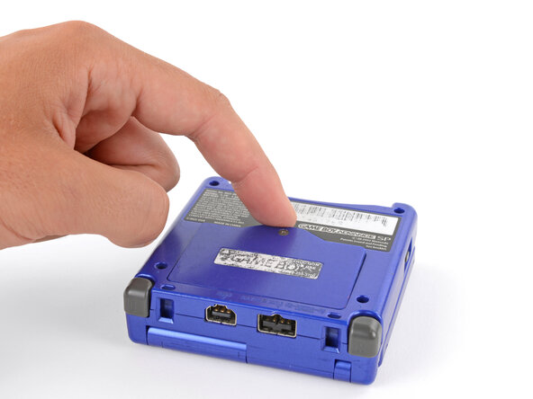

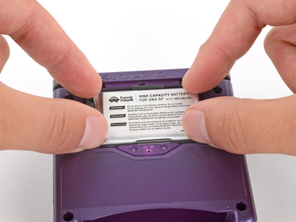

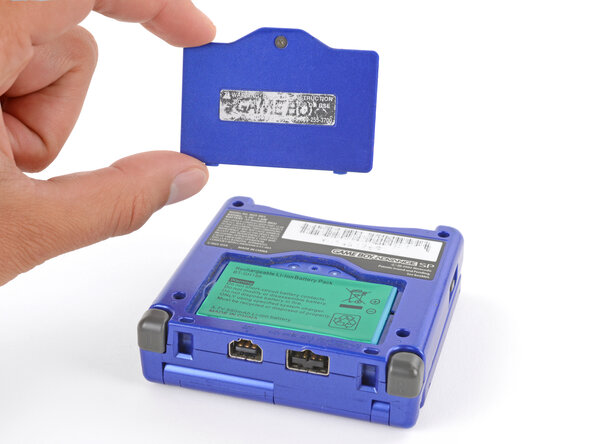

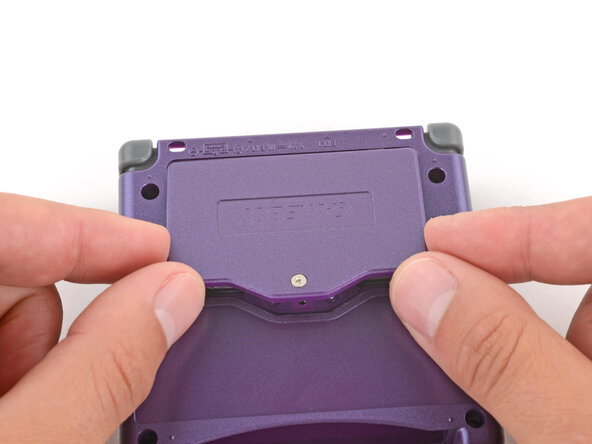

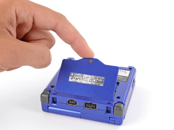

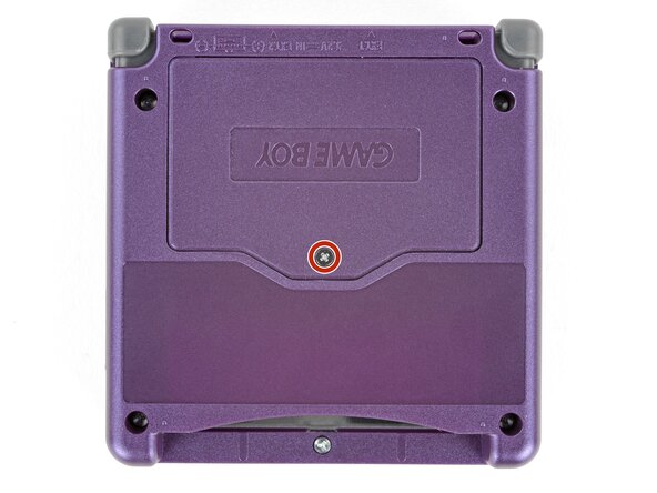

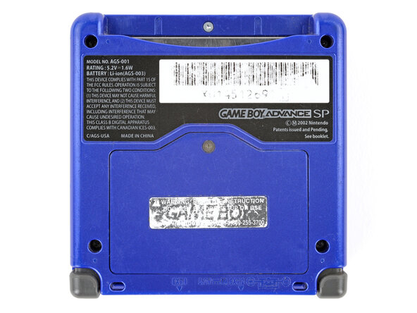

    2. How to Reshell Your Game Boy Advance SP, Remove the battery cover: crwdns2935265:02crwdnd2935265:01crwdnd2935265:02crwdne2935265:0 How to Reshell Your Game Boy Advance SP, Remove the battery cover: crwdns2935265:02crwdnd2935265:02crwdnd2935265:02crwdne2935265:0
      • Use a JIS 00 screwdriver to loosen the captive screw securing the battery cover.
      • You can try to use a non-iFixit Phillips driver in a pinch, but you risk damaging or stripping the screw. Push down firmly on the driver and twist slowly.
    3. How to Reshell Your Game Boy Advance SP: crwdns2935265:03crwdnd2935265:01crwdnd2935265:03crwdne2935265:0 How to Reshell Your Game Boy Advance SP: crwdns2935265:03crwdnd2935265:02crwdnd2935265:03crwdne2935265:0 How to Reshell Your Game Boy Advance SP: crwdns2935265:03crwdnd2935265:03crwdnd2935265:03crwdne2935265:0
      • Lift the edge of the cover near the screw and remove the cover.

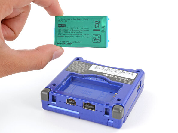

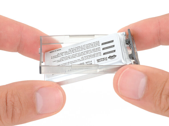

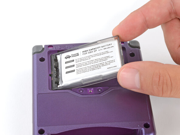

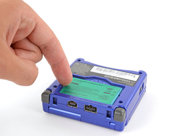

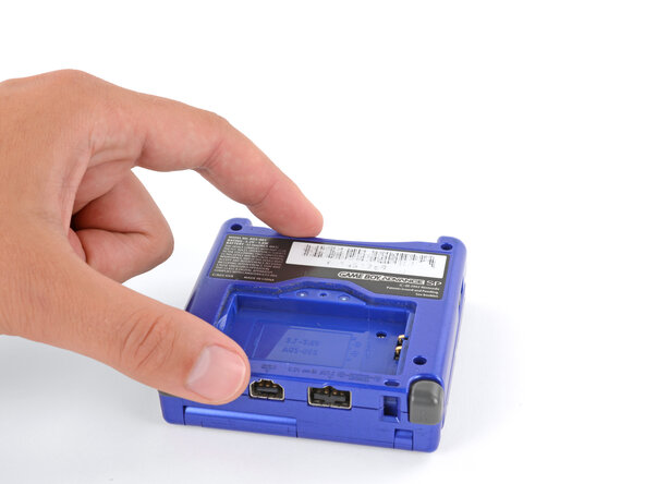

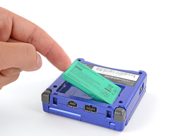

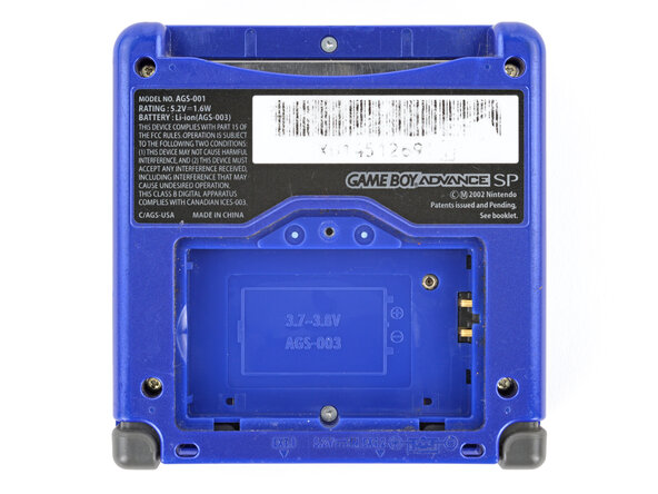

    4. How to Reshell Your Game Boy Advance SP, Remove the battery: crwdns2935265:04crwdnd2935265:01crwdnd2935265:03crwdne2935265:0 How to Reshell Your Game Boy Advance SP, Remove the battery: crwdns2935265:04crwdnd2935265:02crwdnd2935265:03crwdne2935265:0 How to Reshell Your Game Boy Advance SP, Remove the battery: crwdns2935265:04crwdnd2935265:03crwdnd2935265:03crwdne2935265:0
      • Use your finger to lift the battery by the tab on its left edge, then remove it.

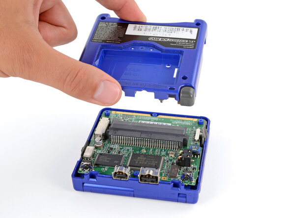

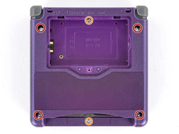

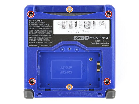

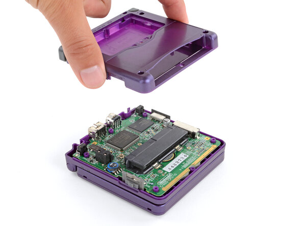

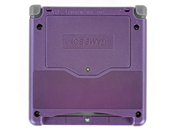

    5. How to Reshell Your Game Boy Advance SP, Remove the bottom shell: crwdns2935265:05crwdnd2935265:01crwdnd2935265:02crwdne2935265:0 How to Reshell Your Game Boy Advance SP, Remove the bottom shell: crwdns2935265:05crwdnd2935265:02crwdnd2935265:02crwdne2935265:0
      • Use a tri‑point Y0 screwdriver to remove the six screws securing the bottom shell:
      • Four 6.3 mm‑long recessed screws
      • Two 4.6 mm‑long screws
    6. How to Reshell Your Game Boy Advance SP: crwdns2935265:06crwdnd2935265:01crwdnd2935265:02crwdne2935265:0 How to Reshell Your Game Boy Advance SP: crwdns2935265:06crwdnd2935265:02crwdnd2935265:02crwdne2935265:0
      • Lift the bottom shell straight up and remove it.

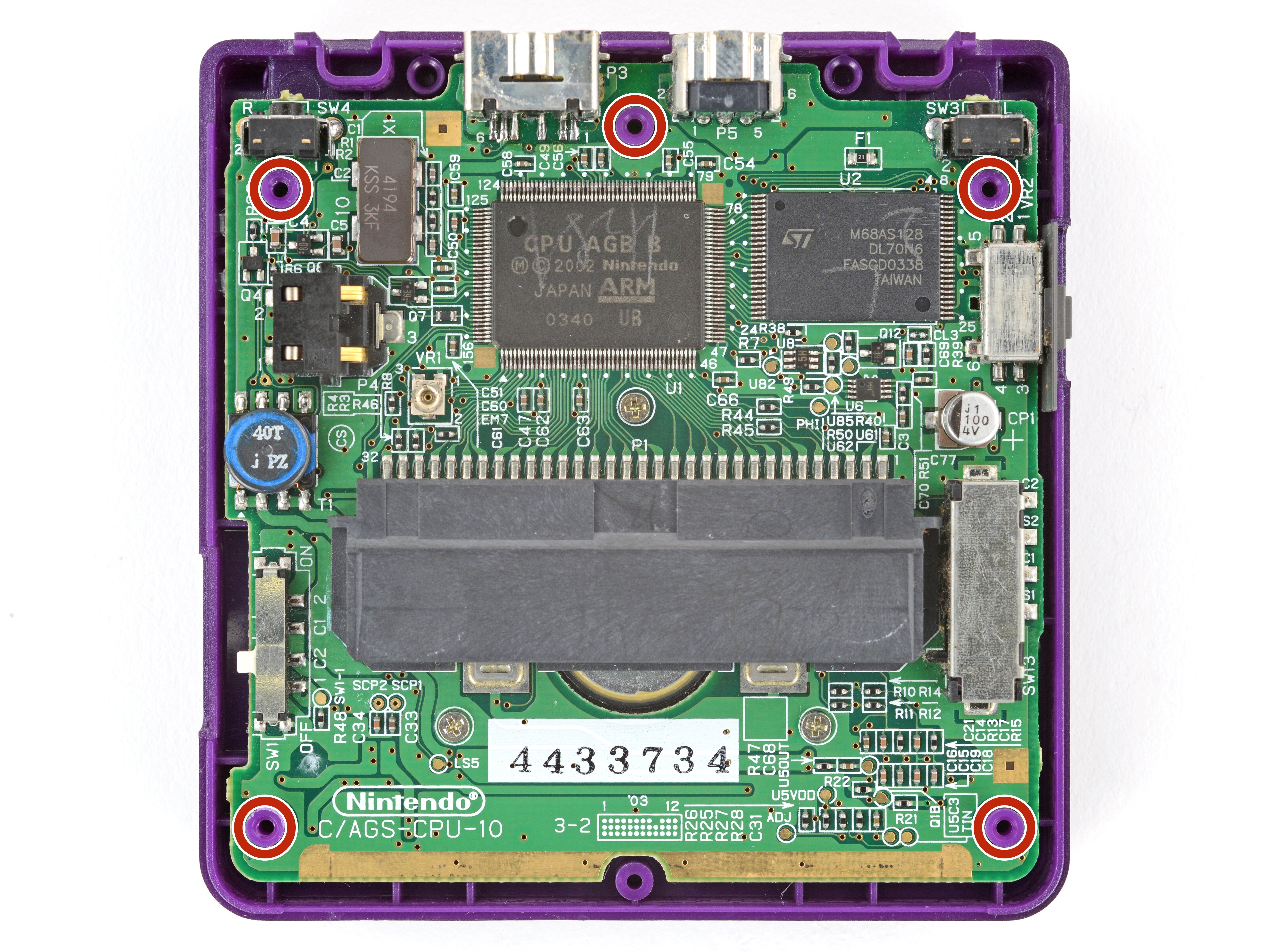

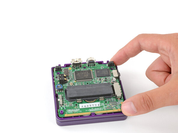

    7. How to Reshell Your Game Boy Advance SP, Remove the motherboard screws: crwdns2935265:07crwdnd2935265:01crwdnd2935265:02crwdne2935265:0 How to Reshell Your Game Boy Advance SP, Remove the motherboard screws: crwdns2935265:07crwdnd2935265:02crwdnd2935265:02crwdne2935265:0
      • Use a JIS 00 screwdriver to remove the three 4.1 mm‑long screws securing the motherboard.

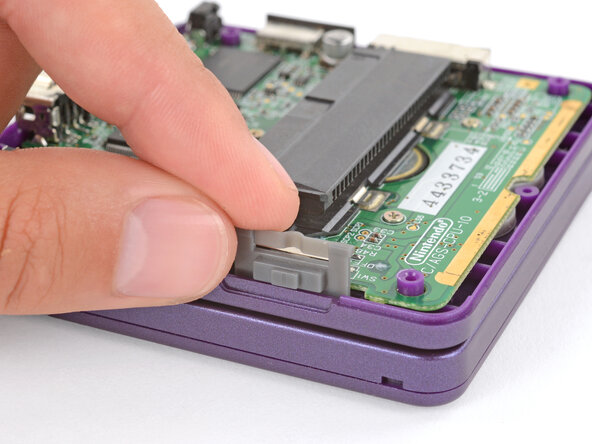

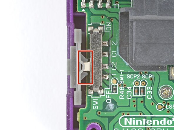

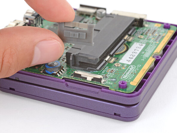

    8. How to Reshell Your Game Boy Advance SP, Remove the power switch cover: crwdns2935265:08crwdnd2935265:01crwdnd2935265:02crwdne2935265:0 How to Reshell Your Game Boy Advance SP, Remove the power switch cover: crwdns2935265:08crwdnd2935265:02crwdnd2935265:02crwdne2935265:0
      • Use your fingers to lift and remove the power switch cover.

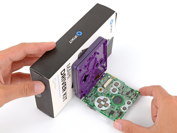

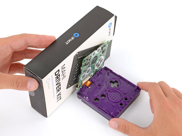

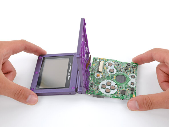

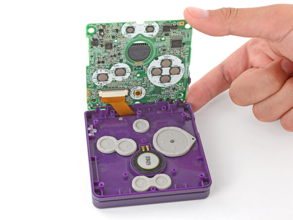

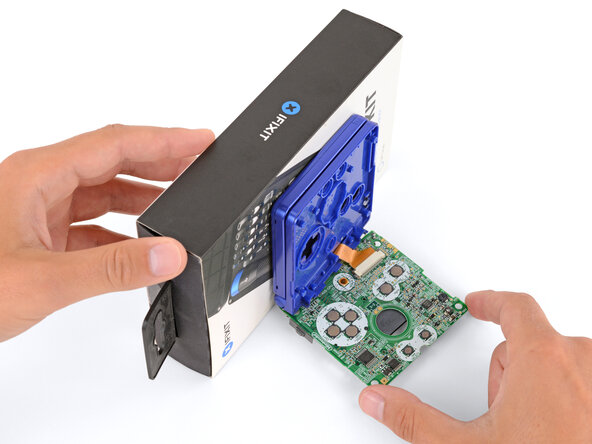

    9. How to Reshell Your Game Boy Advance SP, Prop up the motherboard: crwdns2935265:09crwdnd2935265:01crwdnd2935265:03crwdne2935265:0 How to Reshell Your Game Boy Advance SP, Prop up the motherboard: crwdns2935265:09crwdnd2935265:02crwdnd2935265:03crwdne2935265:0 How to Reshell Your Game Boy Advance SP, Prop up the motherboard: crwdns2935265:09crwdnd2935265:03crwdnd2935265:03crwdne2935265:0
      • Place a sturdy object such as a stack of books or tool case along the edge of your Game Boy with the hinges.
      • Use your fingers to gently flip the motherboard over the hinges and prop it up.

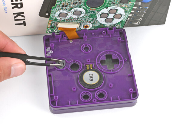

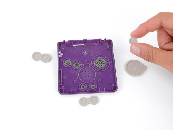

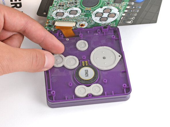

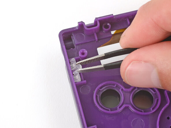

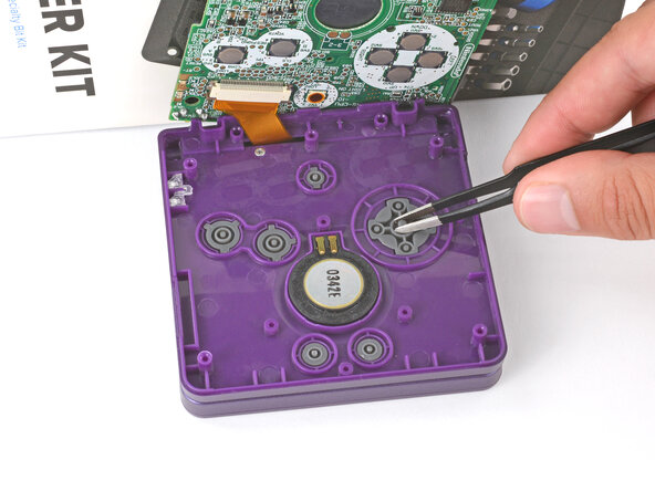

    10. How to Reshell Your Game Boy Advance SP, Remove the silicone pads: crwdns2935265:010crwdnd2935265:01crwdnd2935265:03crwdne2935265:0 How to Reshell Your Game Boy Advance SP, Remove the silicone pads: crwdns2935265:010crwdnd2935265:02crwdnd2935265:03crwdne2935265:0 How to Reshell Your Game Boy Advance SP, Remove the silicone pads: crwdns2935265:010crwdnd2935265:03crwdnd2935265:03crwdne2935265:0
      • Use tweezers or your fingers to remove the four silicone pads covering the buttons (A and B, D‑pad, brightness, and Start/Select).
      • If any of the pads are missing, they may be stuck to their corresponding spot on the motherboard.
    11. How to Reshell Your Game Boy Advance SP, Remove the buttons: crwdns2935265:011crwdnd2935265:01crwdnd2935265:03crwdne2935265:0 How to Reshell Your Game Boy Advance SP, Remove the buttons: crwdns2935265:011crwdnd2935265:02crwdnd2935265:03crwdne2935265:0 How to Reshell Your Game Boy Advance SP, Remove the buttons: crwdns2935265:011crwdnd2935265:03crwdnd2935265:03crwdne2935265:0
      • Use tweezers or your fingers to remove the buttons (A and B, D‑pad, brightness, and Start/Select).

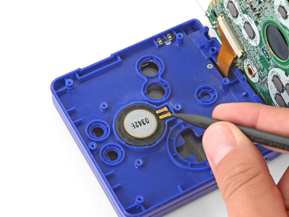

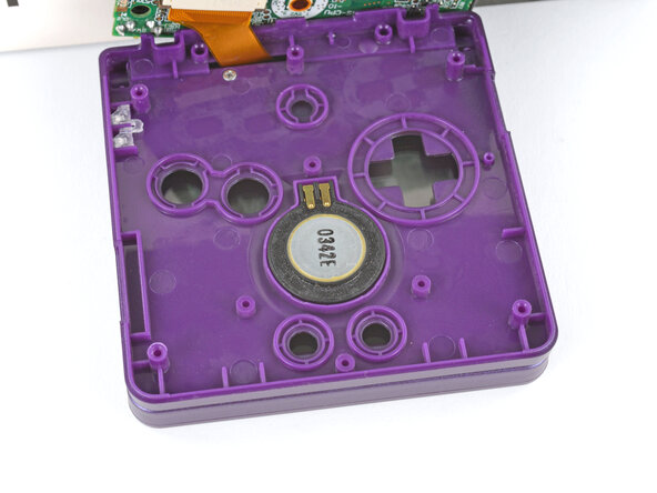

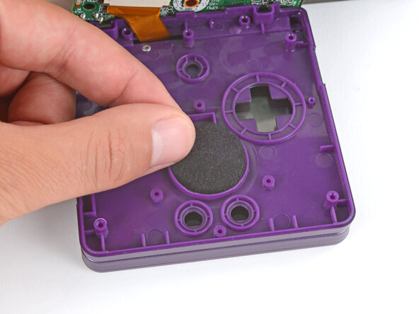

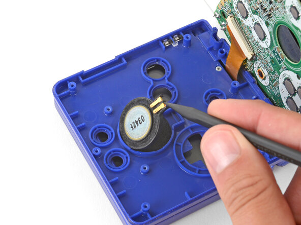

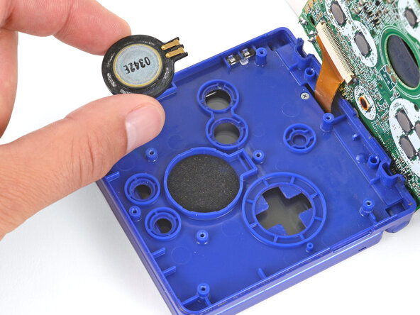

    12. How to Reshell Your Game Boy Advance SP, Remove the speaker: crwdns2935265:012crwdnd2935265:01crwdnd2935265:03crwdne2935265:0 How to Reshell Your Game Boy Advance SP, Remove the speaker: crwdns2935265:012crwdnd2935265:02crwdnd2935265:03crwdne2935265:0 How to Reshell Your Game Boy Advance SP, Remove the speaker: crwdns2935265:012crwdnd2935265:03crwdnd2935265:03crwdne2935265:0
      • Use the point of a spudger or a clean fingernail to lift the speaker until you can grip it with your fingers.
      • Remove the speaker.

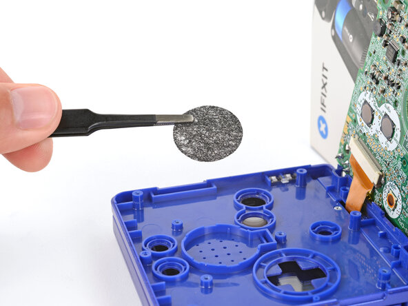

    13. How to Reshell Your Game Boy Advance SP: crwdns2935265:013crwdnd2935265:01crwdnd2935265:01crwdne2935265:0
      • Remove the circular mesh from the speaker recess and set it aside—the piece can easily fall out and get lost when working.

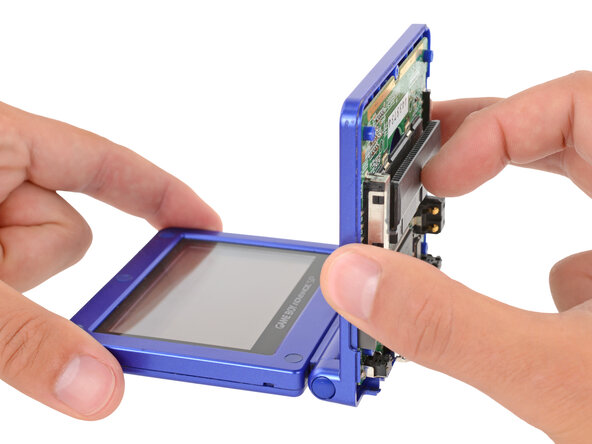

    14. How to Reshell Your Game Boy Advance SP, Prop up the main body: crwdns2935265:014crwdnd2935265:01crwdnd2935265:03crwdne2935265:0 How to Reshell Your Game Boy Advance SP, Prop up the main body: crwdns2935265:014crwdnd2935265:02crwdnd2935265:03crwdne2935265:0 How to Reshell Your Game Boy Advance SP, Prop up the main body: crwdns2935265:014crwdnd2935265:03crwdnd2935265:03crwdne2935265:0
      • Be careful not to strain the screen cable during the next few steps—it has very little slack.
      • You need to prop up the main body of your Game Boy in order to disconnect the screen cable without straining it. Here are two ways to do so:
      • Option 1: Open the main body of your Game Boy to a 90‑degree angle and gently lay the motherboard down. Make sure the main body is resting on top of the motherboard to give the cable slack.
      • Option 2: Keep the main body closed and prop it up on the edge of the logic board, using a sturdy object to hold it up.

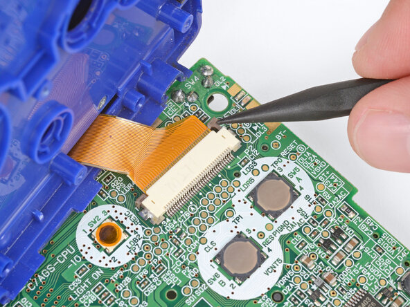

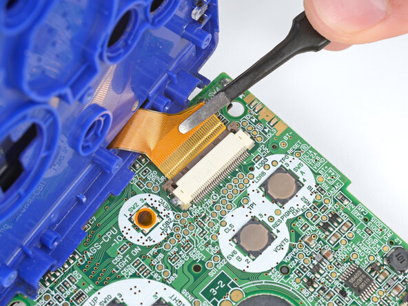

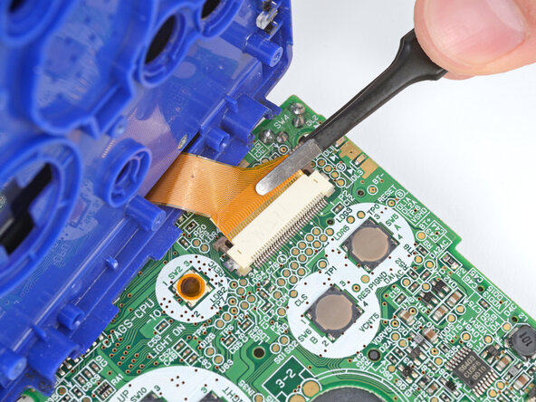

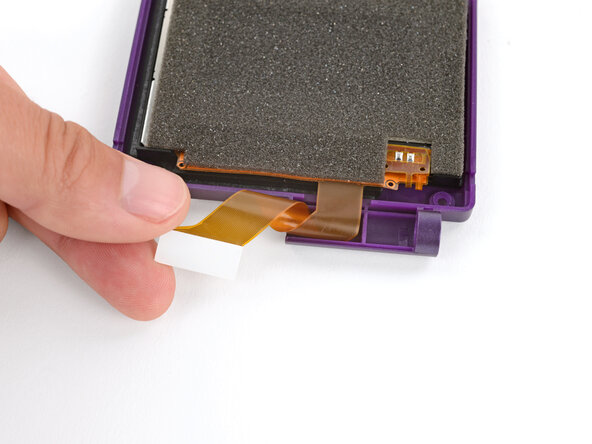

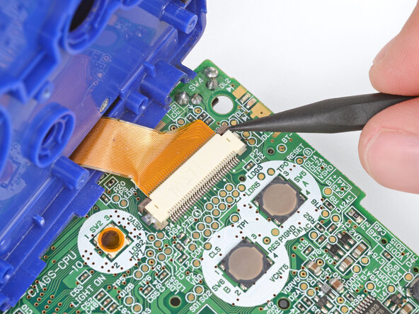

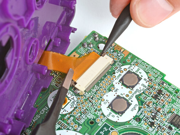

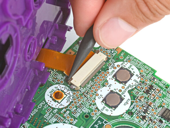

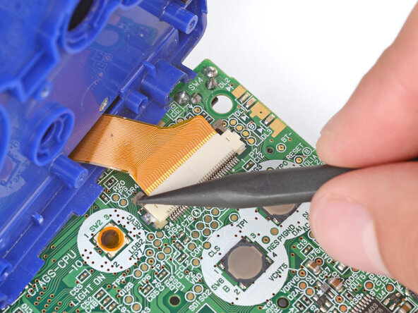

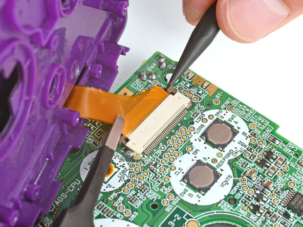

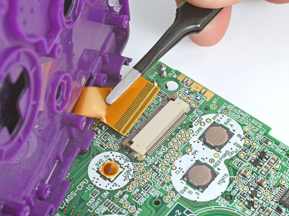

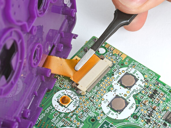

    15. How to Reshell Your Game Boy Advance SP, Disconnect the screen cable: crwdns2935265:015crwdnd2935265:01crwdnd2935265:03crwdne2935265:0 How to Reshell Your Game Boy Advance SP, Disconnect the screen cable: crwdns2935265:015crwdnd2935265:02crwdnd2935265:03crwdne2935265:0 How to Reshell Your Game Boy Advance SP, Disconnect the screen cable: crwdns2935265:015crwdnd2935265:03crwdnd2935265:03crwdne2935265:0
      • Use the point of a spudger to push the two tabs on either side of the screen cable connector into the unlocked position.
      • Only push the tabs until they stop. If you push them too far, you may slide the locking tab off the connector.
    16. How to Reshell Your Game Boy Advance SP: crwdns2935265:016crwdnd2935265:01crwdnd2935265:02crwdne2935265:0 How to Reshell Your Game Boy Advance SP: crwdns2935265:016crwdnd2935265:02crwdnd2935265:02crwdne2935265:0
      • Use a pair of tweezers to gently slide the screen cable out of its socket.

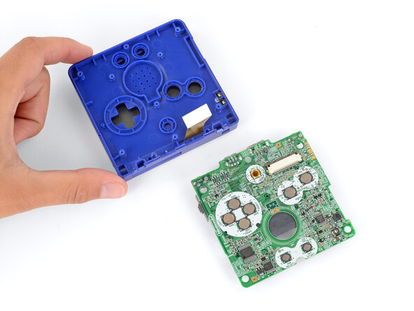

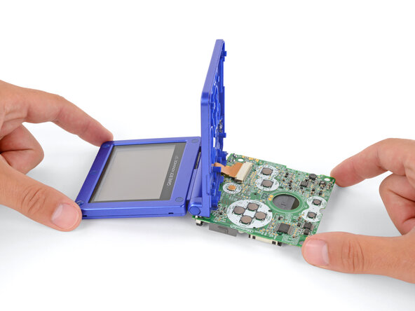

    17. How to Reshell Your Game Boy Advance SP, Remove the motherboard: crwdns2935265:017crwdnd2935265:01crwdnd2935265:01crwdne2935265:0
      • Remove the main body from the motherboard.

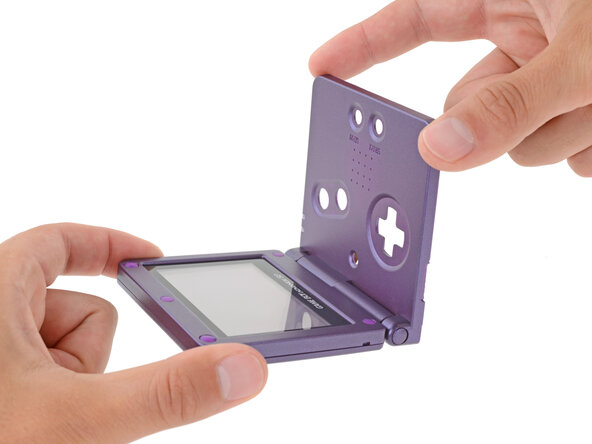

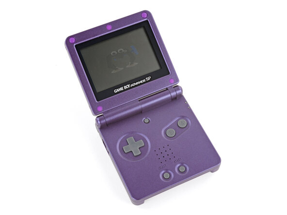

    18. How to Reshell Your Game Boy Advance SP, Open your Game Boy: crwdns2935265:018crwdnd2935265:01crwdnd2935265:01crwdne2935265:0
      • Open your Game Boy to a 90‑degree angle and set it down so the screen is facing up.

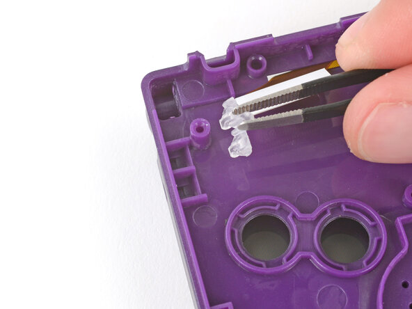

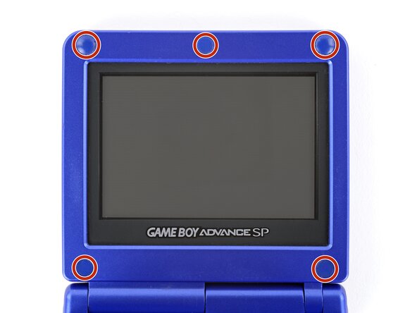

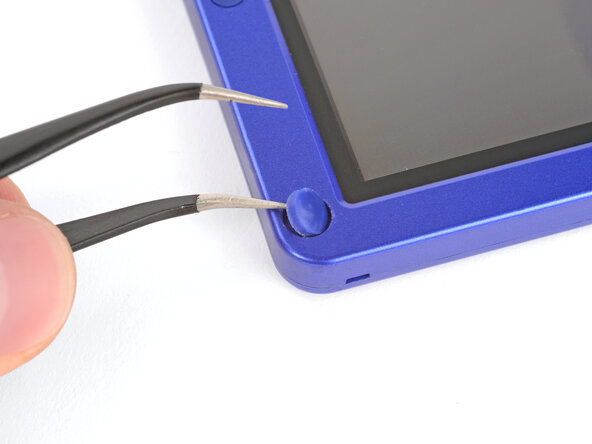

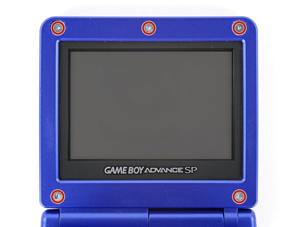

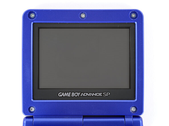

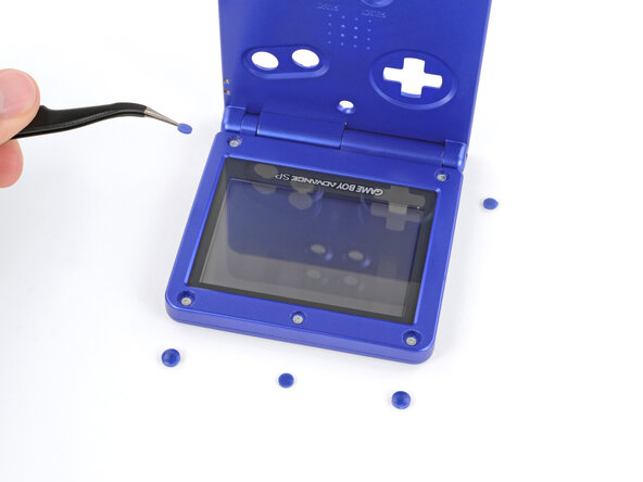

    19. How to Reshell Your Game Boy Advance SP, Remove the rubber screw covers: crwdns2935265:019crwdnd2935265:01crwdnd2935265:03crwdne2935265:0 How to Reshell Your Game Boy Advance SP, Remove the rubber screw covers: crwdns2935265:019crwdnd2935265:02crwdnd2935265:03crwdne2935265:0 How to Reshell Your Game Boy Advance SP, Remove the rubber screw covers: crwdns2935265:019crwdnd2935265:03crwdnd2935265:03crwdne2935265:0
      • Use a pair of angled tweezers to pry up and remove all five rubber screw covers.
      • Removing old, brittle covers without damaging them can be tricky. Make sure to pry gently between the cover’s edge and the frame—don’t dig into the cover itself.

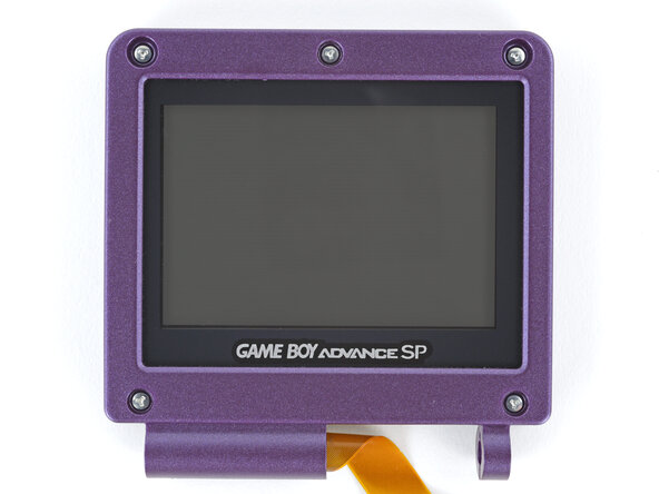

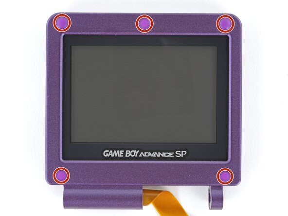

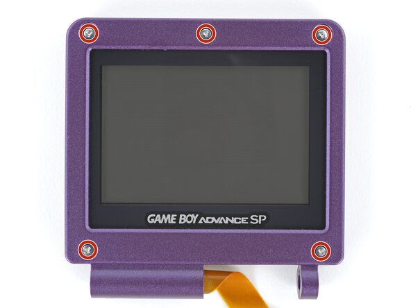

    20. How to Reshell Your Game Boy Advance SP, Remove the screen screws: crwdns2935265:020crwdnd2935265:01crwdnd2935265:02crwdne2935265:0 How to Reshell Your Game Boy Advance SP, Remove the screen screws: crwdns2935265:020crwdnd2935265:02crwdnd2935265:02crwdne2935265:0
      • Use a tri‑point Y0 screwdriver to remove the five 4.7 mm‑long screws securing screen shells together.

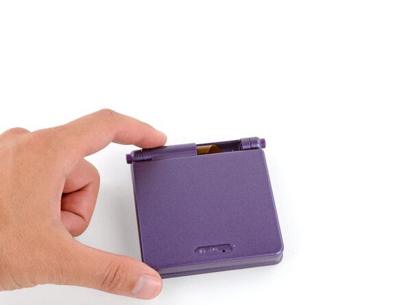

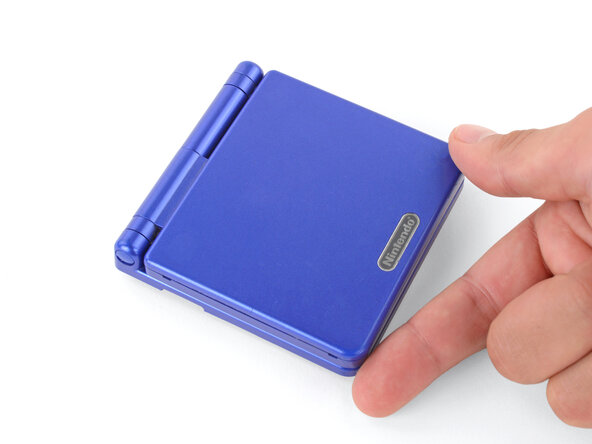

    21. How to Reshell Your Game Boy Advance SP, Close the main body: crwdns2935265:021crwdnd2935265:01crwdnd2935265:02crwdne2935265:0 How to Reshell Your Game Boy Advance SP, Close the main body: crwdns2935265:021crwdnd2935265:02crwdnd2935265:02crwdne2935265:0
      • Fully close your Game Boy (the button cutouts should be on top).

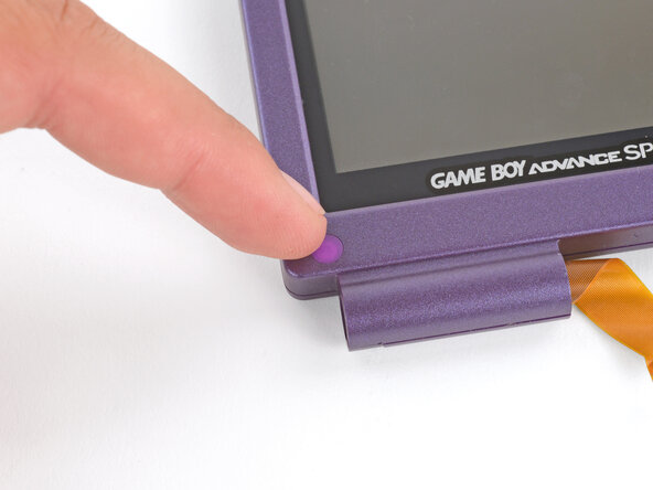

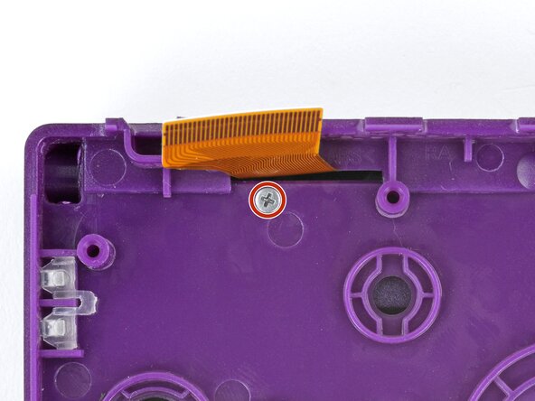

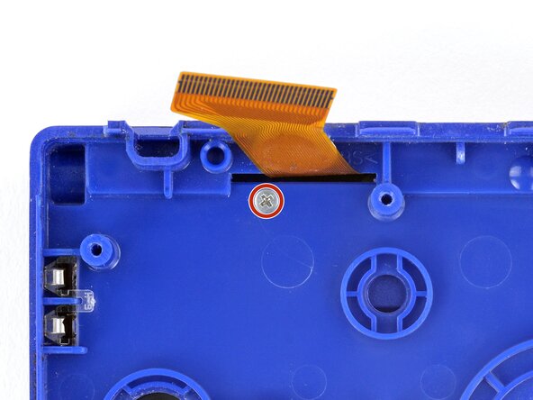

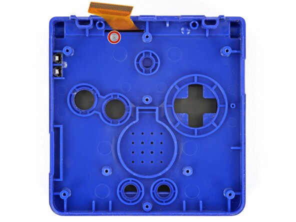

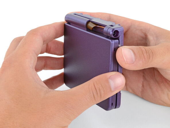

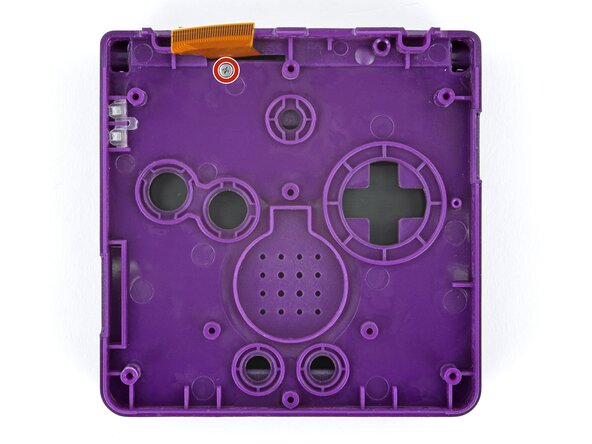

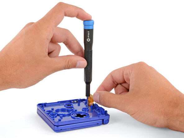

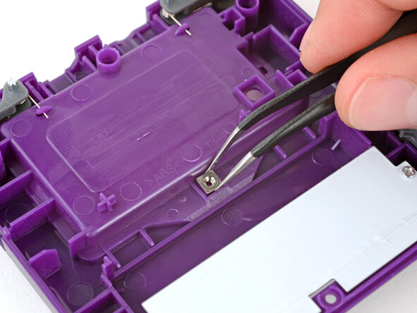

    22. How to Reshell Your Game Boy Advance SP, Remove the hinge cover screw: crwdns2935265:022crwdnd2935265:01crwdnd2935265:03crwdne2935265:0 How to Reshell Your Game Boy Advance SP, Remove the hinge cover screw: crwdns2935265:022crwdnd2935265:02crwdnd2935265:03crwdne2935265:0 How to Reshell Your Game Boy Advance SP, Remove the hinge cover screw: crwdns2935265:022crwdnd2935265:03crwdnd2935265:03crwdne2935265:0
      • Use a JIS 00 screwdriver to remove the 6.3 mm‑long screw securing the hinge cover.
      • You may need to use your free hand to hold the screen cable out of the way.
    23. How to Reshell Your Game Boy Advance SP, Flip your Game Boy over: crwdns2935265:023crwdnd2935265:01crwdnd2935265:02crwdne2935265:0 How to Reshell Your Game Boy Advance SP, Flip your Game Boy over: crwdns2935265:023crwdnd2935265:02crwdnd2935265:02crwdne2935265:0
      • Flip your Game Boy over.

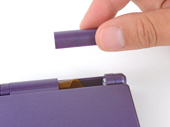

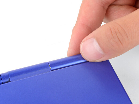

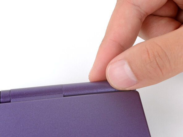

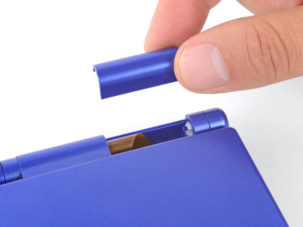

    24. How to Reshell Your Game Boy Advance SP, Remove the hinge cover: crwdns2935265:024crwdnd2935265:01crwdnd2935265:02crwdne2935265:0 How to Reshell Your Game Boy Advance SP, Remove the hinge cover: crwdns2935265:024crwdnd2935265:02crwdnd2935265:02crwdne2935265:0
      • Use your fingers to lift and remove the hinge cover.

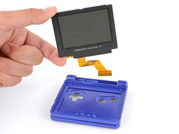

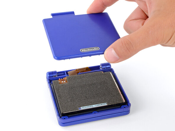

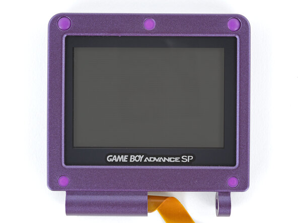

    25. How to Reshell Your Game Boy Advance SP, Remove the top shell: crwdns2935265:025crwdnd2935265:01crwdnd2935265:03crwdne2935265:0 How to Reshell Your Game Boy Advance SP, Remove the top shell: crwdns2935265:025crwdnd2935265:02crwdnd2935265:03crwdne2935265:0 How to Reshell Your Game Boy Advance SP, Remove the top shell: crwdns2935265:025crwdnd2935265:03crwdnd2935265:03crwdne2935265:0
      • Depending on the age of your device, the screen may stay attached to its outer shell. If it does, make sure to thread the cable through its cutout while removing the shell.
      • Use your fingers to lift and remove the outer screen shell.

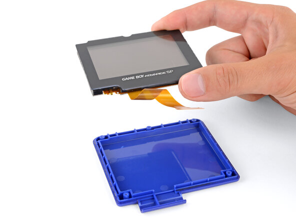

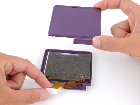

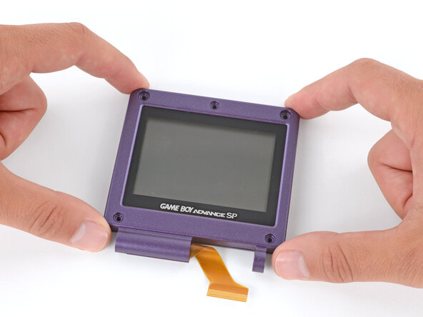

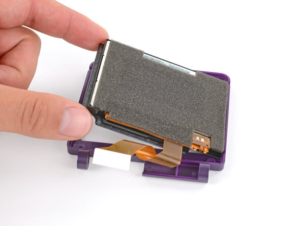

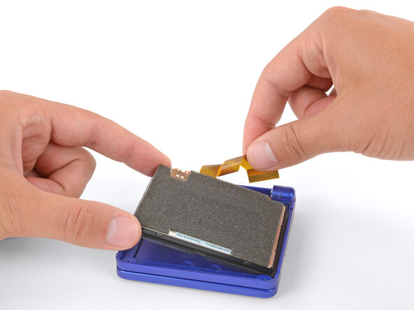

    26. How to Reshell Your Game Boy Advance SP, Remove the screen: crwdns2935265:026crwdnd2935265:01crwdnd2935265:03crwdne2935265:0 How to Reshell Your Game Boy Advance SP, Remove the screen: crwdns2935265:026crwdnd2935265:02crwdnd2935265:03crwdne2935265:0 How to Reshell Your Game Boy Advance SP, Remove the screen: crwdns2935265:026crwdnd2935265:03crwdnd2935265:03crwdne2935265:0
      • Use your fingers to lift and remove the screen, threading the cable through its cutout.
      • If your screen stayed attached to the shell, you may need to gently pry it up with a spudger before removing it.

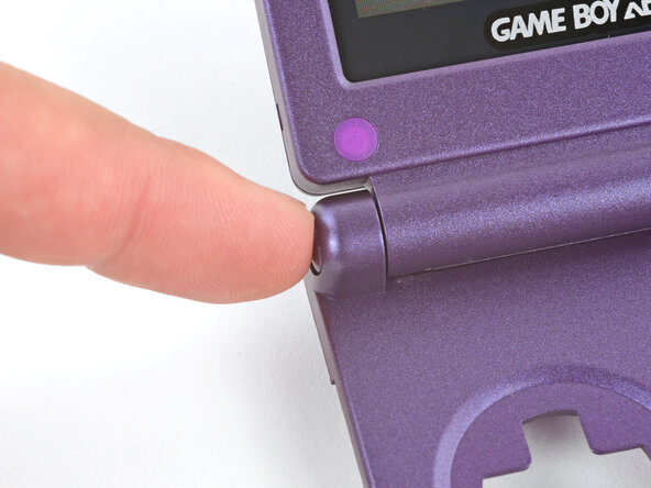

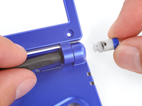

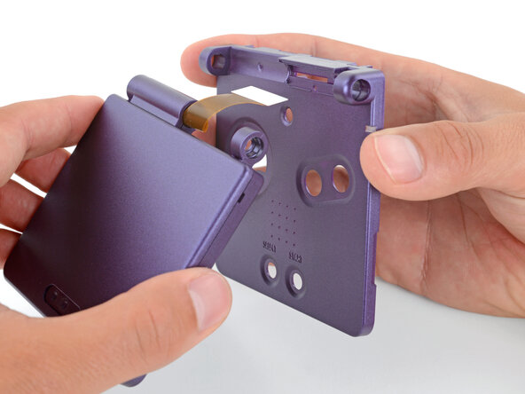

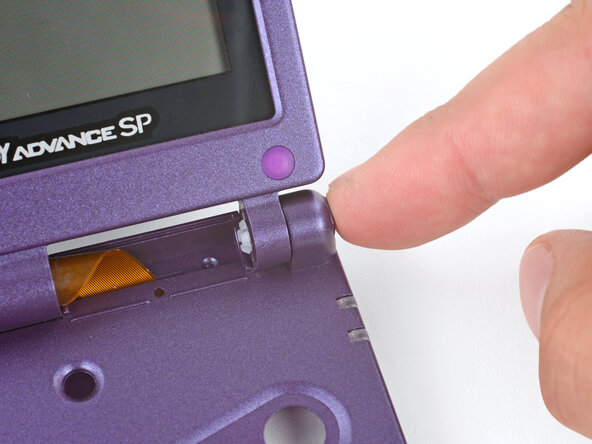

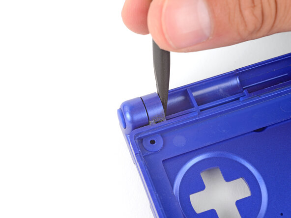

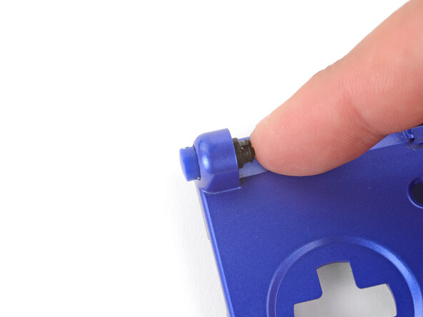

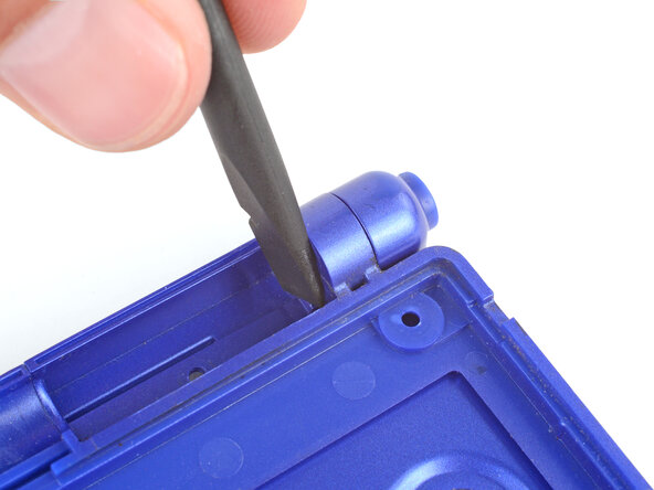

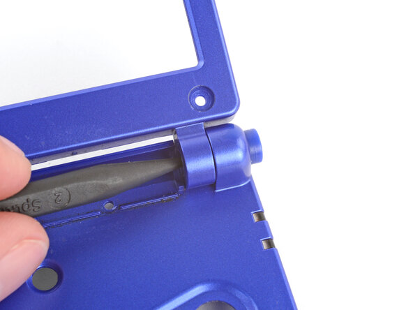

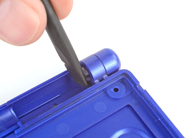

    27. How to Reshell Your Game Boy Advance SP, Partially separate the hinges: crwdns2935265:027crwdnd2935265:01crwdnd2935265:03crwdne2935265:0 How to Reshell Your Game Boy Advance SP, Partially separate the hinges: crwdns2935265:027crwdnd2935265:02crwdnd2935265:03crwdne2935265:0 How to Reshell Your Game Boy Advance SP, Partially separate the hinges: crwdns2935265:027crwdnd2935265:03crwdnd2935265:03crwdne2935265:0
      • Don't try to force the hinges out of their sockets—you may damage the hinges, crack the shell, or injure yourself.
      • Use the flat end of a spudger to push both hinges partially out of their sockets.
      • You only need to push the hinges out until you feel them click into place.

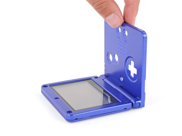

    28. How to Reshell Your Game Boy Advance SP, Open the shell: crwdns2935265:028crwdnd2935265:01crwdnd2935265:02crwdne2935265:0 How to Reshell Your Game Boy Advance SP, Open the shell: crwdns2935265:028crwdnd2935265:02crwdnd2935265:02crwdne2935265:0
      • Full open the shell of your Game Boy.

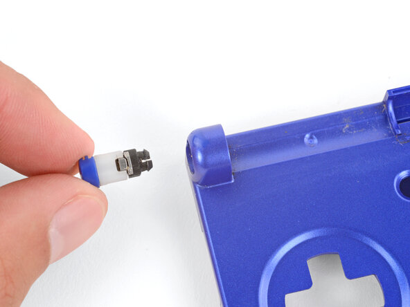

    29. How to Reshell Your Game Boy Advance SP, Remove the right hinge: crwdns2935265:029crwdnd2935265:01crwdnd2935265:02crwdne2935265:0 How to Reshell Your Game Boy Advance SP, Remove the right hinge: crwdns2935265:029crwdnd2935265:02crwdnd2935265:02crwdne2935265:0
      • Use the point of a spudger to push the right hinge fully out of its socket and remove it.

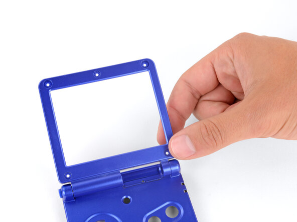

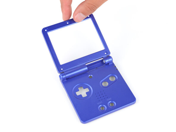

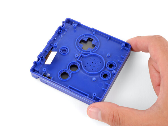

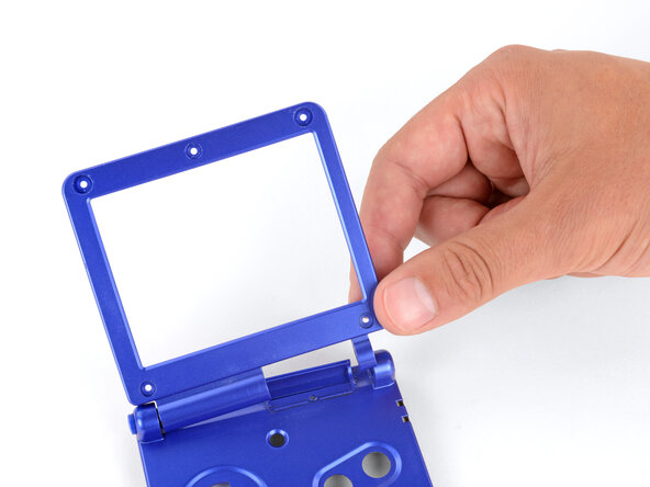

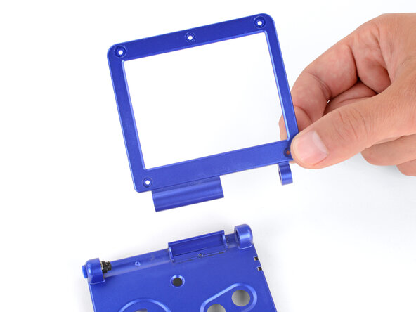

    30. How to Reshell Your Game Boy Advance SP, Remove the screen bezel: crwdns2935265:030crwdnd2935265:01crwdnd2935265:03crwdne2935265:0 How to Reshell Your Game Boy Advance SP, Remove the screen bezel: crwdns2935265:030crwdnd2935265:02crwdnd2935265:03crwdne2935265:0 How to Reshell Your Game Boy Advance SP, Remove the screen bezel: crwdns2935265:030crwdnd2935265:03crwdnd2935265:03crwdne2935265:0
      • Use your fingers to gently lift the right side of the screen bezel.
      • Pull the screen bezel to the right—so it slides out of the left hinge—and remove it.
    31. How to Reshell Your Game Boy Advance SP, Remove the left hinge: crwdns2935265:031crwdnd2935265:01crwdnd2935265:03crwdne2935265:0 How to Reshell Your Game Boy Advance SP, Remove the left hinge: crwdns2935265:031crwdnd2935265:02crwdnd2935265:03crwdne2935265:0 How to Reshell Your Game Boy Advance SP, Remove the left hinge: crwdns2935265:031crwdnd2935265:03crwdnd2935265:03crwdne2935265:0
      • Use your finger to push the left hinge out of its socket and remove it.

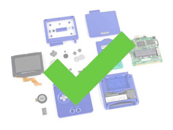

    1. How to Reshell Your Game Boy Advance SP, Disassembly complete: crwdns2935265:032crwdnd2935265:01crwdnd2935265:01crwdne2935265:0
      • Congratulations on disassembling your Game Boy! The remaining steps will show you how to transfer everything into your new shells.

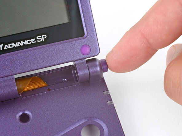

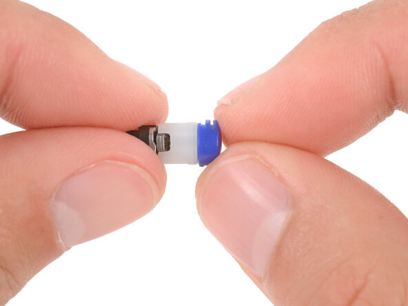

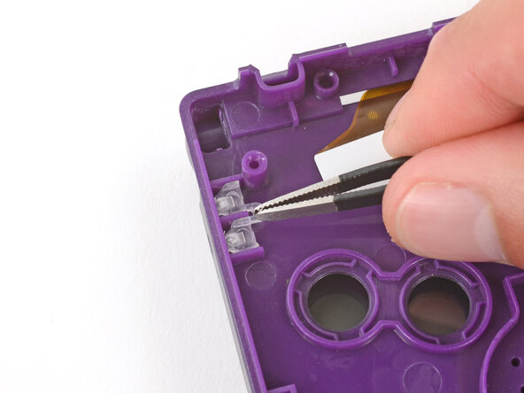

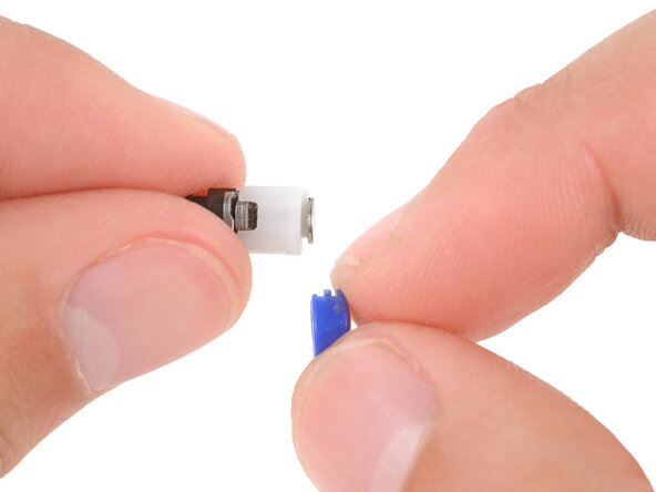

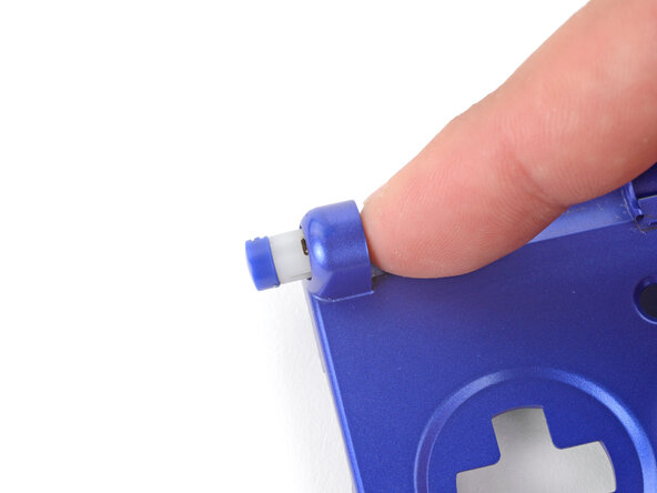

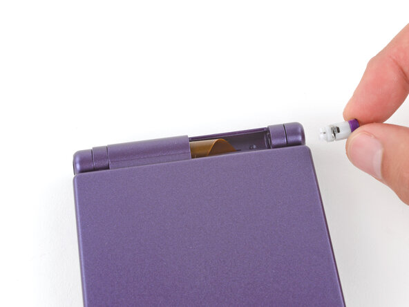

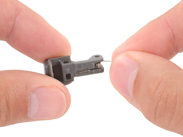

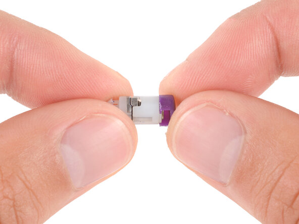

    2. How to Reshell Your Game Boy Advance SP, Install new hinge caps: crwdns2935265:033crwdnd2935265:01crwdnd2935265:03crwdne2935265:0 How to Reshell Your Game Boy Advance SP, Install new hinge caps: crwdns2935265:033crwdnd2935265:02crwdnd2935265:03crwdne2935265:0 How to Reshell Your Game Boy Advance SP, Install new hinge caps: crwdns2935265:033crwdnd2935265:03crwdnd2935265:03crwdne2935265:0
      • If your kit comes with replacement hinges, you can skip this step. Otherwise, follow this step to install new hinge caps.
      • Use your fingers to firmly slide the plastic caps off of the hinges, at a perpendicular angle to the hinge.
      • This may take some force, as the caps fit very tightly on the hinges.
      • Slide your new caps onto the hinges until they click into place.
      • The caps are grooved so you can only slide them on when they're in the proper orientation.

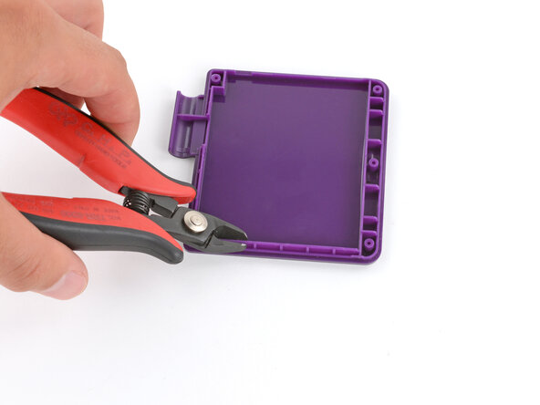

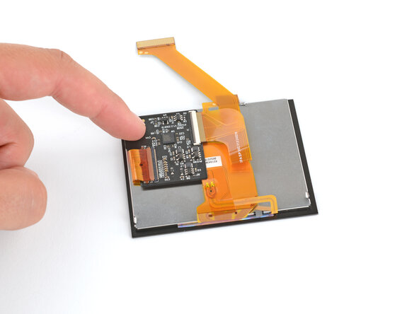

    3. How to Reshell Your Game Boy Advance SP, Modification information: crwdns2935265:034crwdnd2935265:01crwdnd2935265:03crwdne2935265:0 How to Reshell Your Game Boy Advance SP, Modification information: crwdns2935265:034crwdnd2935265:02crwdnd2935265:03crwdne2935265:0 How to Reshell Your Game Boy Advance SP, Modification information: crwdns2935265:034crwdnd2935265:03crwdnd2935265:03crwdne2935265:0
      • For some IPS screen upgrades, you may need to make modifications to your replacement outer screen shell, or the screen itself. If you're using the original screen, you don't need to make modifications. Check your kit or the website you purchased it from for specific instructions before making any modifications.
      • Some IPS screens are bigger than the original. You may need to use flush cutters to trim one of the plastic side rails to make room for your replacement screen.
      • Your replacement screen may come with a small extra board and ribbon cable(s). The board will likely need to be adhered to the back of the screen, and the ribbon cable will connect to the board. Check the board and any cables for adhesive backings, and follow any manufacturer instructions.

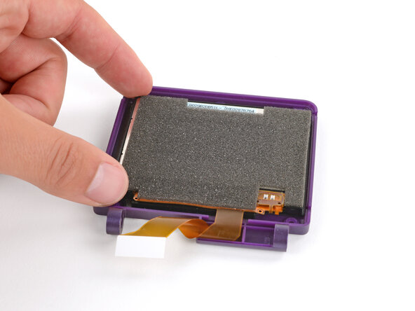

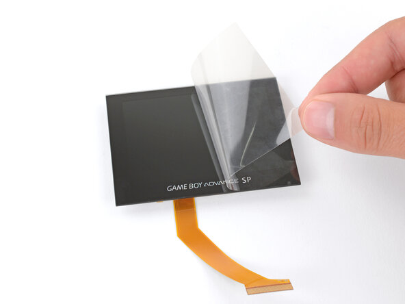

    4. How to Reshell Your Game Boy Advance SP, Remove any protective screen liners: crwdns2935265:035crwdnd2935265:01crwdnd2935265:01crwdne2935265:0
      • Make sure your screen has the large foam pad installed on the backside.
      • If you're installing a new screen, remove any protective liners.

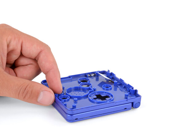

    5. How to Reshell Your Game Boy Advance SP, Lay the screen in place: crwdns2935265:036crwdnd2935265:01crwdnd2935265:02crwdne2935265:0 How to Reshell Your Game Boy Advance SP, Lay the screen in place: crwdns2935265:036crwdnd2935265:02crwdnd2935265:02crwdne2935265:0
      • Remember, there are two screen shells—make sure you're laying the screen into the inner shell, with a cutout for the screen.
      • Lay the screen display‑side-down into its inner shell, so the cable is near the hinge sockets.

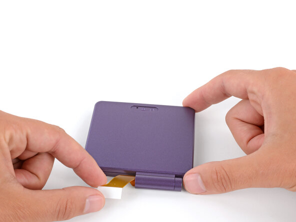

    6. How to Reshell Your Game Boy Advance SP, Loop the screen cable: crwdns2935265:037crwdnd2935265:01crwdnd2935265:01crwdne2935265:0
      • Carefully twist the screen cable to make one loop and hold it in place.

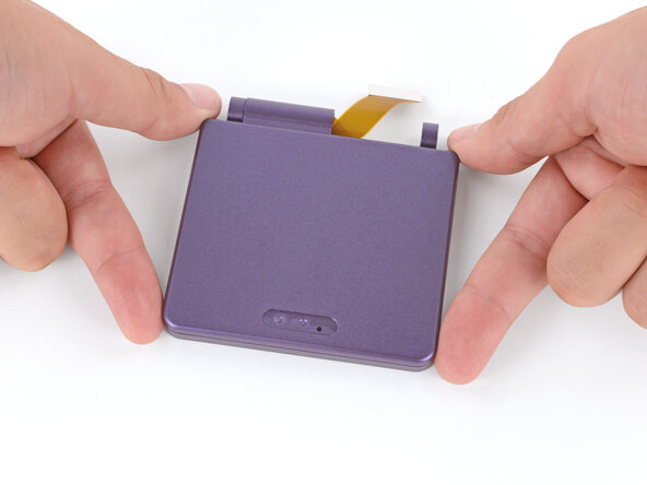

    7. How to Reshell Your Game Boy Advance SP, Install the exterior shell: crwdns2935265:038crwdnd2935265:01crwdnd2935265:02crwdne2935265:0 How to Reshell Your Game Boy Advance SP, Install the exterior shell: crwdns2935265:038crwdnd2935265:02crwdnd2935265:02crwdne2935265:0
      • While keeping the screen cable looped, use your free hand to place the exterior screen shell into place over the screen.
    8. How to Reshell Your Game Boy Advance SP, Flip the shells over: crwdns2935265:039crwdnd2935265:01crwdnd2935265:02crwdne2935265:0 How to Reshell Your Game Boy Advance SP, Flip the shells over: crwdns2935265:039crwdnd2935265:02crwdnd2935265:02crwdne2935265:0
      • Nothing is securing the shells together. Be careful not to let them separate, or the screen may fall out.
      • Hold the screen shells firmly together and flip them over so the screen is facing up.
      • Continue holding the two halves of the screen shell together for the next step.

    10. How to Reshell Your Game Boy Advance SP, Install the rubber screw covers: crwdns2935265:041crwdnd2935265:01crwdnd2935265:03crwdne2935265:0 How to Reshell Your Game Boy Advance SP, Install the rubber screw covers: crwdns2935265:041crwdnd2935265:02crwdnd2935265:03crwdne2935265:0 How to Reshell Your Game Boy Advance SP, Install the rubber screw covers: crwdns2935265:041crwdnd2935265:03crwdnd2935265:03crwdne2935265:0
      • Use your finger to install the five rubber screw covers, pushing them firmly into place.
      • These don't usually need any adhesive—they stay secured on their own.

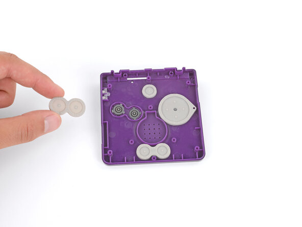

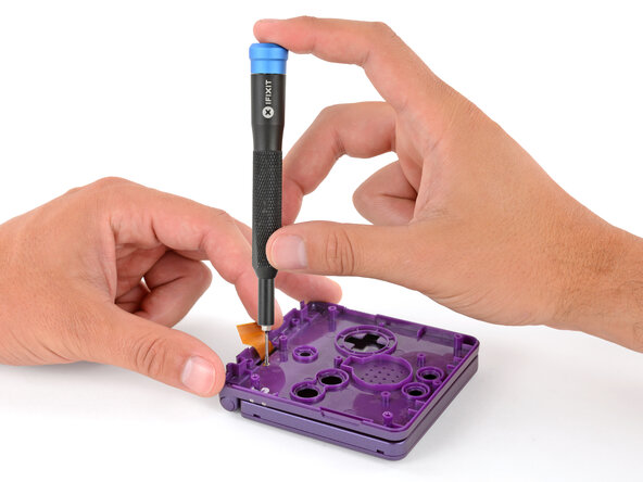

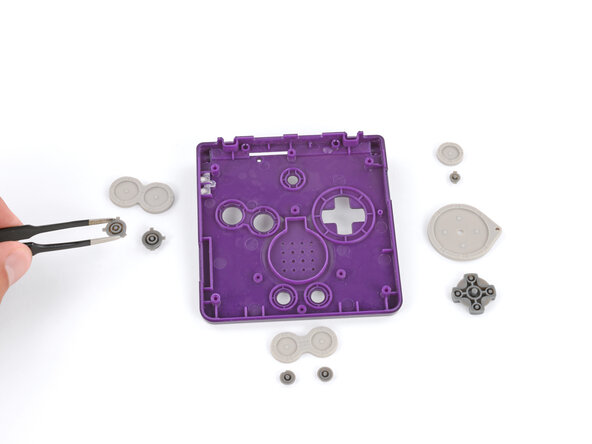

    11. How to Reshell Your Game Boy Advance SP, Remove the buttons: crwdns2935265:042crwdnd2935265:01crwdnd2935265:03crwdne2935265:0 How to Reshell Your Game Boy Advance SP, Remove the buttons: crwdns2935265:042crwdnd2935265:02crwdnd2935265:03crwdne2935265:0 How to Reshell Your Game Boy Advance SP, Remove the buttons: crwdns2935265:042crwdnd2935265:03crwdnd2935265:03crwdne2935265:0
      • If your replacement button shell has silicone pads and buttons installed, use tweezers or your fingers to remove them and set them aside for now.
      • This prevents the buttons from falling out and getting lost while you work on the shell in the next steps.

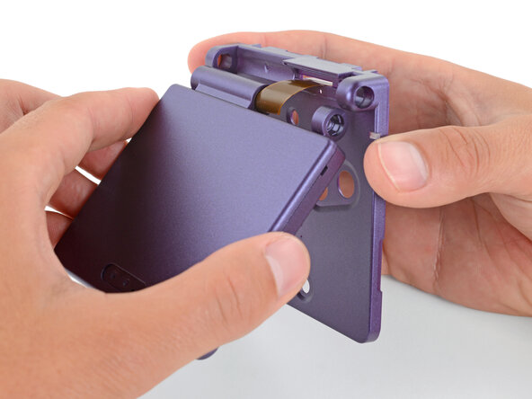

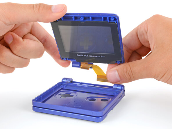

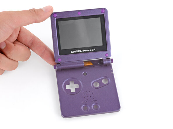

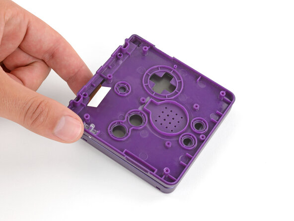

    12. How to Reshell Your Game Boy Advance SP, Fit the shells together: crwdns2935265:043crwdnd2935265:01crwdnd2935265:03crwdne2935265:0 How to Reshell Your Game Boy Advance SP, Fit the shells together: crwdns2935265:043crwdnd2935265:02crwdnd2935265:03crwdne2935265:0 How to Reshell Your Game Boy Advance SP, Fit the shells together: crwdns2935265:043crwdnd2935265:03crwdnd2935265:03crwdne2935265:0
      • Hold the screen in one hand and the button shell in the other.
      • Thread the screen cable through its cutouts, slide the hinge sockets into place, and fully close the shells together.
      • Check that the screen cable isn't pinched.

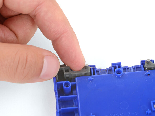

    13. How to Reshell Your Game Boy Advance SP: crwdns2935265:044crwdnd2935265:01crwdnd2935265:03crwdne2935265:0 How to Reshell Your Game Boy Advance SP: crwdns2935265:044crwdnd2935265:02crwdnd2935265:03crwdne2935265:0 How to Reshell Your Game Boy Advance SP: crwdns2935265:044crwdnd2935265:03crwdnd2935265:03crwdne2935265:0
      • Use your fingers to partially insert both hinges in their sockets, only pushing them until they stop.

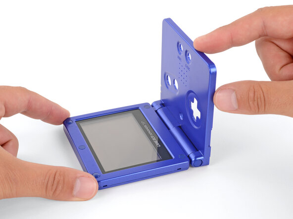

    14. How to Reshell Your Game Boy Advance SP, Fully open your Game Boy: crwdns2935265:045crwdnd2935265:01crwdnd2935265:02crwdne2935265:0 How to Reshell Your Game Boy Advance SP, Fully open your Game Boy: crwdns2935265:045crwdnd2935265:02crwdnd2935265:02crwdne2935265:0
      • Fully open your Game Boy and hold the screen in place.

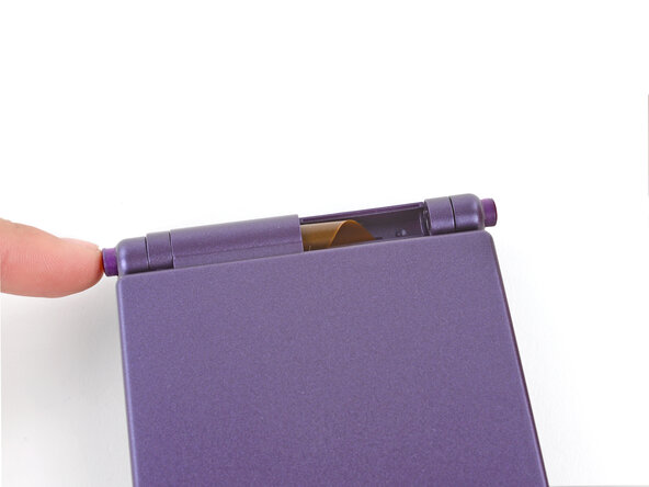

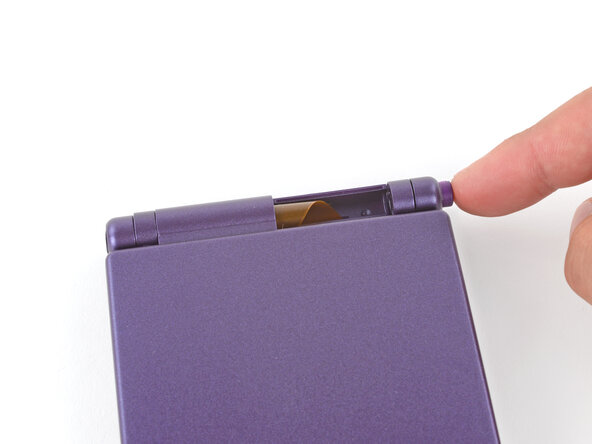

    15. How to Reshell Your Game Boy Advance SP, Install the hinges: crwdns2935265:046crwdnd2935265:01crwdnd2935265:03crwdne2935265:0 How to Reshell Your Game Boy Advance SP, Install the hinges: crwdns2935265:046crwdnd2935265:02crwdnd2935265:03crwdne2935265:0 How to Reshell Your Game Boy Advance SP, Install the hinges: crwdns2935265:046crwdnd2935265:03crwdnd2935265:03crwdne2935265:0
      • Use your finger to push the hinges fully into their sockets—they should click into place.
      • Gently open and close your Game Boy to make sure the hinges are correctly installed.

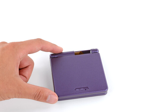

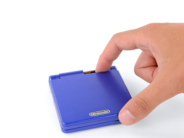

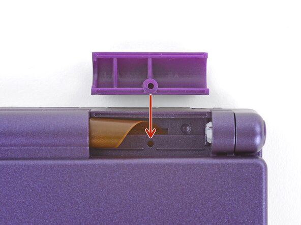

    16. How to Reshell Your Game Boy Advance SP, Close your Game Boy: crwdns2935265:047crwdnd2935265:01crwdnd2935265:02crwdne2935265:0 How to Reshell Your Game Boy Advance SP, Close your Game Boy: crwdns2935265:047crwdnd2935265:02crwdnd2935265:02crwdne2935265:0
      • Close your Game Boy.
    17. How to Reshell Your Game Boy Advance SP, Put the hinge cover into place: crwdns2935265:048crwdnd2935265:01crwdnd2935265:03crwdne2935265:0 How to Reshell Your Game Boy Advance SP, Put the hinge cover into place: crwdns2935265:048crwdnd2935265:02crwdnd2935265:03crwdne2935265:0 How to Reshell Your Game Boy Advance SP, Put the hinge cover into place: crwdns2935265:048crwdnd2935265:03crwdnd2935265:03crwdne2935265:0
      • Use your fingers to put the hinge cover into place, with the screw hole closest to the screen.
    18. How to Reshell Your Game Boy Advance SP, Flip your Game Boy over: crwdns2935265:049crwdnd2935265:01crwdnd2935265:01crwdne2935265:0
      • Hold the hinge cover and main body together and flip your Game Boy over, so the button cutouts face up.
    19. How to Reshell Your Game Boy Advance SP, Install the hinge cover screw: crwdns2935265:050crwdnd2935265:01crwdnd2935265:03crwdne2935265:0 How to Reshell Your Game Boy Advance SP, Install the hinge cover screw: crwdns2935265:050crwdnd2935265:02crwdnd2935265:03crwdne2935265:0 How to Reshell Your Game Boy Advance SP, Install the hinge cover screw: crwdns2935265:050crwdnd2935265:03crwdnd2935265:03crwdne2935265:0
      • Use a JIS 00 screwdriver to install the 6.3 mm‑long screw securing the hinge cover.
    20. How to Reshell Your Game Boy Advance SP, Transfer the LED diffuser: crwdns2935265:051crwdnd2935265:01crwdnd2935265:03crwdne2935265:0 How to Reshell Your Game Boy Advance SP, Transfer the LED diffuser: crwdns2935265:051crwdnd2935265:02crwdnd2935265:03crwdne2935265:0 How to Reshell Your Game Boy Advance SP, Transfer the LED diffuser: crwdns2935265:051crwdnd2935265:03crwdnd2935265:03crwdne2935265:0
      • If your replacement button shell doesn't have an LED diffuser installed, transfer it from your original shell to the new one.
    21. How to Reshell Your Game Boy Advance SP, Prop up the main body: crwdns2935265:052crwdnd2935265:01crwdnd2935265:03crwdne2935265:0 How to Reshell Your Game Boy Advance SP, Prop up the main body: crwdns2935265:052crwdnd2935265:02crwdnd2935265:03crwdne2935265:0 How to Reshell Your Game Boy Advance SP, Prop up the main body: crwdns2935265:052crwdnd2935265:03crwdnd2935265:03crwdne2935265:0
      • You'll need to prop up the main body of your Game Boy in order to reconnect the screen cable to the motherboard. Here are two ways to do so:
      • Option 1: Open the main body of your Game Boy to a 90‑degree angle. With the screen facing up, rest the hinges on the edge of the motherboard closest to the screen cable connector.
      • Option 2: Place the motherboard next to a sturdy object, such as a stack of books or tool case, so the side with the screen cable connector is up against it. With the Game Boy closed, prop it up so the hinges are on the motherboard and the screen cable is near its connector.
    22. How to Reshell Your Game Boy Advance SP, Connect the screen cable: crwdns2935265:053crwdnd2935265:01crwdnd2935265:02crwdne2935265:0 How to Reshell Your Game Boy Advance SP, Connect the screen cable: crwdns2935265:053crwdnd2935265:02crwdnd2935265:02crwdne2935265:0
      • Before inserting the screen cable, make sure both sides of the connector's tab are pushed into the unlocked position.
      • Use a pair of tweezers to slide the screen cable fully into its connector.
    23. How to Reshell Your Game Boy Advance SP: crwdns2935265:054crwdnd2935265:01crwdnd2935265:03crwdne2935265:0 How to Reshell Your Game Boy Advance SP: crwdns2935265:054crwdnd2935265:02crwdnd2935265:03crwdne2935265:0 How to Reshell Your Game Boy Advance SP: crwdns2935265:054crwdnd2935265:03crwdnd2935265:03crwdne2935265:0
      • With one hand, hold the screen cable in place with a pair of tweezers—make sure it's fully inserted in the connector.
      • The screen cable will tend to slide out of its socket since there's very little slack. If it slides out slightly, your screen may not work.
      • With your free hand, use the point of a spudger to push both sides of the connector's tab into the locked position.
    24. How to Reshell Your Game Boy Advance SP, Flip the main body over: crwdns2935265:055crwdnd2935265:01crwdnd2935265:01crwdne2935265:0
      • Be careful when repositioning your Game Boy. The motherboard is only attached by the screen cable—don't strain the cable.
      • With the Game Boy closed, place it screen-down on your work surface.
      • Place a sturdy object along the edge of your Game Boy with the hinges.
    25. How to Reshell Your Game Boy Advance SP, Install the speaker: crwdns2935265:056crwdnd2935265:01crwdnd2935265:03crwdne2935265:0 How to Reshell Your Game Boy Advance SP, Install the speaker: crwdns2935265:056crwdnd2935265:02crwdnd2935265:03crwdne2935265:0 How to Reshell Your Game Boy Advance SP, Install the speaker: crwdns2935265:056crwdnd2935265:03crwdnd2935265:03crwdne2935265:0
      • Place the speaker mesh into the speaker recess.
      • With the gold spring contacts facing up, place the speaker into its recess.
    26. How to Reshell Your Game Boy Advance SP, Install the buttons and silicone pads: crwdns2935265:057crwdnd2935265:01crwdnd2935265:03crwdne2935265:0 How to Reshell Your Game Boy Advance SP, Install the buttons and silicone pads: crwdns2935265:057crwdnd2935265:02crwdnd2935265:03crwdne2935265:0 How to Reshell Your Game Boy Advance SP, Install the buttons and silicone pads: crwdns2935265:057crwdnd2935265:03crwdnd2935265:03crwdne2935265:0
      • Use tweezers or your fingers to place all the buttons into their recesses.
      • The action and brightness buttons are keyed specifically for their recesses and proper orientation.
      • Lay the four silicone pads into place over the buttons.
    27. How to Reshell Your Game Boy Advance SP, Lay the motherboard down: crwdns2935265:058crwdnd2935265:01crwdnd2935265:02crwdne2935265:0 How to Reshell Your Game Boy Advance SP, Lay the motherboard down: crwdns2935265:058crwdnd2935265:02crwdnd2935265:02crwdne2935265:0
      • Use your fingers to gently lower the motherboard into place, making sure all the screw posts go through their cutouts.
    28. How to Reshell Your Game Boy Advance SP, Install the motherboard screws: crwdns2935265:059crwdnd2935265:01crwdnd2935265:02crwdne2935265:0 How to Reshell Your Game Boy Advance SP, Install the motherboard screws: crwdns2935265:059crwdnd2935265:02crwdnd2935265:02crwdne2935265:0
      • If your kit includes replacement screws, install them during reassembly. The screw lengths or bit sizes may vary slightly—use the quantity of each type to determine placement, keeping in mind that each set may include an extra screw.
      • Use a JIS 00 screwdriver to install the three 4.1 mm‑long screws securing the motherboard.

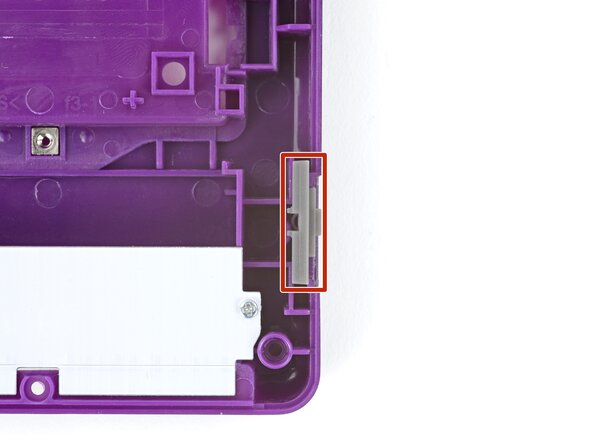

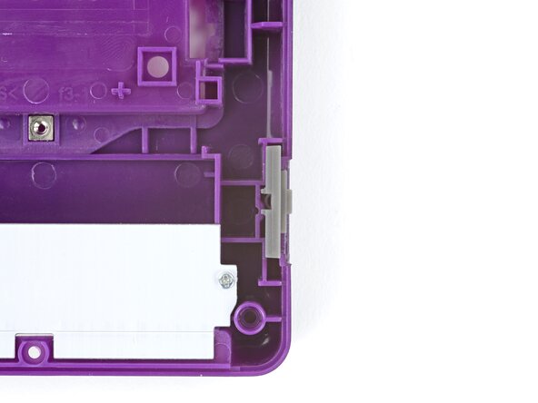

    29. How to Reshell Your Game Boy Advance SP, Remove the power switch cover: crwdns2935265:060crwdnd2935265:01crwdnd2935265:02crwdne2935265:0 How to Reshell Your Game Boy Advance SP, Remove the power switch cover: crwdns2935265:060crwdnd2935265:02crwdnd2935265:02crwdne2935265:0
      • If the power switch cover is preinstalled in the new bottom shell, remove it—you'll install it in the next step.
      • The cover needs to be aligned properly over its switch, which is much easier to do with your fingers rather than trying to align it while putting the bottom shell on.
    30. How to Reshell Your Game Boy Advance SP, Install the power switch cover: crwdns2935265:061crwdnd2935265:01crwdnd2935265:03crwdne2935265:0 How to Reshell Your Game Boy Advance SP, Install the power switch cover: crwdns2935265:061crwdnd2935265:02crwdnd2935265:03crwdne2935265:0 How to Reshell Your Game Boy Advance SP, Install the power switch cover: crwdns2935265:061crwdnd2935265:03crwdnd2935265:03crwdne2935265:0
      • Use your fingers to put the power switch cover (notched side up) into place so the cutout goes around the actual switch.
      • Gently slide the cover back and forth to make sure it's positioned properly and moving the switch.
      • If the switch isn't properly in its cutout, you won't be able to power on your Game Boy.

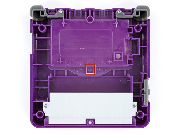

    31. How to Reshell Your Game Boy Advance SP, Bottom shell components: crwdns2935265:062crwdnd2935265:01crwdnd2935265:03crwdne2935265:0 How to Reshell Your Game Boy Advance SP, Bottom shell components: crwdns2935265:062crwdnd2935265:02crwdnd2935265:03crwdne2935265:0 How to Reshell Your Game Boy Advance SP, Bottom shell components: crwdns2935265:062crwdnd2935265:03crwdnd2935265:03crwdne2935265:0

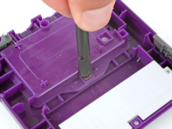

      • The bottom shell needs the small, metal captive nut/screw boss installed in the center for the battery cover screw to go into. Your kit may come with a new one, or you may need to transfer the one from your original shell.
      • Use tweezers to place the captive nut into its recess in the center of the bottom shell.
      • Use the flat end of a spudger to firmly push the nut fully into its recess.
      • This may require some force. Don't push too hard, or you may damage the shell.

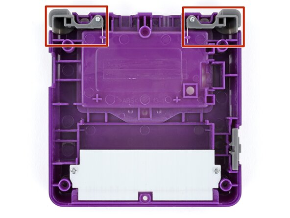

    32. How to Reshell Your Game Boy Advance SP, Install the shoulder buttons: crwdns2935265:063crwdnd2935265:01crwdnd2935265:03crwdne2935265:0 How to Reshell Your Game Boy Advance SP, Install the shoulder buttons: crwdns2935265:063crwdnd2935265:02crwdnd2935265:03crwdne2935265:0 How to Reshell Your Game Boy Advance SP, Install the shoulder buttons: crwdns2935265:063crwdnd2935265:03crwdnd2935265:03crwdne2935265:0
      • If shoulder buttons aren't already installed in your bottom shell, follow this guide to install them.

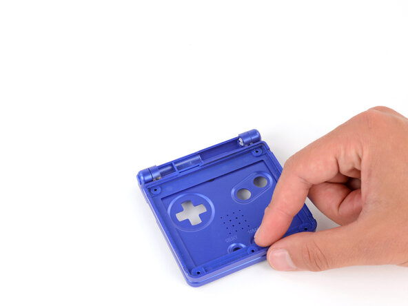

    33. How to Reshell Your Game Boy Advance SP, Put the bottom shell on: crwdns2935265:064crwdnd2935265:01crwdnd2935265:02crwdne2935265:0 How to Reshell Your Game Boy Advance SP, Put the bottom shell on: crwdns2935265:064crwdnd2935265:02crwdnd2935265:02crwdne2935265:0
      • Place the bottom shell onto your Game Boy, making sure the shoulder buttons and power switch cover correctly slot into place.
      • While holding the shells together, test the shoulder buttons. If something doesn't feel right, remove the bottom shell and re‑seat it.
    34. How to Reshell Your Game Boy Advance SP, Install the bottom shell screws: crwdns2935265:065crwdnd2935265:01crwdnd2935265:02crwdne2935265:0 How to Reshell Your Game Boy Advance SP, Install the bottom shell screws: crwdns2935265:065crwdnd2935265:02crwdnd2935265:02crwdne2935265:0
      • Use a tri‑point Y0 screwdriver to install the six screws securing the bottom shell:
    35. How to Reshell Your Game Boy Advance SP, Install the battery: crwdns2935265:066crwdnd2935265:01crwdnd2935265:03crwdne2935265:0 How to Reshell Your Game Boy Advance SP, Install the battery: crwdns2935265:066crwdnd2935265:02crwdnd2935265:03crwdne2935265:0 How to Reshell Your Game Boy Advance SP, Install the battery: crwdns2935265:066crwdnd2935265:03crwdnd2935265:03crwdne2935265:0
      • Some Game Boy Advance SP batteries are hard shell, and some are soft shell. Soft shell batteries will come with a plastic perimeter—don't try to remove it.
      • Insert the edge of the battery with contacts at a slight downward angle—aligning the contacts with their prongs in the recess—and press the battery into place.
    36. How to Reshell Your Game Boy Advance SP, Install the battery cover: crwdns2935265:067crwdnd2935265:01crwdnd2935265:03crwdne2935265:0 How to Reshell Your Game Boy Advance SP, Install the battery cover: crwdns2935265:067crwdnd2935265:02crwdnd2935265:03crwdne2935265:0 How to Reshell Your Game Boy Advance SP, Install the battery cover: crwdns2935265:067crwdnd2935265:03crwdnd2935265:03crwdne2935265:0
      • Slide the small tabs on the long edge of the battery into their cutouts and lay the cover into place.
    37. How to Reshell Your Game Boy Advance SP, Tighten the battery cover screw: crwdns2935265:068crwdnd2935265:01crwdnd2935265:02crwdne2935265:0 How to Reshell Your Game Boy Advance SP, Tighten the battery cover screw: crwdns2935265:068crwdnd2935265:02crwdnd2935265:02crwdne2935265:0
      • Use a JIS 00 screwdriver to tighten the captive screw securing the battery cover.

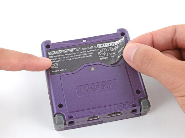

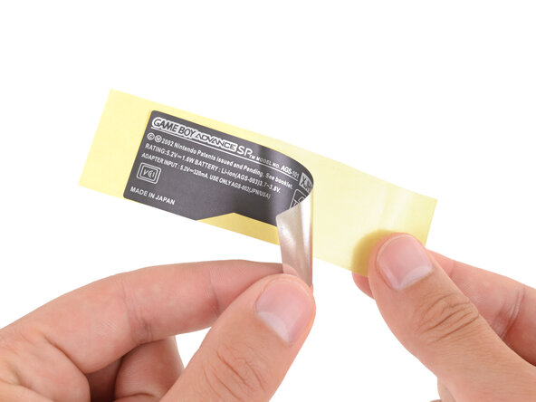

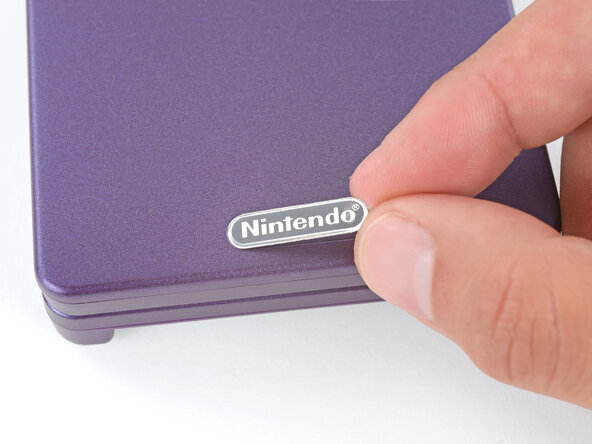

    38. How to Reshell Your Game Boy Advance SP, Apply new stickers: crwdns2935265:069crwdnd2935265:01crwdnd2935265:03crwdne2935265:0 How to Reshell Your Game Boy Advance SP, Apply new stickers: crwdns2935265:069crwdnd2935265:02crwdnd2935265:03crwdne2935265:0 How to Reshell Your Game Boy Advance SP, Apply new stickers: crwdns2935265:069crwdnd2935265:03crwdnd2935265:03crwdne2935265:0
      • If your kit comes with replacement stickers, peel them off their liners, align them, and press them into place.

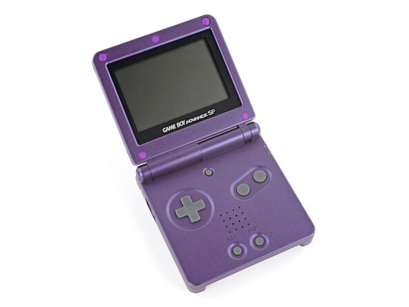

    39. How to Reshell Your Game Boy Advance SP, You're done!: crwdns2935265:070crwdnd2935265:01crwdnd2935265:03crwdne2935265:0 How to Reshell Your Game Boy Advance SP, You're done!: crwdns2935265:070crwdnd2935265:02crwdnd2935265:03crwdne2935265:0 How to Reshell Your Game Boy Advance SP, You're done!: crwdns2935265:070crwdnd2935265:03crwdnd2935265:03crwdne2935265:0
      • Flip the power switch into the On position and get to gaming!
      • That Game Boy startup really brings back some nostalgia…ours also somehow summoned Suction‑Cups‑For‑Feet Clampy...weird.
Congratulations on reshelling your Game Boy Advance SP!
