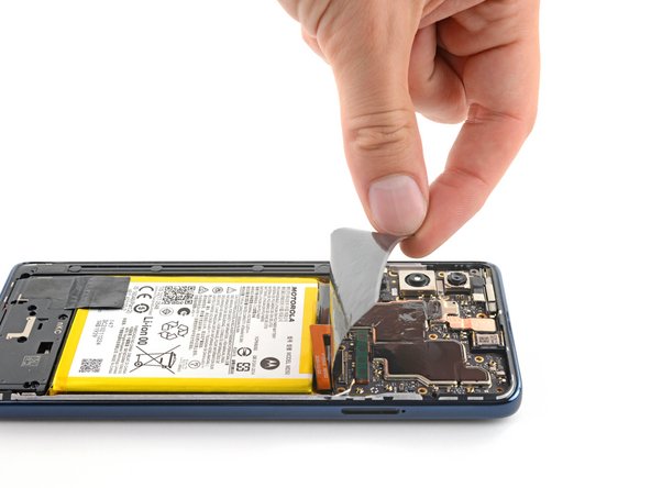

  11. Motorola Moto G Stylus 5G (2022) Screen Replacement, Remove the back cover: crwdns2935265:011crwdnd2935265:01crwdnd2935265:03crwdne2935265:0 Motorola Moto G Stylus 5G (2022) Screen Replacement, Remove the back cover: crwdns2935265:011crwdnd2935265:02crwdnd2935265:03crwdne2935265:0 Motorola Moto G Stylus 5G (2022) Screen Replacement, Remove the back cover: crwdns2935265:011crwdnd2935265:03crwdnd2935265:03crwdne2935265:0
    • Grab and remove the back cover by lifting it away from the phone.
    • If your back cover is still sticking to the frame, slide the pick around the edges of the phone to slice through any remaining adhesive.

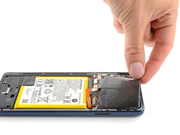

  17. Motorola Moto G Stylus 5G (2022) Screen Replacement, Remove the motherboard cover: crwdns2935265:017crwdnd2935265:01crwdnd2935265:02crwdne2935265:0 Motorola Moto G Stylus 5G (2022) Screen Replacement, Remove the motherboard cover: crwdns2935265:017crwdnd2935265:02crwdnd2935265:02crwdne2935265:0
    • Grip the right edge of the cover and pull it off the motherboard.

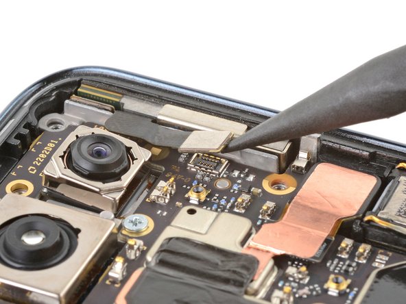

  20. Motorola Moto G Stylus 5G (2022) Screen Replacement, Disconnect the antenna cable: crwdns2935265:020crwdnd2935265:01crwdnd2935265:02crwdne2935265:0 Motorola Moto G Stylus 5G (2022) Screen Replacement, Disconnect the antenna cable: crwdns2935265:020crwdnd2935265:02crwdnd2935265:02crwdne2935265:0
    • Use the pointed end of your spudger to pry and disconnect the white antenna cable.
    • Pry on only the metal head of the connector. Avoid lifting the cable itself as much as possible.
    • During reassembly, these can be tricky to reconnect. Hold the connector in place over its socket and press down with the flat end of a spudger. The connector should snap into place.

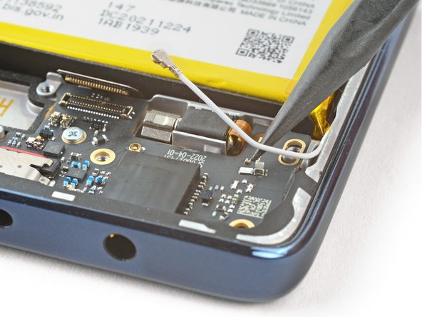

  22. Motorola Moto G Stylus 5G (2022) Screen Replacement, Disconnect the upper 5G mmWave antenna: crwdns2935265:022crwdnd2935265:01crwdnd2935265:02crwdne2935265:0 Motorola Moto G Stylus 5G (2022) Screen Replacement, Disconnect the upper 5G mmWave antenna: crwdns2935265:022crwdnd2935265:02crwdnd2935265:02crwdne2935265:0
    • Use the pointed end of a spudger to pry up and disconnect the 5G mmWave antenna's press connector.

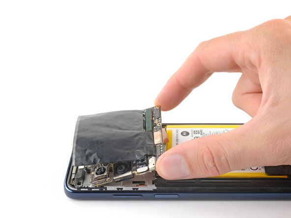

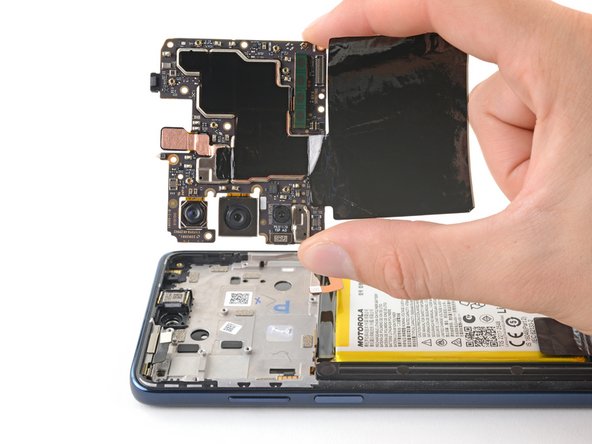

  25. Motorola Moto G Stylus 5G (2022) Screen Replacement, Remove the motherboard: crwdns2935265:025crwdnd2935265:01crwdnd2935265:03crwdne2935265:0 Motorola Moto G Stylus 5G (2022) Screen Replacement, Remove the motherboard: crwdns2935265:025crwdnd2935265:02crwdnd2935265:03crwdne2935265:0 Motorola Moto G Stylus 5G (2022) Screen Replacement, Remove the motherboard: crwdns2935265:025crwdnd2935265:03crwdnd2935265:03crwdne2935265:0
    • Grab the motherboard from the bottom edge and lift it from its recess.
    • Be sure the loose cables don't catch on the motherboard as it's removed.
    • During reassembly, make sure no cables or connectors become trapped underneath the motherboard.

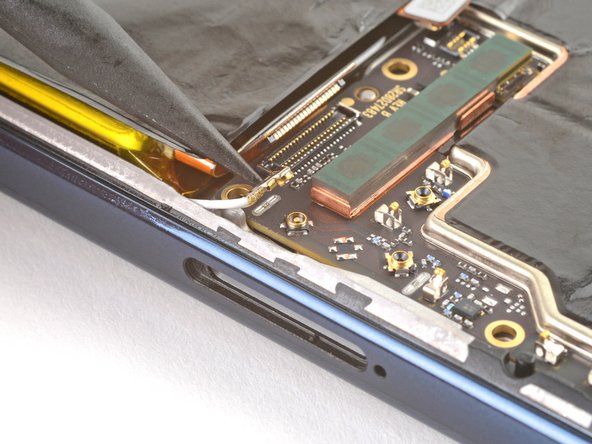

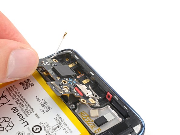

  29. Motorola Moto G Stylus 5G (2022) Screen Replacement, Disconnect the board connector: crwdns2935265:029crwdnd2935265:01crwdnd2935265:02crwdne2935265:0 Motorola Moto G Stylus 5G (2022) Screen Replacement, Disconnect the board connector: crwdns2935265:029crwdnd2935265:02crwdnd2935265:02crwdne2935265:0
    • Use the point of a spudger to pry and disconnect the daughterboard cable's press connector.

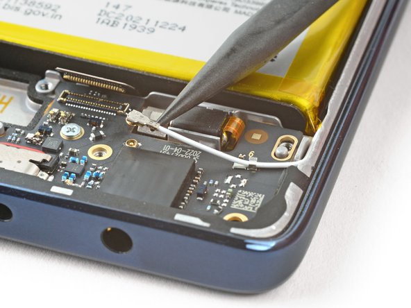

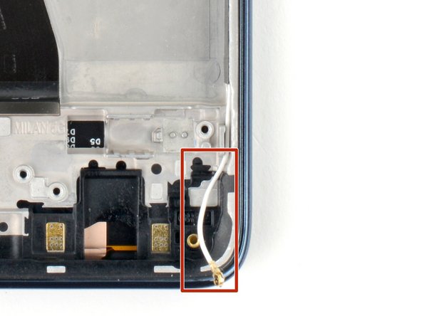

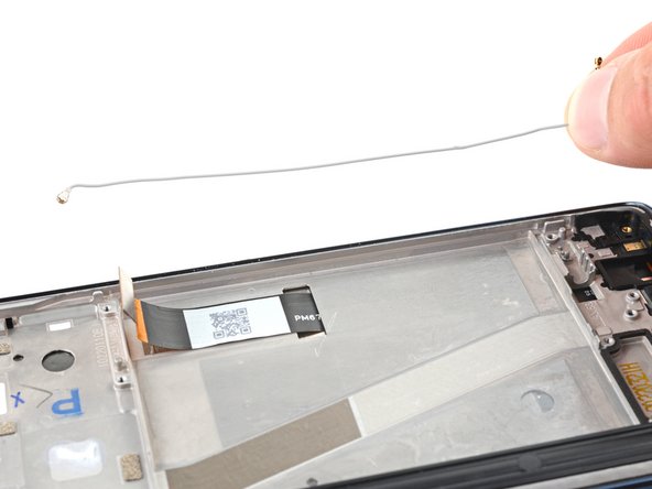

  30. Motorola Moto G Stylus 5G (2022) Screen Replacement, Disconnect the antenna cable: crwdns2935265:030crwdnd2935265:01crwdnd2935265:03crwdne2935265:0 Motorola Moto G Stylus 5G (2022) Screen Replacement, Disconnect the antenna cable: crwdns2935265:030crwdnd2935265:02crwdnd2935265:03crwdne2935265:0 Motorola Moto G Stylus 5G (2022) Screen Replacement, Disconnect the antenna cable: crwdns2935265:030crwdnd2935265:03crwdnd2935265:03crwdne2935265:0
    • Use the point of your spudger to pry and disconnect the white antenna cable.
    • Free the cable from the clip in the top-right of the daughterboard.
    • During reassembly, be sure to secure the cable to the clip in the daughterboard.

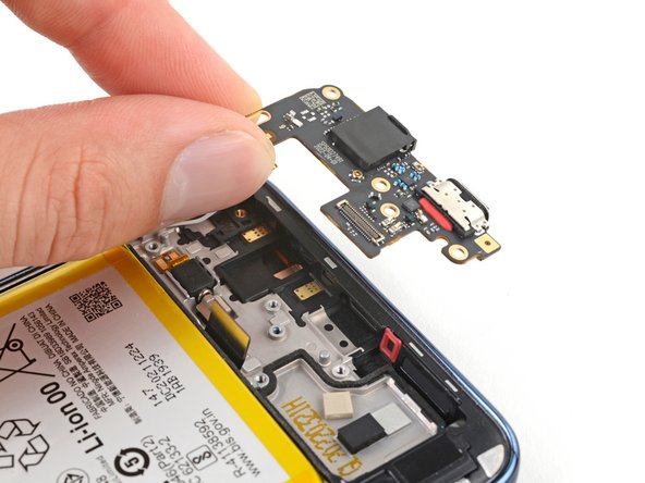

  31. Motorola Moto G Stylus 5G (2022) Screen Replacement, Unfasten the daughterboard: crwdns2935265:031crwdnd2935265:01crwdnd2935265:01crwdne2935265:0
    • Use a Phillips screwdriver to remove the 3 mm-long screw securing the daughterboard.
  32. Motorola Moto G Stylus 5G (2022) Screen Replacement, Remove the daughterboard: crwdns2935265:032crwdnd2935265:01crwdnd2935265:03crwdne2935265:0 Motorola Moto G Stylus 5G (2022) Screen Replacement, Remove the daughterboard: crwdns2935265:032crwdnd2935265:02crwdnd2935265:03crwdne2935265:0 Motorola Moto G Stylus 5G (2022) Screen Replacement, Remove the daughterboard: crwdns2935265:032crwdnd2935265:03crwdnd2935265:03crwdne2935265:0
    • Grab and lift the top edge of the daughterboard.
    • Make sure the daughterboard doesn't snag on any loose cables as you lift it out.
    • Remove the daughterboard from its recess.

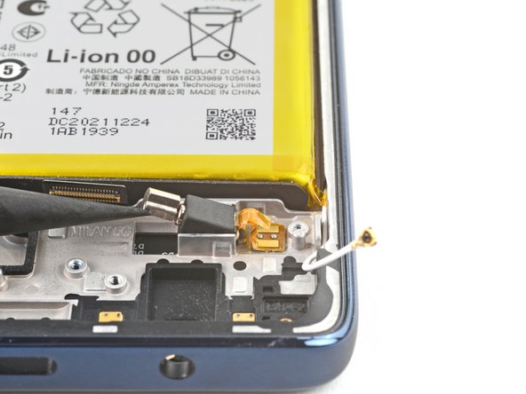

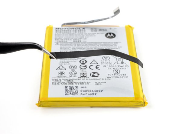

  33. Motorola Moto G Stylus 5G (2022) Screen Replacement, Soften the adhesive: crwdns2935265:033crwdnd2935265:01crwdnd2935265:02crwdne2935265:0 Motorola Moto G Stylus 5G (2022) Screen Replacement, Soften the adhesive: crwdns2935265:033crwdnd2935265:02crwdnd2935265:02crwdne2935265:0
    • The vibration motor cable is strongly adhered to the frame. Before attempting to peel it, follow this step to weaken the adhesive securing it.
    • Apply highly-concentrated isopropyl alcohol (over 90%) to the flex cable.
    • Alternatively, use a heated iOpener, hair dryer, or heat gun to soften the adhesive.
    • Use caution to not overheat the battery or surrounding components.

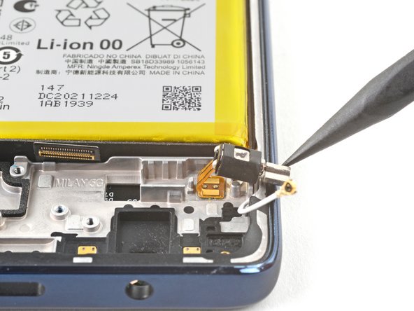

  34. Motorola Moto G Stylus 5G (2022) Screen Replacement, Reposition the vibration motor: crwdns2935265:034crwdnd2935265:01crwdnd2935265:03crwdne2935265:0 Motorola Moto G Stylus 5G (2022) Screen Replacement, Reposition the vibration motor: crwdns2935265:034crwdnd2935265:02crwdnd2935265:03crwdne2935265:0 Motorola Moto G Stylus 5G (2022) Screen Replacement, Reposition the vibration motor: crwdns2935265:034crwdnd2935265:03crwdnd2935265:03crwdne2935265:0
    • While you wait for the adhesive to soften, remove the vibration motor from its recess:
    • Insert the point of your spudger between the motor counterweight and the frame.
    • Pry the motor out of its recess and flip it to the right.
  35. Motorola Moto G Stylus 5G (2022) Screen Replacement, Remove the vibration motor: crwdns2935265:035crwdnd2935265:01crwdnd2935265:03crwdne2935265:0 Motorola Moto G Stylus 5G (2022) Screen Replacement, Remove the vibration motor: crwdns2935265:035crwdnd2935265:02crwdnd2935265:03crwdne2935265:0 Motorola Moto G Stylus 5G (2022) Screen Replacement, Remove the vibration motor: crwdns2935265:035crwdnd2935265:03crwdnd2935265:03crwdne2935265:0
    • The vibration motor's flex cable is very fragile. Work slowly to prevent tearing the cable.
    • With blunt nose tweezers, grab the base of the flex cable as close to the frame as possible.
    • Slowly and steadily peel the cable from the frame.
    • If the cable feels stuck or re-adheres, apply more isopropyl alcohol or heat.
    • Remove the vibration motor from the frame.
    • Apply new adhesive to your vibration motor before installing it in the frame.

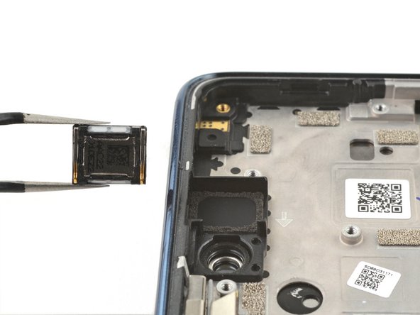

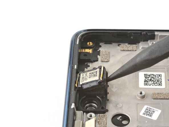

  36. Motorola Moto G Stylus 5G (2022) Screen Replacement, Remove the earpiece speaker: crwdns2935265:036crwdnd2935265:01crwdnd2935265:03crwdne2935265:0 Motorola Moto G Stylus 5G (2022) Screen Replacement, Remove the earpiece speaker: crwdns2935265:036crwdnd2935265:02crwdnd2935265:03crwdne2935265:0 Motorola Moto G Stylus 5G (2022) Screen Replacement, Remove the earpiece speaker: crwdns2935265:036crwdnd2935265:03crwdnd2935265:03crwdne2935265:0
    • Use the pointed end of a spudger to pry the bottom edge of the earpiece speaker up out of the frame.
    • Remove the earpiece speaker from its recess.
    • During reassembly, orient the speaker so the raised sides of the connectors are closest to the front-facing camera.

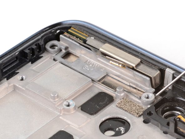

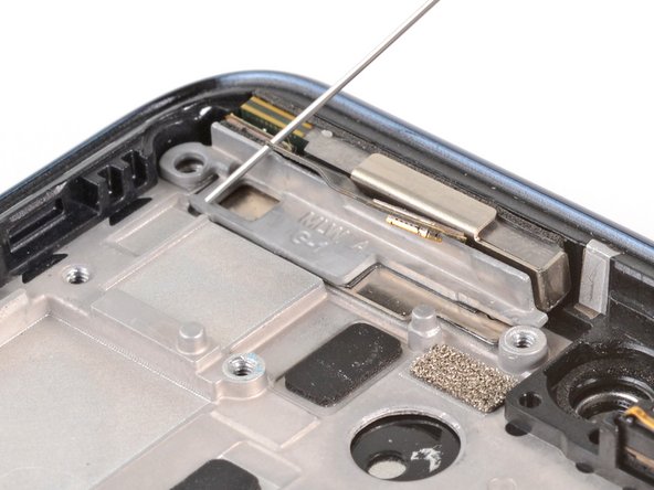

  37. Motorola Moto G Stylus 5G (2022) Screen Replacement, Soften the antenna bracket's adhesive: crwdns2935265:037crwdnd2935265:01crwdnd2935265:03crwdne2935265:0 Motorola Moto G Stylus 5G (2022) Screen Replacement, Soften the antenna bracket's adhesive: crwdns2935265:037crwdnd2935265:02crwdnd2935265:03crwdne2935265:0 Motorola Moto G Stylus 5G (2022) Screen Replacement, Soften the antenna bracket's adhesive: crwdns2935265:037crwdnd2935265:03crwdnd2935265:03crwdne2935265:0
    • Heat an iOpener and apply it to the antenna bracket in the upper left of the frame for two minutes.
    • A hair dryer or heat gun may also be used, but be careful not to overheat the phone—the display and internal battery are both susceptible to heat damage.
    • Alternatively, use highly-concentrated isopropyl alcohol (over 90%) between the bracket and upper left of the frame.
  38. Motorola Moto G Stylus 5G (2022) Screen Replacement, Remove the 5G mmWave antenna bracket: crwdns2935265:038crwdnd2935265:01crwdnd2935265:03crwdne2935265:0 Motorola Moto G Stylus 5G (2022) Screen Replacement, Remove the 5G mmWave antenna bracket: crwdns2935265:038crwdnd2935265:02crwdnd2935265:03crwdne2935265:0 Motorola Moto G Stylus 5G (2022) Screen Replacement, Remove the 5G mmWave antenna bracket: crwdns2935265:038crwdnd2935265:03crwdnd2935265:03crwdne2935265:0
    • Insert the pointed end of a spudger between the right side of the 5G mmWave antenna bracket and the frame.
    • Pry up the bracket.
    • A strong metal tape holds the bracket to the frame. Work slowly to avoid tearing this adhesive tape.
    • Remove the bracket from its recess.
    • During reassembly, remove the old adhesive from the bracket and frame, then apply new adhesive.
  39. Motorola Moto G Stylus 5G (2022) Screen Replacement, Soften the adhesive with heat: crwdns2935265:039crwdnd2935265:01crwdnd2935265:01crwdne2935265:0
    • Heat an iOpener and apply it to the left edge of the screen for two minutes.
    • A hair dryer, heat gun, or hot plate may also be used, but be careful not to overheat the phone—the display and internal battery are both susceptible to heat damage.
  40. Motorola Moto G Stylus 5G (2022) Screen Replacement, Soften the adhesive with isopropyl alcohol: crwdns2935265:040crwdnd2935265:01crwdnd2935265:02crwdne2935265:0 Motorola Moto G Stylus 5G (2022) Screen Replacement, Soften the adhesive with isopropyl alcohol: crwdns2935265:040crwdnd2935265:02crwdnd2935265:02crwdne2935265:0
    • Additionally, you may use highly-concentrated isopropyl alcohol (over 90%) to further loosen the adhesive securing the battery.
    • Apply the isopropyl alcohol into the gaps between the sides of the battery and the frame.
    • Wait one minute to allow the isopropyl alcohol to penetrate.

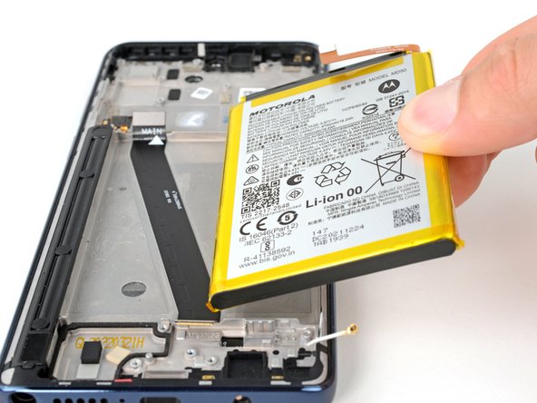

  41. Motorola Moto G Stylus 5G (2022) Screen Replacement, Pry the battery: crwdns2935265:041crwdnd2935265:01crwdnd2935265:03crwdne2935265:0 Motorola Moto G Stylus 5G (2022) Screen Replacement, Pry the battery: crwdns2935265:041crwdnd2935265:02crwdnd2935265:03crwdne2935265:0 Motorola Moto G Stylus 5G (2022) Screen Replacement, Pry the battery: crwdns2935265:041crwdnd2935265:03crwdnd2935265:03crwdne2935265:0
    • Place a suction handle on the center of the battery.
    • Insert an opening pick between the right edge of the battery and the frame.
    • Use a steady force to pull on the suction handle and simultaneously pry with the pick.
    • Don't use excessive force on the battery. Slow, consistent pressure is all that is required to free it from the frame.
    • Apply more isopropyl alcohol if the battery re-adheres.
  42. Motorola Moto G Stylus 5G (2022) Screen Replacement, Remove the battery: crwdns2935265:042crwdnd2935265:01crwdnd2935265:02crwdne2935265:0 Motorola Moto G Stylus 5G (2022) Screen Replacement, Remove the battery: crwdns2935265:042crwdnd2935265:02crwdnd2935265:02crwdne2935265:0
    • Remove the battery from its recess.
    • Don't reinstall a damaged or deformed battery, as doing so is a potential safety hazard.
    • Use this guide to install a battery with custom-cut adhesives, or use this guide to install a battery with an adhesive sheet.

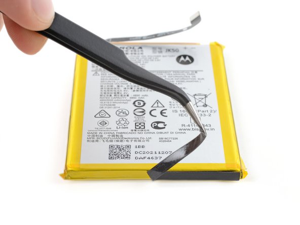

  43. Motorola Moto G Stylus 5G (2022) Screen Replacement, Remove the foam strip: crwdns2935265:043crwdnd2935265:01crwdnd2935265:03crwdne2935265:0 Motorola Moto G Stylus 5G (2022) Screen Replacement, Remove the foam strip: crwdns2935265:043crwdnd2935265:02crwdnd2935265:03crwdne2935265:0 Motorola Moto G Stylus 5G (2022) Screen Replacement, Remove the foam strip: crwdns2935265:043crwdnd2935265:03crwdnd2935265:03crwdne2935265:0
    • If you're reusing your old battery, skip this step.
    • Peel and remove the foam strip from the bottom of the battery.
    • Apply the foam strip onto your new battery.

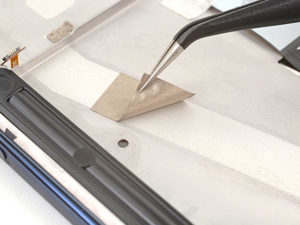

  45. Motorola Moto G Stylus 5G (2022) Screen Replacement, Remove the board cable: crwdns2935265:045crwdnd2935265:01crwdnd2935265:03crwdne2935265:0 Motorola Moto G Stylus 5G (2022) Screen Replacement, Remove the board cable: crwdns2935265:045crwdnd2935265:02crwdnd2935265:03crwdne2935265:0 Motorola Moto G Stylus 5G (2022) Screen Replacement, Remove the board cable: crwdns2935265:045crwdnd2935265:03crwdnd2935265:03crwdne2935265:0
    • Peel and remove the board cable from the frame.
    • Don't fold or sharply bend the cable.

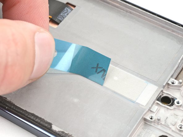

  46. Motorola Moto G Stylus 5G (2022) Screen Replacement, Reassembly information: crwdns2935265:046crwdnd2935265:01crwdnd2935265:03crwdne2935265:0 Motorola Moto G Stylus 5G (2022) Screen Replacement, Reassembly information: crwdns2935265:046crwdnd2935265:02crwdnd2935265:03crwdne2935265:0 Motorola Moto G Stylus 5G (2022) Screen Replacement, Reassembly information: crwdns2935265:046crwdnd2935265:03crwdnd2935265:03crwdne2935265:0
    • This step shows how to replace the conductive adhesive for the board cable during reassembly. If your frame has this adhesive preinstalled, skip this step.
    • If necessary, cut the adhesive blocks to fit into contours of the cable channel. The adhesive doesn't need fit the contours perfectly.
    • Peel the adhesive blocks from the adhesive sheet.
    • Place the adhesives in the board cable channel. Space them evenly through the channel.
    • Peel any remaining plastic liners to expose the adhesive.

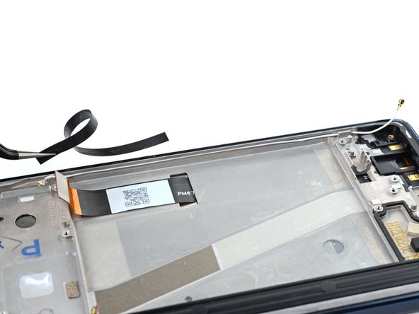

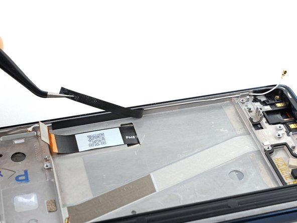

  47. Motorola Moto G Stylus 5G (2022) Screen Replacement, Remove the antenna cable tape: crwdns2935265:047crwdnd2935265:01crwdnd2935265:03crwdne2935265:0 Motorola Moto G Stylus 5G (2022) Screen Replacement, Remove the antenna cable tape: crwdns2935265:047crwdnd2935265:02crwdnd2935265:03crwdne2935265:0 Motorola Moto G Stylus 5G (2022) Screen Replacement, Remove the antenna cable tape: crwdns2935265:047crwdnd2935265:03crwdnd2935265:03crwdne2935265:0
    • Use your tweezers to peel and remove the black tape securing the antenna cable.
    • During reassembly, you may reuse the tape if the adhesive is intact. If not, follow this guide to use a pre-cut adhesive strip instead.
  48. Motorola Moto G Stylus 5G (2022) Screen Replacement, Reassembly information: crwdns2935265:048crwdnd2935265:01crwdnd2935265:02crwdne2935265:0 Motorola Moto G Stylus 5G (2022) Screen Replacement, Reassembly information: crwdns2935265:048crwdnd2935265:02crwdnd2935265:02crwdne2935265:0
    • The extra antenna cable length on either side of the frame is very important for its alignment.
    • Leave no extra length in the cable where it connects to the motherboard, and all of its available length to the daughterboard.
  49. Motorola Moto G Stylus 5G (2022) Screen Replacement, Remove the antenna cable: crwdns2935265:049crwdnd2935265:01crwdnd2935265:02crwdne2935265:0 Motorola Moto G Stylus 5G (2022) Screen Replacement, Remove the antenna cable: crwdns2935265:049crwdnd2935265:02crwdnd2935265:02crwdne2935265:0
    • Grab and lift the antenna cable from the frame.
  50. Motorola Moto G Stylus 5G (2022) Screen Replacement: crwdns2935265:050crwdnd2935265:01crwdnd2935265:01crwdne2935265:0
    • The screen is all that remains.
Compare your new replacement part to the original part—be sure to transfer remaining components and remove adhesive backings from the new part before installing.
