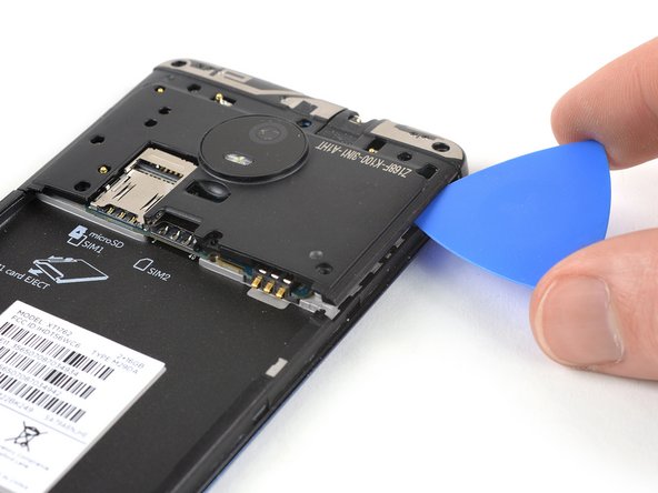

  7. Motorola Moto E4 Screen Assembly Replacement: crwdns2935265:07crwdnd2935265:01crwdnd2935265:02crwdne2935265:0 Motorola Moto E4 Screen Assembly Replacement: crwdns2935265:07crwdnd2935265:02crwdnd2935265:02crwdne2935265:0
    • Insert an opening pick between the cover and the motherboard at the bottom right corner.
    • Slide the opening pick upwards to open the plastic clips.
  8. Motorola Moto E4 Screen Assembly Replacement: crwdns2935265:08crwdnd2935265:01crwdnd2935265:02crwdne2935265:0 Motorola Moto E4 Screen Assembly Replacement: crwdns2935265:08crwdnd2935265:02crwdnd2935265:02crwdne2935265:0
    • Insert an opening pick between the cover and the motherboard at the bottom left corner.
    • Pry up the motherboard cover by twisting the opening pick.

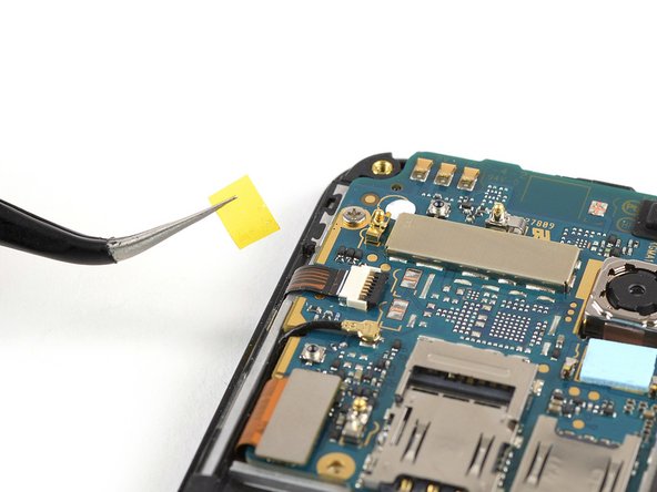

  10. Motorola Moto E4 Screen Assembly Replacement, Motherboard Assembly: crwdns2935265:010crwdnd2935265:01crwdnd2935265:02crwdne2935265:0 Motorola Moto E4 Screen Assembly Replacement, Motherboard Assembly: crwdns2935265:010crwdnd2935265:02crwdnd2935265:02crwdne2935265:0
    • Use a pair of tweezers to peel off the yellow tape of the ZIF connector located on the left of the motherboard.

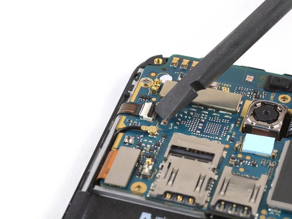

  11. Motorola Moto E4 Screen Assembly Replacement: crwdns2935265:011crwdnd2935265:01crwdnd2935265:02crwdne2935265:0 Motorola Moto E4 Screen Assembly Replacement: crwdns2935265:011crwdnd2935265:02crwdnd2935265:02crwdne2935265:0
    • Use the edge of a spudger to open the black flap of the ZIF connector.
  12. Motorola Moto E4 Screen Assembly Replacement: crwdns2935265:012crwdnd2935265:01crwdnd2935265:02crwdne2935265:0 Motorola Moto E4 Screen Assembly Replacement: crwdns2935265:012crwdnd2935265:02crwdnd2935265:02crwdne2935265:0
    • Slide the volume button flex cable out of the ZIF connector to disconnect it.

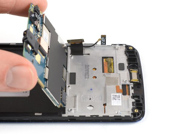

  16. Motorola Moto E4 Screen Assembly Replacement: crwdns2935265:016crwdnd2935265:01crwdnd2935265:02crwdne2935265:0 Motorola Moto E4 Screen Assembly Replacement: crwdns2935265:016crwdnd2935265:02crwdnd2935265:02crwdne2935265:0

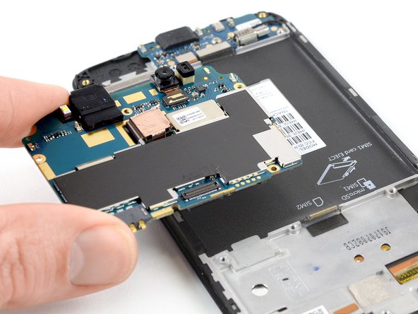

    • Don't try to remove the motherboard all the way yet. The interconnect flex cable is still connected to its rear side.
    • Use a spudger to carefully lift the motherboard from the top and fold it towards the battery compartment.
    • Be careful not to damage any components underneath the motherboard.

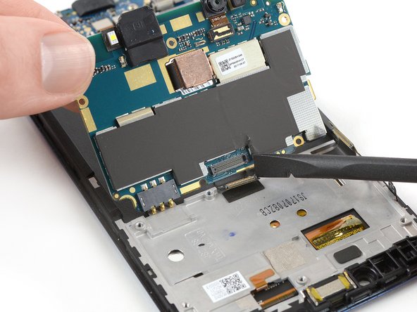

  17. Motorola Moto E4 Screen Assembly Replacement: crwdns2935265:017crwdnd2935265:01crwdnd2935265:03crwdne2935265:0 Motorola Moto E4 Screen Assembly Replacement: crwdns2935265:017crwdnd2935265:02crwdnd2935265:03crwdne2935265:0 Motorola Moto E4 Screen Assembly Replacement: crwdns2935265:017crwdnd2935265:03crwdnd2935265:03crwdne2935265:0
    • Use the edge of a spudger to disconnect the interconnect cable from the motherboard.
    • Remove the motherboard.

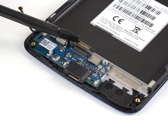

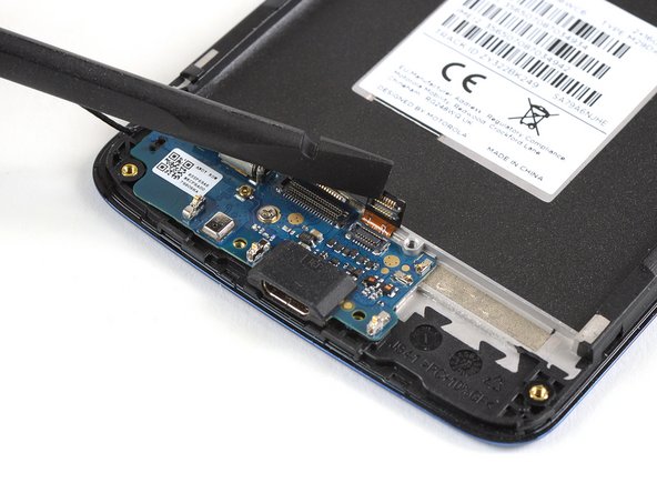

  18. Motorola Moto E4 Screen Assembly Replacement, Charging Board: crwdns2935265:018crwdnd2935265:01crwdnd2935265:02crwdne2935265:0 Motorola Moto E4 Screen Assembly Replacement, Charging Board: crwdns2935265:018crwdnd2935265:02crwdnd2935265:02crwdne2935265:0
    • Use a pair of tweezers to pry up and disconnect the antenna cable.
  19. Motorola Moto E4 Screen Assembly Replacement: crwdns2935265:019crwdnd2935265:01crwdnd2935265:02crwdne2935265:0 Motorola Moto E4 Screen Assembly Replacement: crwdns2935265:019crwdnd2935265:02crwdnd2935265:02crwdne2935265:0
    • Use the edge of a spudger to pry up and disconnect the interconnect flex cable.

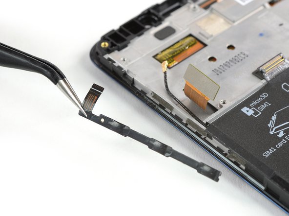

  25. Motorola Moto E4 Screen Assembly Replacement, Screen Assembly: crwdns2935265:025crwdnd2935265:01crwdnd2935265:01crwdne2935265:0
    • Apply a heated iOpener to the left edge of the phone for about 30 seconds to loosen the adhesive beneath power and volume button unit.
  26. Motorola Moto E4 Screen Assembly Replacement: crwdns2935265:026crwdnd2935265:01crwdnd2935265:03crwdne2935265:0 Motorola Moto E4 Screen Assembly Replacement: crwdns2935265:026crwdnd2935265:02crwdnd2935265:03crwdne2935265:0 Motorola Moto E4 Screen Assembly Replacement: crwdns2935265:026crwdnd2935265:03crwdnd2935265:03crwdne2935265:0
    • Use a pair of tweezers to gently peel the power and volume button unit off the left edge of the phone.
    • Remove the power and volume button unit.

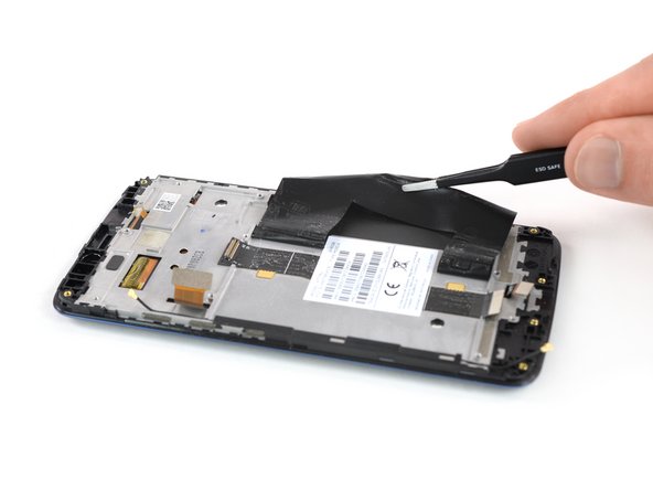

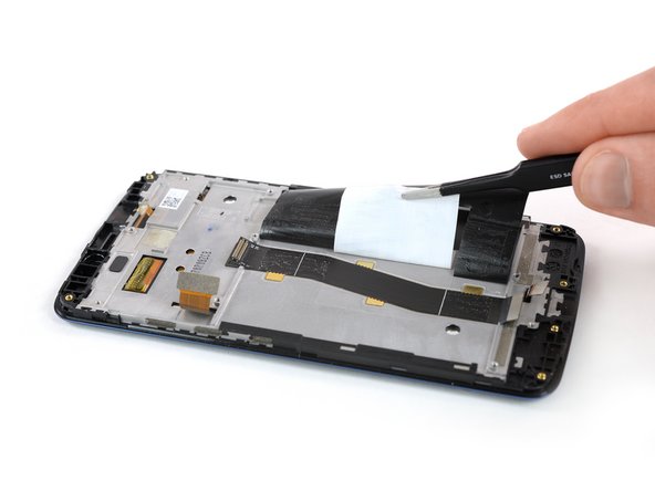

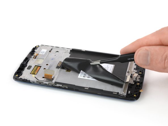

    • Apply the iOpener for about two minutes on the black adhesive tape that covers the antenna and the interconnect cable.
  28. Motorola Moto E4 Screen Assembly Replacement: crwdns2935265:028crwdnd2935265:01crwdnd2935265:03crwdne2935265:0 Motorola Moto E4 Screen Assembly Replacement: crwdns2935265:028crwdnd2935265:02crwdnd2935265:03crwdne2935265:0 Motorola Moto E4 Screen Assembly Replacement: crwdns2935265:028crwdnd2935265:03crwdnd2935265:03crwdne2935265:0
    • Use a pair of tweezers to gently peel the adhesive tape off the antenna and interconnect cable and fold it out of the way.

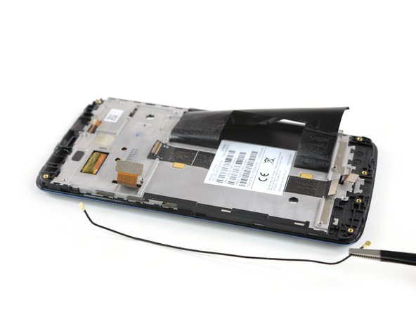

  29. Motorola Moto E4 Screen Assembly Replacement: crwdns2935265:029crwdnd2935265:01crwdnd2935265:02crwdne2935265:0 Motorola Moto E4 Screen Assembly Replacement: crwdns2935265:029crwdnd2935265:02crwdnd2935265:02crwdne2935265:0
    • Use a pair of tweezers to thread the antenna cable out of its routing.
    • Remove the antenna cable.

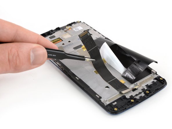

  30. Motorola Moto E4 Screen Assembly Replacement: crwdns2935265:030crwdnd2935265:01crwdnd2935265:03crwdne2935265:0 Motorola Moto E4 Screen Assembly Replacement: crwdns2935265:030crwdnd2935265:02crwdnd2935265:03crwdne2935265:0 Motorola Moto E4 Screen Assembly Replacement: crwdns2935265:030crwdnd2935265:03crwdnd2935265:03crwdne2935265:0
    • Use a pair of tweezers to gently peel the product sticker off the interconnect cable.
    • In case you can't remove the sticker or it starts to rip apart you can re-apply an iOpener to loosen the adhesive.

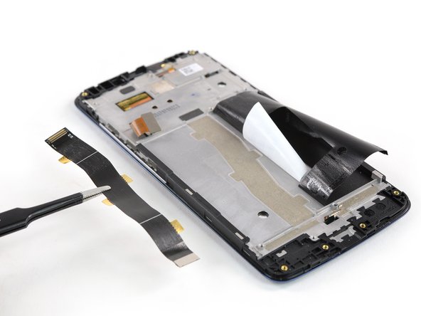

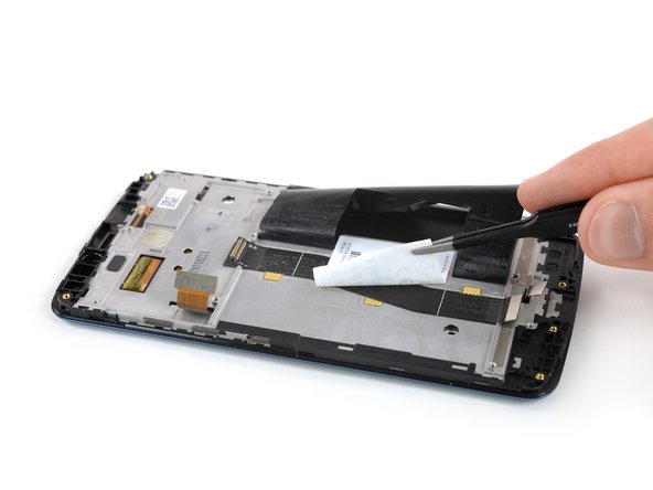

  31. Motorola Moto E4 Screen Assembly Replacement: crwdns2935265:031crwdnd2935265:01crwdnd2935265:03crwdne2935265:0 Motorola Moto E4 Screen Assembly Replacement: crwdns2935265:031crwdnd2935265:02crwdnd2935265:03crwdne2935265:0 Motorola Moto E4 Screen Assembly Replacement: crwdns2935265:031crwdnd2935265:03crwdnd2935265:03crwdne2935265:0
    • Use a pair of tweezers to grab and carefully peel up the interconnect flex cable.
    • Remove the interconnect flex cable.
