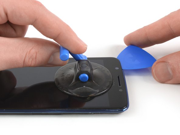

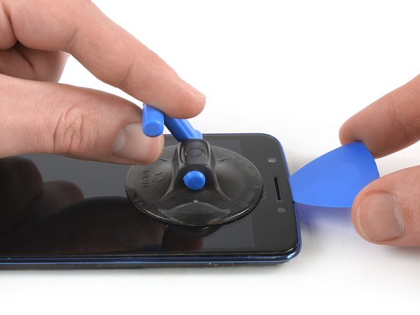

  24. Motorola Moto E4 (XT1762) LCD and Digitizer Replacement: crwdns2935265:024crwdnd2935265:01crwdnd2935265:03crwdne2935265:0 Motorola Moto E4 (XT1762) LCD and Digitizer Replacement: crwdns2935265:024crwdnd2935265:02crwdnd2935265:03crwdne2935265:0 Motorola Moto E4 (XT1762) LCD and Digitizer Replacement: crwdns2935265:024crwdnd2935265:03crwdnd2935265:03crwdne2935265:0
    • Once the screen is warm to the touch, apply a suction cup to the upper area of the phone right under the earpiece speaker.
    • If the phone's screen is cracked, the suction cup may not stick. Try lifting it with strong tape, or superglue the suction cup in place and allow it to cure so you can proceed.
    • Pull up the suction cup, and insert an opening pick under the display.
    • Slide the opening pick to the top left corner of the phone to cut the adhesive.

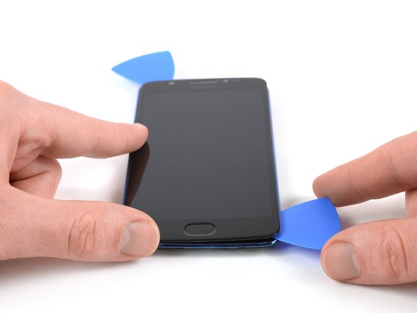

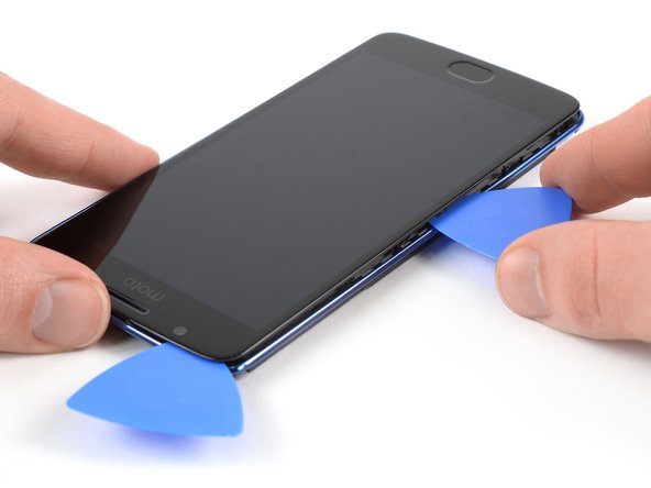

  25. Motorola Moto E4 (XT1762) LCD and Digitizer Replacement: crwdns2935265:025crwdnd2935265:01crwdnd2935265:02crwdne2935265:0 Motorola Moto E4 (XT1762) LCD and Digitizer Replacement: crwdns2935265:025crwdnd2935265:02crwdnd2935265:02crwdne2935265:0
    • Insert a second opening pick.
    • Slide it to the top right corner.

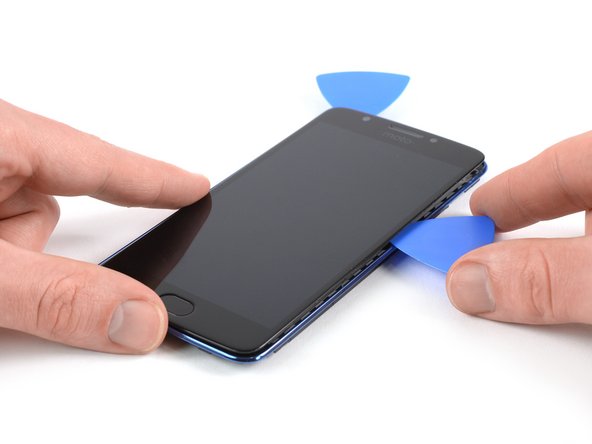

  26. Motorola Moto E4 (XT1762) LCD and Digitizer Replacement: crwdns2935265:026crwdnd2935265:01crwdnd2935265:03crwdne2935265:0 Motorola Moto E4 (XT1762) LCD and Digitizer Replacement: crwdns2935265:026crwdnd2935265:02crwdnd2935265:03crwdne2935265:0 Motorola Moto E4 (XT1762) LCD and Digitizer Replacement: crwdns2935265:026crwdnd2935265:03crwdnd2935265:03crwdne2935265:0
    • If cutting becomes too difficult, reheat and reapply the iOpener.
    • Slide the opening pick from the top right corner along the edge of the phone to cut the adhesive.
    • Make sure you get under the display unit and not just between the LCD and the digitizer on the front glass when cutting the adhesive.
    • Slide the opening pick around the bottom right corner.

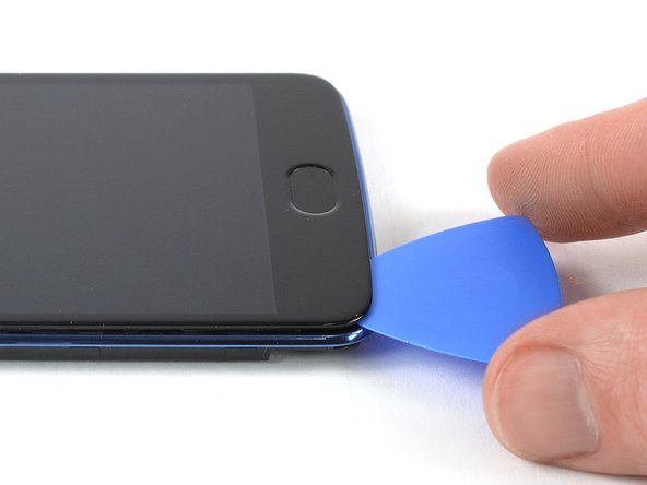

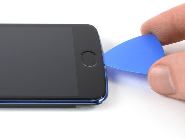

  27. Motorola Moto E4 (XT1762) LCD and Digitizer Replacement: crwdns2935265:027crwdnd2935265:01crwdnd2935265:03crwdne2935265:0 Motorola Moto E4 (XT1762) LCD and Digitizer Replacement: crwdns2935265:027crwdnd2935265:02crwdnd2935265:03crwdne2935265:0 Motorola Moto E4 (XT1762) LCD and Digitizer Replacement: crwdns2935265:027crwdnd2935265:03crwdnd2935265:03crwdne2935265:0
    • Slide the opening pick along the bottom edge of the phone and cut the adhesive.
    • In the middle where the home button is only use the very tip of the opening pick to not damage it.

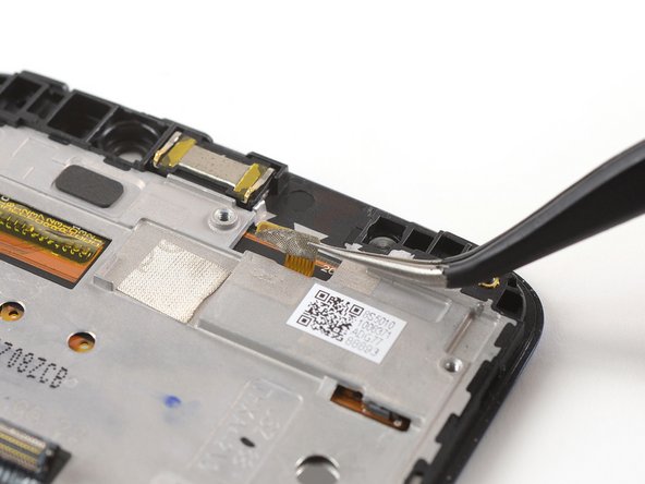

  29. Motorola Moto E4 (XT1762) LCD and Digitizer Replacement: crwdns2935265:029crwdnd2935265:01crwdnd2935265:02crwdne2935265:0 Motorola Moto E4 (XT1762) LCD and Digitizer Replacement: crwdns2935265:029crwdnd2935265:02crwdnd2935265:02crwdne2935265:0
    • Use a pair of tweezers to peel both display flex cables off the frame. They are located on the bottom left and at the top of the motherboard.

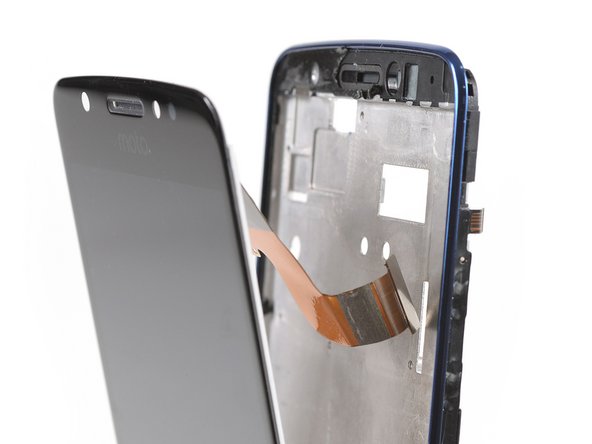

  30. Motorola Moto E4 (XT1762) LCD and Digitizer Replacement: crwdns2935265:030crwdnd2935265:01crwdnd2935265:02crwdne2935265:0 Motorola Moto E4 (XT1762) LCD and Digitizer Replacement: crwdns2935265:030crwdnd2935265:02crwdnd2935265:02crwdne2935265:0
    • Carefully thread both display cables through their gaps in the frame.

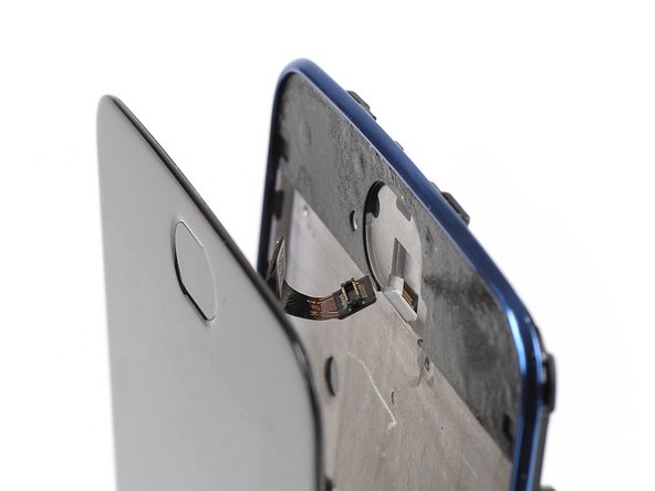

  31. Motorola Moto E4 (XT1762) LCD and Digitizer Replacement: crwdns2935265:031crwdnd2935265:01crwdnd2935265:01crwdne2935265:0
    • Make sure the fingerprint sensor flex cable does not stick to the frame. If so, peel it loose with a pair of tweezers.
  32. Motorola Moto E4 (XT1762) LCD and Digitizer Replacement: crwdns2935265:032crwdnd2935265:01crwdnd2935265:02crwdne2935265:0 Motorola Moto E4 (XT1762) LCD and Digitizer Replacement: crwdns2935265:032crwdnd2935265:02crwdnd2935265:02crwdne2935265:0
    • Carefully thread the fingerprint sensor cable at the bottom through its gap in the frame.
  33. Motorola Moto E4 (XT1762) LCD and Digitizer Replacement: crwdns2935265:033crwdnd2935265:01crwdnd2935265:01crwdne2935265:0
    • Remove the LCD and digitizer unit.
    • Remove any remaining adhesive from the frame, and clean the glued areas with isopropyl alcohol and a lint-free cloth.

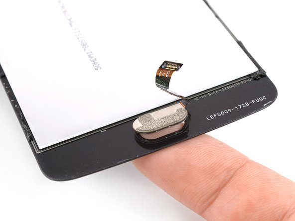

  34. Motorola Moto E4 (XT1762) LCD and Digitizer Replacement, Home Button: crwdns2935265:034crwdnd2935265:01crwdnd2935265:01crwdne2935265:0
    • In case you're replacing a broken screen and the replacement screen already includes the home button, skip the following steps.
    • Apply an iOpener for about one minute to the bottom end of the display where the home button is located.
  35. Motorola Moto E4 (XT1762) LCD and Digitizer Replacement: crwdns2935265:035crwdnd2935265:01crwdnd2935265:03crwdne2935265:0 Motorola Moto E4 (XT1762) LCD and Digitizer Replacement: crwdns2935265:035crwdnd2935265:02crwdnd2935265:03crwdne2935265:0 Motorola Moto E4 (XT1762) LCD and Digitizer Replacement: crwdns2935265:035crwdnd2935265:03crwdnd2935265:03crwdne2935265:0
    • Use your fingertip to push the home button from the front through the display.
    • Remove the home button.
If possible, turn on your phone and test your repair before installing new adhesive and resealing the phone.
