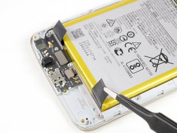

  19. Motorola Moto E4 Plus Screen Replacement: crwdns2935265:019crwdnd2935265:01crwdnd2935265:03crwdne2935265:0 Motorola Moto E4 Plus Screen Replacement: crwdns2935265:019crwdnd2935265:02crwdnd2935265:03crwdne2935265:0 Motorola Moto E4 Plus Screen Replacement: crwdns2935265:019crwdnd2935265:03crwdnd2935265:03crwdne2935265:0
    • Use a pair of tweezers to peel the ends of the two pull tabs off of the bottom edge of the battery.

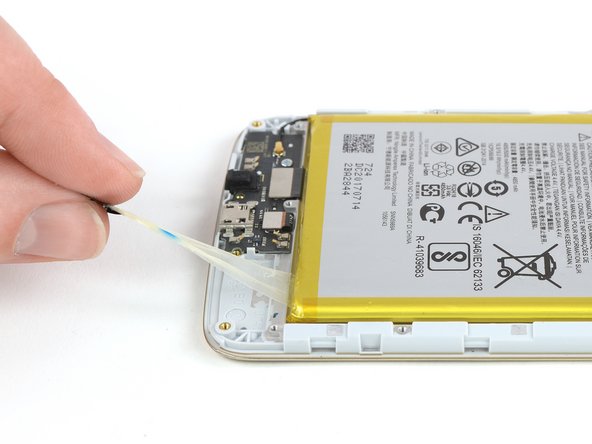

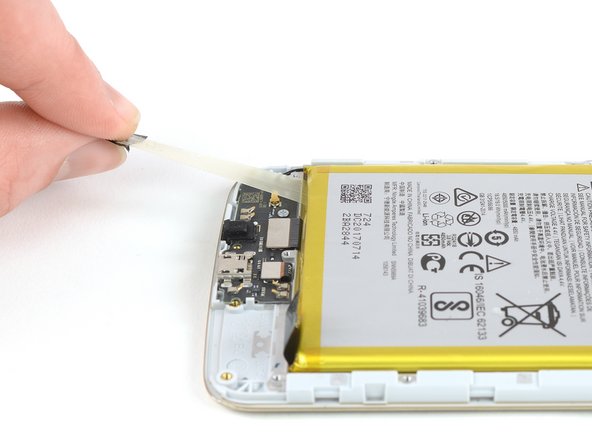

  20. Motorola Moto E4 Plus Screen Replacement: crwdns2935265:020crwdnd2935265:01crwdnd2935265:03crwdne2935265:0 Motorola Moto E4 Plus Screen Replacement: crwdns2935265:020crwdnd2935265:02crwdnd2935265:03crwdne2935265:0 Motorola Moto E4 Plus Screen Replacement: crwdns2935265:020crwdnd2935265:03crwdnd2935265:03crwdne2935265:0
    • Pull out the left adhesive strip by steadily pulling the left tab at a flat angle.
    • If the adhesive strip rips, grab and twist the remaining stub around the tip of a pair of tweezers a couple of times and then continue pulling.
    • Repeat the same process for the right adhesive strip.

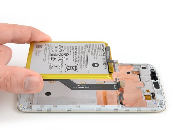

  21. Motorola Moto E4 Plus Screen Replacement: crwdns2935265:021crwdnd2935265:01crwdnd2935265:02crwdne2935265:0 Motorola Moto E4 Plus Screen Replacement: crwdns2935265:021crwdnd2935265:02crwdnd2935265:02crwdne2935265:0
    • Get a good grip on the battery and remove it.

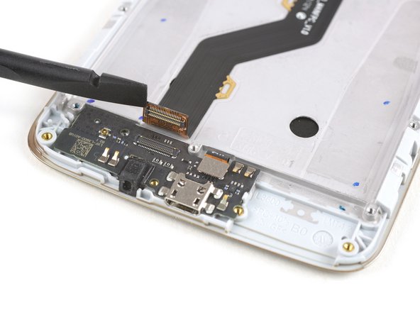

    • Remove the single 2.9 mm Phillips screw holding the charging board to the frame.

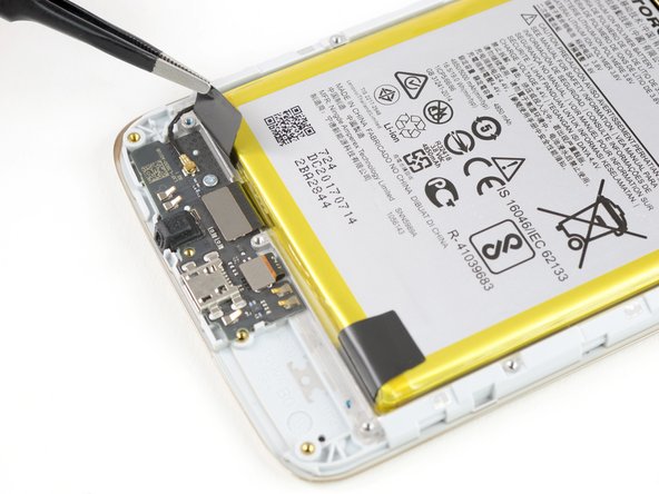

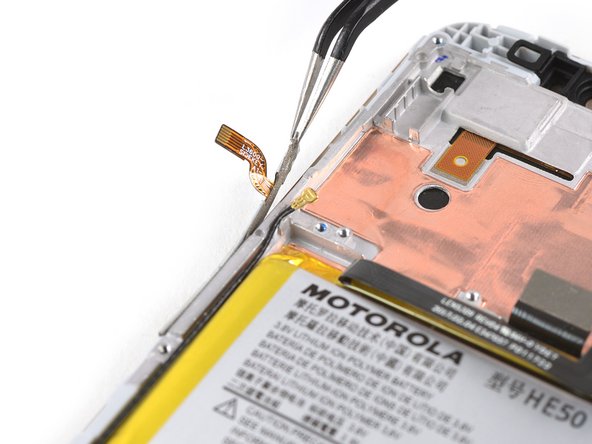

  23. Motorola Moto E4 Plus Screen Replacement: crwdns2935265:023crwdnd2935265:01crwdnd2935265:02crwdne2935265:0 Motorola Moto E4 Plus Screen Replacement: crwdns2935265:023crwdnd2935265:02crwdnd2935265:02crwdne2935265:0
    • Use a pair of tweezers to pry up and disconnect the antenna cable and remove it.

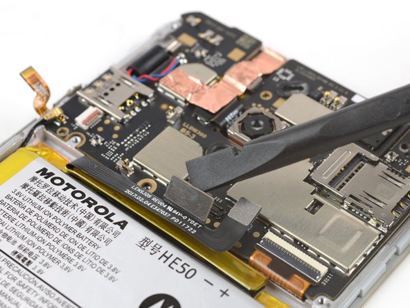

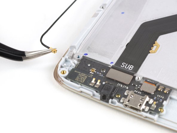

  24. Motorola Moto E4 Plus Screen Replacement: crwdns2935265:024crwdnd2935265:01crwdnd2935265:02crwdne2935265:0 Motorola Moto E4 Plus Screen Replacement: crwdns2935265:024crwdnd2935265:02crwdnd2935265:02crwdne2935265:0
    • Use the edge of a spudger to pry up and disconnect the interconnect flex cable.
  25. Motorola Moto E4 Plus Screen Replacement: crwdns2935265:025crwdnd2935265:01crwdnd2935265:02crwdne2935265:0 Motorola Moto E4 Plus Screen Replacement: crwdns2935265:025crwdnd2935265:02crwdnd2935265:02crwdne2935265:0
    • Use the edge of a spudger to pry up and disconnect the fingerprint sensor flex cable.

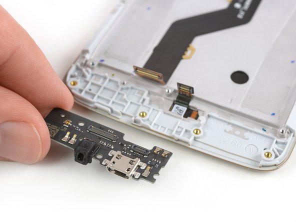

  26. Motorola Moto E4 Plus Screen Replacement: crwdns2935265:026crwdnd2935265:01crwdnd2935265:02crwdne2935265:0 Motorola Moto E4 Plus Screen Replacement: crwdns2935265:026crwdnd2935265:02crwdnd2935265:02crwdne2935265:0
    • Insert the tip of a spudger underneath the bottom edge of the charging board and pry upwards.
    • Remove the charging board.
