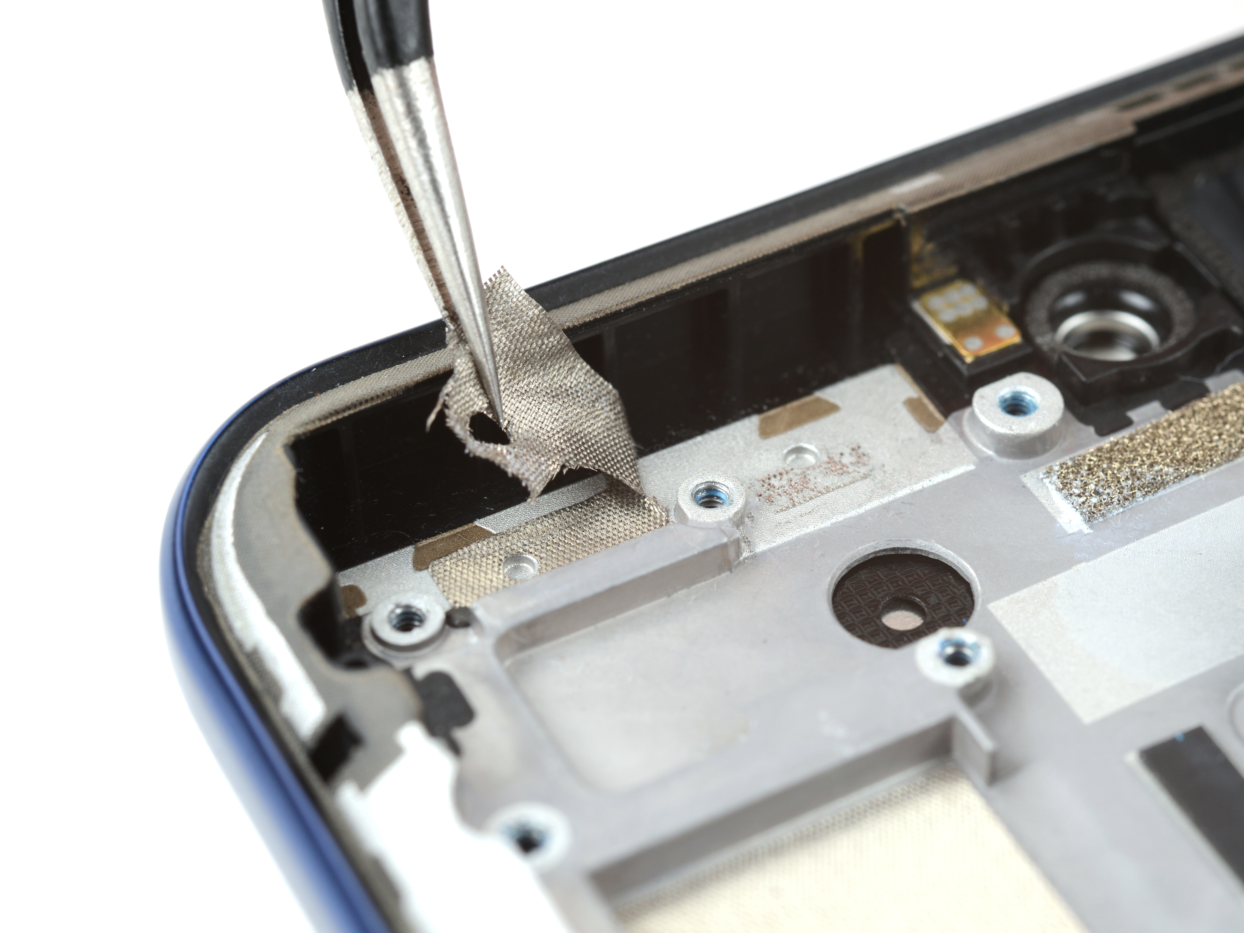

  30. Motorola Edge 5G UW (2022) Top 5G mmWave Antenna Replacement, Reassembly note: crwdns2935265:030crwdnd2935265:01crwdnd2935265:02crwdne2935265:0 Motorola Edge 5G UW (2022) Top 5G mmWave Antenna Replacement, Reassembly note: crwdns2935265:030crwdnd2935265:02crwdnd2935265:02crwdne2935265:0

  31. Motorola Edge 5G UW (2022) Top 5G mmWave Antenna Replacement, Apply isopropyl alcohol: crwdns2935265:031crwdnd2935265:01crwdnd2935265:02crwdne2935265:0 Motorola Edge 5G UW (2022) Top 5G mmWave Antenna Replacement, Apply isopropyl alcohol: crwdns2935265:031crwdnd2935265:02crwdnd2935265:02crwdne2935265:0
    • Apply a few drops of high-concentration (90% or higher) isopropyl alcohol under the 5G mmWave antenna.
    • Wait one minute for the isopropyl alcohol to penetrate the adhesive.
  32. Motorola Edge 5G UW (2022) Top 5G mmWave Antenna Replacement, Remove the 5G mmWave antenna: crwdns2935265:032crwdnd2935265:01crwdnd2935265:03crwdne2935265:0 Motorola Edge 5G UW (2022) Top 5G mmWave Antenna Replacement, Remove the 5G mmWave antenna: crwdns2935265:032crwdnd2935265:02crwdnd2935265:03crwdne2935265:0 Motorola Edge 5G UW (2022) Top 5G mmWave Antenna Replacement, Remove the 5G mmWave antenna: crwdns2935265:032crwdnd2935265:03crwdnd2935265:03crwdne2935265:0
    • Insert the pointed end of a spudger under the 5G mmWave antenna on the side closest to the center of the phone.
    • Pry up with the spudger to detach the antenna.
    • It may take significant force to detach the antenna. If the antenna isn't moving, apply a few more drops of isopropyl alcohol and try again.
    • Remove the antenna.
    • During reassembly, remove the old adhesive from the bracket and frame, then apply new adhesive.
