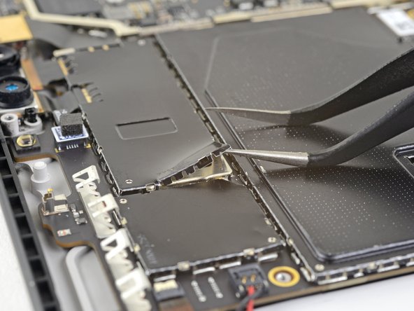

  26. Microsoft Surface Pro 5 Rear-Facing Camera Replacement, Remove the heat sink shield: crwdns2935265:026crwdnd2935265:01crwdnd2935265:02crwdne2935265:0 Microsoft Surface Pro 5 Rear-Facing Camera Replacement, Remove the heat sink shield: crwdns2935265:026crwdnd2935265:02crwdnd2935265:02crwdne2935265:0
    • Insert one point of a pair of pointed tweezers into a gap in the corner of the EMI shield covering the heat sink.
    • Use the tweezers to pry the EMI shield away from the motherboard as much as you can without bending it. Do not remove it yet.
    • Try not to deform the shield too much—you will need to reinstall it during reassembly.
    • Take care not to puncture the battery with the tweezers while working on this shield.

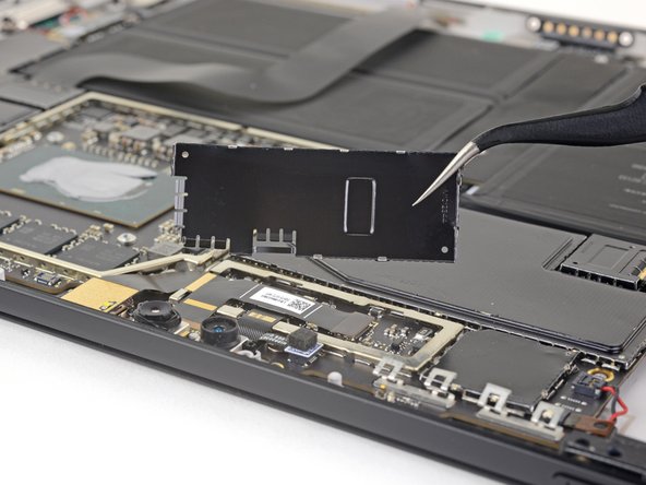

  31. Microsoft Surface Pro 5 Rear-Facing Camera Replacement, Remove the camera connector shield: crwdns2935265:031crwdnd2935265:01crwdnd2935265:03crwdne2935265:0 Microsoft Surface Pro 5 Rear-Facing Camera Replacement, Remove the camera connector shield: crwdns2935265:031crwdnd2935265:02crwdnd2935265:03crwdne2935265:0 Microsoft Surface Pro 5 Rear-Facing Camera Replacement, Remove the camera connector shield: crwdns2935265:031crwdnd2935265:03crwdnd2935265:03crwdne2935265:0
    • Insert one point of a pair of pointed tweezers into a gap in the corner of the EMI shield covering the camera connectors.
    • Repeat this procedure at different points around the shield until it is free. Remove the shield.

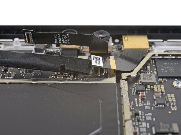

  32. Microsoft Surface Pro 5 Rear-Facing Camera Replacement, Disconnect the front-facing camera: crwdns2935265:032crwdnd2935265:01crwdnd2935265:02crwdne2935265:0 Microsoft Surface Pro 5 Rear-Facing Camera Replacement, Disconnect the front-facing camera: crwdns2935265:032crwdnd2935265:02crwdnd2935265:02crwdne2935265:0
    • Use the flat end of a spudger to pry the front-facing camera connector up and out of its socket on the motherboard.

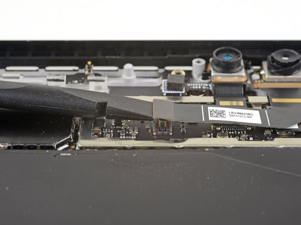

  33. Microsoft Surface Pro 5 Rear-Facing Camera Replacement, Disconnect the rear-facing camera: crwdns2935265:033crwdnd2935265:01crwdnd2935265:02crwdne2935265:0 Microsoft Surface Pro 5 Rear-Facing Camera Replacement, Disconnect the rear-facing camera: crwdns2935265:033crwdnd2935265:02crwdnd2935265:02crwdne2935265:0
    • Use the flat end of a spudger to pry the rear-facing camera connector up and out of its socket on the motherboard.
