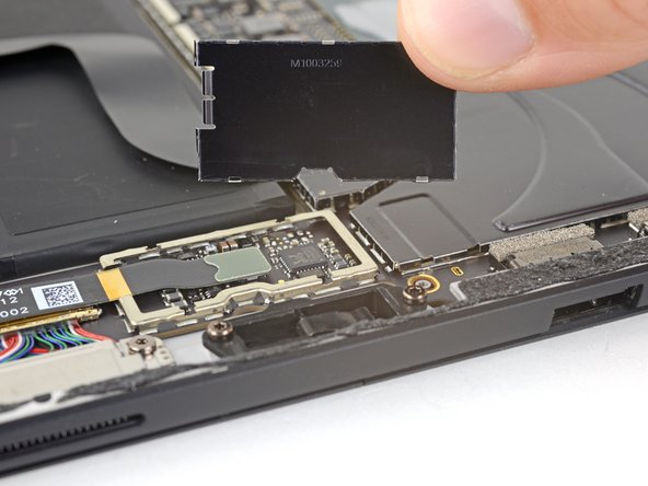

  17. Microsoft Surface Pro 5 MicroSD Card Reader Replacement: crwdns2935265:017crwdnd2935265:01crwdnd2935265:01crwdne2935265:0
    • Lift the EMI shield away from the display board and remove it.

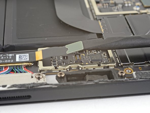

  18. Microsoft Surface Pro 5 MicroSD Card Reader Replacement: crwdns2935265:018crwdnd2935265:01crwdnd2935265:02crwdne2935265:0 Microsoft Surface Pro 5 MicroSD Card Reader Replacement: crwdns2935265:018crwdnd2935265:02crwdnd2935265:02crwdne2935265:0
    • Use the flat end of a spudger to pry the display interconnect cable straight up and out of its socket on the board.

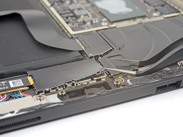

    • Insert one point of a pair of pointed tweezers into a gap in the edge of the EMI shield covering the digitizer connector.
    • Use the tweezers to pry the EMI shield away from the display as much as you can without bending it.
    • Repeat this procedure at different points around the shield until it is free. Remove the shield.
    • Try not to deform the shield too much—you will need to reinstall it during reassembly.
