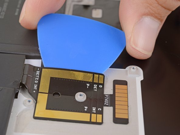

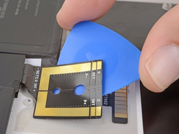

  51. Microsoft Surface Pro 5 Battery Replacement, Separate the battery connector adhesive: crwdns2935265:051crwdnd2935265:01crwdnd2935265:03crwdne2935265:0 Microsoft Surface Pro 5 Battery Replacement, Separate the battery connector adhesive: crwdns2935265:051crwdnd2935265:02crwdnd2935265:03crwdne2935265:0 Microsoft Surface Pro 5 Battery Replacement, Separate the battery connector adhesive: crwdns2935265:051crwdnd2935265:03crwdnd2935265:03crwdne2935265:0
    • Starting at the edge closest to the battery, slide an opening pick under the battery connector to separate the adhesive underneath.
    • Make sure the battery connector is completely free from the case.

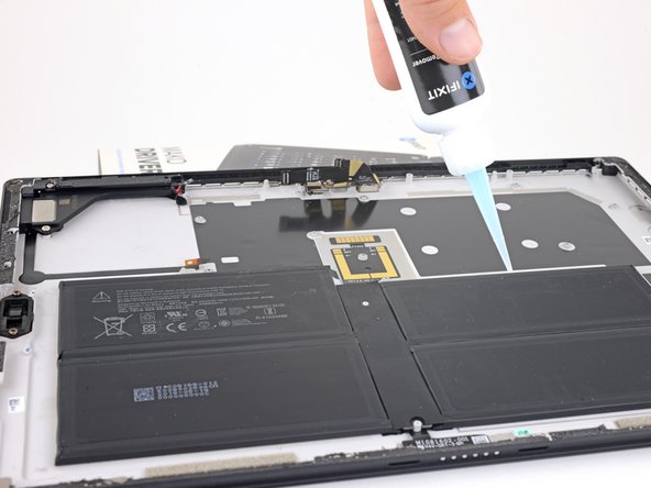

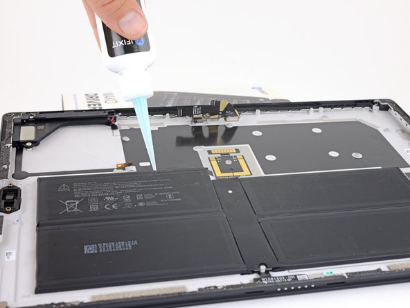

  52. Microsoft Surface Pro 5 Battery Replacement, Remove the battery: crwdns2935265:052crwdnd2935265:01crwdnd2935265:03crwdne2935265:0 Microsoft Surface Pro 5 Battery Replacement, Remove the battery: crwdns2935265:052crwdnd2935265:02crwdnd2935265:03crwdne2935265:0 Microsoft Surface Pro 5 Battery Replacement, Remove the battery: crwdns2935265:052crwdnd2935265:03crwdnd2935265:03crwdne2935265:0
    • Prop the top edge of the Surface up a couple inches so the whole Surface slopes towards the bottom edge.
    • Apply adhesive remover or high-concentration (90% or higher) isopropyl alcohol to the top edge of the battery.
    • If you are using adhesive remover, follow these preparation steps first.
    • Let the adhesive remover sit and soak into the adhesive for 2–3 minutes before continuing.

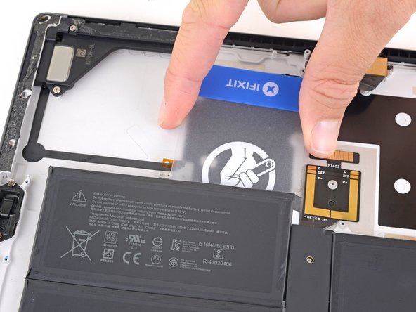

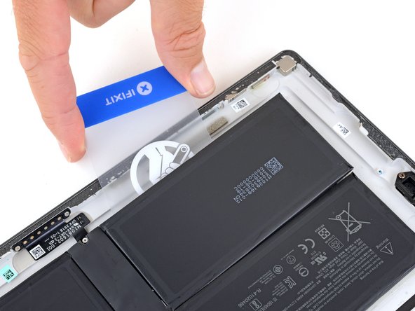

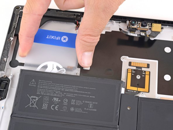

  53. Microsoft Surface Pro 5 Battery Replacement: crwdns2935265:053crwdnd2935265:01crwdnd2935265:03crwdne2935265:0 Microsoft Surface Pro 5 Battery Replacement: crwdns2935265:053crwdnd2935265:02crwdnd2935265:03crwdne2935265:0 Microsoft Surface Pro 5 Battery Replacement: crwdns2935265:053crwdnd2935265:03crwdnd2935265:03crwdne2935265:0
    Plastic Cards
    $2.99
    • Take care not to puncture or bend the battery with your tools—a punctured or bent battery may leak dangerous chemicals or cause a thermal event.
    • Slide a plastic card under the left side of the top edge of the battery.
    • If you encounter significant resistance at any point during this procedure, stop, apply a little more adhesive remover, and wait for it to soak in.
    • Slide the card side to side under the upper left battery cell to slice through the adhesive underneath.

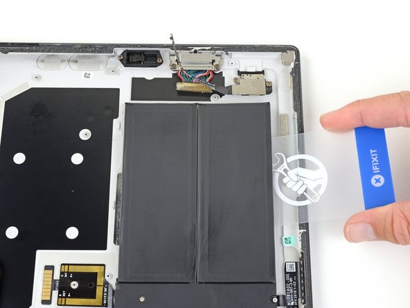

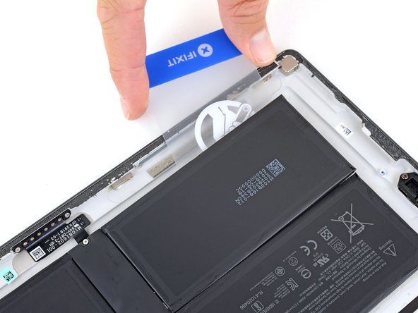

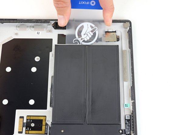

  55. Microsoft Surface Pro 5 Battery Replacement: crwdns2935265:055crwdnd2935265:01crwdnd2935265:03crwdne2935265:0 Microsoft Surface Pro 5 Battery Replacement: crwdns2935265:055crwdnd2935265:02crwdnd2935265:03crwdne2935265:0 Microsoft Surface Pro 5 Battery Replacement: crwdns2935265:055crwdnd2935265:03crwdnd2935265:03crwdne2935265:0
    • Repeat the previous two steps for the right side of the battery to release the two right cells from their adhesive.

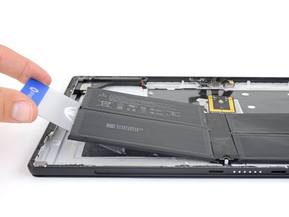

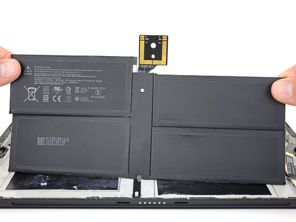

  56. Microsoft Surface Pro 5 Battery Replacement: crwdns2935265:056crwdnd2935265:01crwdnd2935265:03crwdne2935265:0 Microsoft Surface Pro 5 Battery Replacement: crwdns2935265:056crwdnd2935265:02crwdnd2935265:03crwdne2935265:0 Microsoft Surface Pro 5 Battery Replacement: crwdns2935265:056crwdnd2935265:03crwdnd2935265:03crwdne2935265:0
    • Lift each side of the battery with a plastic card and make sure all the adhesive is separated from the battery.
    • Gently lift the battery out of the case.
    • Do not reuse the battery after it has been removed, as doing so is a potential safety hazard. Replace it with a new battery.
    • During reassembly, follow this guide to clean off old adhesive and apply new adhesive from a pre-cut adhesive card.
For optimal performance, calibrate your newly installed battery after completing this guide.
