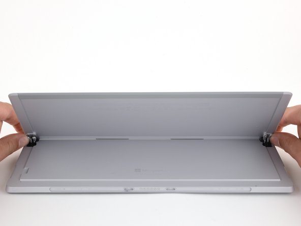

    • Place your device screen-down on a clean work surface.
    • Place your device on top of a clean cloth, such as a microfiber towel, if you feel the need to protect against scratching.
    • Open the kickstand as wide as it is designed to go (about 135 degrees).

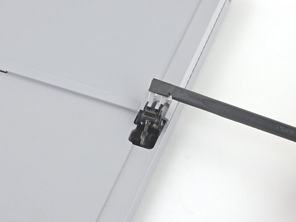

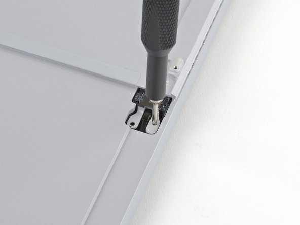

  2. Microsoft Surface Pro 4 Kickstand Replacement, Unscrew the kickstand: crwdns2935265:02crwdnd2935265:01crwdnd2935265:02crwdne2935265:0 Microsoft Surface Pro 4 Kickstand Replacement, Unscrew the kickstand: crwdns2935265:02crwdnd2935265:02crwdnd2935265:02crwdne2935265:0
    • Use a T5 Torx screwdriver to remove the two 3.3 mm screws securing each hinge to the kickstand.
    • Support the kickstand from behind to prevent damage to the hinges while removing the screws.
    • Do not remove the kickstand yet.
    • The kickstand remains held in place by two flexible appendages between the hinges.

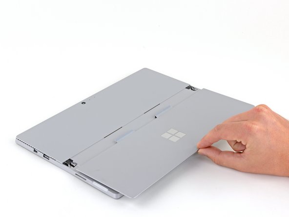

  3. Microsoft Surface Pro 4 Kickstand Replacement, Close the kickstand: crwdns2935265:03crwdnd2935265:01crwdnd2935265:03crwdne2935265:0 Microsoft Surface Pro 4 Kickstand Replacement, Close the kickstand: crwdns2935265:03crwdnd2935265:02crwdnd2935265:03crwdne2935265:0 Microsoft Surface Pro 4 Kickstand Replacement, Close the kickstand: crwdns2935265:03crwdnd2935265:03crwdnd2935265:03crwdne2935265:0
    • Press the kickstand from directly behind the hinges and close it fully.
    • Do not exert force on the kickstand anywhere except for behind the hinges.
    • This step does not apply during reassembly.

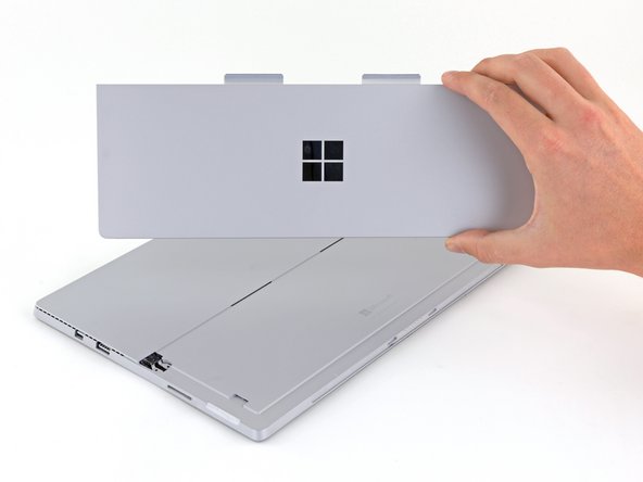

  4. Microsoft Surface Pro 4 Kickstand Replacement, Remove the kickstand: crwdns2935265:04crwdnd2935265:01crwdnd2935265:03crwdne2935265:0 Microsoft Surface Pro 4 Kickstand Replacement, Remove the kickstand: crwdns2935265:04crwdnd2935265:02crwdnd2935265:03crwdne2935265:0 Microsoft Surface Pro 4 Kickstand Replacement, Remove the kickstand: crwdns2935265:04crwdnd2935265:03crwdnd2935265:03crwdne2935265:0
    • Pull the kickstand straight out from the bottom of the device.
    • Begin reassembly now before proceeding to steps 5 and 6:
    • Install your new kickstand by inserting its two appendages into the back of the device.
    • Press your new kickstand towards the top of the device until it is fully inserted.
    • Open the kickstand 180 degrees to expose the hinges.

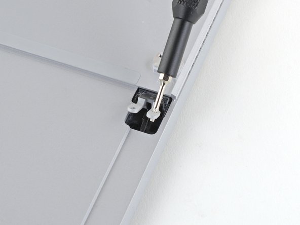

  5. Microsoft Surface Pro 4 Kickstand Replacement, Reassembly tips: crwdns2935265:05crwdnd2935265:01crwdnd2935265:03crwdne2935265:0 Microsoft Surface Pro 4 Kickstand Replacement, Reassembly tips: crwdns2935265:05crwdnd2935265:02crwdnd2935265:03crwdne2935265:0 Microsoft Surface Pro 4 Kickstand Replacement, Reassembly tips: crwdns2935265:05crwdnd2935265:03crwdnd2935265:03crwdne2935265:0
    • To open the hinge, insert your T5 Torx screwdriver into one of the screw holes and gently pry towards the top of your device until the hinge is exposed.
    • Make sure the complete step 4 and begin installing the kickstand first.
  6. Microsoft Surface Pro 4 Kickstand Replacement: crwdns2935265:06crwdnd2935265:01crwdnd2935265:02crwdne2935265:0 Microsoft Surface Pro 4 Kickstand Replacement: crwdns2935265:06crwdnd2935265:02crwdnd2935265:02crwdne2935265:0
