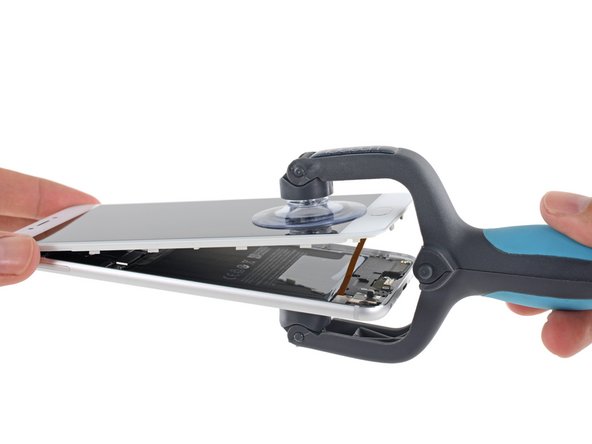

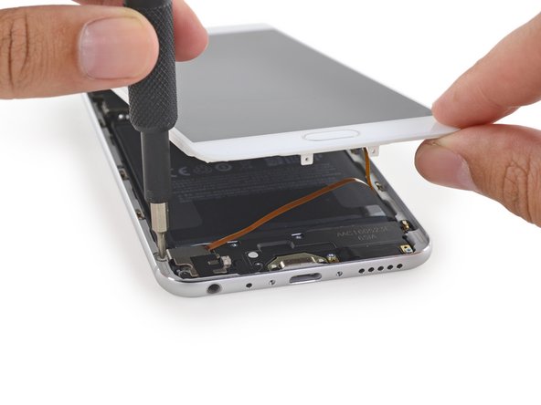

  3. Meizu MX6 Teardown: crwdns2935265:03crwdnd2935265:01crwdnd2935265:03crwdne2935265:0 Meizu MX6 Teardown: crwdns2935265:03crwdnd2935265:02crwdnd2935265:03crwdne2935265:0 Meizu MX6 Teardown: crwdns2935265:03crwdnd2935265:03crwdnd2935265:03crwdne2935265:0

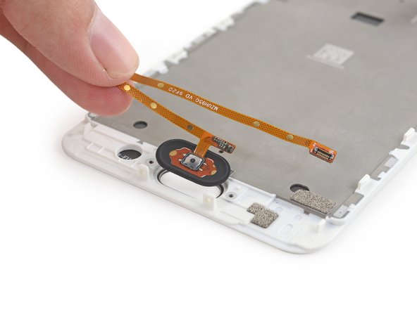

    • Like the Huawei P9, the MX6 seems inspired by the iPhone in more than just looks: two Pentalobe screws secure the MX6's display assembly to the chassis.
    • We're still baffled as to why manufacturers would copy Apple's screw design, when a regular ol' Phillips or Torx screw does the same job better with less hassle.
    • Ruh Roh, Raggy! We also find a fingerprint reader cable booby trap like in the iPhone 5s/SE!
    • Not to worry, Scooby Doo— Meizu cut us some slack (literally), so the cable is unlikely to rip when opening the phone.
    • The cable's connector lies under a screwed-down, tamper-evident bracket that's arguably simpler than Apple's awful spring clip.
  4. Meizu MX6 Teardown: crwdns2935265:04crwdnd2935265:01crwdnd2935265:02crwdne2935265:0 Meizu MX6 Teardown: crwdns2935265:04crwdnd2935265:02crwdnd2935265:02crwdne2935265:0
    • Before diving in, we pause to disconnect the battery; its small connector releases with a flip of the spudger. Safety first.
    • With the MX6 safely de-electrified, we pop the display cable free and peer inside.
    • First observation: Phillips screws— everywhere! A small celebration breaks out around the teardown table.
    • Second observation: Looks like the iPhone mold is mostly skin-deep, look at that big ol' battery.!We just can't wait to dig in.

    • Interestingly, the display's perimeter is all plastic, including its clips and edges. This may be a durability concern, but there's no risk of display bracket separation.
    • Out comes the bracket securing the fingerprint sensor—followed by the sensor itself, with its long switchback cable in tow.
    • This display assembly is a much simpler affair than you'll find in a comparable iPhone (or Android phone!), thanks to some handy spring contacts and a motherboard-mounted front-facing camera.
    • That means a cheaper, simpler repair!

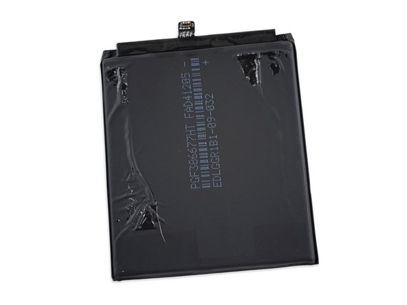

  6. Meizu MX6 Teardown: crwdns2935265:06crwdnd2935265:01crwdnd2935265:03crwdne2935265:0 Meizu MX6 Teardown: crwdns2935265:06crwdnd2935265:02crwdnd2935265:03crwdne2935265:0 Meizu MX6 Teardown: crwdns2935265:06crwdnd2935265:03crwdnd2935265:03crwdne2935265:0

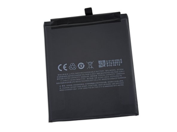

    • With the display assembly out of the way, we carefully excavate the MX6's stubbornly-adhered battery. Luckily, the battery features an iPhone 4-esque battery pull tab that makes the job a bit easier.
    • The MX6 packs a non-user-removable, 3.8 V, 11.63 Wh Li-poly battery.
    • This puts the MX6's battery ahead in the power struggle, topping the iPhone 6s Plus's 10.45 Wh battery, and just barely surpassing the Samsung Galaxy S7's 11.55 Wh battery.
    • Meizu claims that their mCharge 24 W (12 V at 2 A) fast charging technology will fully charge the MX6's battery in only 75 minutes, compared to 90 minutes for the Galaxy S7.

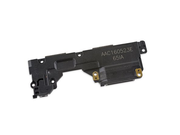

  7. Meizu MX6 Teardown: crwdns2935265:07crwdnd2935265:01crwdnd2935265:03crwdne2935265:0 Meizu MX6 Teardown: crwdns2935265:07crwdnd2935265:02crwdnd2935265:03crwdne2935265:0 Meizu MX6 Teardown: crwdns2935265:07crwdnd2935265:03crwdnd2935265:03crwdne2935265:0

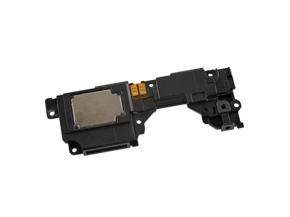

    • Next to come out? The speaker assembly, complete with spring contacts and what appears to be an antenna sticker of some kind.
    • Part of the assembly lines up with the lower microphone hole—but if you go looking for a mic here, you'll be disappointed!
    • This assembly has a tiny acoustic tube channel with a 90-degree bend, passing sound from the outside world to a mic located elsewhere...

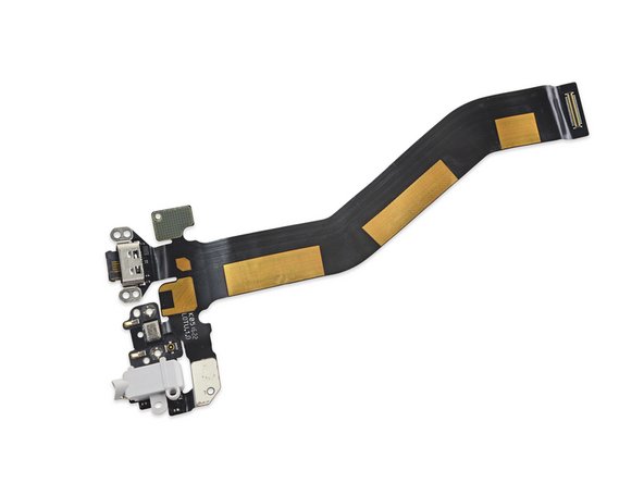

  8. Meizu MX6 Teardown: crwdns2935265:08crwdnd2935265:01crwdnd2935265:02crwdne2935265:0 Meizu MX6 Teardown: crwdns2935265:08crwdnd2935265:02crwdnd2935265:02crwdne2935265:0
    • "Elsewhere" turns out to be a combined USB-C, headphone jack, and microphone assembly—which we dutifully peel out of the chassis of the MX6.
    • A small amount of adhesive secures the cable to the chassis, but it presents no problem for our teardown engineer.
    • Upon inspection, we find antenna connections on the bottom of the cable, as well as on the bottom of the motherboard.
    • Manufacturers seem to be in competition to cram as much as they possibly can onto the charging port cable. (Which means a pricier repair when your port eventually gets loose.)

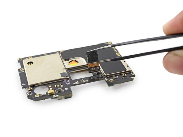

    • With those bits out of the way, we lift the motherboard out and get a closer look at the cameras.
    • The rear-facing camera features Sony's 12 MP Exmor RS IMX386 CMOS image sensor along with a 6-element ƒ/2.0 lens, while the front-facing camera features a 5 MP sensor with a 4-element ƒ/2.0 lens.

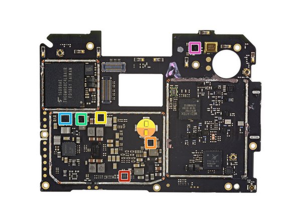

    • With the motherboard plucked from the the rear case, we take a second to explore the MX6's silicon situation. Highlights include:
    • Micron MT52L512M64D4GN-107 WT:B 32 Gb (4 GB) Mobile LPDDR3 SDRAM with MediaTek Helio X20 SoC layered underneath
    • MediaTek MT6631N Wi-Fi module
    • Texas Instruments BQ25892 fast charging IC
    • NXP TFA9911 audio amplifier
    • MediaTek MT6351V PMIC
    • Skyworks SKY77673-11 power amplifier module (likely)
    • MediaTek MT6300P (possibly an iteration of the MT6302 dual SIM card controller)

    • IC Identification, pt. 2:
    • ON Semiconductor FUSB301A USB type-C controller
    • Texas Instruments LM3644 camera flash LED driver
    • ON Semiconductor FAN53200UC35X 5 A regulator
    • ON Semiconductor FAN53526UC128X 3.0 A DC-DC converter
    • ON Semiconductor FAN49101 2 A buck-boost regulator (likely)
    • Texas Instruments DRV2604 haptic driver
    • Skyworks SKY9225 antenna tuner (likely)

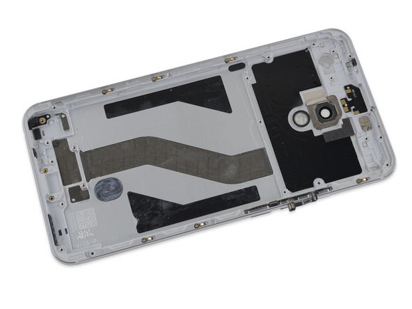

    • The final few pickings come from the MX6's chassis.
    • We pry out the (tiny!) rotational vibrator motor. It's different from the linear oscillating motors and "Taptic Engines" used in many (not all) iPhone models, but also takes less space.
    • The chassis itself is peppered with spring contacts, which no doubt made our teardown journey that much easier.
