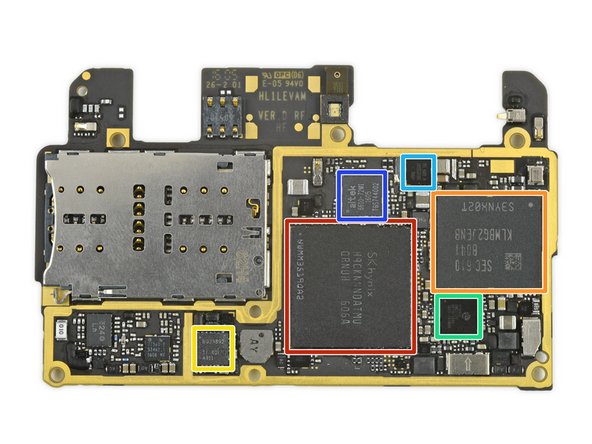

  6. Huawei P9 Teardown: crwdns2935265:06crwdnd2935265:01crwdnd2935265:02crwdne2935265:0 Huawei P9 Teardown: crwdns2935265:06crwdnd2935265:02crwdnd2935265:02crwdne2935265:0
    • Who left their gum in here? Peeling up the motherboard reveals more thermal paste in a phone than we've seen in awhile.
    • Here are the front-side chips:
    • HiSilicon Kirin 955 (likely a HiSilicon Hi3650) octa-core processor layered underneath 3 GB of SK Hynix H9CKNNNDATMUQRN-UH LPDDR3 RAM
    • Samsung KLMBG2JENB-B041 32 GB eMMC NAND flash memory
    • Texas Instruments BQ25892 fast charging IC
    • HiSilicon Hi6402 audio codec
    • Maxim Integrated MAX98925 audio amplifier
    • Altek AL6610-72M1 AI camera processor (likely)
