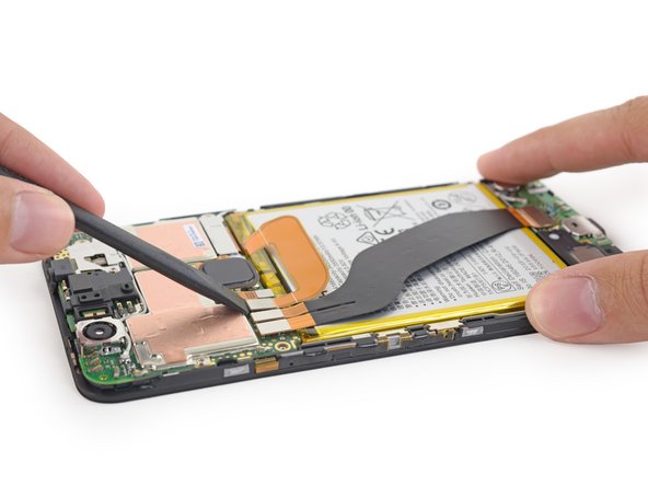

    • With the initial adhesive adventures behind us, the 6P has finally come out of its shell.
    • Unlike other phones we've seen lately, there's no discrete display assembly or easily removed rear cover here. Instead, the 6P's internals come out of the rear case in one mega-sized component assembly, leaving only the NFC antenna behind.
    • This isn't a good sign for the 6P's repairability—in fact, it reminds us of our harrowing experience with the HTC One M7.
    • On the bright side, it looks like a daughterboard interconnect cable is all that stands between us and the battery!

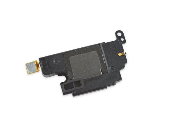

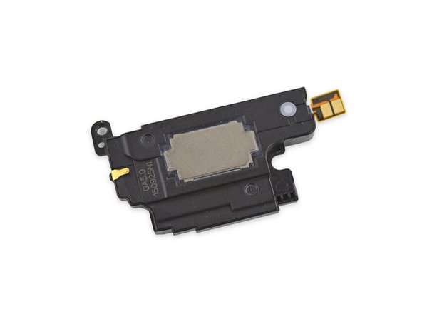

    • We continue our sleuthing along the bottom of the phone and come across what appears to be a speaker box.
    • Front-facing speakers are becoming a bit of a trademark for Google, and were found in last year's Nexus 9 and the Nexus 6.
    • We suspect Google's motive for including these front-facing speakers is simple enough: people prefer speakers that face them.
    • Of course that says nothing about how it actually sounds. We'll have to wait until we put our 6P back together to give it a listen.

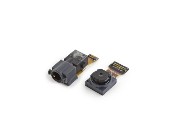

  10. Nexus 6P Teardown: crwdns2935265:010crwdnd2935265:01crwdnd2935265:03crwdne2935265:0 Nexus 6P Teardown: crwdns2935265:010crwdnd2935265:02crwdnd2935265:03crwdne2935265:0 Nexus 6P Teardown: crwdns2935265:010crwdnd2935265:03crwdnd2935265:03crwdne2935265:0
    • Next to fly free is the headphone jack, which we find encased in a little rubber sleeve. Hmmm.
    • While we've been watching carefully for signs of life waterproofing, this small sleeve alone doesn't indicate whether Google might be preparing for rising tides.
    • Moving along, we pull out the front-facing (i.e. selfie) camera. This 8 MP, ƒ/2.4 camera is up 3 MP from its counterpart on the 5X, but still maintains the same 1.4 micron pixel size.
    • We snap a few photos of our new-found peripheral friends and head for the core.

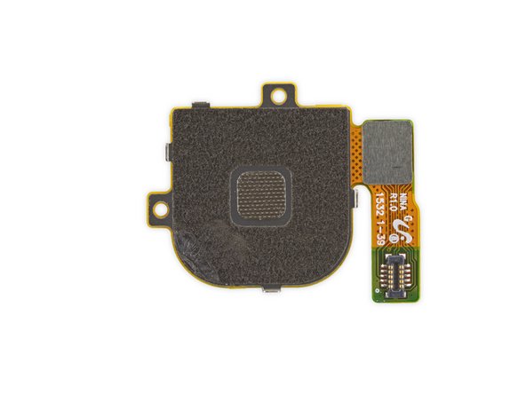

    • Spudger ready, we turn our attention to the square Nexus Imprint sensor.
    • Wait. Square? Wasn't this thing round when we first saw it?
    • It turns out this version of the Imprint sensor is quite different from the one we found in the 5X. The circular profile of this fingerprint reader is solely due to the round hole in the 6P's rear case.
    • Perhaps Huawei is planning to use this very fingerprint reader in one of their other phones. Handy.
    • Fingerprints FPC1020 fingerprint sensor
    • Fingerprints FPC2050 fingerprint controller (likely)

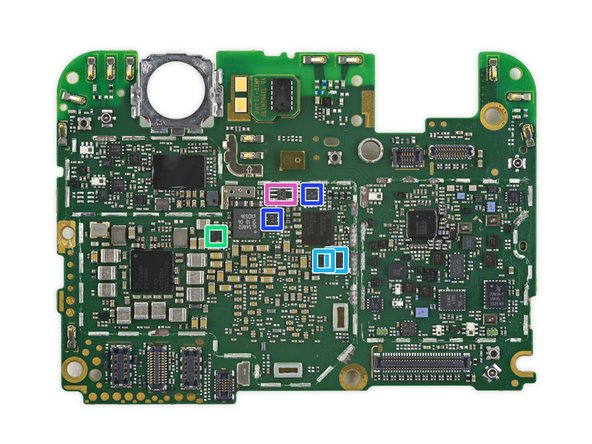

    • We smell chips! With the motherboard free and the EMI shielding pulled away, it's time for a look at the silicon:
    • Micron MT53B384M64D4NK-062 3 GB LPDDR4 RAM, layered over Qualcomm Snapdragon 810 v2.1, 2.0 GHz octa-core 64-bit CPU
    • Samsung KLMBG4GEND-B031 32 GB eMMC 5.0 NAND flash
    • Qualcomm PMI8994 power management IC (found in many 2015 Android smartphones including the Nexus 5X)
    • Qualcomm SMB1351 Quick Charge IC (Likely an iteration of SMB1358 found in the Nexus 5X)
    • Qualcomm QFE1100 envelope tracking IC
    • ST Microelectronics STM32F411CE 32-bit 100 MHz ARM Cortex-M4 RISC microcontroller
    • Maxim Integrated MAX98925 audio amplifier

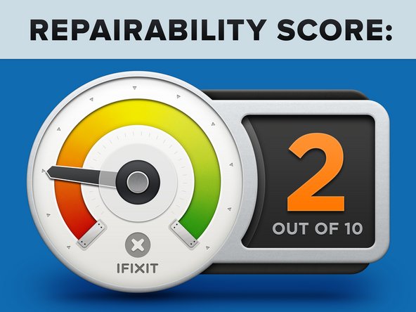

    • Nexus 6P Repairability Score: 2 out of 10 (10 is easiest to repair)
    • Solid external construction improves durability.
    • Once the arduous opening procedure is complete, the battery is immediately accessible.
    • It's very difficult—although not impossible—to open the device without damaging the glass camera cover. Because of the unibody design, this makes every component extremely difficult to replace.
    • The display assembly cannot be replaced without tunneling through the entire phone. This makes one of the most common repairs, a damaged screen, difficult to accomplish.
    • Tough adhesive holds the rear cover panels and battery in place.
