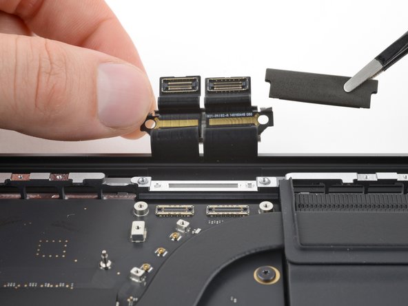

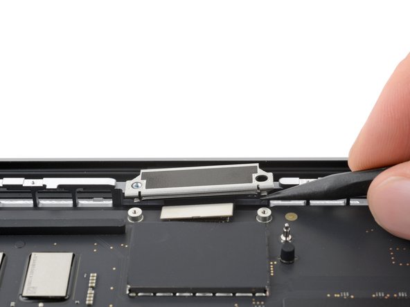

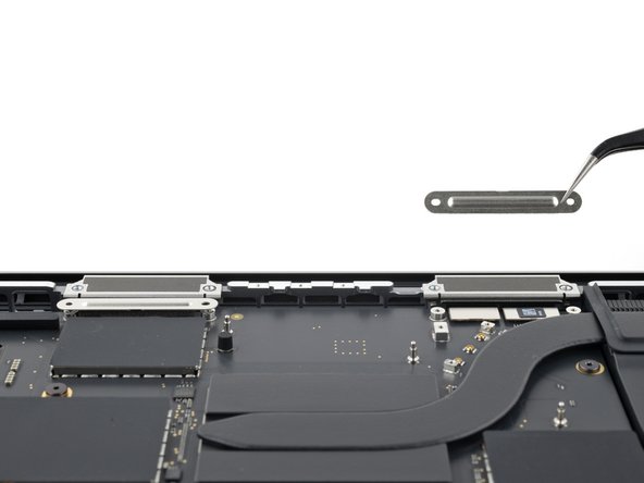

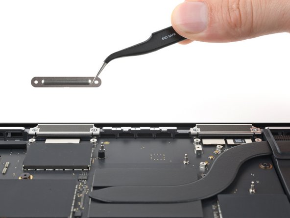

  26. MacBook Pro 14" Late 2023 (M3) Screen Replacement, Unfasten the screen connector covers: crwdns2935265:026crwdnd2935265:01crwdnd2935265:01crwdne2935265:0
    • Use your 3IP Torx Plus driver to remove the four 2.1 mm-long screws securing both screen connector covers.
  27. MacBook Pro 14" Late 2023 (M3) Screen Replacement, Remove the screen connector covers: crwdns2935265:027crwdnd2935265:01crwdnd2935265:03crwdne2935265:0 MacBook Pro 14" Late 2023 (M3) Screen Replacement, Remove the screen connector covers: crwdns2935265:027crwdnd2935265:02crwdnd2935265:03crwdne2935265:0 MacBook Pro 14" Late 2023 (M3) Screen Replacement, Remove the screen connector covers: crwdns2935265:027crwdnd2935265:03crwdnd2935265:03crwdne2935265:0
    • Remove both screen connector covers.

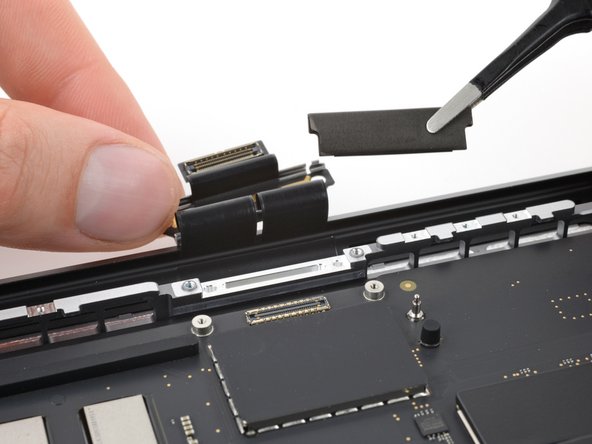

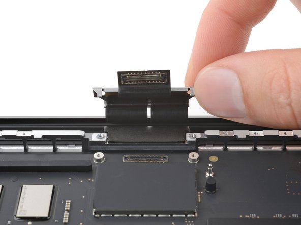

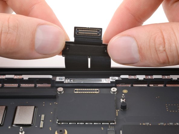

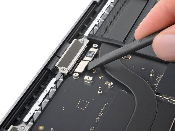

  28. MacBook Pro 14" Late 2023 (M3) Screen Replacement, Disconnect the screen: crwdns2935265:028crwdnd2935265:01crwdnd2935265:03crwdne2935265:0 MacBook Pro 14" Late 2023 (M3) Screen Replacement, Disconnect the screen: crwdns2935265:028crwdnd2935265:02crwdnd2935265:03crwdne2935265:0 MacBook Pro 14" Late 2023 (M3) Screen Replacement, Disconnect the screen: crwdns2935265:028crwdnd2935265:03crwdnd2935265:03crwdne2935265:0
    • Use the flat end of your spudger to pry up and disconnect the three screen press connectors.

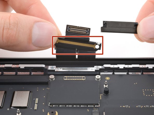

  30. MacBook Pro 14" Late 2023 (M3) Screen Replacement, Remove the cable buffer: crwdns2935265:030crwdnd2935265:01crwdnd2935265:03crwdne2935265:0 MacBook Pro 14" Late 2023 (M3) Screen Replacement, Remove the cable buffer: crwdns2935265:030crwdnd2935265:02crwdnd2935265:03crwdne2935265:0 MacBook Pro 14" Late 2023 (M3) Screen Replacement, Remove the cable buffer: crwdns2935265:030crwdnd2935265:03crwdnd2935265:03crwdne2935265:0
    • Black plastic cable buffers help route the screen cables over the frame.
    • Remove the left cable buffer from the frame.
    • The cable buffer might stay stuck in the metal bracket. If so, remove it from the bracket.
  31. MacBook Pro 14" Late 2023 (M3) Screen Replacement, Free the right screen-cable bracket: crwdns2935265:031crwdnd2935265:01crwdnd2935265:02crwdne2935265:0 MacBook Pro 14" Late 2023 (M3) Screen Replacement, Free the right screen-cable bracket: crwdns2935265:031crwdnd2935265:02crwdnd2935265:02crwdne2935265:0
    • Pry up and free the right screen-cable bracket from the frame, just as you did with the left cables.
    • Remove the cable buffer.
  32. MacBook Pro 14" Late 2023 (M3) Screen Replacement, Screen cable reassembly information: crwdns2935265:032crwdnd2935265:01crwdnd2935265:03crwdne2935265:0 MacBook Pro 14" Late 2023 (M3) Screen Replacement, Screen cable reassembly information: crwdns2935265:032crwdnd2935265:02crwdnd2935265:03crwdne2935265:0 MacBook Pro 14" Late 2023 (M3) Screen Replacement, Screen cable reassembly information: crwdns2935265:032crwdnd2935265:03crwdnd2935265:03crwdne2935265:0
    • During reassembly:
    • Insert the cable buffer into the metal bracket with the buffer's alignment pegs pointing toward the MacBook and closest to the cable's press connector.
    • Align the cable buffer's pegs with its holes in the frame.
    • Press the cable bracket onto the frame, so its metal tabs clip into place.

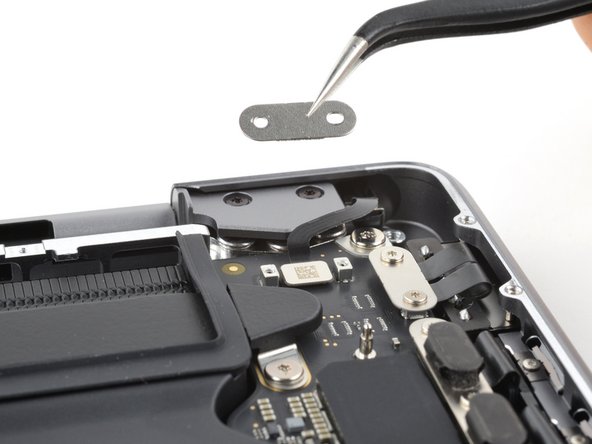

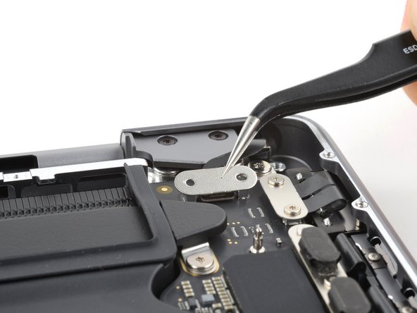

  33. MacBook Pro 14" Late 2023 (M3) Screen Replacement, Remove the lid angle sensor connector cover: crwdns2935265:033crwdnd2935265:01crwdnd2935265:03crwdne2935265:0 MacBook Pro 14" Late 2023 (M3) Screen Replacement, Remove the lid angle sensor connector cover: crwdns2935265:033crwdnd2935265:02crwdnd2935265:03crwdne2935265:0 MacBook Pro 14" Late 2023 (M3) Screen Replacement, Remove the lid angle sensor connector cover: crwdns2935265:033crwdnd2935265:03crwdnd2935265:03crwdne2935265:0
    • Use your 3IP Torx Plus driver to remove the two 2.1 mm-long screws securing the lid angle sensor connector cover.
    • Remove the cover.

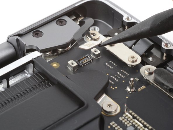

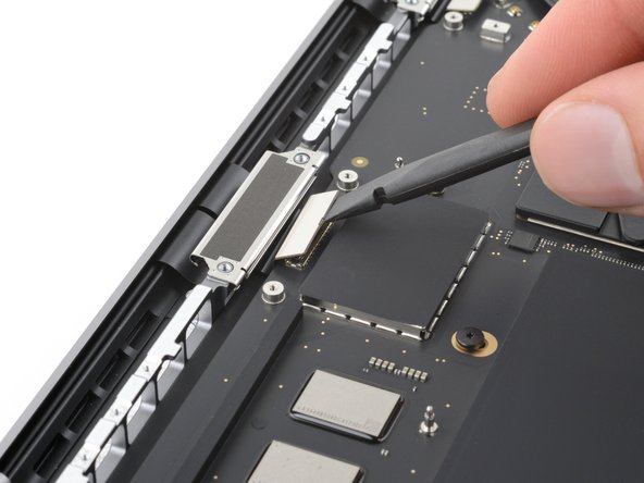

  34. MacBook Pro 14" Late 2023 (M3) Screen Replacement, Disconnect the lid angle sensor: crwdns2935265:034crwdnd2935265:01crwdnd2935265:02crwdne2935265:0 MacBook Pro 14" Late 2023 (M3) Screen Replacement, Disconnect the lid angle sensor: crwdns2935265:034crwdnd2935265:02crwdnd2935265:02crwdne2935265:0
    • Use the point of your spudger to pry up and disconnect the lid angle sensor press connector.

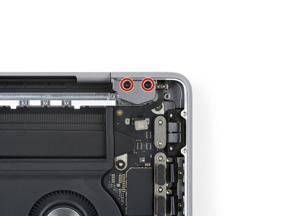

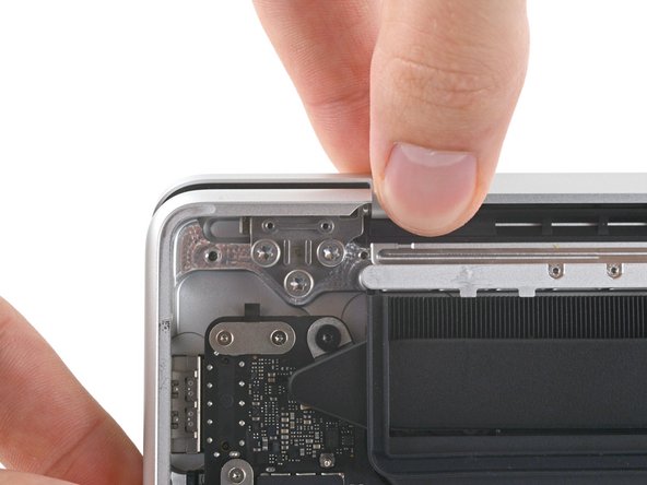

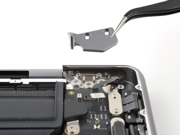

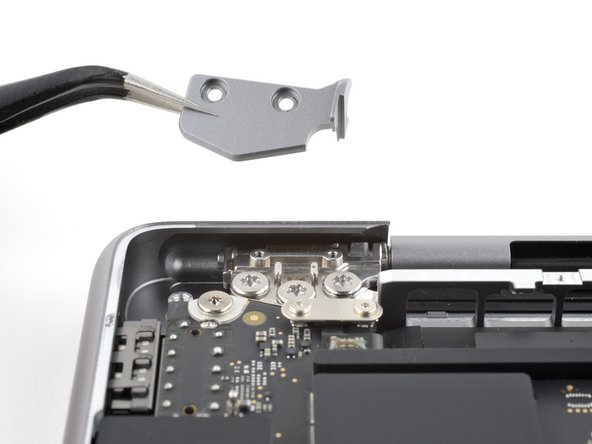

  35. MacBook Pro 14" Late 2023 (M3) Screen Replacement, Unfasten the hinge covers: crwdns2935265:035crwdnd2935265:01crwdnd2935265:02crwdne2935265:0 MacBook Pro 14" Late 2023 (M3) Screen Replacement, Unfasten the hinge covers: crwdns2935265:035crwdnd2935265:02crwdnd2935265:02crwdne2935265:0
    • Use your 5IP Torx Plus driver to remove the two 2.5 mm‑long screws securing each hinge cover (four screws in total).
  36. MacBook Pro 14" Late 2023 (M3) Screen Replacement, Remove the hinge covers: crwdns2935265:036crwdnd2935265:01crwdnd2935265:03crwdne2935265:0 MacBook Pro 14" Late 2023 (M3) Screen Replacement, Remove the hinge covers: crwdns2935265:036crwdnd2935265:02crwdnd2935265:03crwdne2935265:0 MacBook Pro 14" Late 2023 (M3) Screen Replacement, Remove the hinge covers: crwdns2935265:036crwdnd2935265:03crwdnd2935265:03crwdne2935265:0
    • Use tweezers or your fingers to slide each hinge cover away from the back edge and lift straight up to remove them.

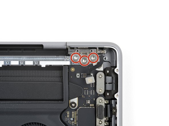

  37. MacBook Pro 14" Late 2023 (M3) Screen Replacement, Loosen the screen hinges: crwdns2935265:037crwdnd2935265:01crwdnd2935265:02crwdne2935265:0 MacBook Pro 14" Late 2023 (M3) Screen Replacement, Loosen the screen hinges: crwdns2935265:037crwdnd2935265:02crwdnd2935265:02crwdne2935265:0
    • Use a 8IP Torx Plus driver to slightly loosen the six screws securing the screen hinges.
    • Don't remove these screws just yet.

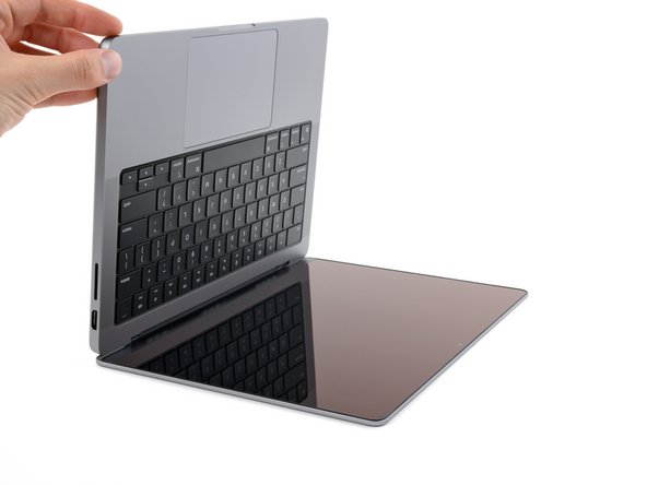

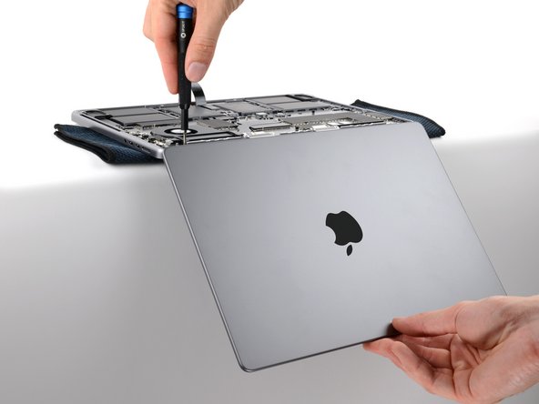

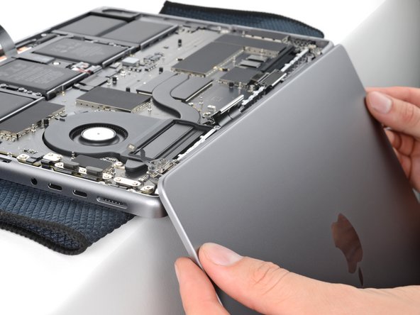

  38. MacBook Pro 14" Late 2023 (M3) Screen Replacement, Open your screen: crwdns2935265:038crwdnd2935265:01crwdnd2935265:02crwdne2935265:0 MacBook Pro 14" Late 2023 (M3) Screen Replacement, Open your screen: crwdns2935265:038crwdnd2935265:02crwdnd2935265:02crwdne2935265:0
    • Make sure there aren't any cable covers, screws, or other small components that might fall out of your MacBook when you open it.
    • Grab the body of your MacBook and open it to a 90-degree angle.

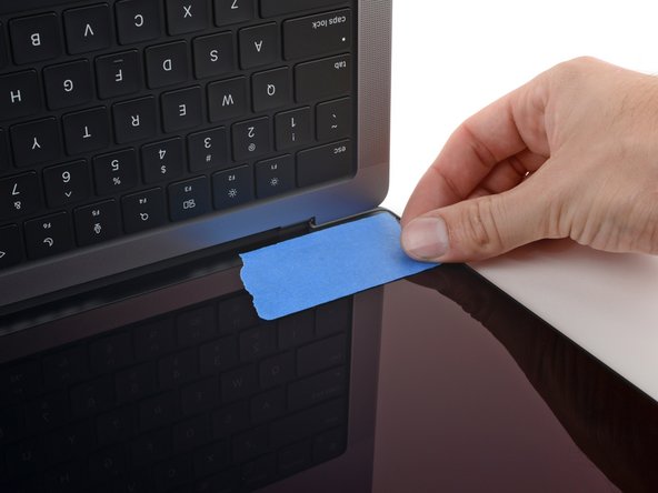

  39. MacBook Pro 14" Late 2023 (M3) Screen Replacement, Protect your screen: crwdns2935265:039crwdnd2935265:01crwdnd2935265:02crwdne2935265:0 MacBook Pro 14" Late 2023 (M3) Screen Replacement, Protect your screen: crwdns2935265:039crwdnd2935265:02crwdnd2935265:02crwdne2935265:0
    • If you plan on reusing your screen, apply a couple strips of tape to the lower corners of it to prevent scratches from the frame during removal.

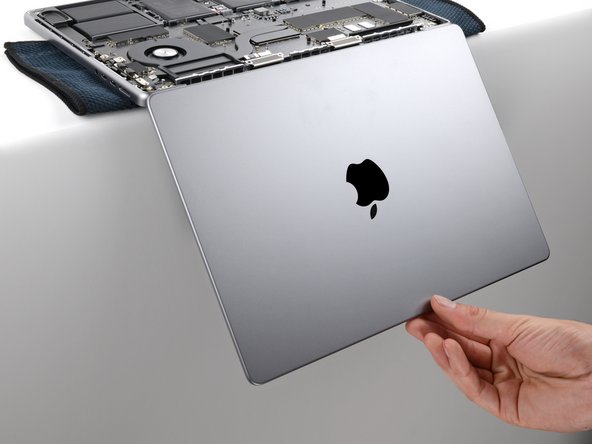

  40. MacBook Pro 14" Late 2023 (M3) Screen Replacement, Lay down the MacBook: crwdns2935265:040crwdnd2935265:01crwdnd2935265:01crwdne2935265:0
    • Place a soft cloth on the edge of a table or your work surface.
    • Lay your MacBook keyboard-side down on the edge of your work surface with the screen hanging straight down.
    • Make sure your MacBook doesn't tip over while you work.

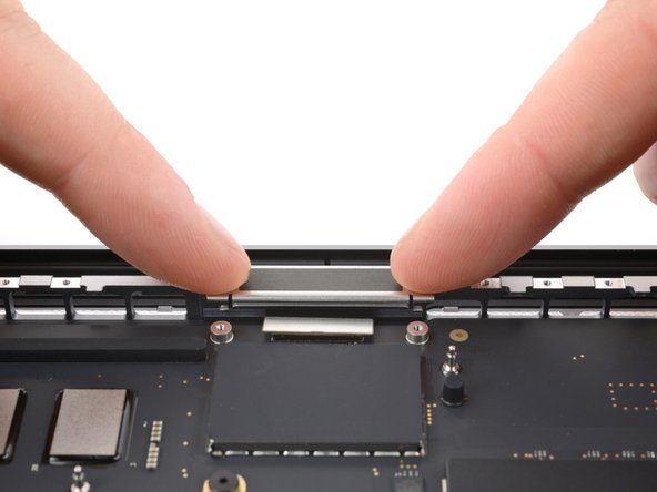

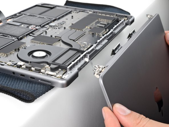

  41. MacBook Pro 14" Late 2023 (M3) Screen Replacement, Fully open the screen: crwdns2935265:041crwdnd2935265:01crwdnd2935265:02crwdne2935265:0 MacBook Pro 14" Late 2023 (M3) Screen Replacement, Fully open the screen: crwdns2935265:041crwdnd2935265:02crwdnd2935265:02crwdne2935265:0
    • Keep the main body secured against your work surface and open the screen as far as it will go.
    • Keep your screen supported with one hand for the next two steps.

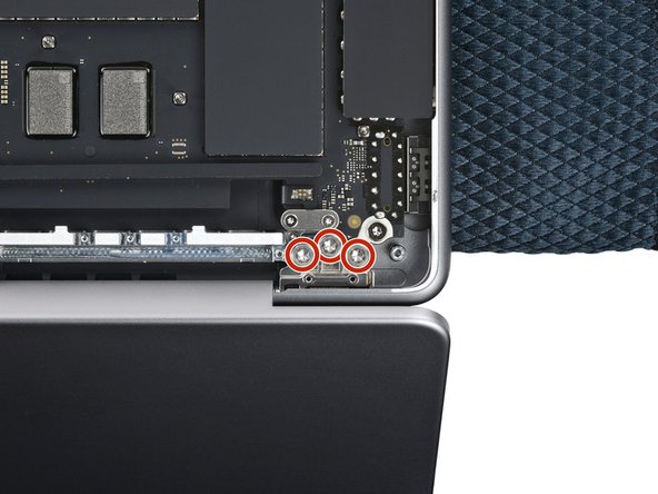

  42. MacBook Pro 14" Late 2023 (M3) Screen Replacement, Remove the hinge screws: crwdns2935265:042crwdnd2935265:01crwdnd2935265:03crwdne2935265:0 MacBook Pro 14" Late 2023 (M3) Screen Replacement, Remove the hinge screws: crwdns2935265:042crwdnd2935265:02crwdnd2935265:03crwdne2935265:0 MacBook Pro 14" Late 2023 (M3) Screen Replacement, Remove the hinge screws: crwdns2935265:042crwdnd2935265:03crwdnd2935265:03crwdne2935265:0
    • Use your 8IP Torx Plus driver to remove the six 5.2 mm-long screws securing the screen hinges.
  43. MacBook Pro 14" Late 2023 (M3) Screen Replacement, Lower the screen: crwdns2935265:043crwdnd2935265:01crwdnd2935265:01crwdne2935265:0
    • Slowly begin to close the screen so it hangs straight down again.
  44. MacBook Pro 14" Late 2023 (M3) Screen Replacement, Remove the screen: crwdns2935265:044crwdnd2935265:01crwdnd2935265:03crwdne2935265:0 MacBook Pro 14" Late 2023 (M3) Screen Replacement, Remove the screen: crwdns2935265:044crwdnd2935265:02crwdnd2935265:03crwdne2935265:0 MacBook Pro 14" Late 2023 (M3) Screen Replacement, Remove the screen: crwdns2935265:044crwdnd2935265:03crwdnd2935265:03crwdne2935265:0
    • Lift the left hinge up and out of its recess in the frame.
    • Be careful not to touch the hinge to any connectors or components on the logic board.
    • Repeat for the right hinge.
    • Remove the screen.
  45. MacBook Pro 14" Late 2023 (M3) Screen Replacement, Reassembly information: crwdns2935265:045crwdnd2935265:01crwdnd2935265:02crwdne2935265:0 MacBook Pro 14" Late 2023 (M3) Screen Replacement, Reassembly information: crwdns2935265:045crwdnd2935265:02crwdnd2935265:02crwdne2935265:0
    • During reassembly, follow these instructions to align your screen hinges:
    • If you have blue threadlocker, apply a drop to each screw's threads to prevent them from loosening over time.
    • Install the hinge screws without fully tightening them. Center the hinges and check for gaps or rubbing on either side.
    • Fully tighten the hinge screws.
    • If your screen clicks or snaps when it's opened or closed, loosen the screws and realign the screen.
