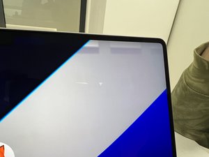

I got same issues on my Macbook Pro 14"
Eljohn - the artifacts would be along the top in rectangular form. Your images don’t show that. What you maybe seeing is a shadow area along the sides if I follow what you are seeing. This is a different issue. Often times it’s the dispersion sheets curling from heat or wetness (humidity).

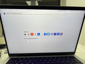

I've same problem that Eljon faced. I don't if that's normal? please explain
Shadow on the edges
@m.m709 - The issue is the light dispersion sheets curling from heat or wetness (humidity).
Visit an Apple Store to see if they will do a warranty exception if you haven’t caused excessive heat to humidity to your system. Don’t hold your breath 😩

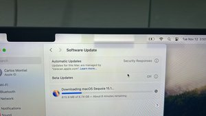

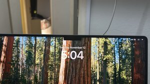

Today 11/12/2024
Update to the latest MacOS Sequoia 15.2 Beta 3 and you will have NO ARTIFACTS AT ALL
I bought from ebay an Macbook 2021 M1 Max with this issue and i updated it to this version i all the artifacts disappeared
Before installing the update
PS: on 15.1 i still had the artifacts, just on the 15.2 Beta 3 the artifacts were gone

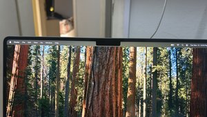

After

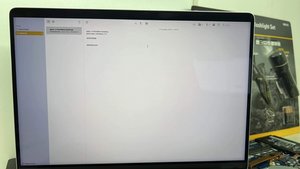

This is the second time the screen has been replaced under warranty
@liortahan - Without more details this doesn’t offer anything!
Why was the display replaced before? What does it need to be replaced again?
You show a bit of the diagnostic screen which doesn’t tell us what are the failing error codes so we could even try to look them up in English as we don’t speak Thai (if I guessed correctly).
There is nothing wrong with your screen, mine looks the same. If you look at angle the edges always look blue, even straight on the edges are slightly darker. It's just as a result of the backlight.
