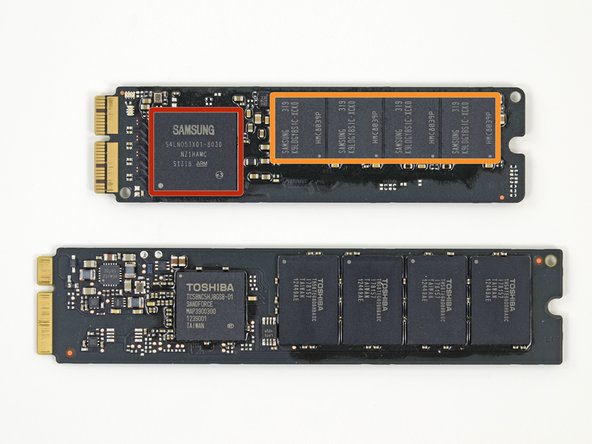

    • In order to achieve flash storage that's "up to 45 percent faster" than the previous model, Apple switched from SATA to PCIe, and turned to its best pal in the industry: Samsung.
    • In this case we find:
    • Samsung S4LN053X01-8030 (ARM) flash controller
    • 8 x Samsung K9LDGY8SIC-XCK0 16 GB flash storage
    • Samsung K4P2G324ED 512 MB RAM (the same RAM used in the Raspberry Pi)
    • We didn't run any tests to verify that the PCIe-based Samsung SSD is indeed that much faster than last year's Toshiba SATA module, but we can definitely say that the drive is smaller and not compatible with previous MacBook Air models, making it harder to find parts if you want to upgrade.

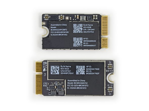

    • Next out is the totally redesigned AirPort card, providing 802.11ac Wi-Fi connectivity.
    • While the current and prior generations' Airport cards will fit in each others' logic board slots, their different lengths will prevent you from fastening them down. We haven't yet tested for compatibility beyond this.
    • At the heart of the card we find a Broadcom BCM4360, which enables operation on the 5 GHz band at speeds up to 1.3 Gbps and communication via Bluetooth 4.0.
    • Also on the board is a Skyworks SE5516 dual-band 802.11 a/b/g/n/ac WLAN front-end module.

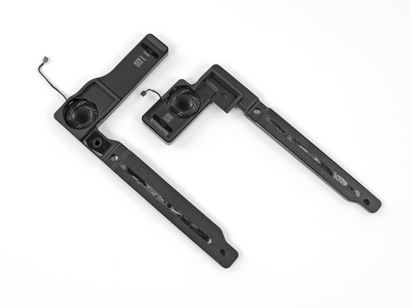

    • What's that sound? Oh, it's just the MacBook Air's stereo speakers.
    • Other than the aforementioned change in the direction of one of the speaker cables, these appear to be the same speakers found in last year's model.
    • Some computer and smartphone manufacturers like to emphasize an industry partner's audio systems in their marketing. Apple is not one of those companies, simply listing the noisemakers in the MacBook Air as "stereo speakers."

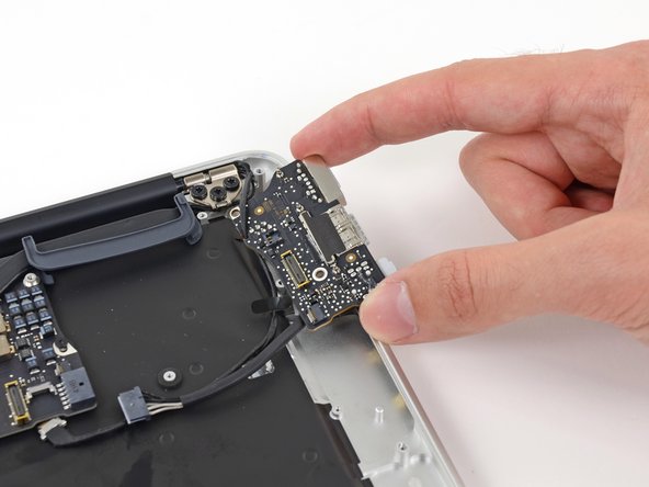

  9. MacBook Air 13" Mid 2013 Teardown: crwdns2935265:09crwdnd2935265:01crwdnd2935265:03crwdne2935265:0 MacBook Air 13" Mid 2013 Teardown: crwdns2935265:09crwdnd2935265:02crwdnd2935265:03crwdne2935265:0 MacBook Air 13" Mid 2013 Teardown: crwdns2935265:09crwdnd2935265:03crwdnd2935265:03crwdne2935265:0

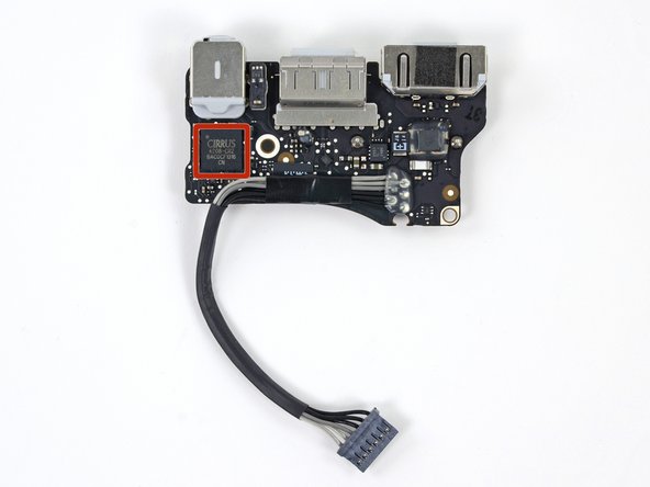

    • The I/O board in the MacBook Air is mostly unchanged from last year, except that it no longer has a socket for the iSight cable.
    • We find a Cirrus chip marked 4208-CRZ next to the headphone jack. This appears to be a two-channel version of the CS4207 low power HD audio codec with headphone amp.

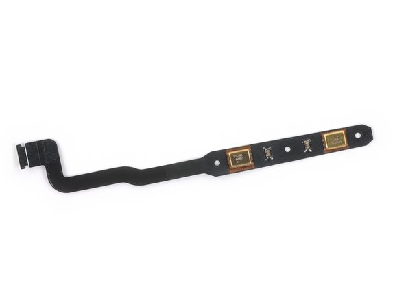

  10. MacBook Air 13" Mid 2013 Teardown: crwdns2935265:010crwdnd2935265:01crwdnd2935265:03crwdne2935265:0 MacBook Air 13" Mid 2013 Teardown: crwdns2935265:010crwdnd2935265:02crwdnd2935265:03crwdne2935265:0 MacBook Air 13" Mid 2013 Teardown: crwdns2935265:010crwdnd2935265:03crwdnd2935265:03crwdne2935265:0

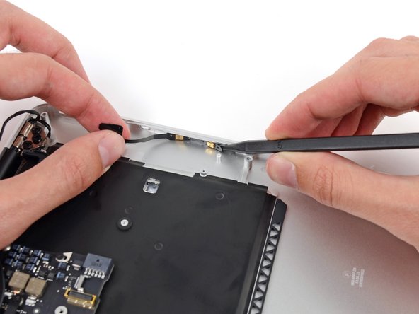

    • If one microphone was good in last year's MacBook Air, then two microphones in this year's model must be better!
    • As in the iPhone, the Air's dual microphones help cut out background noise while you're making a FaceTime call or dictating important memos.

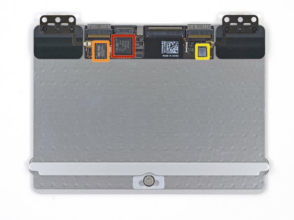

    • As in most other unibody MacBooks, the Air's trackpad is held to the upper case with six tiny Phillips screws and comes out without much hassle.
    • In addition to a plethora of connectors, we find the following chips on the trackpad board:
    • STMicroelectronics STM32F103VB microcontroller
    • MXIC MX25L2006E 2 Mb serial flash
    • Broadcom BCM5976A0KUB2G trackpad controller

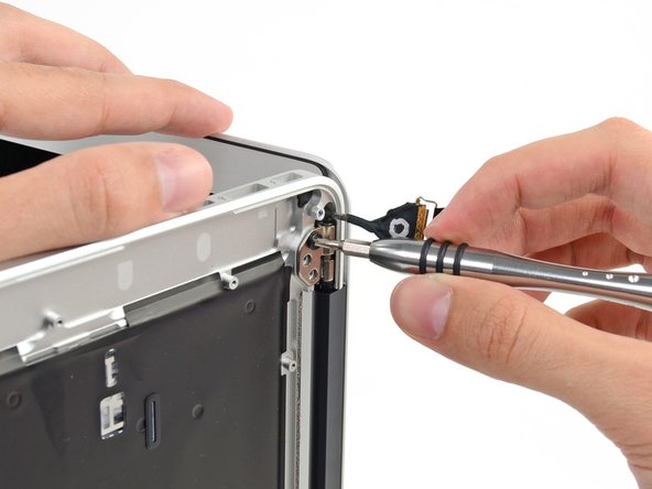

    • Finally, we free the display assembly from the upper case by removing the Phillips screws that secure the two hinges.
