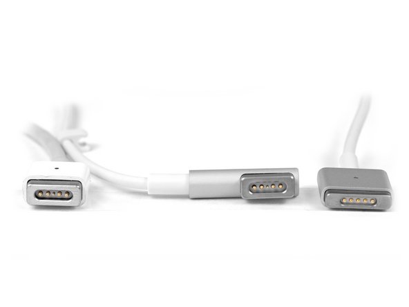

  4. MacBook Air 13" Mid 2012 Teardown: crwdns2935265:04crwdnd2935265:01crwdnd2935265:02crwdne2935265:0 MacBook Air 13" Mid 2012 Teardown: crwdns2935265:04crwdnd2935265:02crwdnd2935265:02crwdne2935265:0
    • MagSafe 2 is a luxury reserved (so far) for the new MacBook Air and the Retina display-equipped MacBook Pro.
    • As you can see, the new MagSafe 2 connector (bottom) is much thinner and wider than its predecessor. This is pretty significant, because the thickness of Apple's devices seems to be limited only by the size of their ports.
    • Imagine how thin of a device they could make if all communication and charging were done wirelessly…
    • Apple sells a $10 MagSafe 2 adapter, so you don't have to throw away your 27" Thunderbolt Display. Phew.

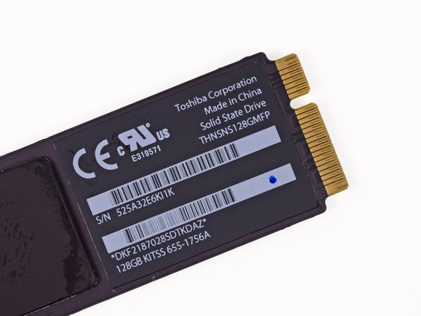

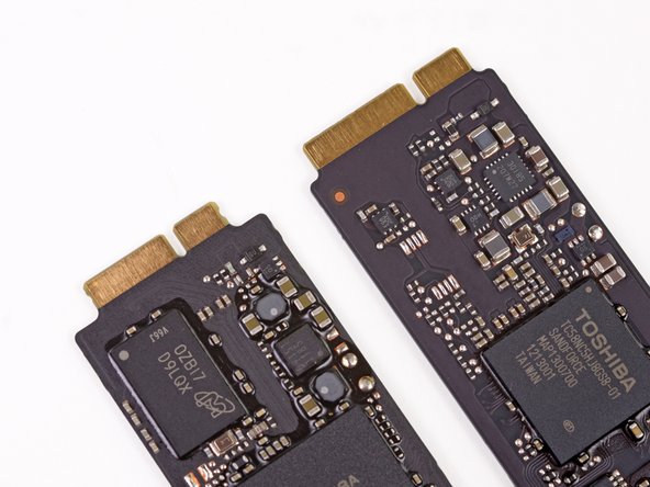

  8. MacBook Air 13" Mid 2012 Teardown: crwdns2935265:08crwdnd2935265:01crwdnd2935265:03crwdne2935265:0 MacBook Air 13" Mid 2012 Teardown: crwdns2935265:08crwdnd2935265:02crwdnd2935265:03crwdne2935265:0 MacBook Air 13" Mid 2012 Teardown: crwdns2935265:08crwdnd2935265:03crwdnd2935265:03crwdne2935265:0
    • At first glance, the 128 GB SSD is almost exactly the same as last year's.
    • But upon closer inspection, the connector for this model's flash memory module is slightly different than last year!
    • The SSD looks to be a completely new design. The new unit appears to be based on a SandForce controller chip, but stamped with Toshiba markings.

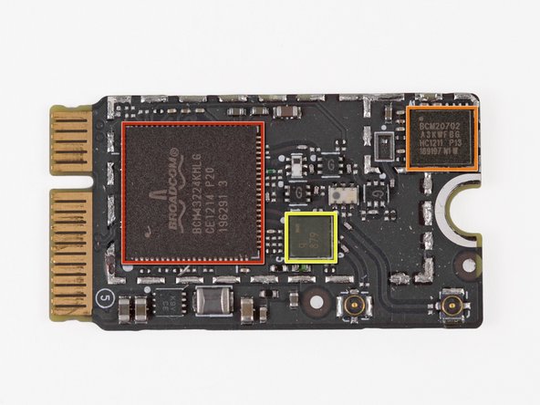

  9. MacBook Air 13" Mid 2012 Teardown: crwdns2935265:09crwdnd2935265:01crwdnd2935265:01crwdne2935265:0

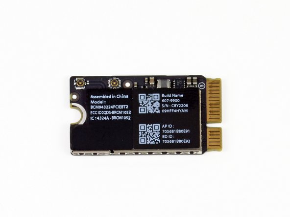

  10. MacBook Air 13" Mid 2012 Teardown: crwdns2935265:010crwdnd2935265:01crwdnd2935265:03crwdne2935265:0 MacBook Air 13" Mid 2012 Teardown: crwdns2935265:010crwdnd2935265:02crwdnd2935265:03crwdne2935265:0 MacBook Air 13" Mid 2012 Teardown: crwdns2935265:010crwdnd2935265:03crwdnd2935265:03crwdne2935265:0
    • We would tell you that this Broadcom BCM 943224 module looks just like the Mid 2011 MacBook Air's wireless board, but you would accuse us of being repetitive.
    • Instead, let's focus on what's different. Apple rotated the "Assembled in China" sticker 90˚ and flipped the internal code sticker a whopping 180˚!
    • In case you thought we were joking, taking the EMI shield off reveals the same chips as last year:
    • Broadcom BCM4322 Intensi-fi® Single-Chip 802.11n Wi-Fi Transceiver
    • Broadcom BCM20702 Single-Chip Bluetooth 4.0 Processor with Bluetooth Low Energy (BLE) support
    • Murata antenna switch module

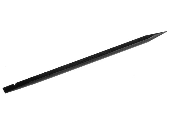

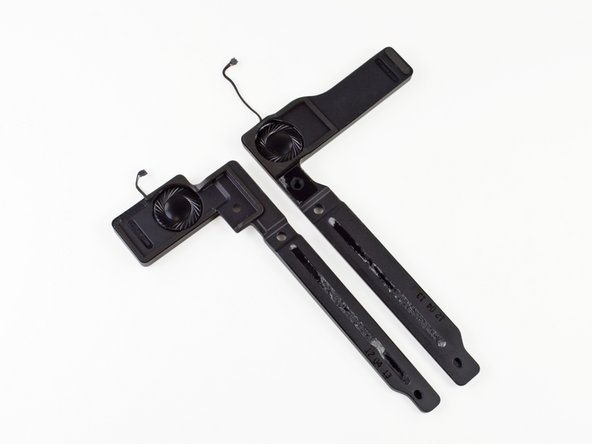

    • Next up are the speakers.
    • The new Air boasts stereo speakers for all your Apple party needs. Just in case you want to party like it's 2011 or 2010...
    • You may be asking, "What's that black stick being used to remove the speaker?" That is a Spudger. It's ESD safe and heat/solder resistant. It's a must for working with sensitive electronics.

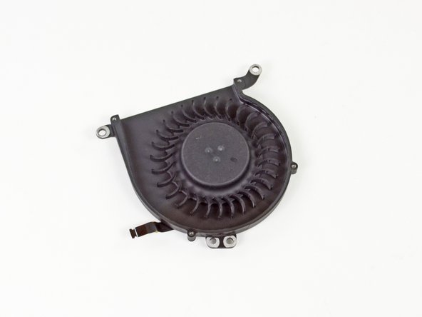

  12. MacBook Air 13" Mid 2012 Teardown: crwdns2935265:012crwdnd2935265:01crwdnd2935265:02crwdne2935265:0 MacBook Air 13" Mid 2012 Teardown: crwdns2935265:012crwdnd2935265:02crwdnd2935265:02crwdne2935265:0
    • A few more Torx screws hold the lonely fan in place.
    • We were hoping to find a new asymmetrical fan, and we were not disappointed!
    • The wider gaps in the fan blades are around 3.6 mm, while the narrower ones are approximately 2.8 mm.
    • If you're not familiar with all the hype, the "asymmetrical" design of the fan blades is supposed to disperse sound across a wide range of frequencies, rather than just one, making fan noise "hardly perceivable."

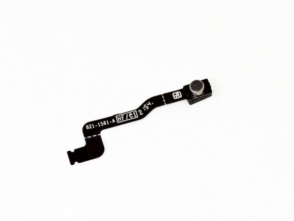

  14. MacBook Air 13" Mid 2012 Teardown: crwdns2935265:014crwdnd2935265:01crwdnd2935265:02crwdne2935265:0 MacBook Air 13" Mid 2012 Teardown: crwdns2935265:014crwdnd2935265:02crwdnd2935265:02crwdne2935265:0
    • With dictation coming in OSX Mountain Lion, you're going to want to make sure you've got a brand spankin' new microphone.
    • "MacBook, send a message to my iPhone so that I can talk to Siri."

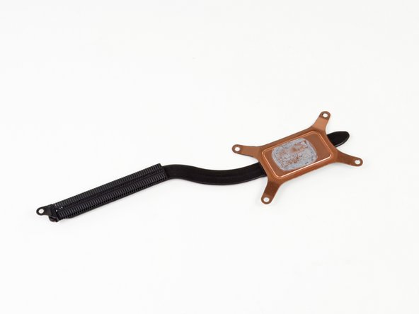

  15. MacBook Air 13" Mid 2012 Teardown: crwdns2935265:015crwdnd2935265:01crwdnd2935265:03crwdne2935265:0 MacBook Air 13" Mid 2012 Teardown: crwdns2935265:015crwdnd2935265:02crwdnd2935265:03crwdne2935265:0 MacBook Air 13" Mid 2012 Teardown: crwdns2935265:015crwdnd2935265:03crwdnd2935265:03crwdne2935265:0
    • Boom! There goes the logic board.
    • Bam! There goes the heat sink.
    • Even with a new processor lineup, the thermal management system looks pretty much the same as last year. It truly is a testament to modern processor efficiency to see such a small heat sink on a dual-core processor that can crank out up to 2.8 GHz.

Sad to hear, that the SSD-connection port has been changed.
So after i've upgraded my 2010er MBA 11" and my late 13" MBA with OWC 240GB SSD-Bladed (3G & 6G) they will be worthless when i wanna buy a small 11" 2012er MBA and upgrade it ? -> Yes !
I can understand that the Retina MBP got a different SSD-Blade size, but changing the connection port within the MBA-family is nonsense.....

The different connector was probably because the SSDs are electronically incompatible, not just to frustrate DIYers.
