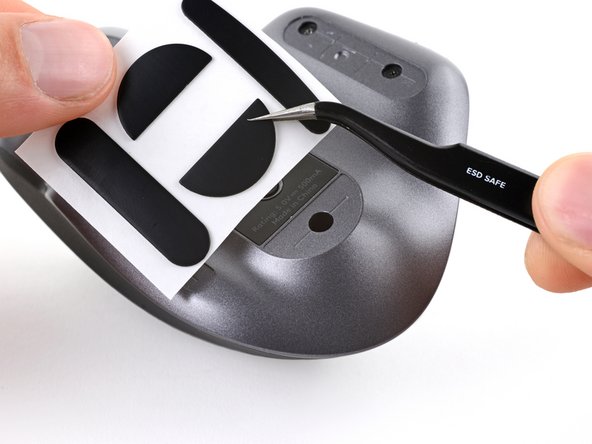

  1. Logitech MX Master 3S Battery Replacement, Soften the mouse feet adhesive: crwdns2935265:01crwdnd2935265:01crwdnd2935265:03crwdne2935265:0 Logitech MX Master 3S Battery Replacement, Soften the mouse feet adhesive: crwdns2935265:01crwdnd2935265:02crwdnd2935265:03crwdne2935265:0 Logitech MX Master 3S Battery Replacement, Soften the mouse feet adhesive: crwdns2935265:01crwdnd2935265:03crwdnd2935265:03crwdne2935265:0
    • Flip the mouse's power switch into the OFF position, unplug any cables, and flip it over so the feet are facing up.
    • The unique shape of some mice can prevent them from laying flat. If you need to, lay your mouse on a soft towel to prevent wobble.
    • If you're planning to reuse your existing mouse feet, note that the adhesive needs to be thoroughly heated for them to be cleanly removed.
    • Heat an iOpener and apply it to each of the mouse feet for about one minute each.
    • Alternatively, you can use a hair dryer to soften the mouse feet adhesive.
    • When using a hair dryer, don't heat the feet for more than a couple seconds at a time—anything hotter than just warm to the touch risks melting or warping the plastic lower case.
    • The information sticker adhesive may soften during this step, but you don't need to remove it.

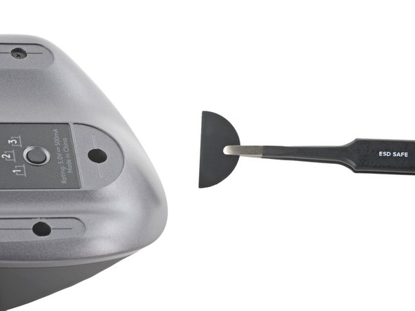

  2. Logitech MX Master 3S Battery Replacement, Separate the mouse foot adhesive: crwdns2935265:02crwdnd2935265:01crwdnd2935265:03crwdne2935265:0 Logitech MX Master 3S Battery Replacement, Separate the mouse foot adhesive: crwdns2935265:02crwdnd2935265:02crwdnd2935265:03crwdne2935265:0 Logitech MX Master 3S Battery Replacement, Separate the mouse foot adhesive: crwdns2935265:02crwdnd2935265:03crwdnd2935265:03crwdne2935265:0
    • Slide an opening pick under an edge of the left mouse foot.
    • Go slowly, and make sure the pick slides underneath both the foot and its adhesive pad. These layers separate easily.
    • If you plan on reusing your mouse feet, be careful not to crease them or separate them from their adhesive pads.
    • If the foot feels stuck, apply more heat before continuing.
    • Slide your pick under the foot to separate its adhesive until you can grab it with your fingers.
    • Peel up and remove the left mouse foot.
  3. Logitech MX Master 3S Battery Replacement, Remove the remaining feet: crwdns2935265:03crwdnd2935265:01crwdnd2935265:03crwdne2935265:0 Logitech MX Master 3S Battery Replacement, Remove the remaining feet: crwdns2935265:03crwdnd2935265:02crwdnd2935265:03crwdne2935265:0 Logitech MX Master 3S Battery Replacement, Remove the remaining feet: crwdns2935265:03crwdnd2935265:03crwdnd2935265:03crwdne2935265:0
    • Repeat the previous two steps for the three remaining feet.
    • The front foot doesn't cover any screws—if you're only removing the mouse feet to open up the mouse, you don't need to remove this foot.

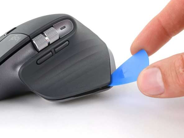

  6. Logitech MX Master 3S Battery Replacement, Release the left clips: crwdns2935265:06crwdnd2935265:01crwdnd2935265:03crwdne2935265:0 Logitech MX Master 3S Battery Replacement, Release the left clips: crwdns2935265:06crwdnd2935265:02crwdnd2935265:03crwdne2935265:0 Logitech MX Master 3S Battery Replacement, Release the left clips: crwdns2935265:06crwdnd2935265:03crwdnd2935265:03crwdne2935265:0
    • Insert your opening pick into the seam between the thumb rest and the lower case.
    • Slide your pick right, towards the rear of the upper shell and pry upward to release the left clips.
  7. Logitech MX Master 3S Battery Replacement, Release the right clips: crwdns2935265:07crwdnd2935265:01crwdnd2935265:02crwdne2935265:0 Logitech MX Master 3S Battery Replacement, Release the right clips: crwdns2935265:07crwdnd2935265:02crwdnd2935265:02crwdne2935265:0
    • Gently pry the upper shell and lower case apart to release the clips on the right side of the mouse.
    • Don't try to fully remove the top shell just yet—another clip and a delicate cable connect the upper shell to the lower case.

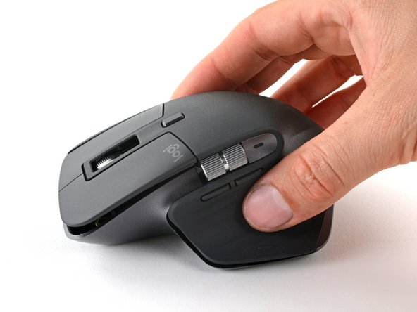

  8. Logitech MX Master 3S Battery Replacement, Release the final clip: crwdns2935265:08crwdnd2935265:01crwdnd2935265:03crwdne2935265:0 Logitech MX Master 3S Battery Replacement, Release the final clip: crwdns2935265:08crwdnd2935265:02crwdnd2935265:03crwdne2935265:0 Logitech MX Master 3S Battery Replacement, Release the final clip: crwdns2935265:08crwdnd2935265:03crwdnd2935265:03crwdne2935265:0
    • Lay your mouse down onto your work surface, making sure none of the clips re-engage.
    • Grasp the upper shell and partially lift up the right edge.
    • Pull the upper shell up and back to release the final clip and separate the upper shell from the lower case.
    • Still keep the two halves close together—a cable is still tethered to the upper shell.
    • To reinstall the upper shell, slide the front edge into place first, then press down around the perimeter of the upper shell to engage the remaining clips.

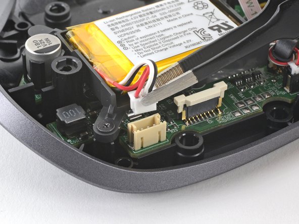

  12. Logitech MX Master 3S Battery Replacement, Disconnect the battery: crwdns2935265:012crwdnd2935265:01crwdnd2935265:03crwdne2935265:0 Logitech MX Master 3S Battery Replacement, Disconnect the battery: crwdns2935265:012crwdnd2935265:02crwdnd2935265:03crwdne2935265:0 Logitech MX Master 3S Battery Replacement, Disconnect the battery: crwdns2935265:012crwdnd2935265:03crwdnd2935265:03crwdne2935265:0
    • Use a pair of tweezers to grip the top of the battery connector.
    • Always pull cables by their connectors and not the wires themselves.
    • Gently rock the connector side to side and pull it out of its socket.
    • The connector is held tightly within its socket. If it feels stuck, try a different grip—use the protrusions around the neck of the connector if you need more leverage.
    • If the connector won't budge, skip to the next step for an alternate method.
  13. Logitech MX Master 3S Battery Replacement, Disconnect the battery with tweezers: crwdns2935265:013crwdnd2935265:01crwdnd2935265:03crwdne2935265:0 Logitech MX Master 3S Battery Replacement, Disconnect the battery with tweezers: crwdns2935265:013crwdnd2935265:02crwdnd2935265:03crwdne2935265:0 Logitech MX Master 3S Battery Replacement, Disconnect the battery with tweezers: crwdns2935265:013crwdnd2935265:03crwdnd2935265:03crwdne2935265:0
    • If your battery connector still feels stuck:
    • Insert each arm of a pair of pointed tweezers into the cutouts on the side of the battery connector's motherboard socket.
    • Push the connector up, just enough to grip the top of the connector with another pair of tweezers or your fingers.
    • Pull the battery connector completely out of its socket to disconnect it.

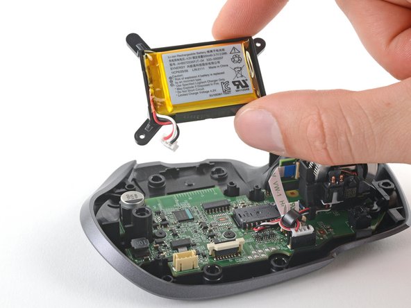

  18. Logitech MX Master 3S Battery Replacement, Remove the battery: crwdns2935265:018crwdnd2935265:01crwdnd2935265:03crwdne2935265:0 Logitech MX Master 3S Battery Replacement, Remove the battery: crwdns2935265:018crwdnd2935265:02crwdnd2935265:03crwdne2935265:0 Logitech MX Master 3S Battery Replacement, Remove the battery: crwdns2935265:018crwdnd2935265:03crwdnd2935265:03crwdne2935265:0
    Tesa 61395 Tape
    $5.99
    • Remove the battery.

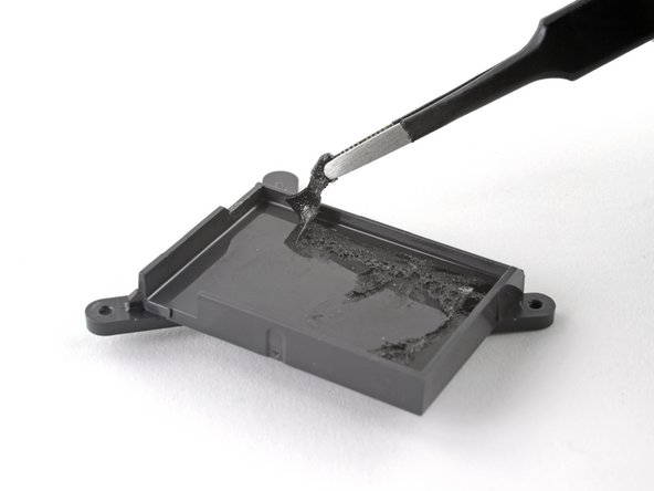

    • To install a new battery:
    • Use a spudger or your fingers to peel any old adhesive off of the battery housing. The old adhesive shouldn't leave any residue.
    • If your new battery doesn't come with preinstalled adhesive, place a couple strips of double-sided tape into the battery housing.
    • Orient your new battery so its cables route through the cutout in the corner of the housing. Press the battery firmly into place to secure it.
Compare your new replacement part to the original part—you may need to transfer remaining components or remove adhesive backings from the new part before you install it.
