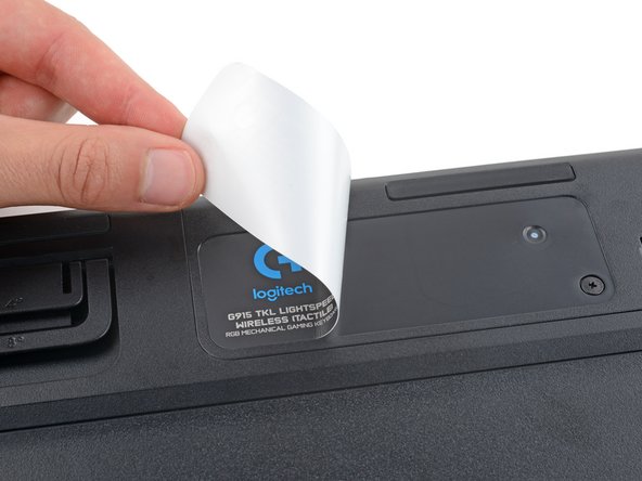

  2. Logitech G915 TKL Battery Replacement, Remove the sticker: crwdns2935265:02crwdnd2935265:01crwdnd2935265:02crwdne2935265:0 Logitech G915 TKL Battery Replacement, Remove the sticker: crwdns2935265:02crwdnd2935265:02crwdnd2935265:02crwdne2935265:0
    • The Logitech sticker hides two battery cover screws.

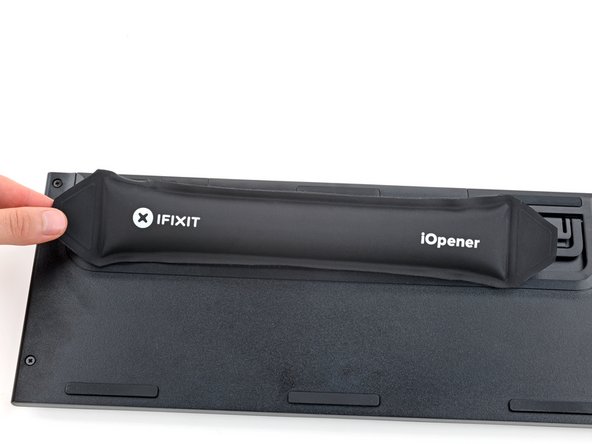

    • Heat an iOpener and lay it on the Logitech sticker for one minute.
    • Alternatively, you can use a hair dryer to heat the sticker. Make sure it's on the Low setting to avoid warping the plastic.
  3. Logitech G915 TKL Battery Replacement: crwdns2935265:03crwdnd2935265:01crwdnd2935265:03crwdne2935265:0 Logitech G915 TKL Battery Replacement: crwdns2935265:03crwdnd2935265:02crwdnd2935265:03crwdne2935265:0 Logitech G915 TKL Battery Replacement: crwdns2935265:03crwdnd2935265:03crwdnd2935265:03crwdne2935265:0

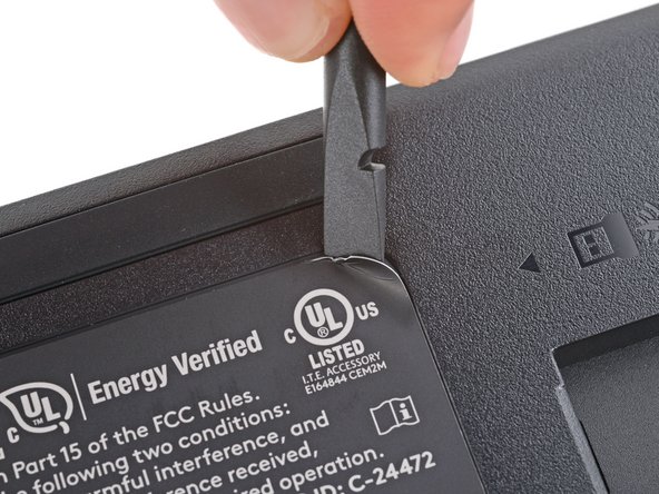

    • If you don't want to remove the whole sticker, you can just peel up the bottom left and right corners until you can access the screws.
    • Use a spudger or your fingernail to peel up a corner of the sticker until you can grip it with your fingers.
    • Peel up the sticker with your fingers and remove it.

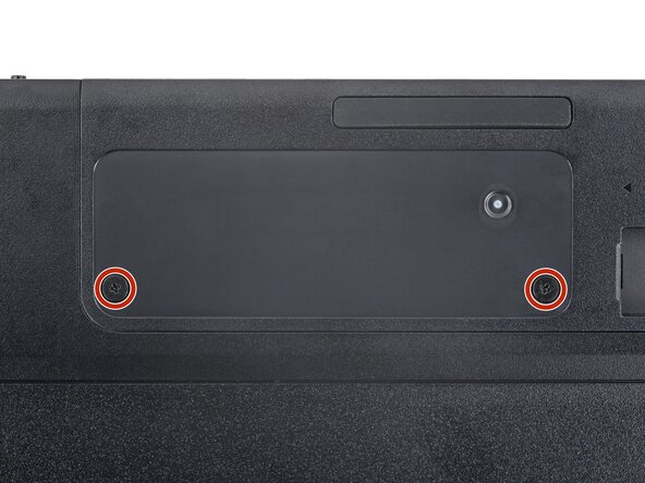

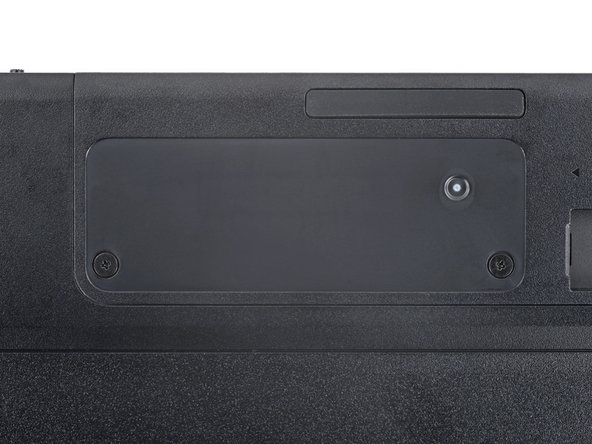

  4. Logitech G915 TKL Battery Replacement, Remove the battery cover screws: crwdns2935265:04crwdnd2935265:01crwdnd2935265:02crwdne2935265:0 Logitech G915 TKL Battery Replacement, Remove the battery cover screws: crwdns2935265:04crwdnd2935265:02crwdnd2935265:02crwdne2935265:0
    • Use a Phillips screwdriver to remove the two 4 mm‑long screws securing the battery cover.

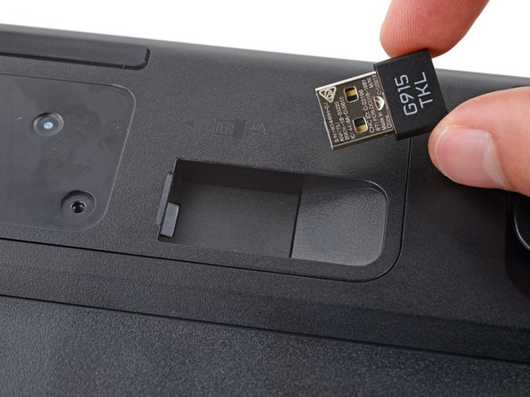

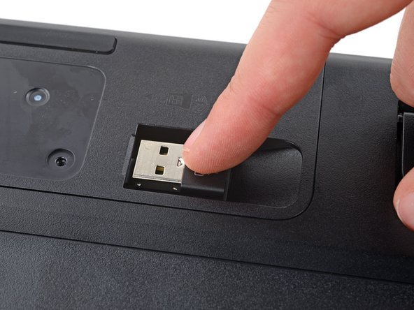

  5. Logitech G915 TKL Battery Replacement, Remove the USB receiver: crwdns2935265:05crwdnd2935265:01crwdnd2935265:03crwdne2935265:0 Logitech G915 TKL Battery Replacement, Remove the USB receiver: crwdns2935265:05crwdnd2935265:02crwdnd2935265:03crwdne2935265:0 Logitech G915 TKL Battery Replacement, Remove the USB receiver: crwdns2935265:05crwdnd2935265:03crwdnd2935265:03crwdne2935265:0
    • If you have a USB receiver stored in the battery cover compartment, use your finger to slide it out and remove it.

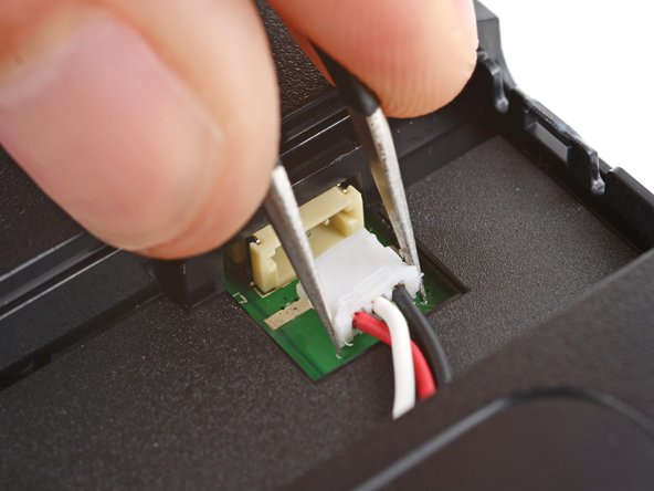

  7. Logitech G915 TKL Battery Replacement, Disconnect the battery: crwdns2935265:07crwdnd2935265:01crwdnd2935265:02crwdne2935265:0 Logitech G915 TKL Battery Replacement, Disconnect the battery: crwdns2935265:07crwdnd2935265:02crwdnd2935265:02crwdne2935265:0
    • Use a pair of angled tweezers to firmly grip the battery connector.
    • Hold the tweezers with your fingers as close to the connector as possible to get a firm grip.
    • Slide the connector straight out of its socket.
    • If you're having trouble, gently rock the connector side-to-side to help loosen it.

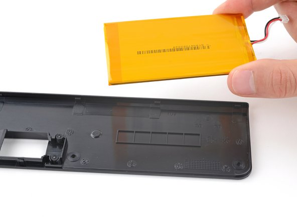

  9. Logitech G915 TKL Battery Replacement, Install the new battery: crwdns2935265:09crwdnd2935265:01crwdnd2935265:03crwdne2935265:0 Logitech G915 TKL Battery Replacement, Install the new battery: crwdns2935265:09crwdnd2935265:02crwdnd2935265:03crwdne2935265:0 Logitech G915 TKL Battery Replacement, Install the new battery: crwdns2935265:09crwdnd2935265:03crwdnd2935265:03crwdne2935265:0

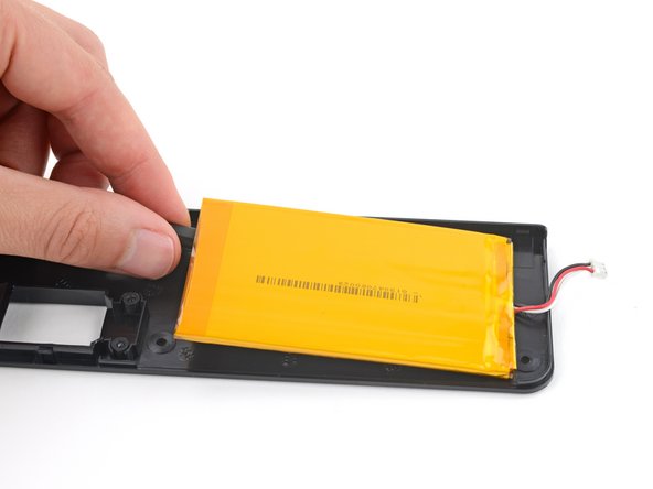

    • If your replacement battery comes attached to a new battery cover, skip the next three steps. Otherwise, follow the next three steps to remove the old battery from the cover and install your new one.
    • Light adhesive secures the battery to its cover.
    • Gently slide the flat end of a spudger under one of the short edges of the battery and lift to separate the adhesive.
    • Be very careful not to puncture the battery, as it can leak dangerous chemicals or catch fire.
    • Remove the battery from its cover.

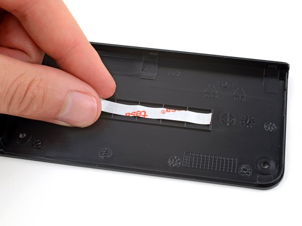

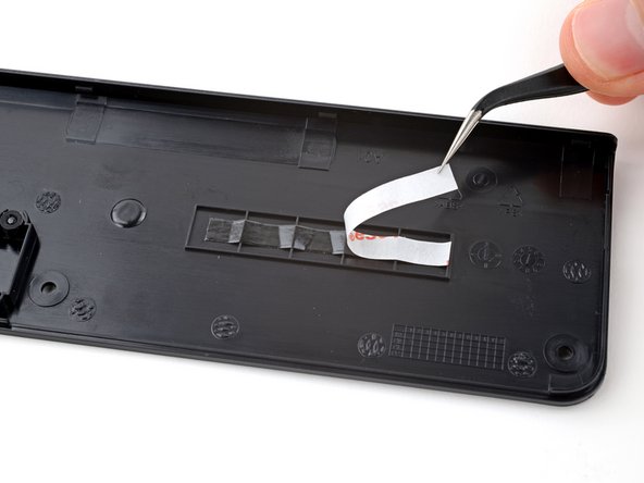

  10. Logitech G915 TKL Battery Replacement: crwdns2935265:010crwdnd2935265:01crwdnd2935265:03crwdne2935265:0 Logitech G915 TKL Battery Replacement: crwdns2935265:010crwdnd2935265:02crwdnd2935265:03crwdne2935265:0 Logitech G915 TKL Battery Replacement: crwdns2935265:010crwdnd2935265:03crwdnd2935265:03crwdne2935265:0
    Tesa 61395 Tape
    $5.99
    • Cut a piece of double-sided tape so it fits on the line of squares on the inside of the battery cover.
    • Press the tape firmly into place on the squares and remove the liner.
