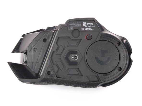

  6. Logitech G502 Lightspeed Battery Replacement, Remove the weight hatch: crwdns2935265:06crwdnd2935265:01crwdnd2935265:03crwdne2935265:0 Logitech G502 Lightspeed Battery Replacement, Remove the weight hatch: crwdns2935265:06crwdnd2935265:02crwdnd2935265:03crwdne2935265:0 Logitech G502 Lightspeed Battery Replacement, Remove the weight hatch: crwdns2935265:06crwdnd2935265:03crwdnd2935265:03crwdne2935265:0
    • Use your fingers to remove the weight hatch by pulling the bottom part of the thumb rest straight down.
  7. Logitech G502 Lightspeed Battery Replacement, Remove the bottom screws: crwdns2935265:07crwdnd2935265:01crwdnd2935265:02crwdne2935265:0 Logitech G502 Lightspeed Battery Replacement, Remove the bottom screws: crwdns2935265:07crwdnd2935265:02crwdnd2935265:02crwdne2935265:0
    • Remove the four 5.4 mm long Phillips screws at the underside of the mouse.
  8. Logitech G502 Lightspeed Battery Replacement, Unclip the bottom plate: crwdns2935265:08crwdnd2935265:01crwdnd2935265:03crwdne2935265:0 Logitech G502 Lightspeed Battery Replacement, Unclip the bottom plate: crwdns2935265:08crwdnd2935265:02crwdnd2935265:03crwdne2935265:0 Logitech G502 Lightspeed Battery Replacement, Unclip the bottom plate: crwdns2935265:08crwdnd2935265:03crwdnd2935265:03crwdne2935265:0
    • Insert an opening pick between the bottom plate and the upper shell starting at the rear of the mouse.
    • Slide the opening pick along the gap between the two halves towards the outer flank of the mouse.
    • Twist the opening pick to disengage the clips holding both halves together.
    • This might require more force than anticipated.
