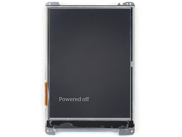

  1. Kobo Clara BW (N365) Screen Replacement, Before you begin: crwdns2935265:01crwdnd2935265:01crwdnd2935265:03crwdne2935265:0 Kobo Clara BW (N365) Screen Replacement, Before you begin: crwdns2935265:01crwdnd2935265:02crwdnd2935265:03crwdne2935265:0 Kobo Clara BW (N365) Screen Replacement, Before you begin: crwdns2935265:01crwdnd2935265:03crwdnd2935265:03crwdne2935265:0
    • Drain your eReader's battery as much as possible before starting your repair. Ideally, it should be fully discharged.
    • Optionally, to drain the battery faster, navigate to MoreSettingsEnergy saving and privacy and set Automatically go to sleep after and Automatically power off after to Never.
    • When working on or near the battery, don't use sharp metal tools to avoid puncturing and shorting the battery.
    • Unplug all cables and fully shut down your eReader.
    • Your screen should be black and say Powered off.

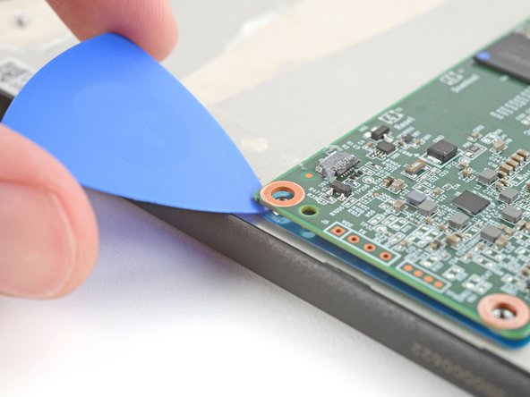

  2. Kobo Clara BW (N365) Screen Replacement, Insert an opening pick: crwdns2935265:02crwdnd2935265:01crwdnd2935265:02crwdne2935265:0 Kobo Clara BW (N365) Screen Replacement, Insert an opening pick: crwdns2935265:02crwdnd2935265:02crwdnd2935265:02crwdne2935265:0
    • Lay your eReader down so the back cover is facing up.
    • Insert the flat edge of an opening pick between the frame and the bottom left corner of the back cover.
    • Push the pick downwards at a slight angle until it slides under the back cover.

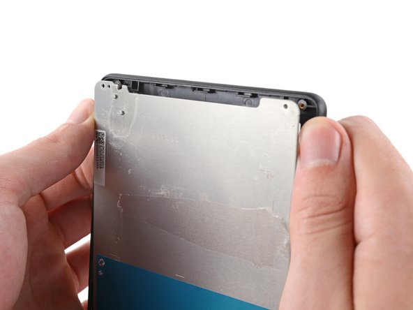

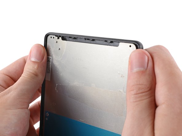

  6. Kobo Clara BW (N365) Screen Replacement, Remove the back cover: crwdns2935265:06crwdnd2935265:01crwdnd2935265:03crwdne2935265:0 Kobo Clara BW (N365) Screen Replacement, Remove the back cover: crwdns2935265:06crwdnd2935265:02crwdnd2935265:03crwdne2935265:0 Kobo Clara BW (N365) Screen Replacement, Remove the back cover: crwdns2935265:06crwdnd2935265:03crwdnd2935265:03crwdne2935265:0
    • At this point, you should be able to grip the back cover and release its remaining clips. If not, slide a pick under the perimeter of the back cover until you can grip an edge.
    • Grip the left edge of the back cover and lift it away from the eReader to release the remaining clips.
    • Remove the back cover.
    • During reassembly, align the back cover over the eReader and press along the perimeter until all its clips snap back into place.

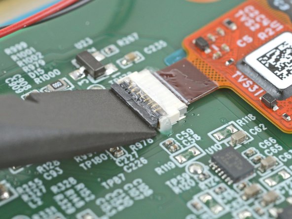

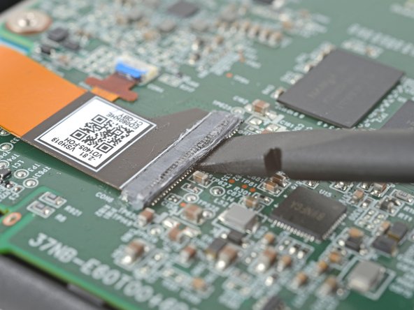

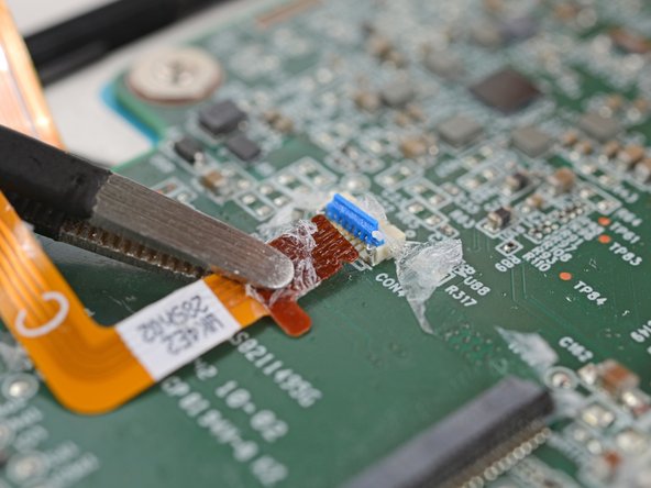

  7. Kobo Clara BW (N365) Screen Replacement, Coating information: crwdns2935265:07crwdnd2935265:01crwdnd2935265:03crwdne2935265:0 Kobo Clara BW (N365) Screen Replacement, Coating information: crwdns2935265:07crwdnd2935265:02crwdnd2935265:03crwdne2935265:0 Kobo Clara BW (N365) Screen Replacement, Coating information: crwdns2935265:07crwdnd2935265:03crwdnd2935265:03crwdne2935265:0
    • The entire surface of the eReader's internals is covered in a thin, plastic-like waterproof coating. Keep the following in mind as you continue disassembly:
    • While this won't hurt your device, removing the coating compromises the device to potential water damage.
    • The coating is brittle and can flake into many small pieces. Heating the coating helps, but working with it is still a time-consuming process.
    • The ZIF connector locking tabs are coated in a gel that can jam the hinge and keep the locking tab from completely unlocking. Make sure the tabs are completely upright before disconnecting any cables.
    • Depending on your repair, you might have to remove the coating from ZIF connectors and their cables.

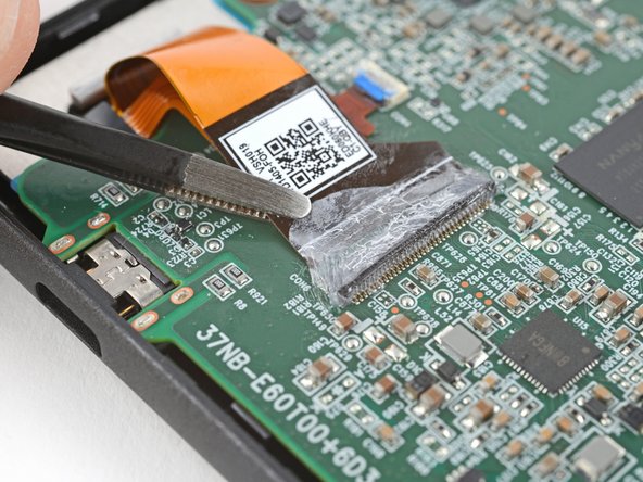

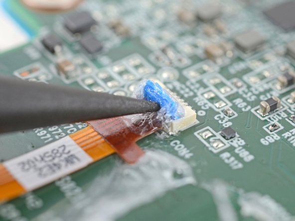

  8. Kobo Clara BW (N365) Screen Replacement, Soften the battery connector coating: crwdns2935265:08crwdnd2935265:01crwdnd2935265:02crwdne2935265:0 Kobo Clara BW (N365) Screen Replacement, Soften the battery connector coating: crwdns2935265:08crwdnd2935265:02crwdnd2935265:02crwdne2935265:0

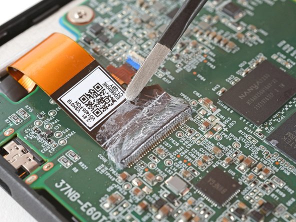

  9. Kobo Clara BW (N365) Screen Replacement, Remove the battery connector coating: crwdns2935265:09crwdnd2935265:01crwdnd2935265:03crwdne2935265:0 Kobo Clara BW (N365) Screen Replacement, Remove the battery connector coating: crwdns2935265:09crwdnd2935265:02crwdnd2935265:03crwdne2935265:0 Kobo Clara BW (N365) Screen Replacement, Remove the battery connector coating: crwdns2935265:09crwdnd2935265:03crwdnd2935265:03crwdne2935265:0

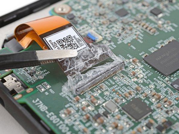

    • Use the tip of a spudger to scrape up the coating along the white battery connector head—enough so you can grab clumps of it with pointed tweezers.

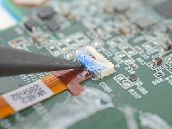

  10. Kobo Clara BW (N365) Screen Replacement: crwdns2935265:010crwdnd2935265:01crwdnd2935265:03crwdne2935265:0 Kobo Clara BW (N365) Screen Replacement: crwdns2935265:010crwdnd2935265:02crwdnd2935265:03crwdne2935265:0 Kobo Clara BW (N365) Screen Replacement: crwdns2935265:010crwdnd2935265:03crwdnd2935265:03crwdne2935265:0

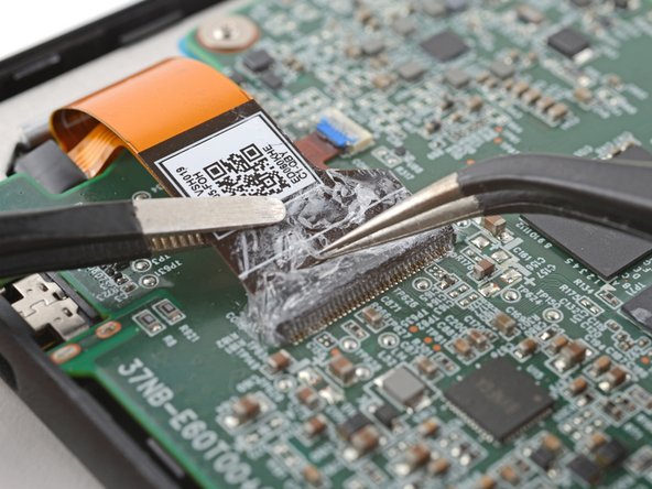

    • Use pointed tweezers to peel off all of the coating around the battery connector head and its socket.
    • If the coating becomes too brittle and hard to peel off, reheat the connector and try again.
    • This is a meticulous process! Failure to remove enough of the coating could damage the plastic head during disconnection, so take your time!

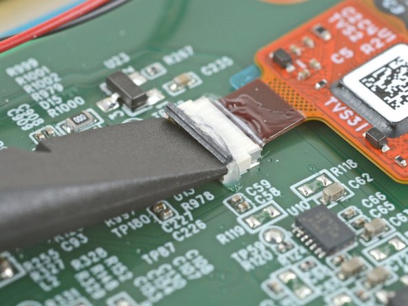

  11. Kobo Clara BW (N365) Screen Replacement, Disconnect the battery: crwdns2935265:011crwdnd2935265:01crwdnd2935265:02crwdne2935265:0 Kobo Clara BW (N365) Screen Replacement, Disconnect the battery: crwdns2935265:011crwdnd2935265:02crwdnd2935265:02crwdne2935265:0
    • Insert the point of a spudger under the edge of the battery connector head opposite of the cable.
    • There's a surface-mounted component close to the connector. Be careful not to touch it with your spudger!
    • Lift up the connector with the spudger to separate the rest of the coating and disconnect the battery.

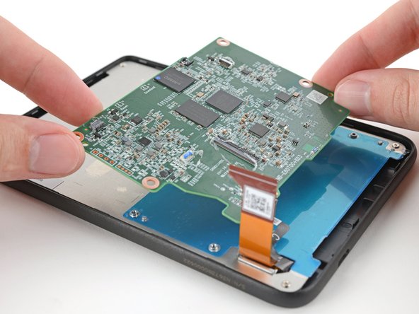

  14. Kobo Clara BW (N365) Screen Replacement, Remove the battery: crwdns2935265:014crwdnd2935265:01crwdnd2935265:02crwdne2935265:0 Kobo Clara BW (N365) Screen Replacement, Remove the battery: crwdns2935265:014crwdnd2935265:02crwdnd2935265:02crwdne2935265:0
    • Lift the battery out of the frame and remove it.

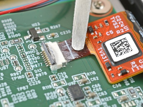

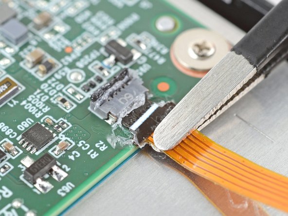

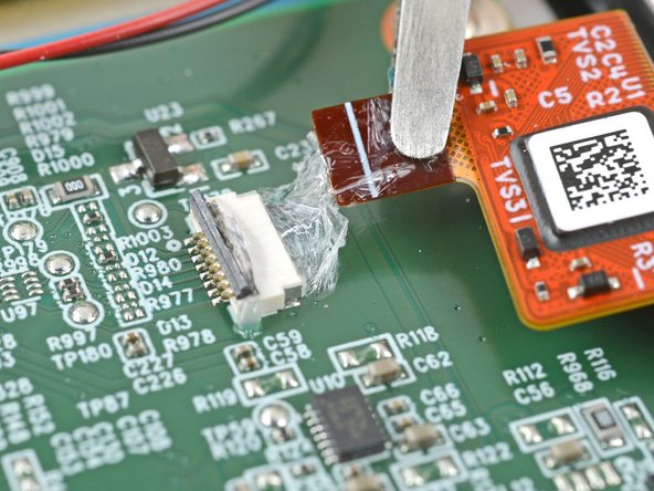

  19. Kobo Clara BW (N365) Screen Replacement, Unlock the power button ZIF connector: crwdns2935265:019crwdnd2935265:01crwdnd2935265:03crwdne2935265:0 Kobo Clara BW (N365) Screen Replacement, Unlock the power button ZIF connector: crwdns2935265:019crwdnd2935265:02crwdnd2935265:03crwdne2935265:0 Kobo Clara BW (N365) Screen Replacement, Unlock the power button ZIF connector: crwdns2935265:019crwdnd2935265:03crwdnd2935265:03crwdne2935265:0
    • There are surface-mounted components next to the power button ZIF connector. Follow the instructions carefully to avoid dislodging them.
    • Insert the tip of a spudger under the right side of the power button ZIF connector's black locking tab.
    • Lift up the locking tab with the spudger to unlock it.
    • The locking tab should be nearly vertical when unlocked. If not, gently push the tab forward to compress the gel and completely unlock the tab.

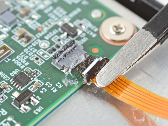

  21. Kobo Clara BW (N365) Screen Replacement, Disconnect the power button: crwdns2935265:021crwdnd2935265:01crwdnd2935265:03crwdne2935265:0 Kobo Clara BW (N365) Screen Replacement, Disconnect the power button: crwdns2935265:021crwdnd2935265:02crwdnd2935265:03crwdne2935265:0 Kobo Clara BW (N365) Screen Replacement, Disconnect the power button: crwdns2935265:021crwdnd2935265:03crwdnd2935265:03crwdne2935265:0
    • Use blunt nose tweezers to grip the cable close to the head and pull it away from its ZIF connector slowly and steadily to separate the coating.
    • If the coating feels stubborn, reheat the connector and try again.
    • Gripping the tweezers closer to the tip can help you get a tighter hold on the cable.
    • Keep pulling on the cable until the cable comes completely out of its socket.
    • During reassembly:
    • Inspect the head of the cable and the ZIF connector for any remaining coating that could prevent a good connection.
    • Peel off the coating—heating the cable and the ZIF connector when the coating becomes too brittle.
    • It doesn't have to look pretty! You just need to remove enough coating to have the cable sit properly in its connector.

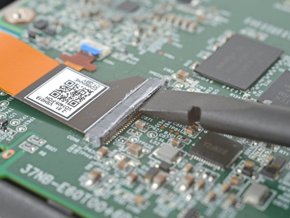

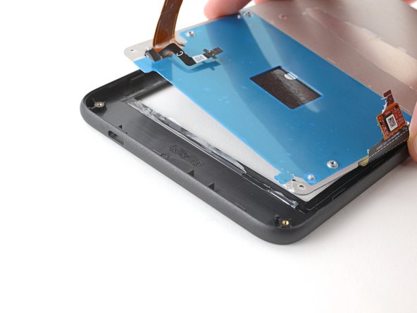

  31. Kobo Clara BW (N365) Screen Replacement, Unlock the digitizer cable ZIF connector: crwdns2935265:031crwdnd2935265:01crwdnd2935265:03crwdne2935265:0 Kobo Clara BW (N365) Screen Replacement, Unlock the digitizer cable ZIF connector: crwdns2935265:031crwdnd2935265:02crwdnd2935265:03crwdne2935265:0 Kobo Clara BW (N365) Screen Replacement, Unlock the digitizer cable ZIF connector: crwdns2935265:031crwdnd2935265:03crwdnd2935265:03crwdne2935265:0
    • Use the flat end of a spudger to lift up the locking tab on the digitizer cable ZIF connector.
  32. Kobo Clara BW (N365) Screen Replacement, Soften the digitizer cable coating: crwdns2935265:032crwdnd2935265:01crwdnd2935265:01crwdne2935265:0
    • Apply a heated iOpener to the digitizer cable ZIF connector for 90 seconds to soften the coating.
    • Alternatively, you can use a hair dryer or a heat gun.
  33. Kobo Clara BW (N365) Screen Replacement, Disconnect the digitizer cable: crwdns2935265:033crwdnd2935265:01crwdnd2935265:03crwdne2935265:0 Kobo Clara BW (N365) Screen Replacement, Disconnect the digitizer cable: crwdns2935265:033crwdnd2935265:02crwdnd2935265:03crwdne2935265:0 Kobo Clara BW (N365) Screen Replacement, Disconnect the digitizer cable: crwdns2935265:033crwdnd2935265:03crwdnd2935265:03crwdne2935265:0
    • Grip the digitizer cable close to the head and pull it away from its ZIF connector slowly and steadily to separate the coating.
    • Keep pulling on the cable until it comes completely out of its socket.
  34. Kobo Clara BW (N365) Screen Replacement, Unlock the display ZIF connector: crwdns2935265:034crwdnd2935265:01crwdnd2935265:03crwdne2935265:0 Kobo Clara BW (N365) Screen Replacement, Unlock the display ZIF connector: crwdns2935265:034crwdnd2935265:02crwdnd2935265:03crwdne2935265:0 Kobo Clara BW (N365) Screen Replacement, Unlock the display ZIF connector: crwdns2935265:034crwdnd2935265:03crwdnd2935265:03crwdne2935265:0
    • There are surface-mounted components next to the display ZIF connector. Follow the instructions carefully to avoid dislodging them.
    • Insert the flat end of a spudger under the right side of the ZIF connector's black locking tab.
  35. Kobo Clara BW (N365) Screen Replacement, Soften the display connector coating: crwdns2935265:035crwdnd2935265:01crwdnd2935265:01crwdne2935265:0
    • Apply a heated iOpener and lay it on the display connector for 90 seconds to soften the coating.
  36. Kobo Clara BW (N365) Screen Replacement, Disconnect the display cable: crwdns2935265:036crwdnd2935265:01crwdnd2935265:02crwdne2935265:0 Kobo Clara BW (N365) Screen Replacement, Disconnect the display cable: crwdns2935265:036crwdnd2935265:02crwdnd2935265:02crwdne2935265:0
    • Use blunt nose tweezers to grip the corner of the display cable closest to the charging port.
    • Pull the cable away from the ZIF connector slowly and steadily at a level angle to separate the coating at the corner.
    • If you're having trouble, try rocking the cable side-to-side while pulling.
    • Gripping the tweezers closer to the tip can help with getting a tighter hold on the cable.
  37. Kobo Clara BW (N365) Screen Replacement: crwdns2935265:037crwdnd2935265:01crwdnd2935265:02crwdne2935265:0 Kobo Clara BW (N365) Screen Replacement: crwdns2935265:037crwdnd2935265:02crwdnd2935265:02crwdne2935265:0
    • Repeat the previous step for the other corner until the the cable comes completely out of its socket.
  38. Kobo Clara BW (N365) Screen Replacement: crwdns2935265:038crwdnd2935265:01crwdnd2935265:03crwdne2935265:0 Kobo Clara BW (N365) Screen Replacement: crwdns2935265:038crwdnd2935265:02crwdnd2935265:03crwdne2935265:0 Kobo Clara BW (N365) Screen Replacement: crwdns2935265:038crwdnd2935265:03crwdnd2935265:03crwdne2935265:0
    • Lift up the display cable and peel off any remaining coating holding it to the motherboard.
    • Inspect the ends of the cable and the ZIF connectors for any remaining coating that could prevent a good connection.
    • It doesn't have to look pretty! You just need to remove enough coating to have the cable sit properly in the connector.

  40. Kobo Clara BW (N365) Screen Replacement, Unlock the backlight cable ZIF connector: crwdns2935265:040crwdnd2935265:01crwdnd2935265:02crwdne2935265:0 Kobo Clara BW (N365) Screen Replacement, Unlock the backlight cable ZIF connector: crwdns2935265:040crwdnd2935265:02crwdnd2935265:02crwdne2935265:0
    • Use the point of a spudger to lift up the blue locking tab on the backlight cable ZIF connector.
  41. Kobo Clara BW (N365) Screen Replacement, Soften the backlight connector coating: crwdns2935265:041crwdnd2935265:01crwdnd2935265:01crwdne2935265:0
    • Apply a heated iOpener and lay it on the backlight connector for 90 seconds to soften the coating.
  42. Kobo Clara BW (N365) Screen Replacement, Disconnect the backlight cable: crwdns2935265:042crwdnd2935265:01crwdnd2935265:02crwdne2935265:0 Kobo Clara BW (N365) Screen Replacement, Disconnect the backlight cable: crwdns2935265:042crwdnd2935265:02crwdnd2935265:02crwdne2935265:0

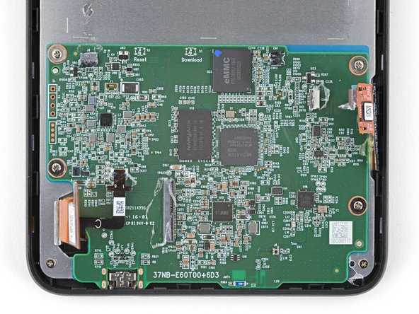

  43. Kobo Clara BW (N365) Screen Replacement, Remove the motherboard screws: crwdns2935265:043crwdnd2935265:01crwdnd2935265:02crwdne2935265:0 Kobo Clara BW (N365) Screen Replacement, Remove the motherboard screws: crwdns2935265:043crwdnd2935265:02crwdnd2935265:02crwdne2935265:0
    • Use a Phillips screwdriver to remove the four 2.4 mm‑long screws securing the motherboard.

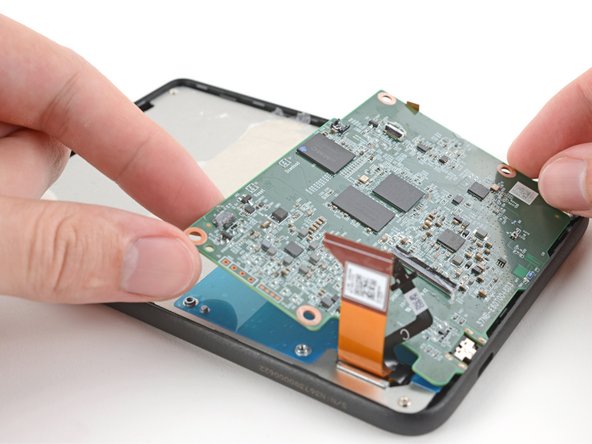

  44. Kobo Clara BW (N365) Screen Replacement, Remove the motherboard: crwdns2935265:044crwdnd2935265:01crwdnd2935265:02crwdne2935265:0 Kobo Clara BW (N365) Screen Replacement, Remove the motherboard: crwdns2935265:044crwdnd2935265:02crwdnd2935265:02crwdne2935265:0
    • Slide an opening pick under the top left corner of the motherboard and lift it up enough to grip the motherboard with your fingers.
  45. Kobo Clara BW (N365) Screen Replacement: crwdns2935265:045crwdnd2935265:01crwdnd2935265:03crwdne2935265:0 Kobo Clara BW (N365) Screen Replacement: crwdns2935265:045crwdnd2935265:02crwdnd2935265:03crwdne2935265:0 Kobo Clara BW (N365) Screen Replacement: crwdns2935265:045crwdnd2935265:03crwdnd2935265:03crwdne2935265:0
    • Angle the motherboard up and pull it toward the top edge of the eReader to remove it.
    • During reassembly, slide the charging port into its slot at an angle before pressing the motherboard flat to the frame.
  46. Kobo Clara BW (N365) Screen Replacement, Remove the front cover screws: crwdns2935265:046crwdnd2935265:01crwdnd2935265:02crwdne2935265:0 Kobo Clara BW (N365) Screen Replacement, Remove the front cover screws: crwdns2935265:046crwdnd2935265:02crwdnd2935265:02crwdne2935265:0
    • Use a Phillips screwdriver to remove the four 3 mm‑long screws securing corners of the front cover.

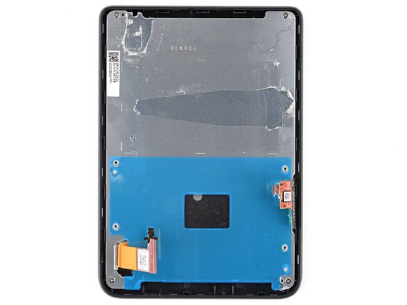

  47. Kobo Clara BW (N365) Screen Replacement, Separate the adhesive: crwdns2935265:047crwdnd2935265:01crwdnd2935265:03crwdne2935265:0 Kobo Clara BW (N365) Screen Replacement, Separate the adhesive: crwdns2935265:047crwdnd2935265:02crwdnd2935265:03crwdne2935265:0 Kobo Clara BW (N365) Screen Replacement, Separate the adhesive: crwdns2935265:047crwdnd2935265:03crwdnd2935265:03crwdne2935265:0
    • The screen is secured by adhesive along the perimeter of the front cover and a layer of coating at the bottom edge.
    • Bend the top edge of the front cover around the screen to separate the adhesive.
  48. Kobo Clara BW (N365) Screen Replacement: crwdns2935265:048crwdnd2935265:01crwdnd2935265:03crwdne2935265:0 Kobo Clara BW (N365) Screen Replacement: crwdns2935265:048crwdnd2935265:02crwdnd2935265:03crwdne2935265:0 Kobo Clara BW (N365) Screen Replacement: crwdns2935265:048crwdnd2935265:03crwdnd2935265:03crwdne2935265:0
    • Lift the top edge of the screen to separate any remaining adhesive around the perimeter of the front cover.
    • Slide the screen toward the top of the eReader to expose the coating at the bottom edge.
  49. Kobo Clara BW (N365) Screen Replacement, Remove the screen: crwdns2935265:049crwdnd2935265:01crwdnd2935265:03crwdne2935265:0 Kobo Clara BW (N365) Screen Replacement, Remove the screen: crwdns2935265:049crwdnd2935265:02crwdnd2935265:03crwdne2935265:0 Kobo Clara BW (N365) Screen Replacement, Remove the screen: crwdns2935265:049crwdnd2935265:03crwdnd2935265:03crwdne2935265:0
    • Lift and rotate the screen off the bottom edge of the front cover to separate the coating.
    • Remove the screen.
