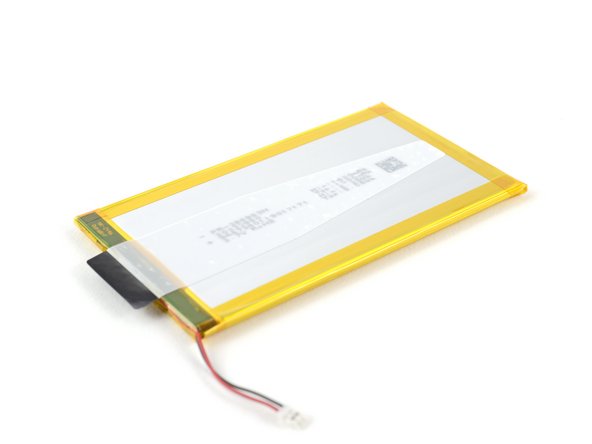

    • If you're reusing your battery, use your fingers, or blunt nose tweezers, to remove any remaining adhesive on the bottom of the battery.
    • Take care not to puncture or bend the battery—it can leak dangerous chemicals and/or catch fire.

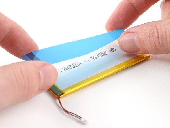

  3. How to Apply Battery Stretch Release Adhesive in Your Kobo Clara eReader, Apply the stretch release adhesive: crwdns2935265:03crwdnd2935265:01crwdnd2935265:03crwdne2935265:0 How to Apply Battery Stretch Release Adhesive in Your Kobo Clara eReader, Apply the stretch release adhesive: crwdns2935265:03crwdnd2935265:02crwdnd2935265:03crwdne2935265:0 How to Apply Battery Stretch Release Adhesive in Your Kobo Clara eReader, Apply the stretch release adhesive: crwdns2935265:03crwdnd2935265:03crwdnd2935265:03crwdne2935265:0
    • Use your fingers to grip the black pull tab and the blue liner on the new stretch release adhesive strip.
    • Just gripping the blue liner could prematurely separate it from the adhesive.
    • Peel the adhesive strip off its clear liner to expose the adhesive underneath.
    • Place the strip on the bottom of the battery, making sure the black pull tab sticks out slightly from the edge of the battery with the cable.
    • The strip doesn't have to be aligned perfectly, but make sure it covers the entire length of the battery.

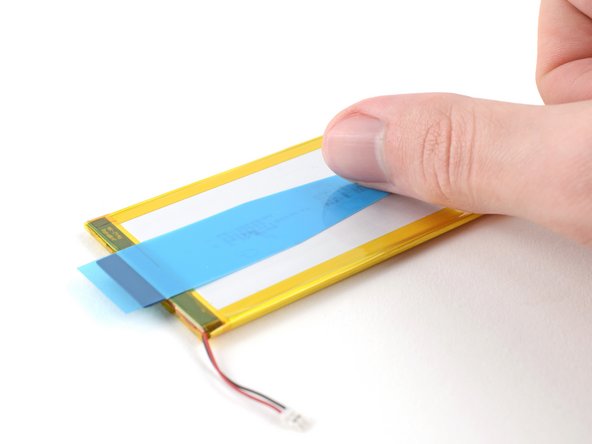

  4. How to Apply Battery Stretch Release Adhesive in Your Kobo Clara eReader: crwdns2935265:04crwdnd2935265:01crwdnd2935265:02crwdne2935265:0 How to Apply Battery Stretch Release Adhesive in Your Kobo Clara eReader: crwdns2935265:04crwdnd2935265:02crwdnd2935265:02crwdne2935265:0
    • Use your fingers to press down on the adhesive strip, adhering it to the battery.

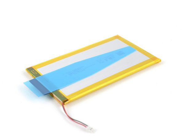

  5. How to Apply Battery Stretch Release Adhesive in Your Kobo Clara eReader: crwdns2935265:05crwdnd2935265:01crwdnd2935265:02crwdne2935265:0 How to Apply Battery Stretch Release Adhesive in Your Kobo Clara eReader: crwdns2935265:05crwdnd2935265:02crwdnd2935265:02crwdne2935265:0
    • Peel off the remaining blue liner to expose the adhesive.

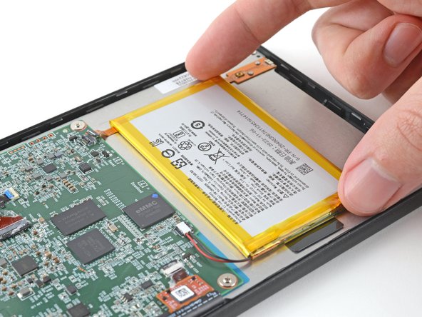

    • Be careful with this step, as it's easy to stick the battery in the wrong spot. Take your time and work slowly.
    • While holding the battery over its spot on the frame, temporarily reconnect the battery cable to ensure the battery gets aligned properly.
    • Keep the battery within the segmented outline on the screen.
    • Place the battery onto its spot in the frame and press down to adhere it.
    • If you have more internal reassembly remaining (like reconnecting other cables) disconnect the battery. Otherwise, you can keep the battery connected.
