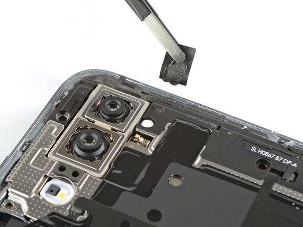

  8. Huawei P20 LCD Screen & Digitizer Replacement, Motherboard Cover with NFC: crwdns2935265:08crwdnd2935265:01crwdnd2935265:02crwdne2935265:0 Huawei P20 LCD Screen & Digitizer Replacement, Motherboard Cover with NFC: crwdns2935265:08crwdnd2935265:02crwdnd2935265:02crwdne2935265:0
    • Use a pair of tweezers to peel the black tape next to the rear camera off the motherboard cover.

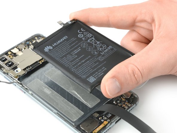

  21. Huawei P20 LCD Screen & Digitizer Replacement, Battery: crwdns2935265:021crwdnd2935265:01crwdnd2935265:03crwdne2935265:0 Huawei P20 LCD Screen & Digitizer Replacement, Battery: crwdns2935265:021crwdnd2935265:02crwdnd2935265:03crwdne2935265:0 Huawei P20 LCD Screen & Digitizer Replacement, Battery: crwdns2935265:021crwdnd2935265:03crwdnd2935265:03crwdne2935265:0
    • Use a spudger to pry up and disconnect the power and volume button flex connector.

    • Apply a heated iOpener to the screen to loosen the adhesive beneath the battery. Apply the iOpener for at least two minutes.
    • Try your best not to deform the battery during the following removal process. Soft-shell lithium-ion batteries can leak dangerous chemicals, catch fire, or even explode if damaged. Do not use excessive force or pry at the battery with metal tools.
  24. Huawei P20 LCD Screen & Digitizer Replacement: crwdns2935265:024crwdnd2935265:01crwdnd2935265:03crwdne2935265:0 Huawei P20 LCD Screen & Digitizer Replacement: crwdns2935265:024crwdnd2935265:02crwdnd2935265:03crwdne2935265:0 Huawei P20 LCD Screen & Digitizer Replacement: crwdns2935265:024crwdnd2935265:03crwdnd2935265:03crwdne2935265:0
    Plastic Cards
    $2.99
    • Start to slide a plastic card under the bottom right corner of the battery to cut the adhesive.
    • Slide the plastic card along the right side of the battery to further release the adhesive. Gently start to pry up the battery while doing so.
    • If you have trouble prying up the battery, the adhesive may not be loose enough. You can apply some isopropyl alcohol under each corner of the battery and allow it to penetrate for about two minutes to help weaken the adhesive.
  25. Huawei P20 LCD Screen & Digitizer Replacement: crwdns2935265:025crwdnd2935265:01crwdnd2935265:03crwdne2935265:0 Huawei P20 LCD Screen & Digitizer Replacement: crwdns2935265:025crwdnd2935265:02crwdnd2935265:03crwdne2935265:0 Huawei P20 LCD Screen & Digitizer Replacement: crwdns2935265:025crwdnd2935265:03crwdnd2935265:03crwdne2935265:0
    • Slide the plastic card under the whole upper part of the battery and cut the adhesive with it.
    • Slide the plastic card down to the bottom end of the battery to cut the remaining adhesive.
    • Use the plastic card to pry up the battery.

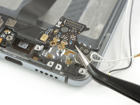

  27. Huawei P20 LCD Screen & Digitizer Replacement, Daughterboard: crwdns2935265:027crwdnd2935265:01crwdnd2935265:01crwdne2935265:0
    • Remove the two Phillips #00 screws (3.4 mm length).

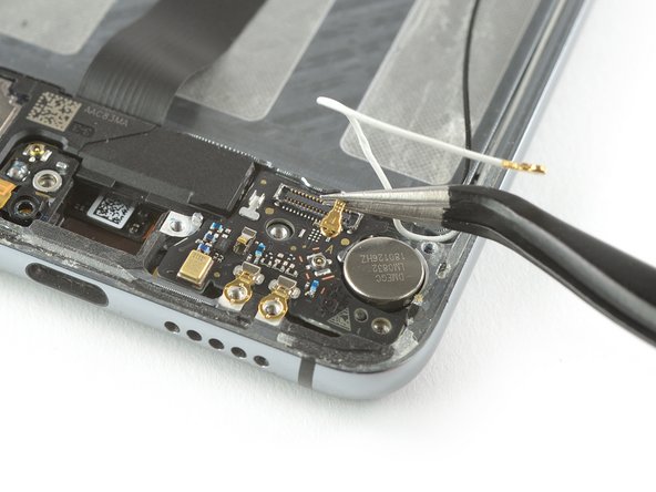

  28. Huawei P20 LCD Screen & Digitizer Replacement: crwdns2935265:028crwdnd2935265:01crwdnd2935265:02crwdne2935265:0 Huawei P20 LCD Screen & Digitizer Replacement: crwdns2935265:028crwdnd2935265:02crwdnd2935265:02crwdne2935265:0
    • Use a pair of tweezers to disconnect the black coax cable and fold it out of your way.
  29. Huawei P20 LCD Screen & Digitizer Replacement: crwdns2935265:029crwdnd2935265:01crwdnd2935265:02crwdne2935265:0 Huawei P20 LCD Screen & Digitizer Replacement: crwdns2935265:029crwdnd2935265:02crwdnd2935265:02crwdne2935265:0
    • Use a pair of tweezers to remove the daughterboard.

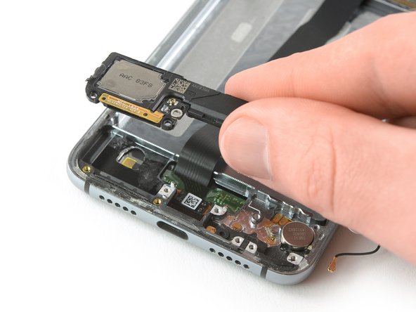

  30. Huawei P20 LCD Screen & Digitizer Replacement, Loudspeaker: crwdns2935265:030crwdnd2935265:01crwdnd2935265:01crwdne2935265:0
    • Remove the two Phillips #00 screws (3.2 mm length).
  31. Huawei P20 LCD Screen & Digitizer Replacement: crwdns2935265:031crwdnd2935265:01crwdnd2935265:01crwdne2935265:0
    • Apply a heated iOpener to the bottom end of the screen to loosen the adhesive underneath the loudspeaker. Apply the iOpener for at least two minutes.
  32. Huawei P20 LCD Screen & Digitizer Replacement: crwdns2935265:032crwdnd2935265:01crwdnd2935265:02crwdne2935265:0 Huawei P20 LCD Screen & Digitizer Replacement: crwdns2935265:032crwdnd2935265:02crwdnd2935265:02crwdne2935265:0
    • Use one arm of a pair of tweezers to peel up the contact cable of the loudspeaker.
  33. Huawei P20 LCD Screen & Digitizer Replacement: crwdns2935265:033crwdnd2935265:01crwdnd2935265:02crwdne2935265:0 Huawei P20 LCD Screen & Digitizer Replacement: crwdns2935265:033crwdnd2935265:02crwdnd2935265:02crwdne2935265:0
    • Insert a spudger between the midframe and the right side of the loudspeaker.
    • Use the spudger to pry up the loudspeaker.
  34. Huawei P20 LCD Screen & Digitizer Replacement: crwdns2935265:034crwdnd2935265:01crwdnd2935265:02crwdne2935265:0 Huawei P20 LCD Screen & Digitizer Replacement: crwdns2935265:034crwdnd2935265:02crwdnd2935265:02crwdne2935265:0
    • Remove the loudspeaker.

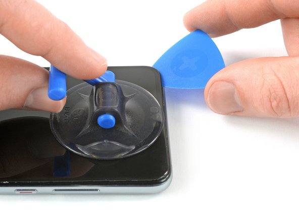

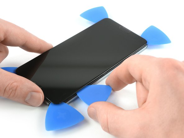

    • Apply a heated iOpener to the screen and all edges of the phone to loosen the adhesive beneath the edges of the LCD screen and digitizer. Apply the iOpener for at least two minutes.
  36. Huawei P20 LCD Screen & Digitizer Replacement: crwdns2935265:036crwdnd2935265:01crwdnd2935265:03crwdne2935265:0 Huawei P20 LCD Screen & Digitizer Replacement: crwdns2935265:036crwdnd2935265:02crwdnd2935265:03crwdne2935265:0 Huawei P20 LCD Screen & Digitizer Replacement: crwdns2935265:036crwdnd2935265:03crwdnd2935265:03crwdne2935265:0

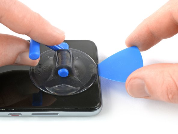

    • Once the screen is warm to the touch, apply a suction cup to the upper edge of the phone.
    • Pull the suction cup upwards and insert an opening pick in the gap between the display glass and the plastic bezel. Start to cut the adhesive by sliding the opening pick to the top left corner.
    • Make sure you get in the right gap between the display and the plastic bezel. Do not pry between the bezel and the midframe.
  37. Huawei P20 LCD Screen & Digitizer Replacement: crwdns2935265:037crwdnd2935265:01crwdnd2935265:02crwdne2935265:0 Huawei P20 LCD Screen & Digitizer Replacement: crwdns2935265:037crwdnd2935265:02crwdnd2935265:02crwdne2935265:0
    • Insert a second opening pick and slide it to the top right corner of the phone.
    • Leave the picks in their place to prevent the adhesive from resealing.
  38. Huawei P20 LCD Screen & Digitizer Replacement: crwdns2935265:038crwdnd2935265:01crwdnd2935265:03crwdne2935265:0 Huawei P20 LCD Screen & Digitizer Replacement: crwdns2935265:038crwdnd2935265:02crwdnd2935265:03crwdne2935265:0 Huawei P20 LCD Screen & Digitizer Replacement: crwdns2935265:038crwdnd2935265:03crwdnd2935265:03crwdne2935265:0
    • Insert a third opening pick under the top right corner of the phone.
    • Slide the opening pick down to the bottom right corner to cut the adhesive. Leave it at the bottom right corner to prevent the adhesive from resealing.
    • If cutting becomes too difficult, reheat and reapply the iOpener.

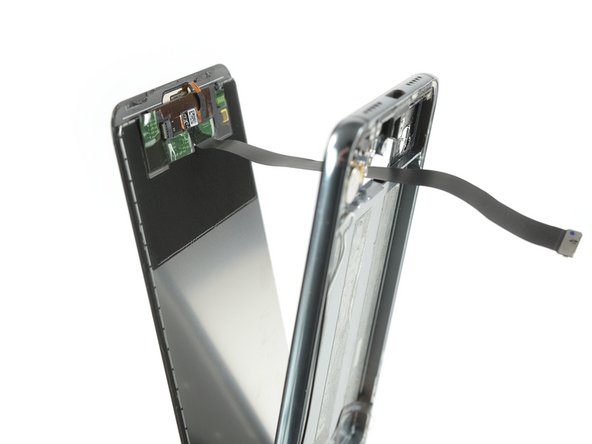

  40. Huawei P20 LCD Screen & Digitizer Replacement: crwdns2935265:040crwdnd2935265:01crwdnd2935265:02crwdne2935265:0 Huawei P20 LCD Screen & Digitizer Replacement: crwdns2935265:040crwdnd2935265:02crwdnd2935265:02crwdne2935265:0
    • Insert a fifth opening pick and slide it along the left edge of the phone to cut the remaining adhesive.
    • Try not to remove the display all the way yet, the display cable is still threaded through the frame and adhered on the inner side of the midframe.

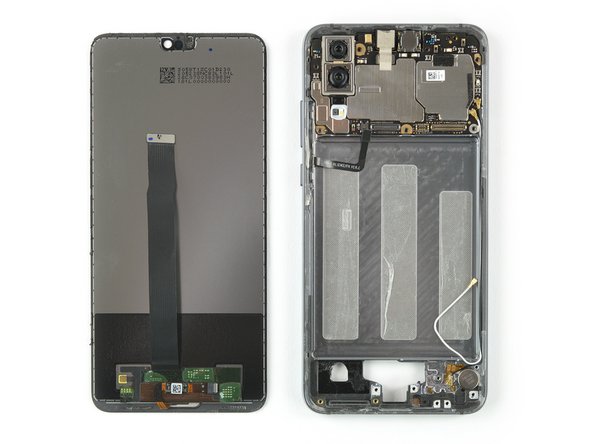

  41. Huawei P20 LCD Screen & Digitizer Replacement: crwdns2935265:041crwdnd2935265:01crwdnd2935265:03crwdne2935265:0 Huawei P20 LCD Screen & Digitizer Replacement: crwdns2935265:041crwdnd2935265:02crwdnd2935265:03crwdne2935265:0 Huawei P20 LCD Screen & Digitizer Replacement: crwdns2935265:041crwdnd2935265:03crwdnd2935265:03crwdne2935265:0
    • Thread the display flex cable through the gap in the midframe and remove the display.
    • Before installing a new display, it's important to remove all traces of the old adhesive from the frame, and clean the glued areas with isopropyl alcohol (>90%) and a lint-free cloth.
    • In case your replacement screen isn't equipped with a new home button with fingerprint sensor, follow this guide to remove the button from your old screen.
If possible, turn on your phone and test your repair before installing new adhesive and resealing the phone.
The best way to secure the new screen is with a sheet of custom-cut double-sided tape. Apply the tape to the back of the screen, then carefully feed the display cable through the frame. Align the screen and press it into place.
