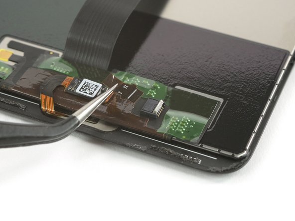

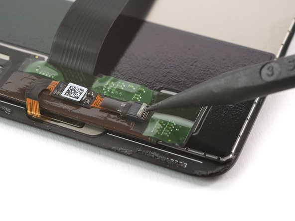

  42. Huawei P20 Home Button with Fingerprint Sensor Replacement, Home Button with Fingerprint Sensor: crwdns2935265:042crwdnd2935265:01crwdnd2935265:02crwdne2935265:0 Huawei P20 Home Button with Fingerprint Sensor Replacement, Home Button with Fingerprint Sensor: crwdns2935265:042crwdnd2935265:02crwdnd2935265:02crwdne2935265:0
    • Use the pointed end of a spudger to open the ZIF connector of the home button.
  43. Huawei P20 Home Button with Fingerprint Sensor Replacement: crwdns2935265:043crwdnd2935265:01crwdnd2935265:02crwdne2935265:0 Huawei P20 Home Button with Fingerprint Sensor Replacement: crwdns2935265:043crwdnd2935265:02crwdnd2935265:02crwdne2935265:0
    • Use a pair of tweezers to pull the home button flex cable out of its ZIF connector.

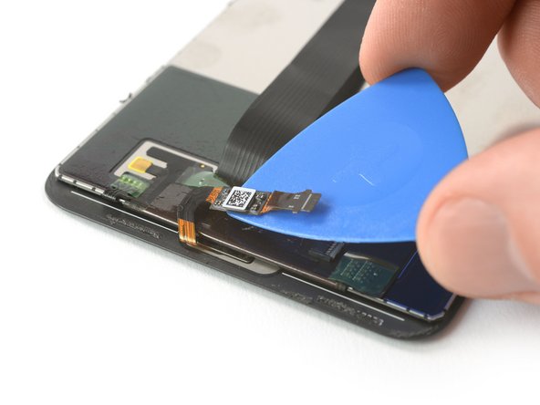

  44. Huawei P20 Home Button with Fingerprint Sensor Replacement: crwdns2935265:044crwdnd2935265:01crwdnd2935265:02crwdne2935265:0 Huawei P20 Home Button with Fingerprint Sensor Replacement: crwdns2935265:044crwdnd2935265:02crwdnd2935265:02crwdne2935265:0
    • Carefully slide an opening pick under the home button cable to loosen the adhesive underneath.
