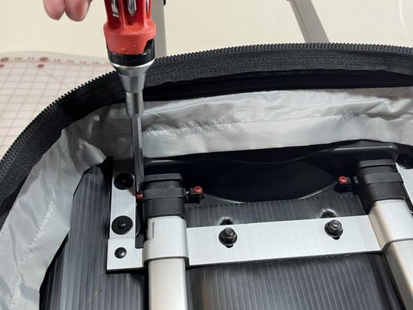

    • Open the zipper at the base of the bag, then open the zipper in the compartment liner to expose the handle mechanisms.
    • All metal bars should be straight and plastic housings should be intact. Replacing the handle won't work if the metal bars or handle housings are damaged or bent.
    • If there is a possibility that the handle is sticking but not damaged, try lubricating it first.
  2. Handle Replacement on Patagonia Freewheeler/Freightliner Luggage, Remove the screws and clips: crwdns2935265:02crwdnd2935265:01crwdnd2935265:03crwdne2935265:0 Handle Replacement on Patagonia Freewheeler/Freightliner Luggage, Remove the screws and clips: crwdns2935265:02crwdnd2935265:02crwdnd2935265:03crwdne2935265:0 Handle Replacement on Patagonia Freewheeler/Freightliner Luggage, Remove the screws and clips: crwdns2935265:02crwdnd2935265:03crwdnd2935265:03crwdne2935265:0

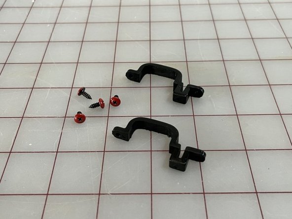

    • Use a Phillips PH1 screwdriver to remove the four screws at the top handle bracket.
    • Then remove the two black plastic retaining clips that were kept in place by the red screws.
    • Be careful not to lose these pieces! Put them somewhere safe and accessible, they'll be reused later on.

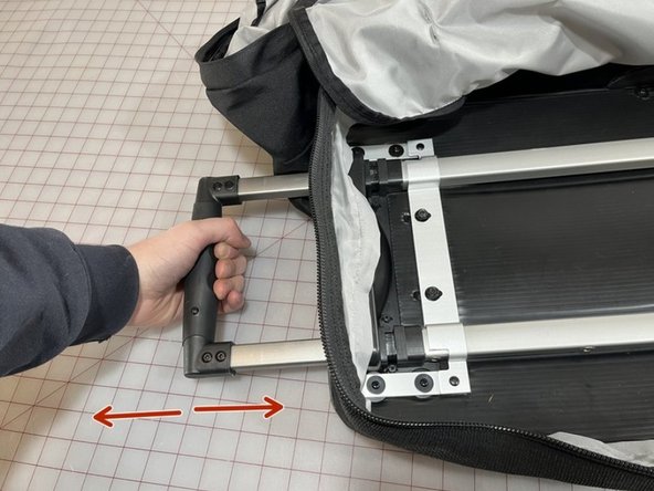

  3. Handle Replacement on Patagonia Freewheeler/Freightliner Luggage, Remove the damaged handle: crwdns2935265:03crwdnd2935265:01crwdnd2935265:03crwdne2935265:0 Handle Replacement on Patagonia Freewheeler/Freightliner Luggage, Remove the damaged handle: crwdns2935265:03crwdnd2935265:02crwdnd2935265:03crwdne2935265:0 Handle Replacement on Patagonia Freewheeler/Freightliner Luggage, Remove the damaged handle: crwdns2935265:03crwdnd2935265:03crwdnd2935265:03crwdne2935265:0
    • Press the handle release button to retract the toggle buttons on the handle.
    • If the toggle buttons won't retract, use a pointed object (like a screwdriver) to depress the buttons into the handle housing manually.
    • Pull the handle up and out of the handle housing. Use a repeated side-to-side movement to free the black plastic sleeves on the bottom portion of the handle.
    • Discard the damaged handle responsibly.
  4. Handle Replacement on Patagonia Freewheeler/Freightliner Luggage, Insert the new handle: crwdns2935265:04crwdnd2935265:01crwdnd2935265:03crwdne2935265:0 Handle Replacement on Patagonia Freewheeler/Freightliner Luggage, Insert the new handle: crwdns2935265:04crwdnd2935265:02crwdnd2935265:03crwdne2935265:0 Handle Replacement on Patagonia Freewheeler/Freightliner Luggage, Insert the new handle: crwdns2935265:04crwdnd2935265:03crwdnd2935265:03crwdne2935265:0
    • While holding the release button on the top, use a repeated up-and-down movement to insert the new handle into the handle housing.
    • Replace the retaining brackets and screws to the original positions.
  5. Handle Replacement on Patagonia Freewheeler/Freightliner Luggage, Test the handle functionality: crwdns2935265:05crwdnd2935265:01crwdnd2935265:03crwdne2935265:0 Handle Replacement on Patagonia Freewheeler/Freightliner Luggage, Test the handle functionality: crwdns2935265:05crwdnd2935265:02crwdnd2935265:03crwdne2935265:0 Handle Replacement on Patagonia Freewheeler/Freightliner Luggage, Test the handle functionality: crwdns2935265:05crwdnd2935265:03crwdnd2935265:03crwdne2935265:0
    • Test that the handle works properly. Move the handle into all positions and ensure it locks securely at each position:
    • Fully extended
    • Middle position (medium and small bags only)
    • Fully collapsed into the handle housing
    • The toggle buttons should move freely when the handle release button is pressed.
