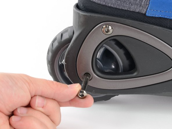

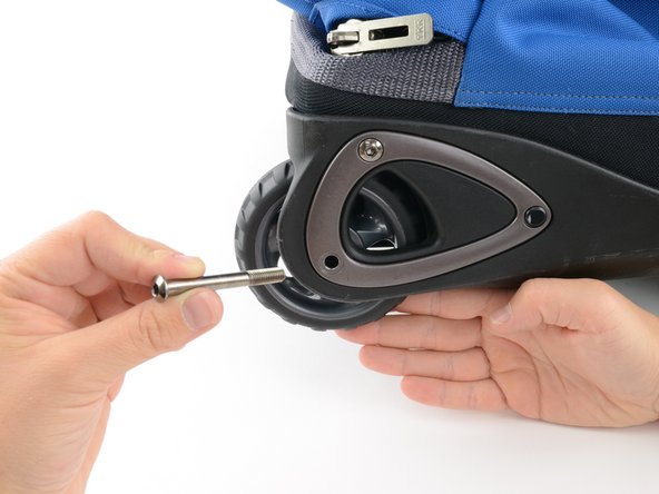

  2. Wheel Replacement on Patagonia Freewheeler/Freightliner Luggage, Remove the wheel: crwdns2935265:02crwdnd2935265:01crwdnd2935265:03crwdne2935265:0 Wheel Replacement on Patagonia Freewheeler/Freightliner Luggage, Remove the wheel: crwdns2935265:02crwdnd2935265:02crwdnd2935265:03crwdne2935265:0 Wheel Replacement on Patagonia Freewheeler/Freightliner Luggage, Remove the wheel: crwdns2935265:02crwdnd2935265:03crwdnd2935265:03crwdne2935265:0
    • Use a 4 mm hex key to unscrew and remove the axle to free the damaged wheel from the wheel housing.
    • Righty tighty, lefty loosey!
    • Lift up the corner of the bag or tilt it onto its side to remove the wheel.
    • Responsibly discard any unusable pieces.
  3. Wheel Replacement on Patagonia Freewheeler/Freightliner Luggage, Replace the wheel: crwdns2935265:03crwdnd2935265:01crwdnd2935265:03crwdne2935265:0 Wheel Replacement on Patagonia Freewheeler/Freightliner Luggage, Replace the wheel: crwdns2935265:03crwdnd2935265:02crwdnd2935265:03crwdne2935265:0 Wheel Replacement on Patagonia Freewheeler/Freightliner Luggage, Replace the wheel: crwdns2935265:03crwdnd2935265:03crwdnd2935265:03crwdne2935265:0
    • Line up the replacement wheel with the bolt hole in the plastic wheel housing.
    • Insert the replacement axle and secure it using a 4 mm hex key.
    • Gently hand-tighten the axle to avoid overtightening it.
    • Check the function of the wheel by spinning the wheel or rolling the luggage on the floor.
    • The appropriate tightness allows the wheel to spin freely for a few seconds. You may need to tighten or loosen the axle.
