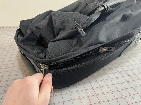

    • Open the zipper at the base of the bag, then open the zipper in the compartment liner to expose the handle mechanisms.
    • Inspect the handle housing.
    • All metal bars should be straight and plastic housings should be intact. This guide cannot fix handles that are stuck due to any damage to the hardware.

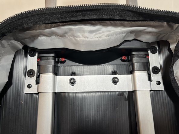

  2. Stuck Luggage Handle Lubrication, Check Function of Toggle Buttons: crwdns2935265:02crwdnd2935265:01crwdnd2935265:03crwdne2935265:0 Stuck Luggage Handle Lubrication, Check Function of Toggle Buttons: crwdns2935265:02crwdnd2935265:02crwdnd2935265:03crwdne2935265:0 Stuck Luggage Handle Lubrication, Check Function of Toggle Buttons: crwdns2935265:02crwdnd2935265:03crwdnd2935265:03crwdne2935265:0
    • There are multiple sets of holes along the external sides of the handle housing. The toggle buttons of the handle (sometimes referred to as 'spring clips') lock into these holes, raising and lowering the height of the retractable handle.
    • Check the function of this mechanism by pressing the handle's release button and watching the toggle buttons:
    • When the luggage handle is fully functional, the handle release button causes these toggle buttons to fully retract into the holes.
    • When the luggage handle mechanism is sticky or fully stuck, the handle release button does not cause the toggle buttons to retract properly.

  4. Stuck Luggage Handle Lubrication, Remove Handle Clips: crwdns2935265:04crwdnd2935265:01crwdnd2935265:03crwdne2935265:0 Stuck Luggage Handle Lubrication, Remove Handle Clips: crwdns2935265:04crwdnd2935265:02crwdnd2935265:03crwdne2935265:0 Stuck Luggage Handle Lubrication, Remove Handle Clips: crwdns2935265:04crwdnd2935265:03crwdnd2935265:03crwdne2935265:0
    • Use a Phillips PH1 screwdriver to remove the four screws at the top handle bracket.
    • Then remove the two black plastic retaining clips that were kept in place by the red screws.
    • Be careful not to lose these pieces! Put them somewhere safe and accessible, they'll be reused later on.
