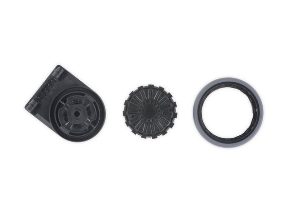

  4. HTC Vive Teardown: crwdns2935265:04crwdnd2935265:01crwdnd2935265:03crwdne2935265:0 HTC Vive Teardown: crwdns2935265:04crwdnd2935265:02crwdnd2935265:03crwdne2935265:0 HTC Vive Teardown: crwdns2935265:04crwdnd2935265:03crwdnd2935265:03crwdne2935265:0
    • Cog-zooks! We've got our gears turning as we remove the eye relief adjustment on the Vive headset.
    • Not to be confused with IPD, this adjustment actually controls the distance from the headset's optics to your eyes.
    • The Rift CV1 doesn't have this feature, probably because its asymmetric lenses allow you to adjust focus by simply pushing the headset higher or lower on your face. Is this confirmation of a different approach to optics in the Vive? Only more teardown will tell.

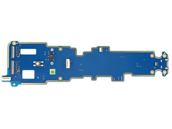

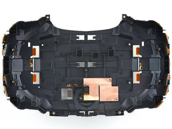

  13. HTC Vive Teardown: crwdns2935265:013crwdnd2935265:01crwdnd2935265:03crwdne2935265:0 HTC Vive Teardown: crwdns2935265:013crwdnd2935265:02crwdnd2935265:03crwdne2935265:0 HTC Vive Teardown: crwdns2935265:013crwdnd2935265:03crwdnd2935265:03crwdne2935265:0
    • Next out: the midframe that housed the motherboard. Clinging to its side we find a small ribbon cable that plays host to the headset button.
    • There are many Texas Instruments TLV70233 300 mA / 3.3 V LDO Regulators on the flex cable around the midframe.
    • A closer look at the midframe reveals a slot for the little black nub on the back of the left display panel.
    • This slot allows the nub to peek through and slide along that white Teflon strip, activating a linear potentiometer, used to track IPD position as you adjust the displays.
    • Ready to go deeper, we remove the twin lens-and-display assemblies from their housing and peel off the rubber light-gasket from around the lenses.

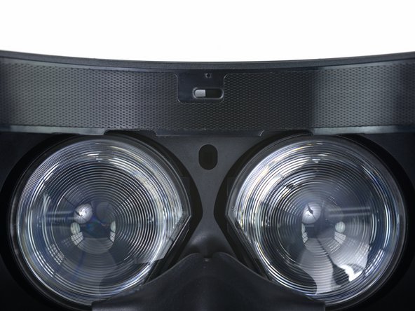

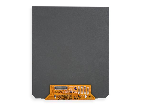

  15. HTC Vive Teardown: crwdns2935265:015crwdnd2935265:01crwdnd2935265:03crwdne2935265:0 HTC Vive Teardown: crwdns2935265:015crwdnd2935265:02crwdnd2935265:03crwdne2935265:0 HTC Vive Teardown: crwdns2935265:015crwdnd2935265:03crwdnd2935265:03crwdne2935265:0
    • After adios-ing four Phillips screws and doing a little investigative prying, we lift away the display cover for access to one of the twin Samsung-branded AMOLED panels.
    • Each display measures ~91.8 mm diagonally, which translates to ~447 ppi. For comparison, the Rift CV1 has ~456 ppi due to a slightly smaller display (90 mm) that still packs the same resolution as the Vive.

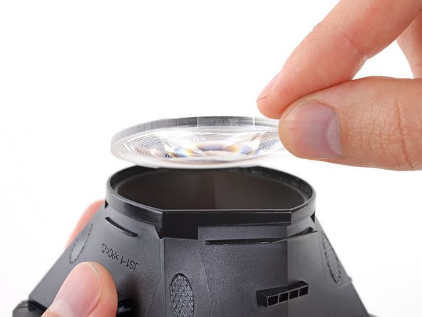

  16. HTC Vive Teardown: crwdns2935265:016crwdnd2935265:01crwdnd2935265:03crwdne2935265:0 HTC Vive Teardown: crwdns2935265:016crwdnd2935265:02crwdnd2935265:03crwdne2935265:0 HTC Vive Teardown: crwdns2935265:016crwdnd2935265:03crwdnd2935265:03crwdne2935265:0
    • A bit of adhesive secures each lens, but it doesn't take much to pop them out.
    • We note a set of concentric rings in each lens—the familiar indicator of Fresnel lenses.

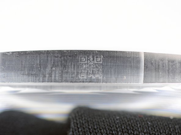

    • Unlike the hybrid lenses we encountered in the Oculus Rift, the Vive's lenses appear to have a uniform contour. It seems that HTC opted to control focus through adjustment of the eye relief.
    • Etched right into the side of the lens, we find the smallest QR code we've ever seen. Despite our best efforts, we can't get it to scan.
    • Maybe we just need a smaller phone.

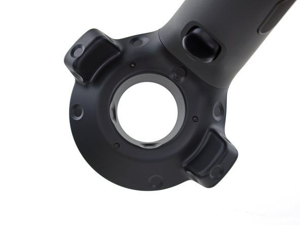

    • With the headset completely disassembled, it's time to move on to the controller. A quick inspection reveals the model number: 2PR7100.
    • The Vive is manufactured by HTC, but it's quite evident that Valve had plenty of input on the design process. The controller touchpad is very reminiscent of the ones we found on the Steam Controller.
    • In addition to the touchpad and buttons, the controller comes packed with 24 sensors (including two inside the ring!) that allow it to accurately track the its position based on the two Lighthouse base stations.

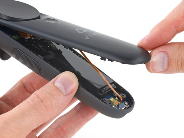

  18. HTC Vive Teardown: crwdns2935265:018crwdnd2935265:01crwdnd2935265:03crwdne2935265:0 HTC Vive Teardown: crwdns2935265:018crwdnd2935265:02crwdnd2935265:03crwdne2935265:0 HTC Vive Teardown: crwdns2935265:018crwdnd2935265:03crwdnd2935265:03crwdne2935265:0
    • A few Torx screws and some tough plastic clips keep the outer case and IR filters shut tight, but it's nothing we can't handle.
    • As we work our way down the controller, we find a ribbon cable booby trap, à la iPhone 5s and iPhone SE.
    • Trap defused, we pop open the handle and take a closer look.

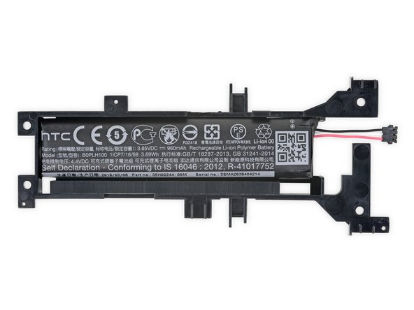

  19. HTC Vive Teardown: crwdns2935265:019crwdnd2935265:01crwdnd2935265:03crwdne2935265:0 HTC Vive Teardown: crwdns2935265:019crwdnd2935265:02crwdnd2935265:03crwdne2935265:0 HTC Vive Teardown: crwdns2935265:019crwdnd2935265:03crwdnd2935265:03crwdne2935265:0
    • After removing the touchpad assembly from the controller, we immediately notice that the daughterboard is near-identical to the one found in the Steam Controller.
    • Just like before, the touchpad is driven by a Cirque 1CA027 companion MCU.
    • As with the Steam Controller, the PCB also features seven well-labeled test points that make it easy to directly interface with the board for testing.
    • Up next is the 3.85 V, 3.69 Whr, and 960 mAh Li-poly battery. After giving it a good looksee, we spot the model number B0PLH100, and a large QR code.
    • Unfortunately, scanning the QR code doesn't reveal a secret message, just the serial number: 3SMA2638404214.
    • Amazing! We've got that same combination on our luggage.

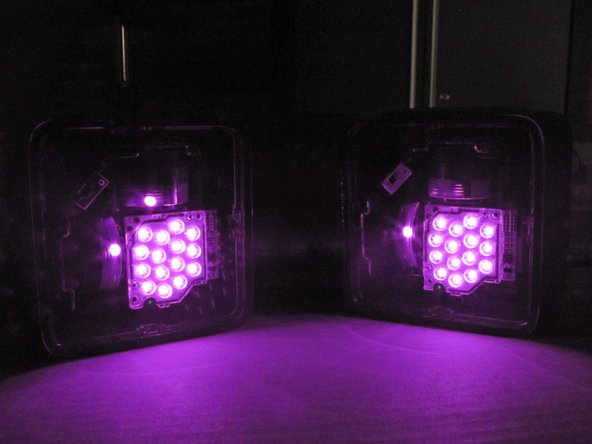

  22. HTC Vive Teardown: crwdns2935265:022crwdnd2935265:01crwdnd2935265:03crwdne2935265:0 HTC Vive Teardown: crwdns2935265:022crwdnd2935265:02crwdnd2935265:03crwdne2935265:0 HTC Vive Teardown: crwdns2935265:022crwdnd2935265:03crwdnd2935265:03crwdne2935265:0

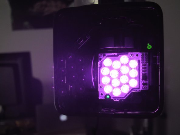

    • With the headset and controllers torn asunder, we move right along to one of the Lighthouse base stations. What secrets does it hold? Let's find out!
    • Firing up our IR camera, we get a glimpse of the internals through the IR-transparent front panel—an array of bright IR LEDs, and a pair of motorized lasers make the Lighthouse shine bright.
    • While the Rift works with an IR camera and some fancy machine vision software to follow the Constellation IR LED array, the Vive uses an entirely different system for position tracking.
    • Each Lighthouse flashes its IR LED array, signaling the start of a cycle. Vertical and horizontal lasers then sweep across the room, and all of those fancy photosensors on the headset and controllers start looking for lasers.
    • The tracked headset or controller can then determine its position based on the order its sensors receive the laser sweeps.
  23. HTC Vive Teardown: crwdns2935265:023crwdnd2935265:01crwdnd2935265:03crwdne2935265:0 HTC Vive Teardown: crwdns2935265:023crwdnd2935265:02crwdnd2935265:03crwdne2935265:0 HTC Vive Teardown: crwdns2935265:023crwdnd2935265:03crwdnd2935265:03crwdne2935265:0

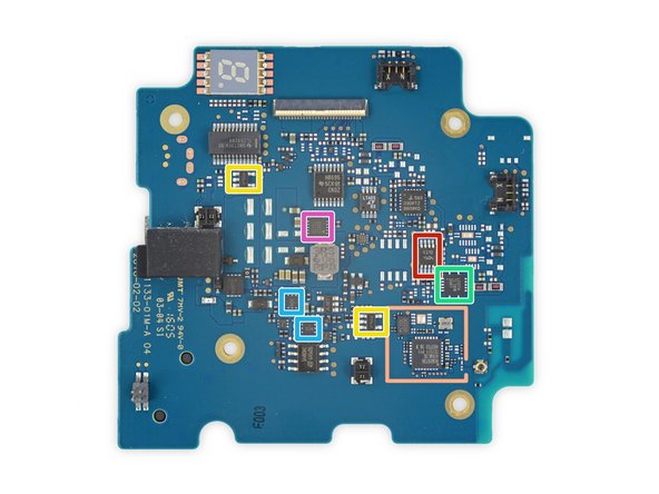

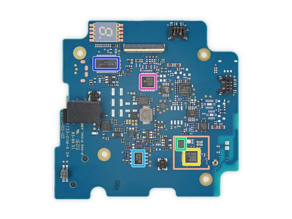

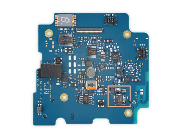

  24. HTC Vive Teardown: crwdns2935265:024crwdnd2935265:01crwdnd2935265:02crwdne2935265:0 HTC Vive Teardown: crwdns2935265:024crwdnd2935265:02crwdnd2935265:02crwdne2935265:0
    • The front panel removed with relative ease, we prepare for the harrowing task of extracting the complex internals from this optical tech marvel.
    • Aaaand we're done. Lucky for us, the whole unit is installed as a single assembly within the Lighthouse base station housing. Just remove the four Torx screws, and it falls right out.
    • With the cover off, we get a look at the array of IR LEDs and spinning motor-mounted laser emitters, as well as a single IR photodiode that allows the device to sync up with its counterpart.
    • IC identification:
    • ON Semiconductor FAN3111E MOSFET Driver
    • MOSFET

    • Let's shed some light on what sort of chips are powering the Lighthouse:
    • NXP Semiconductors LPC11U37F 32-Bit ARM Cortex-M0 Microcontroller
    • Texas Instruments (formerly National Semiconductor) LP38798SD 800 mA Linear Voltage Regulator
    • Broadcom BCM20736 Bluetooth Smart SoC
    • Macronix MX25L1006E 1 Mb Serial Flash Memory
    • STMicroelectronics ST1480AC 12 Mbps RS-485/RS-422 Transceiver
    • Texas Instruments TLC59284 16-Channel LED Driver
    • Texas Instruments SN74AHCT595DBR 8-Bit Shift Register With 3-State Output Register

    • Lighthouse IC identification, continued:
    • STMicroelectronics LIS2DH12 3-Axis MEMS Accelerometer
    • Dialog Semiconductor (formerly Silego) SLG46120 Programmable Mixed Signal Array
    • Renesas (formerly Intersil) ISL58303 800 mA Triple Output Laser Diode Driver
    • Texas Instruments DRV10866 3-Phase BLDC Motor Driver
    • Analog Devices (formerly Linear Technology) LTC6904 Serial Port Programmable Oscillator
    • ON Semiconductor FSA3000 2-Port USB 2.0 Switch
    • ON Semiconductor NCP305LSQ30T 3.0 V Voltage Detector

    • More Lighthouse IC identification:
    • STMicroelectronics LMV358 Dual Operational Amplifier
    • STMicroelectronics LMV321 Single Rail-to-Rail Operational Amplifier
    • Diodes Incorporated AP331A Single Differential Comparator
    • Texas Instruments SN74LVC07A Hex Buffer/Driver
    • ON Semiconductor NCP380HMUAJAATBG Power Distribution Switch
    • Texas Instruments TPS22920 4 A / 3.6 V Load Switch
    • Texas Instruments LMR12020 2 A Step-Down Voltage Regulator

    • Even more Lighthouse IC identification:
    • Texas Instruments LP38798 800 mA LDO Regulator
    • Diodes Incorporated AP2127K-3.3TRG1 300 mA / 3.3 V LDO Regulator
