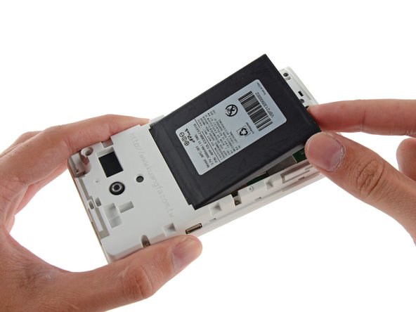

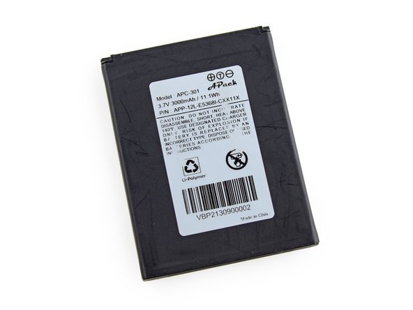

      • A thumbnail is the only tool you need to pop off Tango's rear cover and access the battery. (Well, a thumb would probably be pretty useful, too).
      • Cover off, battery out. Simple. Tango's development brainpower went into what's inside the phone, not into fancy chamfered edges or curved metal unibody enclosures.
      • Tango bears a hefty 3000 mAh battery, ready for developers to take it to the limit.
      • 3000 mAh may be big for a smartphone, but if it weren't for the ultra low power requirements of the vision coprocessor powering Tango's 3D imaging, it'd have to be a lot bigger.

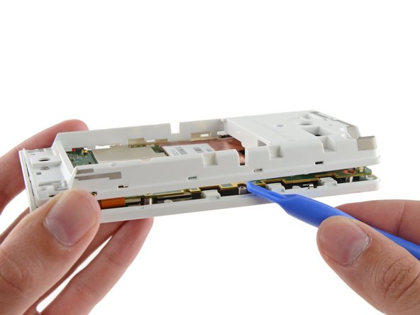

      • The turn of a screw, and pry of an opening tool and the motherlode motherboard is fully revealed.
      • Not a lick of adhesive in sight—just a loudspeaker with pressure contacts nestled snugly into the midframe.
      • The midframe, manufactured by Kuang Fa Plating Co, also houses a few integrated antennas, likewise connected via handy, cable-free spring contacts.

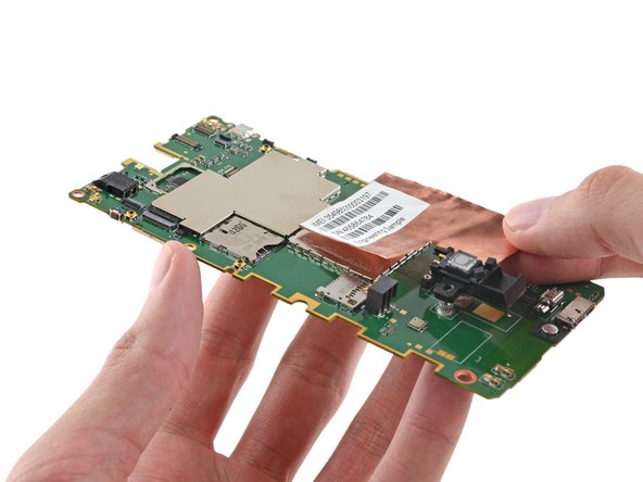

      • A few connectors to disconnect, some stickies to de-stick, and the motherboard is free.
      • Tango's sole purpose in life is to bring an exciting technology that's thus-far been limited to game consoles and Mars rovers to a mobile platform.
      • As such, it doesn't waste time with flashy looks or a slim body. It just packs its tech into a box in the simplest way possible. This is by far one of the easiest to disassemble phones we've encountered, giving the Fairphone a run for its money (or, ideally, some repairability pointers).

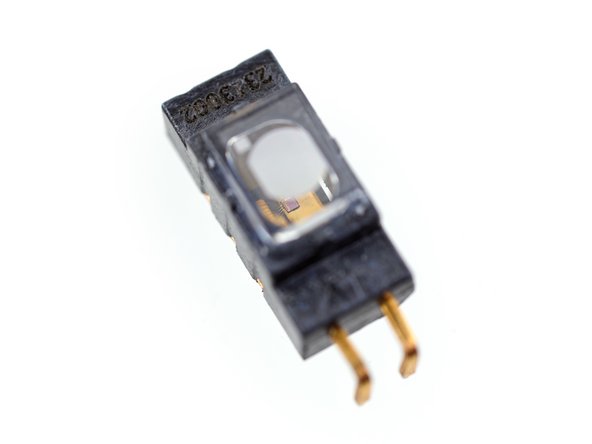

      • A huge chunk of copper provides electrical grounding and thermal dissipation for the lower sensor array. Something must get pretty warm down here...
      • ...And it looks like we've found our culprit, an infrared projector. Deep inside this tiny glass-topped box lives a series of infrared LEDs, powered by some hefty leads (for a smartphone).

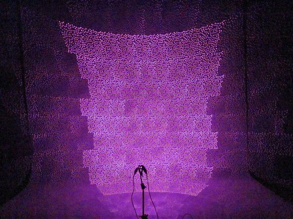

    9. Project Tango Teardown, Science with iFixit!: crwdns2935265:09crwdnd2935265:01crwdnd2935265:03crwdne2935265:0 Project Tango Teardown, Science with iFixit!: crwdns2935265:09crwdnd2935265:02crwdnd2935265:03crwdne2935265:0 Project Tango Teardown, Science with iFixit!: crwdns2935265:09crwdnd2935265:03crwdnd2935265:03crwdne2935265:0
      • Google didn't want us turning on our unit, so we had to figure out our own way to power up the IR projector.
      • A little gentle power applied, a home-hacked IR camera, and presto! Shiny dots on the photo room wall!
      • The bright grid of dots shows that Tango works similarly to the original Microsoft Kinect, with a grid of dots to be captured by the IR sensors of the 4 MP camera, building a depth map.
      • How does a grid of dots build a depth map? With science.

      • What's cooking in Tango?
      • Elpida FA164A1PB 2 GB LPDDR3 RAM, layered above a Qualcomm 8974 (Snapdragon 800) processor
      • Two Movidius Myriad 1 computer vision co-processors.
      • Two AMIC A25L016 16 Mbit low voltage serial flash memory ICs
      • InvenSense MPU-9150 9-axis gyroscope/accelerometer/compass MEMS motion tracking device
      • Skyworks 77629 multimode multiband power amplifier module for quad-band GSM/EDGE
      • PrimeSense PSX1200 Capri PS1200 3D sensor SoC

"How do you build the depth map? It certainly looks to us like nearer dots are smaller, and farther dots are more expanded. Measure the size of the dot, and you've got its distance from the projector."
This doesn't make sense, since from the point of view of the camera, the dots will appear the same size (perspective).
james7780 - crwdns2934203:0crwdne2934203:0 crwdns2950251:0crwdne2950251:0
http://en.wikipedia.org/wiki/Binocular_d...
If you have two images of the same subject from two vantage points you can calculate roughly the depth of the image. In this case it's slightly different since once of the "cameras" is actually a projector. So one viewpoint has a "perfect" image since it has the pattern hardcoded into its frame. You just need a camera then to record the projected image and extract a disparity map between the two. From that you can determine depth.
