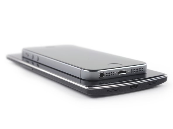

    3. OnePlus One Teardown: crwdns2935265:03crwdnd2935265:01crwdnd2935265:02crwdne2935265:0 OnePlus One Teardown: crwdns2935265:03crwdnd2935265:02crwdnd2935265:02crwdne2935265:0
      • Compared to the current top-selling smartphone, the iPhone 5s, the One is slightly thicker at 8.9 mm (vs. 7.6 mm) and significantly taller at 152.9 mm (vs. 123.8 mm).
      • While this isn't quite a phablet, reviewers are saying this One's a tad big for single-hand use. Unless, of course, you're the Hulk.

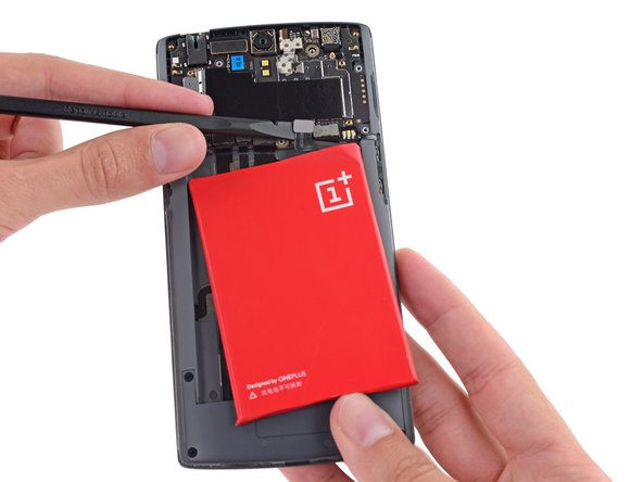

    7. OnePlus One Teardown: crwdns2935265:07crwdnd2935265:01crwdnd2935265:02crwdne2935265:0 OnePlus One Teardown: crwdns2935265:07crwdnd2935265:02crwdnd2935265:02crwdne2935265:0
      • We poke at the giant red battery for a bit (reenactment of actual events) until we finally succeed in popping it up with a spudger.
      • Alas! It seems our reach has temporarily exceeded our bite, as the battery cable disappears under a screwed-in panel.
    8. OnePlus One Teardown: crwdns2935265:08crwdnd2935265:01crwdnd2935265:03crwdne2935265:0 OnePlus One Teardown: crwdns2935265:08crwdnd2935265:02crwdnd2935265:03crwdne2935265:0 OnePlus One Teardown: crwdns2935265:08crwdnd2935265:03crwdnd2935265:03crwdne2935265:0
      • No matter—out go the first round of screws, thanks to our Pro Tech Screwdriver Set.
      • But it's not over yet! The One deals us a one-two punch with some hidden screws.
      • We don't take kindly to screws hidden under rubber stoppers around here. And that last screw is sporting a white sticker on its head, now forever maimed by our screwdriver, proving that we've been inside…tampering.
      • The device hasn't proven especially difficult to enter, but small deterrents like hidden and tamper-evident screws never sit well with us.
    9. OnePlus One Teardown: crwdns2935265:09crwdnd2935265:01crwdnd2935265:03crwdne2935265:0 OnePlus One Teardown: crwdns2935265:09crwdnd2935265:02crwdnd2935265:03crwdne2935265:0 OnePlus One Teardown: crwdns2935265:09crwdnd2935265:03crwdnd2935265:03crwdne2935265:0
      • We pull off an interior cover to access the battery connector. If our calculations are correct, the OnePlus One's battery is about to be subtracted.
      • Our spudger performs the necessary arithmetic, and the 3.8 V, 3100 mAh LiPo battery is ours (and yours) to inspect.
      • It fares well when compared to its 2800 mAh (Galaxy S5) and 2600 mAh (HTC One M8) rivals.
      • For those of us who don't read Chinese, this battery sports a maximum charging voltage of 4.35 V, and the following warnings and cautions (paraphrased):
      • Only use with approved chargers
      • Keep ventilated while charging
      • Do not tear down, short circuit, or puncture
