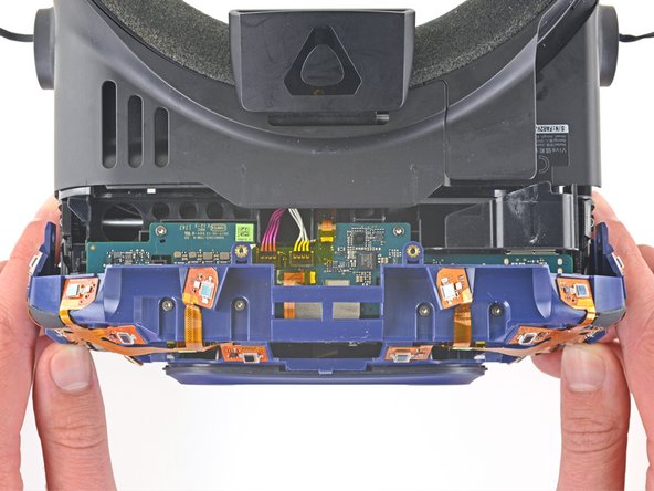

    1. HTC Vive Pro Sensor Array Replacement, Remove the face rest cushion: crwdns2935265:018crwdnd2935265:01crwdnd2935265:03crwdne2935265:0 HTC Vive Pro Sensor Array Replacement, Remove the face rest cushion: crwdns2935265:018crwdnd2935265:02crwdnd2935265:03crwdne2935265:0 HTC Vive Pro Sensor Array Replacement, Remove the face rest cushion: crwdns2935265:018crwdnd2935265:03crwdnd2935265:03crwdne2935265:0
      • Use your fingers to gently peel the face rest cushion off of the headset.
    1. HTC Vive Pro Sensor Array Replacement, Remove the facerest: crwdns2935265:019crwdnd2935265:01crwdnd2935265:02crwdne2935265:0 HTC Vive Pro Sensor Array Replacement, Remove the facerest: crwdns2935265:019crwdnd2935265:02crwdnd2935265:02crwdne2935265:0
      • Partially separate the facerest and the sensor array to access the daughterboard.

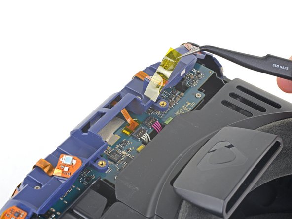

    2. HTC Vive Pro Sensor Array Replacement: crwdns2935265:020crwdnd2935265:01crwdnd2935265:02crwdne2935265:0 HTC Vive Pro Sensor Array Replacement: crwdns2935265:020crwdnd2935265:02crwdnd2935265:02crwdne2935265:0
      • Use a pair of tweezers to remove the Kapton tape covering the white and purple wires on the daughterboard.

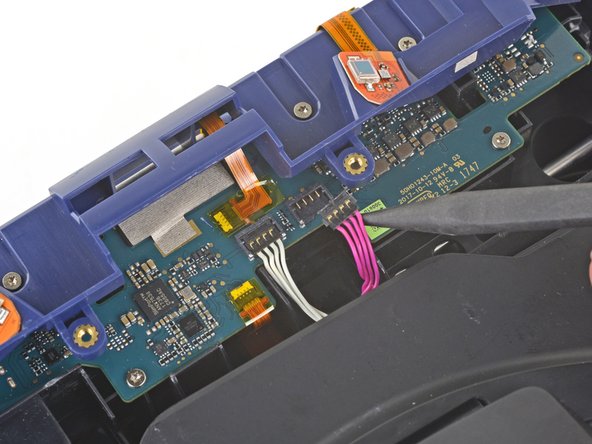

    3. HTC Vive Pro Sensor Array Replacement: crwdns2935265:021crwdnd2935265:01crwdnd2935265:03crwdne2935265:0 HTC Vive Pro Sensor Array Replacement: crwdns2935265:021crwdnd2935265:02crwdnd2935265:03crwdne2935265:0 HTC Vive Pro Sensor Array Replacement: crwdns2935265:021crwdnd2935265:03crwdnd2935265:03crwdne2935265:0
      • Use the pointed end of a spudger to pry up and disconnect the purple and white wires from the daughterboard.
      • Use caution when disconnecting these wires. If you pry up too hard, they may pull out of the connector.
    4. HTC Vive Pro Sensor Array Replacement: crwdns2935265:022crwdnd2935265:01crwdnd2935265:02crwdne2935265:0 HTC Vive Pro Sensor Array Replacement: crwdns2935265:022crwdnd2935265:02crwdnd2935265:02crwdne2935265:0
      • Slide the facerest out of the front assembly.
