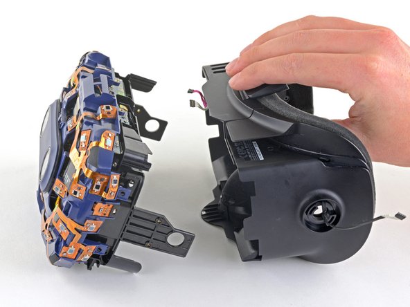

    • Carefully slide each half of the outer shell off of the sensor array.
    • Be careful not to snag any of the ribbon cables underneath.

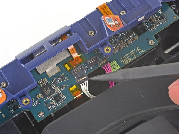

  21. HTC Vive Pro Motherboard Replacement: crwdns2935265:021crwdnd2935265:01crwdnd2935265:03crwdne2935265:0 HTC Vive Pro Motherboard Replacement: crwdns2935265:021crwdnd2935265:02crwdnd2935265:03crwdne2935265:0 HTC Vive Pro Motherboard Replacement: crwdns2935265:021crwdnd2935265:03crwdnd2935265:03crwdne2935265:0
    • Use the pointed end of a spudger to pry up and disconnect the purple and white wires from the daughterboard.
    • Use caution when disconnecting these wires. If you pry up too hard, they may pull out of the connector.

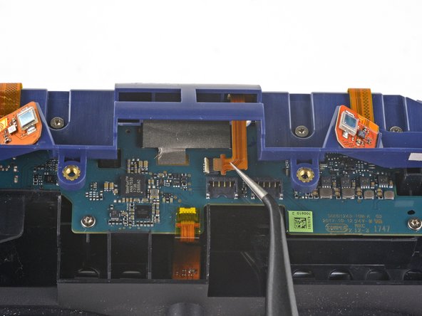

  22. HTC Vive Pro Motherboard Replacement: crwdns2935265:022crwdnd2935265:01crwdnd2935265:02crwdne2935265:0 HTC Vive Pro Motherboard Replacement: crwdns2935265:022crwdnd2935265:02crwdnd2935265:02crwdne2935265:0
    • Slide the facerest out of the front assembly.

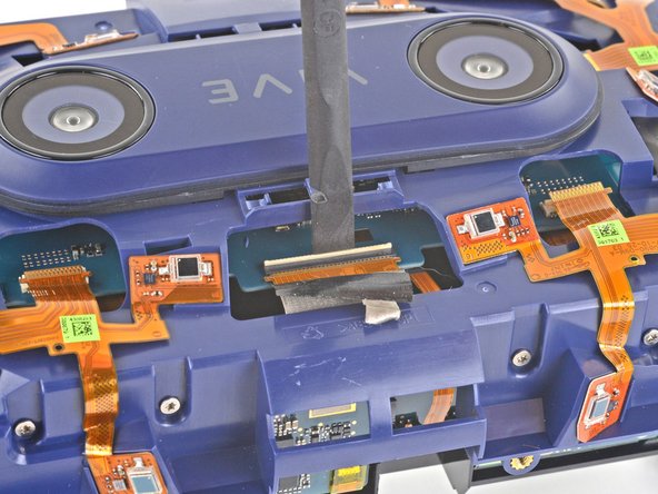

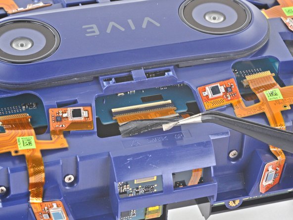

  23. HTC Vive Pro Motherboard Replacement, Remove the sensor array: crwdns2935265:023crwdnd2935265:01crwdnd2935265:02crwdne2935265:0 HTC Vive Pro Motherboard Replacement, Remove the sensor array: crwdns2935265:023crwdnd2935265:02crwdnd2935265:02crwdne2935265:0

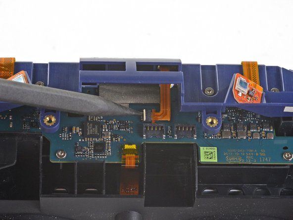

    • Use a pair of tweezers to remove the Kapton tape covering the ZIF connector on the daughterboard.
  24. HTC Vive Pro Motherboard Replacement: crwdns2935265:024crwdnd2935265:01crwdnd2935265:03crwdne2935265:0 HTC Vive Pro Motherboard Replacement: crwdns2935265:024crwdnd2935265:02crwdnd2935265:03crwdne2935265:0 HTC Vive Pro Motherboard Replacement: crwdns2935265:024crwdnd2935265:03crwdnd2935265:03crwdne2935265:0
    • Use the pointed end of a spudger to flip up the locking flap on the daughterboard ZIF connector.
    • Use a pair of tweezers to slide the ribbon cable out of its socket.

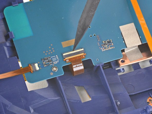

  25. HTC Vive Pro Motherboard Replacement: crwdns2935265:025crwdnd2935265:01crwdnd2935265:02crwdne2935265:0 HTC Vive Pro Motherboard Replacement: crwdns2935265:025crwdnd2935265:02crwdnd2935265:02crwdne2935265:0
    • Use a pair of tweezers to peel back the grey tape covering the ZIF connector on the motherboard underneath the sensor array.

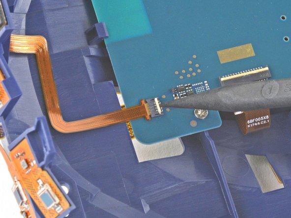

  26. HTC Vive Pro Motherboard Replacement: crwdns2935265:026crwdnd2935265:01crwdnd2935265:03crwdne2935265:0 HTC Vive Pro Motherboard Replacement: crwdns2935265:026crwdnd2935265:02crwdnd2935265:03crwdne2935265:0 HTC Vive Pro Motherboard Replacement: crwdns2935265:026crwdnd2935265:03crwdnd2935265:03crwdne2935265:0
    • Use the flat end of your spudger to flip up the locking flap for the ZIF connector on the motherboard.
    • Use the pointed end of your spudger to disconnect the ribbon cable from the motherboard.

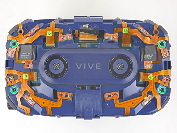

    • Use a T5 Torx screwdriver to remove the four 3.0 mm silver screws securing the sensor array to the lens and OLED assembly.
    • Use a T6 Torx screwdriver to remove the four black 3.8 mm screws securing the sensor array.

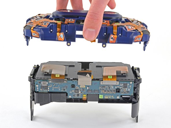

    • Lift the sensor array straight up off of the lens and OLED assembly.

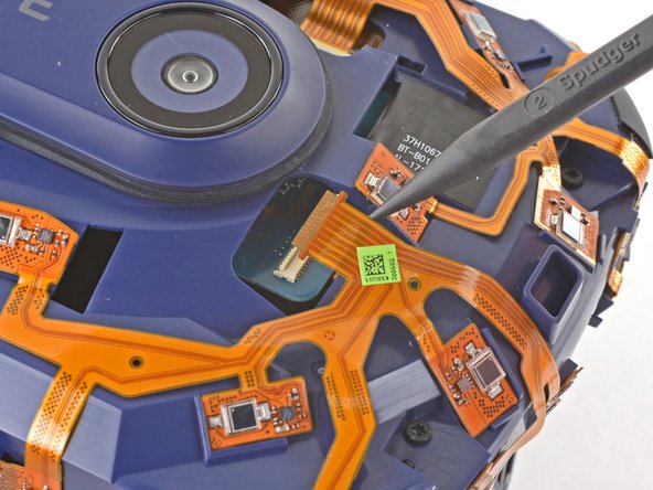

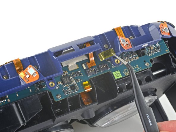

  29. HTC Vive Pro Motherboard Replacement, Disconnect the motherboard from the sensor array: crwdns2935265:029crwdnd2935265:01crwdnd2935265:03crwdne2935265:0 HTC Vive Pro Motherboard Replacement, Disconnect the motherboard from the sensor array: crwdns2935265:029crwdnd2935265:02crwdnd2935265:03crwdne2935265:0 HTC Vive Pro Motherboard Replacement, Disconnect the motherboard from the sensor array: crwdns2935265:029crwdnd2935265:03crwdnd2935265:03crwdne2935265:0

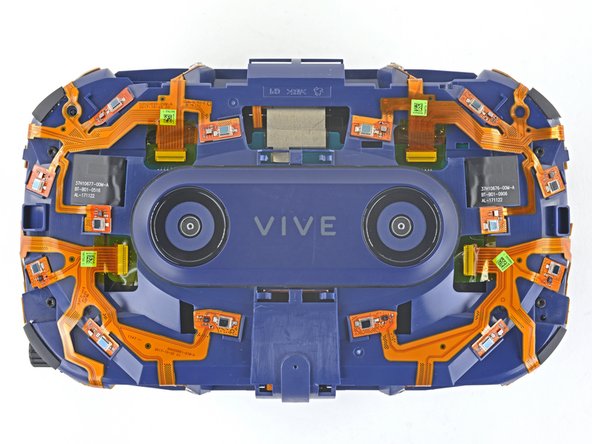

    • Use a pair of tweezers or your fingers to remove the four pieces of Kapton tape covering the ZIF connectors.
  30. HTC Vive Pro Motherboard Replacement: crwdns2935265:030crwdnd2935265:01crwdnd2935265:03crwdne2935265:0 HTC Vive Pro Motherboard Replacement: crwdns2935265:030crwdnd2935265:02crwdnd2935265:03crwdne2935265:0 HTC Vive Pro Motherboard Replacement: crwdns2935265:030crwdnd2935265:03crwdnd2935265:03crwdne2935265:0

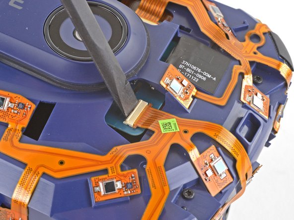

    • Use the flat end of your spudger to flip up the locking flap on a ZIF connector on the sensor array.
    • Use the pointed end of your spudger to disconnect the ribbon cable from its ZIF connector.
    • Repeat this procedure for all four of the ZIF connectors.

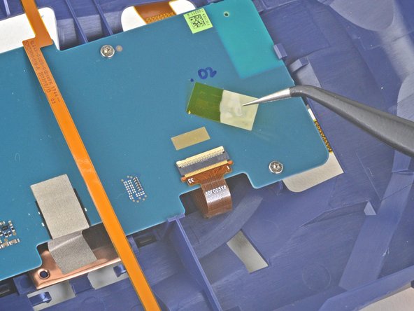

  31. HTC Vive Pro Motherboard Replacement: crwdns2935265:031crwdnd2935265:01crwdnd2935265:02crwdne2935265:0 HTC Vive Pro Motherboard Replacement: crwdns2935265:031crwdnd2935265:02crwdnd2935265:02crwdne2935265:0

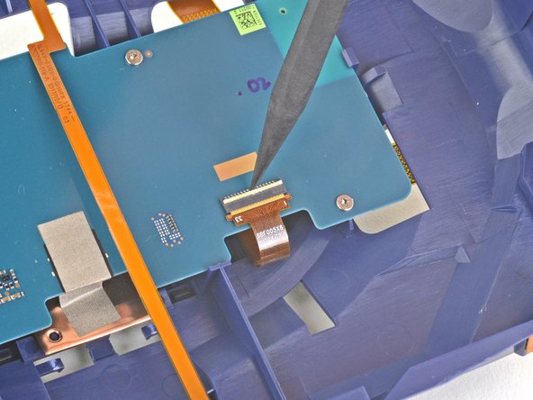

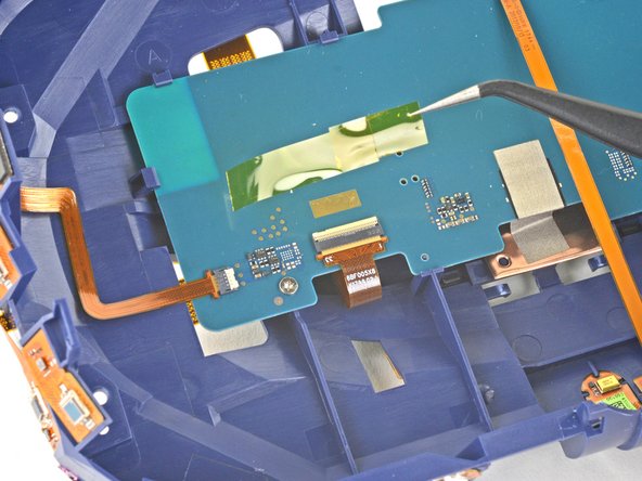

    • Use a pair of tweezers to remove the Kapton tape covering the two ZIF connectors on the back of the motherboard.

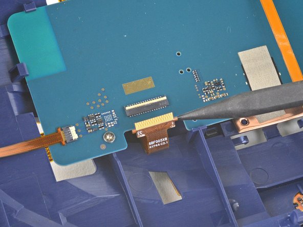

  32. HTC Vive Pro Motherboard Replacement: crwdns2935265:032crwdnd2935265:01crwdnd2935265:03crwdne2935265:0 HTC Vive Pro Motherboard Replacement: crwdns2935265:032crwdnd2935265:02crwdnd2935265:03crwdne2935265:0 HTC Vive Pro Motherboard Replacement: crwdns2935265:032crwdnd2935265:03crwdnd2935265:03crwdne2935265:0
    • Use the point of your spudger to unlock the ZIF connector on the back of the motherboard.
    • Use the spudger, or your fingers, to slide the ribbon cable out of its socket.

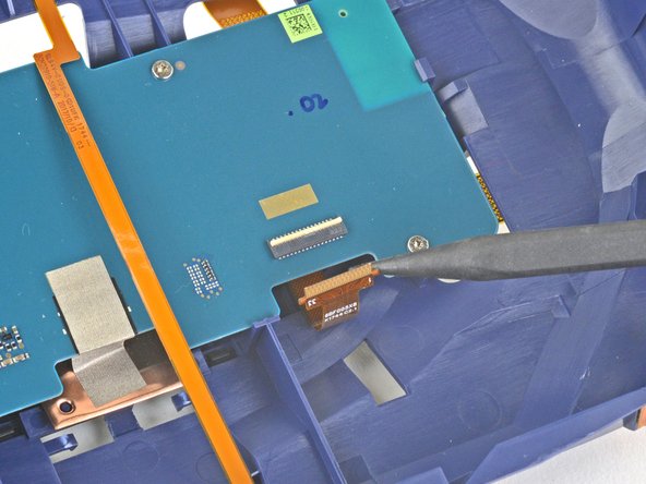

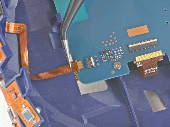

  33. HTC Vive Pro Motherboard Replacement: crwdns2935265:033crwdnd2935265:01crwdnd2935265:03crwdne2935265:0 HTC Vive Pro Motherboard Replacement: crwdns2935265:033crwdnd2935265:02crwdnd2935265:03crwdne2935265:0 HTC Vive Pro Motherboard Replacement: crwdns2935265:033crwdnd2935265:03crwdnd2935265:03crwdne2935265:0

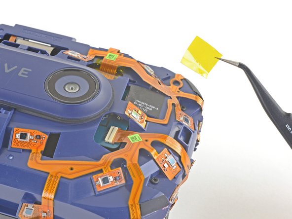

  34. HTC Vive Pro Motherboard Replacement: crwdns2935265:034crwdnd2935265:01crwdnd2935265:02crwdne2935265:0 HTC Vive Pro Motherboard Replacement: crwdns2935265:034crwdnd2935265:02crwdnd2935265:02crwdne2935265:0
    • Use a pair of tweezers to remove the Kapton tape covering the remaining ZIF connector on the back of the motherboard.
  35. HTC Vive Pro Motherboard Replacement: crwdns2935265:035crwdnd2935265:01crwdnd2935265:03crwdne2935265:0 HTC Vive Pro Motherboard Replacement: crwdns2935265:035crwdnd2935265:02crwdnd2935265:03crwdne2935265:0 HTC Vive Pro Motherboard Replacement: crwdns2935265:035crwdnd2935265:03crwdnd2935265:03crwdne2935265:0
    • Use the pointed end of your spudger to unlock the ZIF connector on the back of the motherboard.

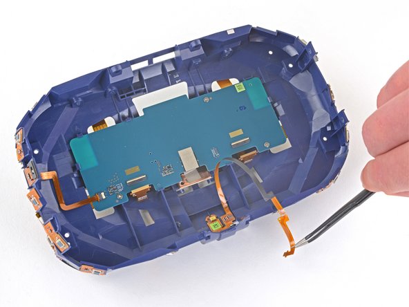

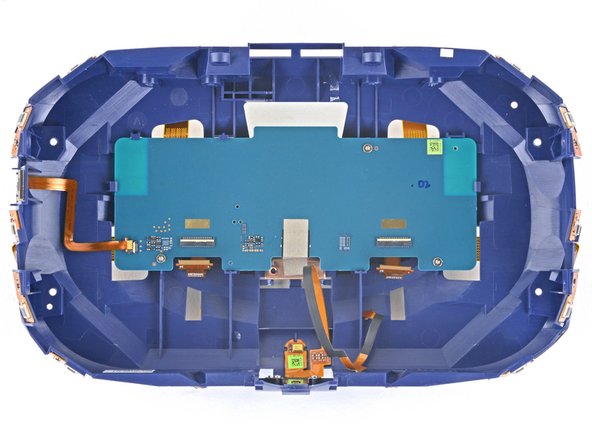

  36. HTC Vive Pro Motherboard Replacement, Remove the motherboard: crwdns2935265:036crwdnd2935265:01crwdnd2935265:02crwdne2935265:0 HTC Vive Pro Motherboard Replacement, Remove the motherboard: crwdns2935265:036crwdnd2935265:02crwdnd2935265:02crwdne2935265:0
    • Reposition the long ribbon cable covering the back of the motherboard so it's out of the way.
    • Don't sharply crease or fold the ribbon cable.
  37. HTC Vive Pro Motherboard Replacement: crwdns2935265:037crwdnd2935265:01crwdnd2935265:02crwdne2935265:0 HTC Vive Pro Motherboard Replacement: crwdns2935265:037crwdnd2935265:02crwdnd2935265:02crwdne2935265:0
    • Use a T5 Torx screwdriver to remove the three 3.0 mm‑long screws securing the motherboard to the sensor array.
  38. HTC Vive Pro Motherboard Replacement: crwdns2935265:038crwdnd2935265:01crwdnd2935265:01crwdne2935265:0
    • Apply a heated iOpener to the back of the motherboard for one minute to soften the light adhesive securing it to the sensor array.
  39. HTC Vive Pro Motherboard Replacement: crwdns2935265:039crwdnd2935265:01crwdnd2935265:01crwdne2935265:0
    • Remove the motherboard from the sensor array.
    • There are several plastic clips lightly securing the perimeter of the motherboard to the sensor array.
