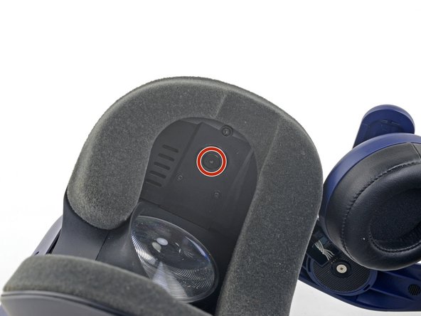

  10. HTC Vive Pro Head Strap Replacement, Remove the head strap: crwdns2935265:010crwdnd2935265:01crwdnd2935265:02crwdne2935265:0 HTC Vive Pro Head Strap Replacement, Remove the head strap: crwdns2935265:010crwdnd2935265:02crwdnd2935265:02crwdne2935265:0
    • Use a T6 Torx screwdriver to remove the two 12.1 mm screws (one on each side) securing the head strap to the headset.
  11. HTC Vive Pro Head Strap Replacement: crwdns2935265:011crwdnd2935265:01crwdnd2935265:01crwdne2935265:0
    • Remove the two plastic spacers underneath the previously removed Torx T6 screw.
  12. HTC Vive Pro Head Strap Replacement: crwdns2935265:012crwdnd2935265:01crwdnd2935265:03crwdne2935265:0 HTC Vive Pro Head Strap Replacement: crwdns2935265:012crwdnd2935265:02crwdnd2935265:03crwdne2935265:0 HTC Vive Pro Head Strap Replacement: crwdns2935265:012crwdnd2935265:03crwdnd2935265:03crwdne2935265:0
    • Thread the headphone speaker wires out through both ends of the head strap.
  13. HTC Vive Pro Head Strap Replacement, Only the head strap remains: crwdns2935265:013crwdnd2935265:01crwdnd2935265:01crwdne2935265:0
    • Transfer all foam pads from the old head strap to the new one.

There is a missing step. The replacement part doesn't contain anything to connect the audio wires to. You will have to remove a screw and pry up the little board that has the headphone connector on it. The spudger works well for this. Be aware that in addition to the screw, this little audio connector board is also held on with adhesive, so you will need to peel it off. The adhesive isn't too strong, so you can get it up pretty easily. When putting the audio connectors into the replacement head strap you'll want to be sure to peel off the backing on the adhesive before seating the board on it.
