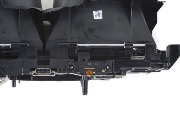

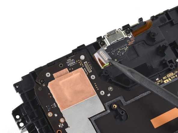

  40. HTC Vive Focus USB-C Port Replacement, Disconnect the USB-C port: crwdns2935265:040crwdnd2935265:01crwdnd2935265:02crwdne2935265:0 HTC Vive Focus USB-C Port Replacement, Disconnect the USB-C port: crwdns2935265:040crwdnd2935265:02crwdnd2935265:02crwdne2935265:0
    • Use the tip of a spudger to disconnect the USB-C port ribbon cable from the motherboard.
  41. HTC Vive Focus USB-C Port Replacement, Remove the USB-C port: crwdns2935265:041crwdnd2935265:01crwdnd2935265:02crwdne2935265:0 HTC Vive Focus USB-C Port Replacement, Remove the USB-C port: crwdns2935265:041crwdnd2935265:02crwdnd2935265:02crwdne2935265:0

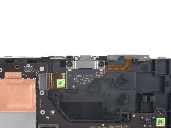

    • Use a T5 Torx screwdriver to remove the two 5.5 mm screws securing the USB-C port to the top of the midframe.
  42. HTC Vive Focus USB-C Port Replacement: crwdns2935265:042crwdnd2935265:01crwdnd2935265:02crwdne2935265:0 HTC Vive Focus USB-C Port Replacement: crwdns2935265:042crwdnd2935265:02crwdnd2935265:02crwdne2935265:0
    • Use a T5 Torx screwdriver to remove the two 5.5 mm screws securing the USB-C port to the front of the midframe.
  43. HTC Vive Focus USB-C Port Replacement: crwdns2935265:043crwdnd2935265:01crwdnd2935265:01crwdne2935265:0
    • Remove the USB-C port.
