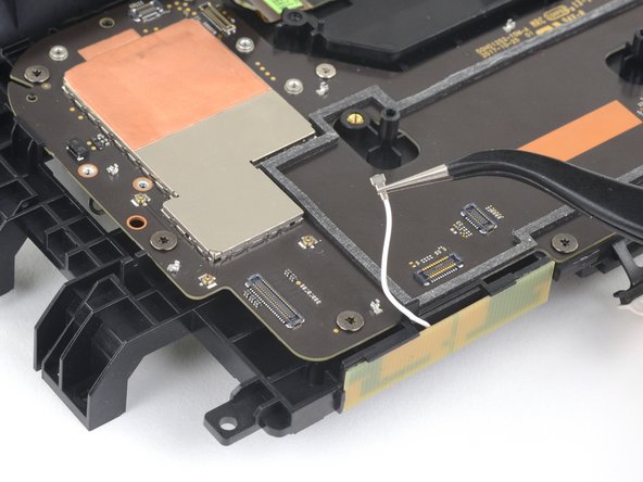

  28. HTC Vive Focus Motherboard Replacement, Remove the internal assembly: crwdns2935265:028crwdnd2935265:01crwdnd2935265:03crwdne2935265:0 HTC Vive Focus Motherboard Replacement, Remove the internal assembly: crwdns2935265:028crwdnd2935265:02crwdnd2935265:03crwdne2935265:0 HTC Vive Focus Motherboard Replacement, Remove the internal assembly: crwdns2935265:028crwdnd2935265:03crwdnd2935265:03crwdne2935265:0
    • Antenna connectors are fragile and can break off of the motherboard. Use this technique when disconnecting antenna cables.
    • Use a spudger or a pair of tweezers to disconnect the red antenna cable from the front of the device.
    • De-route the antenna cable from the front of the device and place it to the side.
    • During reassembly, be sure to re-route the cable through the brackets and clips securing it.
  29. HTC Vive Focus Motherboard Replacement: crwdns2935265:029crwdnd2935265:01crwdnd2935265:03crwdne2935265:0 HTC Vive Focus Motherboard Replacement: crwdns2935265:029crwdnd2935265:02crwdnd2935265:03crwdne2935265:0 HTC Vive Focus Motherboard Replacement: crwdns2935265:029crwdnd2935265:03crwdnd2935265:03crwdne2935265:0
    • Use a spudger or a pair of tweezers to remove the black antenna cable from the motherboard.
    • During reassembly, re-route the black antenna cable through its channel and clip.

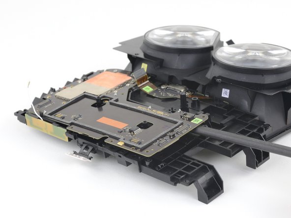

  35. HTC Vive Focus Motherboard Replacement: crwdns2935265:035crwdnd2935265:01crwdnd2935265:02crwdne2935265:0 HTC Vive Focus Motherboard Replacement: crwdns2935265:035crwdnd2935265:02crwdnd2935265:02crwdne2935265:0
    • Use a T5 Torx screwdriver to remove the two 4.5 mm screws securing the bracket under the left lens.
  36. HTC Vive Focus Motherboard Replacement: crwdns2935265:036crwdnd2935265:01crwdnd2935265:02crwdne2935265:0 HTC Vive Focus Motherboard Replacement: crwdns2935265:036crwdnd2935265:02crwdnd2935265:02crwdne2935265:0
    • Remove the bracket under the left lens.
    • To ensure correct operation, make sure this piece is properly seated on the adjuster mechanism by sliding the lenses as close together as possible before reinstalling it.
  37. HTC Vive Focus Motherboard Replacement: crwdns2935265:037crwdnd2935265:01crwdnd2935265:03crwdne2935265:0 HTC Vive Focus Motherboard Replacement: crwdns2935265:037crwdnd2935265:02crwdnd2935265:03crwdne2935265:0 HTC Vive Focus Motherboard Replacement: crwdns2935265:037crwdnd2935265:03crwdnd2935265:03crwdne2935265:0

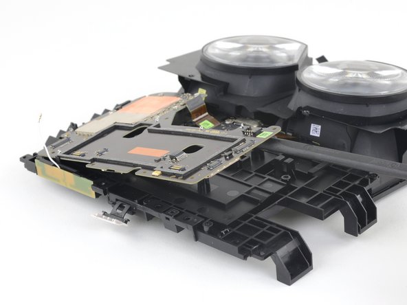

    • Before removing the internal assembly, tilt the front out slightly to feed the microSD card slot cover through the frame.
  38. HTC Vive Focus Motherboard Replacement: crwdns2935265:038crwdnd2935265:01crwdnd2935265:03crwdne2935265:0 HTC Vive Focus Motherboard Replacement: crwdns2935265:038crwdnd2935265:02crwdnd2935265:03crwdne2935265:0 HTC Vive Focus Motherboard Replacement: crwdns2935265:038crwdnd2935265:03crwdnd2935265:03crwdne2935265:0
    • Carefully remove the internal assembly through the front of the device.
    • The internal assembly may not come out easily. Gently bend the outer frame as necessary to create space for the edges to clear.
    • Do not force any part of the internal assembly out.
    • During reassembly, feed the microSD slot cover referenced in the previous step back through the frame as you slide the internal assembly back into place.

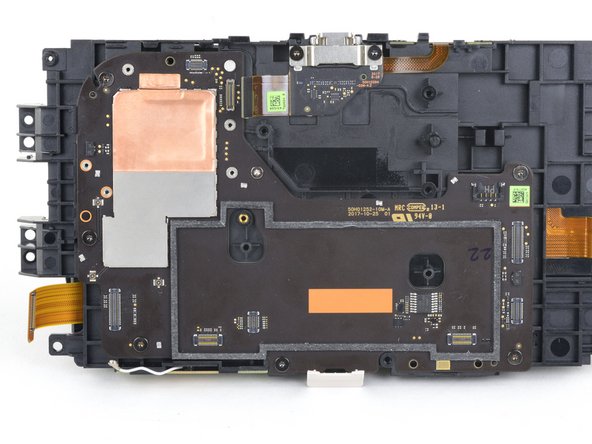

  39. HTC Vive Focus Motherboard Replacement, Reassembly tips: crwdns2935265:039crwdnd2935265:01crwdnd2935265:02crwdne2935265:0 HTC Vive Focus Motherboard Replacement, Reassembly tips: crwdns2935265:039crwdnd2935265:02crwdnd2935265:02crwdne2935265:0
    • During reassembly:
    • Make sure not to trap any of the five loose wires and cables when reinstalling the internal assembly.
    • Hold the lenses as close together as possible and align the rack and pinion with the gear and washer.
    • This will ensure the lenses are properly aligned.

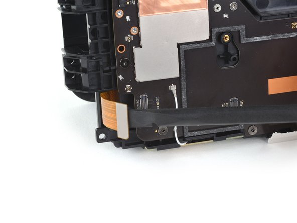

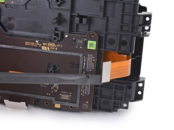

  40. HTC Vive Focus Motherboard Replacement, Disconnect the LED displays: crwdns2935265:040crwdnd2935265:01crwdnd2935265:02crwdne2935265:0 HTC Vive Focus Motherboard Replacement, Disconnect the LED displays: crwdns2935265:040crwdnd2935265:02crwdnd2935265:02crwdne2935265:0
    • Use the flat end of a spudger to disconnect the left LED display ribbon cable from the motherboard.
  41. HTC Vive Focus Motherboard Replacement: crwdns2935265:041crwdnd2935265:01crwdnd2935265:02crwdne2935265:0 HTC Vive Focus Motherboard Replacement: crwdns2935265:041crwdnd2935265:02crwdnd2935265:02crwdne2935265:0
    • Use the flat end of a spudger to disconnect the right LED display ribbon cable from the motherboard.

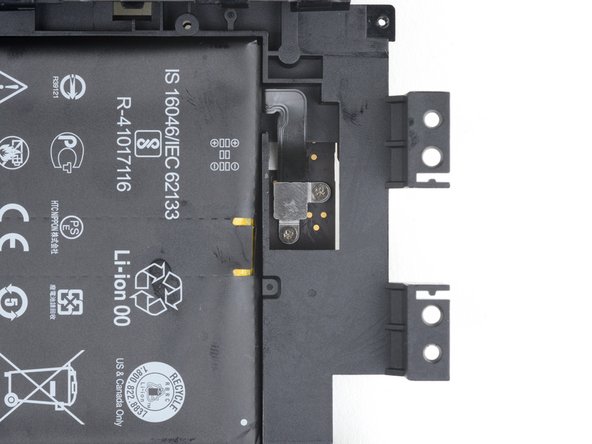

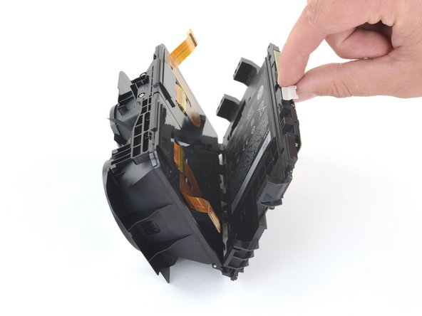

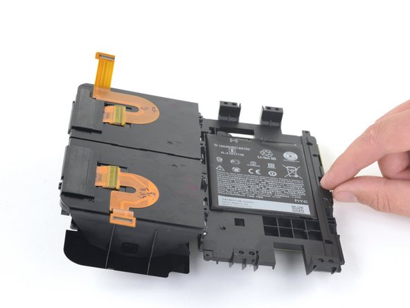

  42. HTC Vive Focus Motherboard Replacement, Open the midframe: crwdns2935265:042crwdnd2935265:01crwdnd2935265:03crwdne2935265:0 HTC Vive Focus Motherboard Replacement, Open the midframe: crwdns2935265:042crwdnd2935265:02crwdnd2935265:03crwdne2935265:0 HTC Vive Focus Motherboard Replacement, Open the midframe: crwdns2935265:042crwdnd2935265:03crwdnd2935265:03crwdne2935265:0
    • Swing the midframe open to access the battery.
    • During reassembly, be careful not to crush the LED display ribbon cables when folding the midframe back into place.

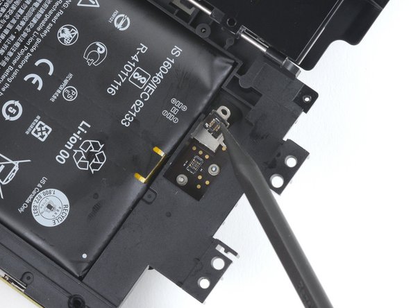

  43. HTC Vive Focus Motherboard Replacement, Disconnect the battery: crwdns2935265:043crwdnd2935265:01crwdnd2935265:02crwdne2935265:0 HTC Vive Focus Motherboard Replacement, Disconnect the battery: crwdns2935265:043crwdnd2935265:02crwdnd2935265:02crwdne2935265:0
    • Use a Phillips screwdriver to remove the two 2.3 mm screws securing the battery cable to the back of the motherboard.
  44. HTC Vive Focus Motherboard Replacement: crwdns2935265:044crwdnd2935265:01crwdnd2935265:02crwdne2935265:0 HTC Vive Focus Motherboard Replacement: crwdns2935265:044crwdnd2935265:02crwdnd2935265:02crwdne2935265:0
    • Use the tip of a spudger to disconnect the battery from the back of the motherboard.
    • During reassembly, use a spudger to align the battery connector screw holes and press it into place.
  45. HTC Vive Focus Motherboard Replacement, Remove the motherboard: crwdns2935265:045crwdnd2935265:01crwdnd2935265:02crwdne2935265:0 HTC Vive Focus Motherboard Replacement, Remove the motherboard: crwdns2935265:045crwdnd2935265:02crwdnd2935265:02crwdne2935265:0
    • Flip the internal assembly over to access the motherboard.
    • Use a pair of tweezers to disconnect the white antenna cable from the motherboard.
  46. HTC Vive Focus Motherboard Replacement: crwdns2935265:046crwdnd2935265:01crwdnd2935265:02crwdne2935265:0 HTC Vive Focus Motherboard Replacement: crwdns2935265:046crwdnd2935265:02crwdnd2935265:02crwdne2935265:0
    • Use a T5 Torx screwdriver to remove the following screws securing the motherboard to the midframe:
    • Six 5.5 mm black screws
    • One 2.9 mm silver screw
  47. HTC Vive Focus Motherboard Replacement: crwdns2935265:047crwdnd2935265:01crwdnd2935265:01crwdne2935265:0
    • The motherboard is still secured to the midframe with adhesive.
    • Apply a heated iOpener to the motherboard for one minute.
  48. HTC Vive Focus Motherboard Replacement: crwdns2935265:048crwdnd2935265:01crwdnd2935265:03crwdne2935265:0 HTC Vive Focus Motherboard Replacement: crwdns2935265:048crwdnd2935265:02crwdnd2935265:03crwdne2935265:0 HTC Vive Focus Motherboard Replacement: crwdns2935265:048crwdnd2935265:03crwdnd2935265:03crwdne2935265:0
    • Use the flat end of a spudger to pry the motherboard off of the midframe.
    • If the motherboard is difficult to remove, apply isopropyl alcohol between the motherboard and midframe and allow it to soak for one minute to soften the adhesive.
    • It is not necessary to apply adhesive to the new motherboard. The screws are sufficient to secure it to the midframe.
  49. HTC Vive Focus Motherboard Replacement: crwdns2935265:049crwdnd2935265:01crwdnd2935265:01crwdne2935265:0
    • Remove the motherboard.
