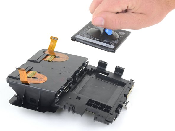

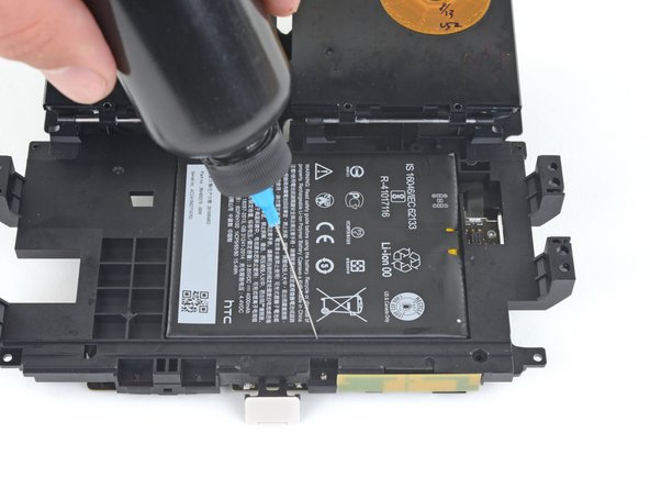

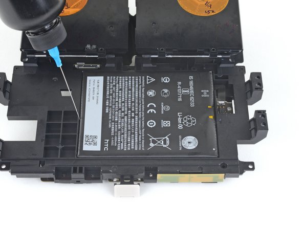

  42. HTC Vive Focus Battery Replacement, Open the midframe: crwdns2935265:042crwdnd2935265:01crwdnd2935265:03crwdne2935265:0 HTC Vive Focus Battery Replacement, Open the midframe: crwdns2935265:042crwdnd2935265:02crwdnd2935265:03crwdne2935265:0 HTC Vive Focus Battery Replacement, Open the midframe: crwdns2935265:042crwdnd2935265:03crwdnd2935265:03crwdne2935265:0
    • Swing the midframe open to access the battery.
    • During reassembly, be careful not to crush the LED display ribbon cables when folding the midframe back into place.
  43. HTC Vive Focus Battery Replacement, Disconnect the battery: crwdns2935265:043crwdnd2935265:01crwdnd2935265:02crwdne2935265:0 HTC Vive Focus Battery Replacement, Disconnect the battery: crwdns2935265:043crwdnd2935265:02crwdnd2935265:02crwdne2935265:0
    • Use a Phillips screwdriver to remove the two 2.3 mm screws securing the battery cable to the back of the motherboard.
  44. HTC Vive Focus Battery Replacement: crwdns2935265:044crwdnd2935265:01crwdnd2935265:02crwdne2935265:0 HTC Vive Focus Battery Replacement: crwdns2935265:044crwdnd2935265:02crwdnd2935265:02crwdne2935265:0

    • Apply high concentration isopropyl alcohol (90% or greater) along the left side of the battery and allow it to soak into the battery well.

    • Apply more isopropyl alcohol along the remaining three edges of the battery.
    • Make sure the alcohol is soaking underneath the battery into the battery well.
    • Wait one minute for the alcohol to soften the adhesive under the battery.
  47. HTC Vive Focus Battery Replacement: crwdns2935265:047crwdnd2935265:01crwdnd2935265:02crwdne2935265:0 HTC Vive Focus Battery Replacement: crwdns2935265:047crwdnd2935265:02crwdnd2935265:02crwdne2935265:0
    • Use a suction handle to lift the battery straight out of the battery well.
    • If the battery is difficult to remove, repeat the previous step and try again.
    • During reassembly, remove the old adhesive and apply double sided adhesive tape or pre-cut adhesive to secure the new battery.
