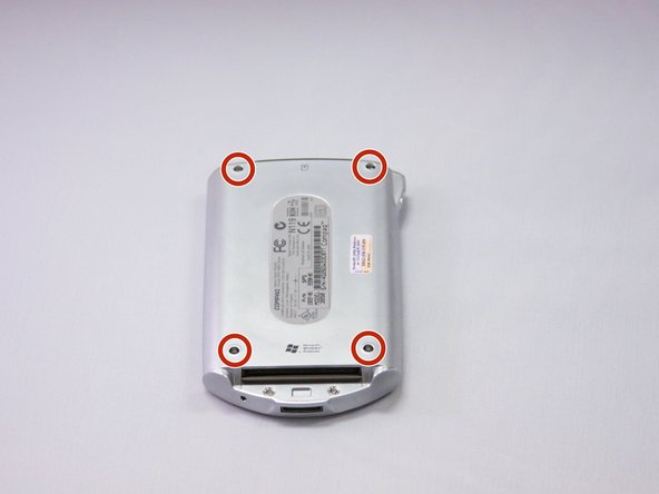

    • Place the device on a flat surface with the screen facing down.
    • Use a screwdriver to remove four screws from the back cover of the device.
