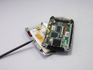

Insert the end of a spudger between the front and back cover and slide it around the edge to release the clips holding them together.
Pry them two halves but don't pull them apart as it is still connected by a cable.
