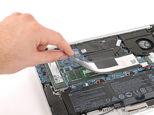

    • Use tweezers or your fingers to peel up the bottom edge of the SSD cover.
    • If the cover is difficult to peel up, use an iOpener or hair dryer to lightly heat it. Be careful not to overheat the tape or the surrounding components.
    • Fold the SSD cover over, onto the memory module cover.

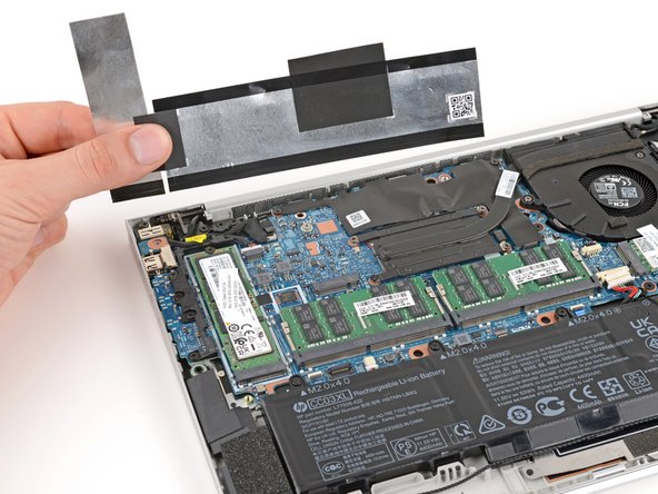

    • Depending on your laptop configuration, your device may have a metal shield or no cover at all.
    • Grip the SSD and memory module covers together and peel them off.
    • If the cover is difficult to remove, use an iOpener or hair dryer to lightly heat it. Be careful not to overheat the tape or the surrounding components.

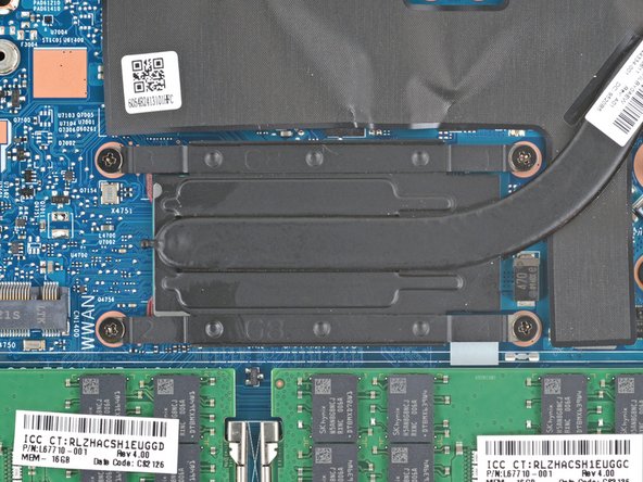

    • Use a Phillips screwdriver to fully loosen (not remove) the four captive screws securing the heat sink. Loosen the screws in descending order based on the numbers stamped next to each screw.
    • During reassembly, tighten the heat sink screws a few turns at a time in ascending order based on the numbers stamped next to each screw., until snug. This will usually be in an "X" pattern.

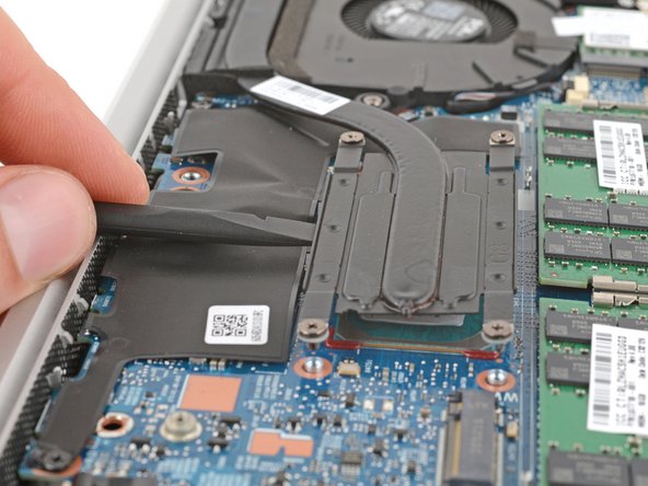

    • Be very careful not to pry on or damage any of the delicate surface‑mounted components around the heat sink.
    • Use the flat end of a spudger to pry up the top edge of the heat sink.
    • Thermal paste bonds the heat sink to the CPU. Depending on the age of your device and condition of the thermal paste, this may take some force. Pull up with constant, steady force to peel the heat sink away from the board.

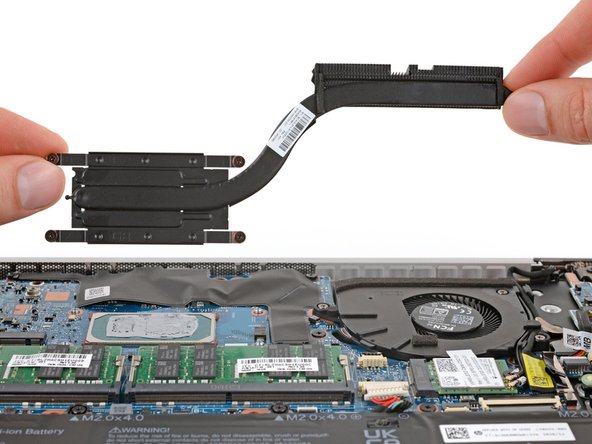

    • Lift and remove the heat sink.
    • During reassembly:

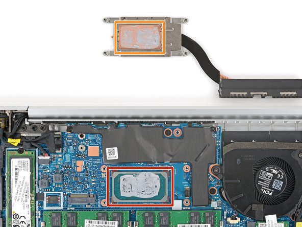

    • Check if your replacement heat sink comes with thermal paste pre‑installed on the bottom. If it does, do not apply new thermal paste.
    • Follow this guide to clean the CPU and apply new thermal paste.
    • If you're reusing the heat sink, make sure to clean it as well.
