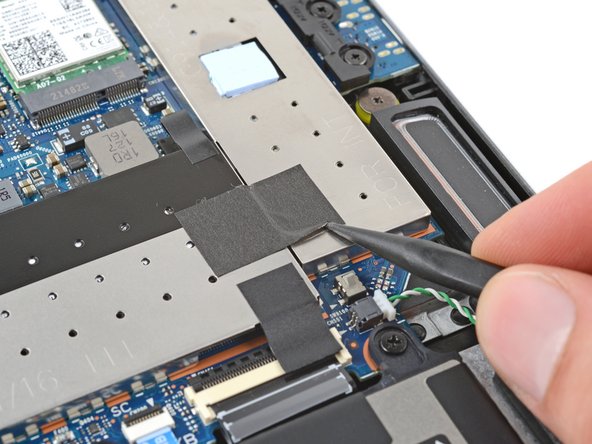

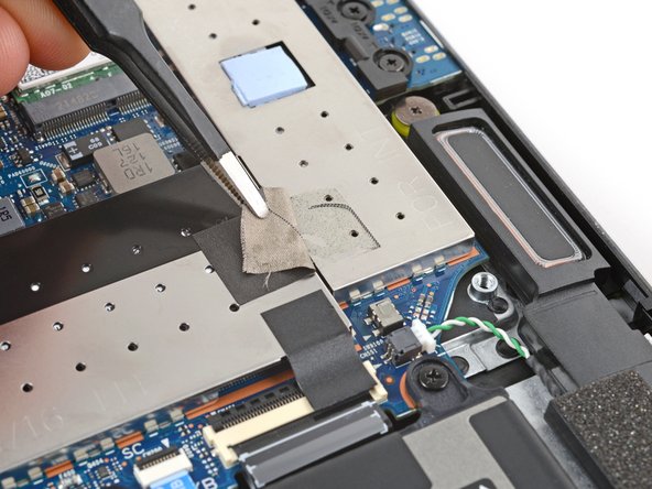

  8. HP EliteBook 840 G9 SSD Replacement, HP EliteBook 840 G9 SSD Shield Tape Peel: crwdns2935265:08crwdnd2935265:01crwdnd2935265:03crwdne2935265:0 HP EliteBook 840 G9 SSD Replacement, HP EliteBook 840 G9 SSD Shield Tape Peel: crwdns2935265:08crwdnd2935265:02crwdnd2935265:03crwdne2935265:0 HP EliteBook 840 G9 SSD Replacement, HP EliteBook 840 G9 SSD Shield Tape Peel: crwdns2935265:08crwdnd2935265:03crwdnd2935265:03crwdne2935265:0
    • If the tape is difficult to remove, use an iOpener or hair dryer to lightly heat it. Be careful not to overheat the tape or the surrounding components.
    • Use the point of a spudger to peel up the tape enough that you can grip it with a pair of tweezers or your fingers.
    • Peel the tape off of the shield.
    • You don't need to fully remove the tape—it can stay attached to one of the metal shields.

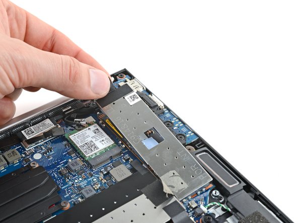

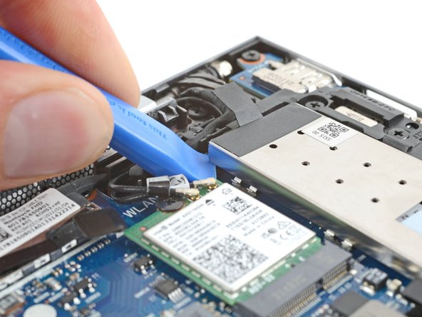

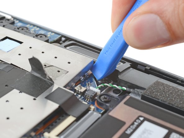

  9. HP EliteBook 840 G9 SSD Replacement, Pry up the SSD shield: crwdns2935265:09crwdnd2935265:01crwdnd2935265:03crwdne2935265:0 HP EliteBook 840 G9 SSD Replacement, Pry up the SSD shield: crwdns2935265:09crwdnd2935265:02crwdnd2935265:03crwdne2935265:0 HP EliteBook 840 G9 SSD Replacement, Pry up the SSD shield: crwdns2935265:09crwdnd2935265:03crwdnd2935265:03crwdne2935265:0
    • Depending on your laptop configuration, your device may have a plastic cover or no cover at all.
    • Use an opening tool to pry up the edges of the SSD's metal shield.
    • Be very careful not to pry on or damage any of the small, surface‑mounted components surrounding the SSD shield.

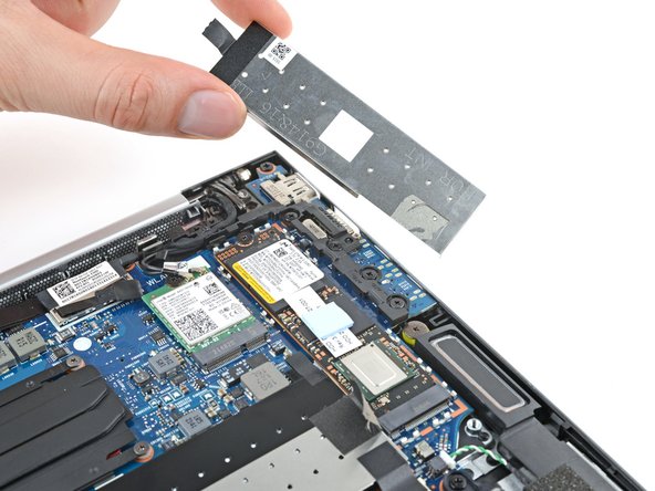

  10. HP EliteBook 840 G9 SSD Replacement, Remove the SSD shield: crwdns2935265:010crwdnd2935265:01crwdnd2935265:03crwdne2935265:0 HP EliteBook 840 G9 SSD Replacement, Remove the SSD shield: crwdns2935265:010crwdnd2935265:02crwdnd2935265:03crwdne2935265:0 HP EliteBook 840 G9 SSD Replacement, Remove the SSD shield: crwdns2935265:010crwdnd2935265:03crwdnd2935265:03crwdne2935265:0
    • Use the pull tab on the top edge to lift and remove the shield.
    • During reassembly, align the shield with its metal clips on the board—to prevent damage, make sure the shield is sitting properly in the middle of each clip. Once the shield is properly aligned, firmly press down around the perimeter of the shield to secure it.

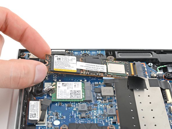

  11. HP EliteBook 840 G9 SSD Replacement, Remove the SSD screw: crwdns2935265:011crwdnd2935265:01crwdnd2935265:02crwdne2935265:0 HP EliteBook 840 G9 SSD Replacement, Remove the SSD screw: crwdns2935265:011crwdnd2935265:02crwdnd2935265:02crwdne2935265:0
    • Use a Phillips screwdriver to remove the 2.5 mm‑long screw securing the SSD.
    • Once removed, the SSD may pop up at a shallow angle.

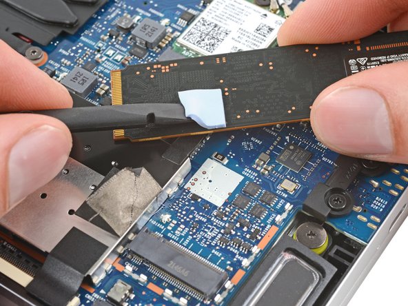

  12. HP EliteBook 840 G9 SSD Replacement, Remove the SSD: crwdns2935265:012crwdnd2935265:01crwdnd2935265:03crwdne2935265:0 HP EliteBook 840 G9 SSD Replacement, Remove the SSD: crwdns2935265:012crwdnd2935265:02crwdnd2935265:03crwdne2935265:0 HP EliteBook 840 G9 SSD Replacement, Remove the SSD: crwdns2935265:012crwdnd2935265:03crwdnd2935265:03crwdne2935265:0
    • Don't pull up at a sharp angle, or you may damage the SSD and its socket.
    • Grip the SSD by its edges and pull it straight out of its socket to remove it.
    • During reassembly, check if your replacement SSD has thermal pads installed. If it doesn't, remove and transfer the pads from the original SSD to your new one.
    • If the pad tears, and you need to replace it with the original size, use a 10 x 10 x 2 mm pad.
    • Depending on the replacement drive, you might not need any thermal pads.
