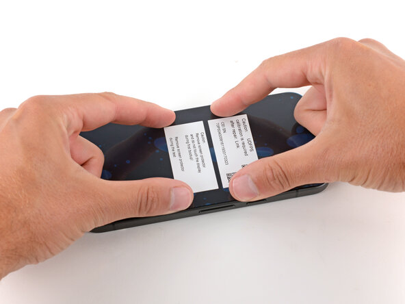

    1. Google Pixel 9a Screen Replacement, Safety precautions: crwdns2935265:02crwdnd2935265:01crwdnd2935265:02crwdne2935265:0 Google Pixel 9a Screen Replacement, Safety precautions: crwdns2935265:02crwdnd2935265:02crwdnd2935265:02crwdne2935265:0
      • Glass shards can complicate disassembly—or worse, cause injury. If your phone has a cracked screen, follow these steps:
      • Apply overlapping strips of packing tape to the cracked glass until the whole screen is covered—this will allow the suction cup to stick to the screen.
      • Only cover the glass itself—don't stick any tape to the frame.
      • Consider wearing safety glasses to protect your eyes from any glass shaken free during the repair.

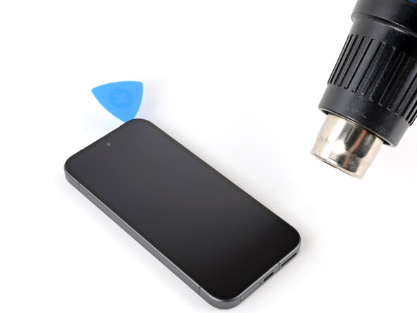

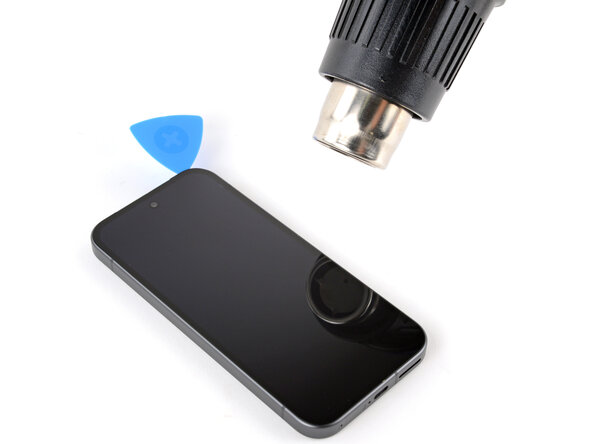

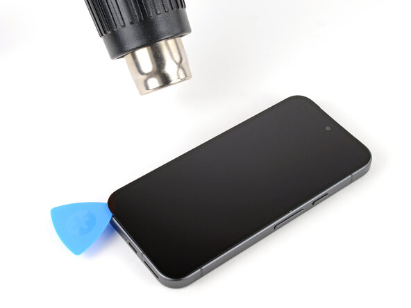

    2. Google Pixel 9a Screen Replacement, Heat the top edge: crwdns2935265:03crwdnd2935265:01crwdnd2935265:01crwdne2935265:0
      • The screen adhesive is very strong, requiring significant heat to soften it. If you have difficulty separating the adhesive, reheat the screen and try again.
      • Use a hair dryer, heat gun, or hot mat to heat the top edge of the screen until it's almost too hot to touch.
      • Be careful not to overheat the phone—the battery and plastic components are susceptible to heat damage. Stop heating if the frame becomes too hot to touch.
      • If you're using a hot mat, set it to 80° C (176° F) and place your phone screen side down for 10 minutes.

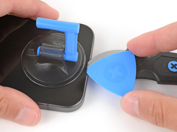

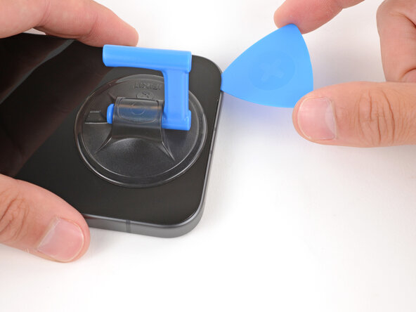

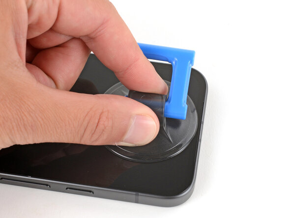

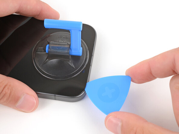

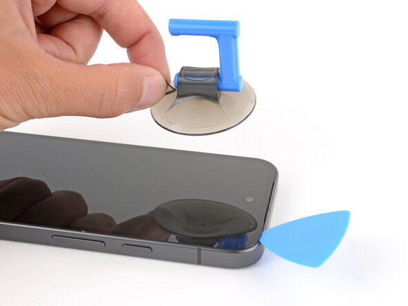

    3. Google Pixel 9a Screen Replacement, Apply a suction handle: crwdns2935265:04crwdnd2935265:01crwdnd2935265:02crwdne2935265:0 Google Pixel 9a Screen Replacement, Apply a suction handle: crwdns2935265:04crwdnd2935265:02crwdnd2935265:02crwdne2935265:0
      • Apply a suction handle to the center of the screen's top edge.

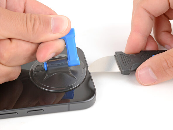

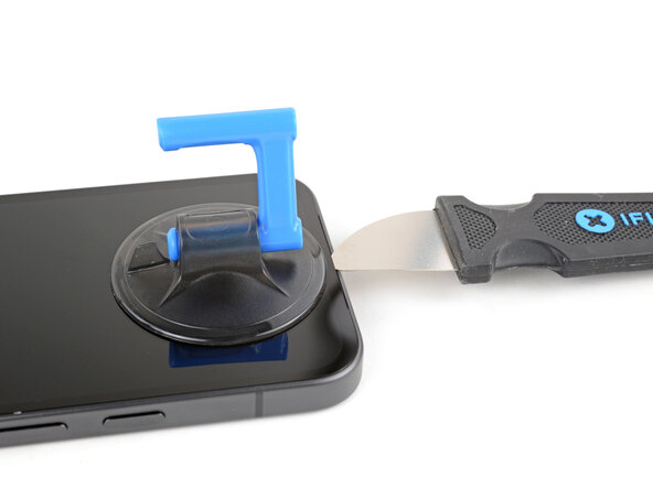

    4. Google Pixel 9a Screen Replacement, Insert your tool under the screen: crwdns2935265:05crwdnd2935265:01crwdnd2935265:03crwdne2935265:0 Google Pixel 9a Screen Replacement, Insert your tool under the screen: crwdns2935265:05crwdnd2935265:02crwdnd2935265:03crwdne2935265:0 Google Pixel 9a Screen Replacement, Insert your tool under the screen: crwdns2935265:05crwdnd2935265:03crwdnd2935265:03crwdne2935265:0
      Jimmy
      $7.95
      • Don't insert any tools deeper than 2 mm, or you may damage the front camera.
      • Insert the tip of a Jimmy downward into the speaker cutout on the top edge of your phone.
      • If you don't have a Jimmy, you can use another small metal tool. Make sure it's thin and rigid.
      • Pull up on the suction handle with strong, steady force while lowering the Jimmy until it slides under the screen.
      • Inserting your tool is very difficult. Reheat the screen at any point and try again if it feels stuck.

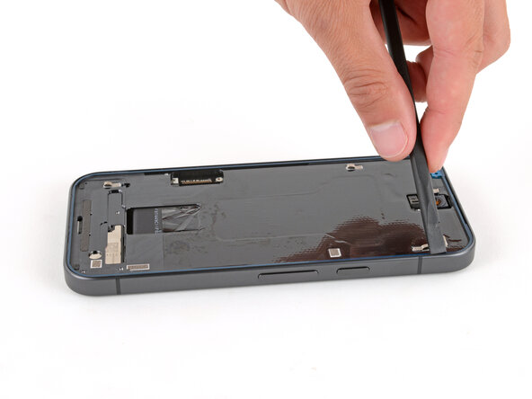

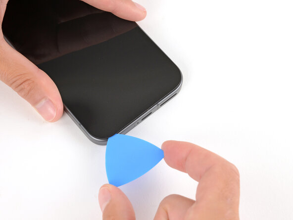

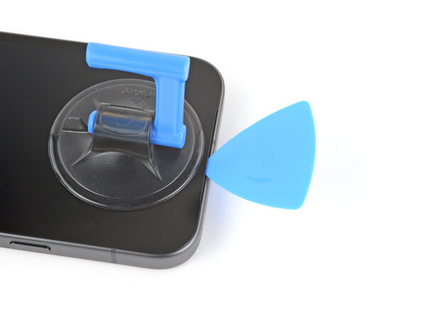

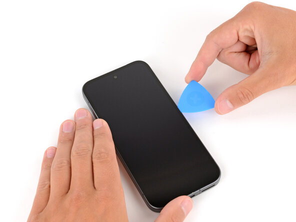

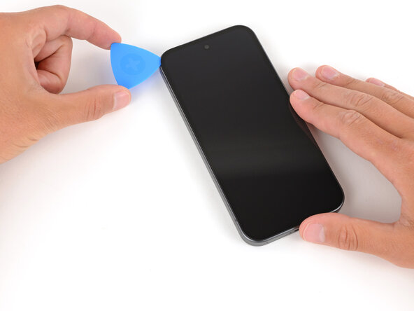

    5. Google Pixel 9a Screen Replacement, Insert an opening pick: crwdns2935265:06crwdnd2935265:01crwdnd2935265:03crwdne2935265:0 Google Pixel 9a Screen Replacement, Insert an opening pick: crwdns2935265:06crwdnd2935265:02crwdnd2935265:03crwdne2935265:0 Google Pixel 9a Screen Replacement, Insert an opening pick: crwdns2935265:06crwdnd2935265:03crwdnd2935265:03crwdne2935265:0
      • Slide the tip of an opening pick under the screen into the gap created by the Jimmy.
      • Remove the Jimmy.
    6. Google Pixel 9a Screen Replacement, Separate the top edge adhesive: crwdns2935265:07crwdnd2935265:01crwdnd2935265:03crwdne2935265:0 Google Pixel 9a Screen Replacement, Separate the top edge adhesive: crwdns2935265:07crwdnd2935265:02crwdnd2935265:03crwdne2935265:0 Google Pixel 9a Screen Replacement, Separate the top edge adhesive: crwdns2935265:07crwdnd2935265:03crwdnd2935265:03crwdne2935265:0
      • Remember: Don't insert your pick deeper than 2 mm, or you may damage the front camera.
      • Slide your opening pick along the top edge of the screen to separate the adhesive securing it.
      • Leave the pick inserted under the top right corner of the screen to prevent the adhesive from re‑sealing.

    8. Google Pixel 9a Screen Replacement, Heat the right edge of the screen: crwdns2935265:09crwdnd2935265:01crwdnd2935265:03crwdne2935265:0 Google Pixel 9a Screen Replacement, Heat the right edge of the screen: crwdns2935265:09crwdnd2935265:02crwdnd2935265:03crwdne2935265:0 Google Pixel 9a Screen Replacement, Heat the right edge of the screen: crwdns2935265:09crwdnd2935265:03crwdnd2935265:03crwdne2935265:0

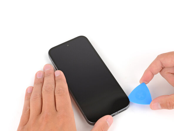

      • Slide your opening pick down the right edge to separate the adhesive securing it.
      • Leave the pick inserted under the bottom right corner of the screen to prevent the adhesive from re‑sealing.

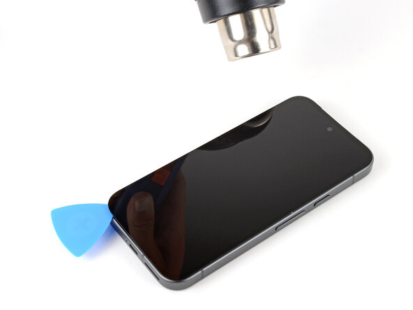

    10. Google Pixel 9a Screen Replacement, Heat the bottom edge: crwdns2935265:011crwdnd2935265:01crwdnd2935265:01crwdne2935265:0

    12. Google Pixel 9a Screen Replacement, Heat the left edge: crwdns2935265:013crwdnd2935265:01crwdnd2935265:03crwdne2935265:0 Google Pixel 9a Screen Replacement, Heat the left edge: crwdns2935265:013crwdnd2935265:02crwdnd2935265:03crwdne2935265:0 Google Pixel 9a Screen Replacement, Heat the left edge: crwdns2935265:013crwdnd2935265:03crwdnd2935265:03crwdne2935265:0

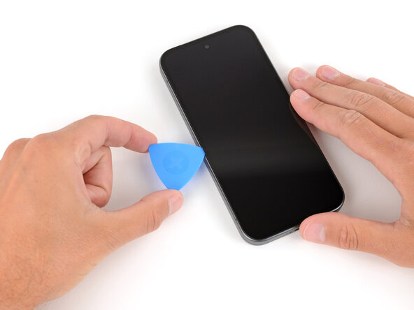

    13. Google Pixel 9a Screen Replacement, Separate the left edge adhesive: crwdns2935265:014crwdnd2935265:01crwdnd2935265:03crwdne2935265:0 Google Pixel 9a Screen Replacement, Separate the left edge adhesive: crwdns2935265:014crwdnd2935265:02crwdnd2935265:03crwdne2935265:0 Google Pixel 9a Screen Replacement, Separate the left edge adhesive: crwdns2935265:014crwdnd2935265:03crwdnd2935265:03crwdne2935265:0
      • Be careful not to insert your pick too far near the center of the left edge, or you may damage the screen cable.
      • Slide your opening pick up the left edge to separate the adhesive securing it.

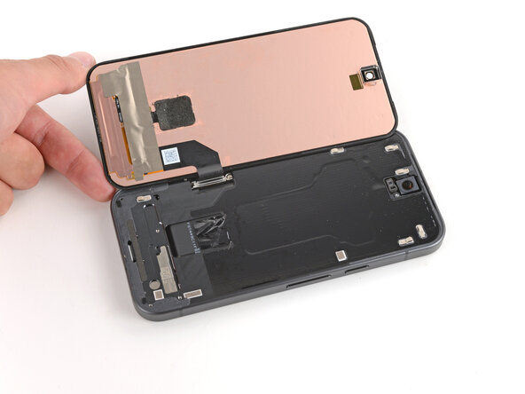

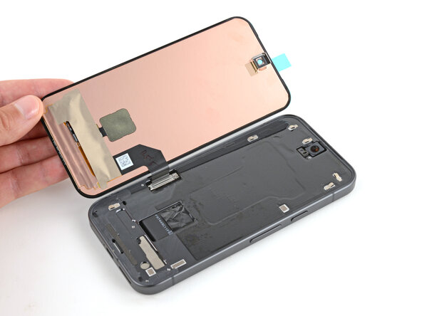

    14. Google Pixel 9a Screen Replacement, Lay the screen flat: crwdns2935265:015crwdnd2935265:01crwdnd2935265:02crwdne2935265:0 Google Pixel 9a Screen Replacement, Lay the screen flat: crwdns2935265:015crwdnd2935265:02crwdnd2935265:02crwdne2935265:0
      • Swing the screen over the left edge of your phone (like opening the cover of a book) and lay it down flat.
      • If you feel resistance when lifting the screen, use an opening pick to separate any leftover adhesive.

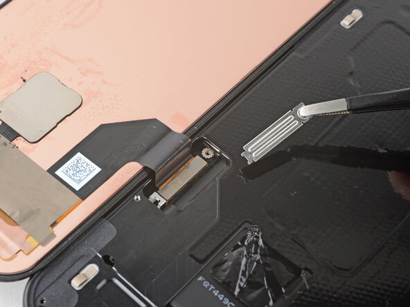

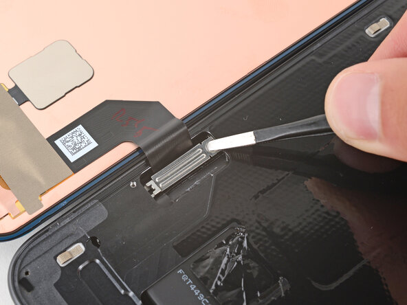

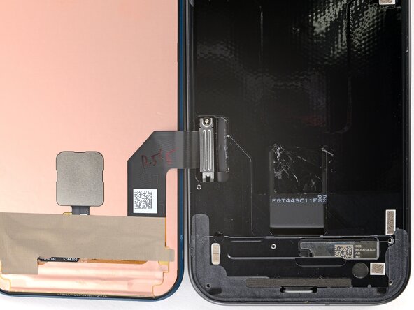

    15. Google Pixel 9a Screen Replacement, Remove the cable cover screw: crwdns2935265:016crwdnd2935265:01crwdnd2935265:02crwdne2935265:0 Google Pixel 9a Screen Replacement, Remove the cable cover screw: crwdns2935265:016crwdnd2935265:02crwdnd2935265:02crwdne2935265:0
      • The battery is exposed through a small cutout near the screen cable. Be very careful not to damage it with your tools.
      • Use a Torx Plus 3IP screwdriver to remove the 1.7 mm‑long screw securing the cable cover.
    16. Google Pixel 9a Screen Replacement, Remove the cable cover: crwdns2935265:017crwdnd2935265:01crwdnd2935265:03crwdne2935265:0 Google Pixel 9a Screen Replacement, Remove the cable cover: crwdns2935265:017crwdnd2935265:02crwdnd2935265:03crwdne2935265:0 Google Pixel 9a Screen Replacement, Remove the cable cover: crwdns2935265:017crwdnd2935265:03crwdnd2935265:03crwdne2935265:0
      • Use tweezers or your fingers to lift and remove the cable cover.
    17. Google Pixel 9a Screen Replacement: crwdns2935265:018crwdnd2935265:01crwdnd2935265:02crwdne2935265:0 Google Pixel 9a Screen Replacement: crwdns2935265:018crwdnd2935265:02crwdnd2935265:02crwdne2935265:0

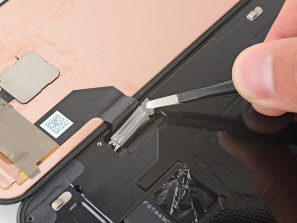

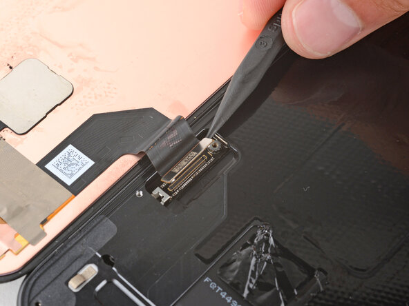

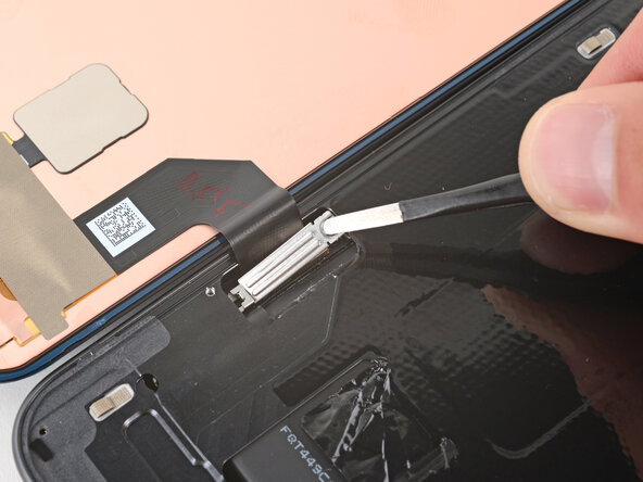

      • Remember: The battery is exposed through a small cutout near the screen cable. Be very careful not to damage it with your tool.
      • Use the point of a spudger to pry up and disconnect the screen press connector from its top left corner.
    18. Google Pixel 9a Screen Replacement, Remove the screen: crwdns2935265:019crwdnd2935265:01crwdnd2935265:01crwdne2935265:0
      • Remove the screen.

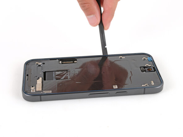

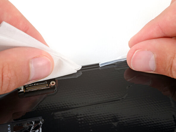

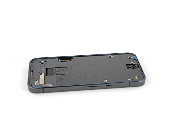

    20. Google Pixel 9a Screen Replacement, Clean the frame: crwdns2935265:021crwdnd2935265:01crwdnd2935265:02crwdne2935265:0 Google Pixel 9a Screen Replacement, Clean the frame: crwdns2935265:021crwdnd2935265:02crwdnd2935265:02crwdne2935265:0
      • Take your time during this step. A clean frame allows replacement adhesive to lay totally flat, ensuring a better bond.
      • Use a spudger and tweezers to scrape up and remove any screen adhesive from the perimeter of the frame.
      • Most of the adhesive should have stayed on the screen during removal, so there may not be any adhesive to remove.
      • Using some high‑concentration (>90%) isopropyl alcohol and a lint‑free cloth (or coffee filter), clean the areas of the frame where the adhesive was.
      • Be careful not to damage the silver foam pads around the perimeter of the phone.
      • Wait for any alcohol to dry completely before continuing.

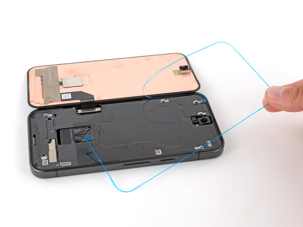

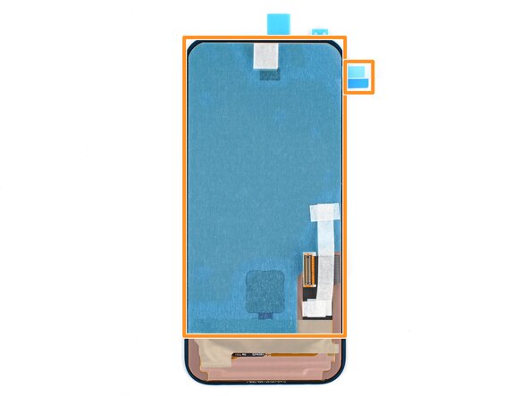

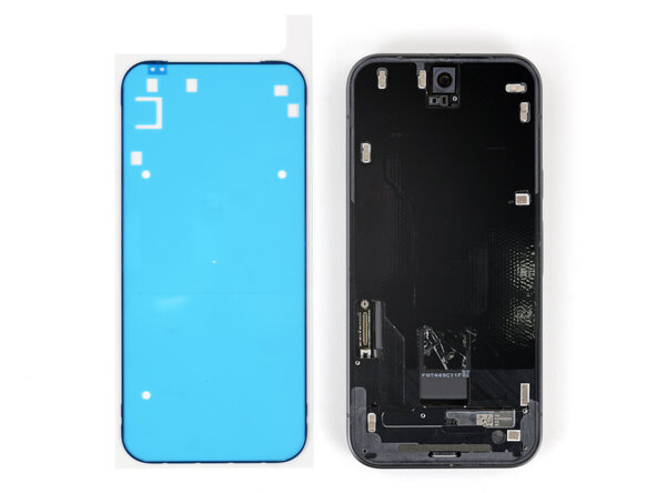

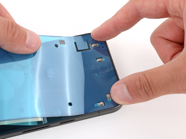

    21. Google Pixel 9a Screen Replacement, Find the adhesive orientation: crwdns2935265:022crwdnd2935265:01crwdnd2935265:02crwdne2935265:0 Google Pixel 9a Screen Replacement, Find the adhesive orientation: crwdns2935265:022crwdnd2935265:02crwdnd2935265:02crwdne2935265:0
      • Check if your replacement screen comes with adhesive pre‑installed around its perimeter. If it does, skip down six steps. If it doesn't, follow the next six steps to install new screen adhesive on the frame.
      • Before applying the screen adhesive, make sure you know how it will sit on the frame. If you apply the adhesive incorrectly, you'll need to restart with new adhesive.
      • Hold the adhesive above the frame to find its orientation. Use cutouts in the liner to help visualize how it will lay in the frame.

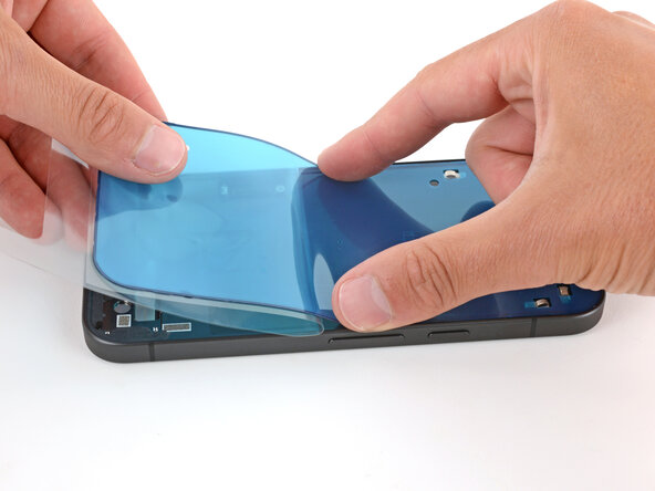

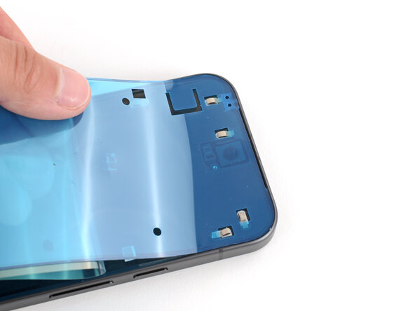

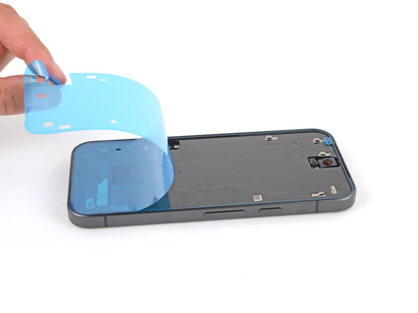

    22. Google Pixel 9a Screen Replacement, Peel the liner halfway down: crwdns2935265:023crwdnd2935265:01crwdnd2935265:01crwdne2935265:0
      • Peel down the top half of the large, clear liner to expose the adhesive—don't fully remove the liner yet.
    23. Google Pixel 9a Screen Replacement, Apply the adhesive: crwdns2935265:024crwdnd2935265:01crwdnd2935265:03crwdne2935265:0 Google Pixel 9a Screen Replacement, Apply the adhesive: crwdns2935265:024crwdnd2935265:02crwdnd2935265:03crwdne2935265:0 Google Pixel 9a Screen Replacement, Apply the adhesive: crwdns2935265:024crwdnd2935265:03crwdnd2935265:03crwdne2935265:0
      • Take your time aligning the adhesive with the frame—it's very sticky and can't be moved after you apply it.
      • With the larger, clear liner folded towards the bottom of the phone, lay the exposed top edge of the adhesive onto the frame.
      • Use the lip of the frame to help align the adhesive.
      • Once the top edge is properly aligned, gently press down on the top corners with your fingers to secure the adhesive.
    24. Google Pixel 9a Screen Replacement: crwdns2935265:025crwdnd2935265:01crwdnd2935265:03crwdne2935265:0 Google Pixel 9a Screen Replacement: crwdns2935265:025crwdnd2935265:02crwdnd2935265:03crwdne2935265:0 Google Pixel 9a Screen Replacement: crwdns2935265:025crwdnd2935265:03crwdnd2935265:03crwdne2935265:0
      • Slowly lay the rest of the adhesive onto the frame, pressing it into place and peeling away the larger liner as you go.
    25. Google Pixel 9a Screen Replacement, Remove the top liner: crwdns2935265:026crwdnd2935265:01crwdnd2935265:03crwdne2935265:0 Google Pixel 9a Screen Replacement, Remove the top liner: crwdns2935265:026crwdnd2935265:02crwdnd2935265:03crwdne2935265:0 Google Pixel 9a Screen Replacement, Remove the top liner: crwdns2935265:026crwdnd2935265:03crwdnd2935265:03crwdne2935265:0
      • Use the pull tab to remove the large, colored liner.
    26. Google Pixel 9a Screen Replacement, Secure the adhesive: crwdns2935265:027crwdnd2935265:01crwdnd2935265:03crwdne2935265:0 Google Pixel 9a Screen Replacement, Secure the adhesive: crwdns2935265:027crwdnd2935265:02crwdnd2935265:03crwdne2935265:0 Google Pixel 9a Screen Replacement, Secure the adhesive: crwdns2935265:027crwdnd2935265:03crwdnd2935265:03crwdne2935265:0
      • Use a spudger to press down firmly on the screen adhesive around the perimeter of your phone to secure it to the frame.

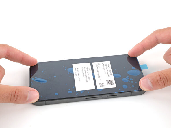

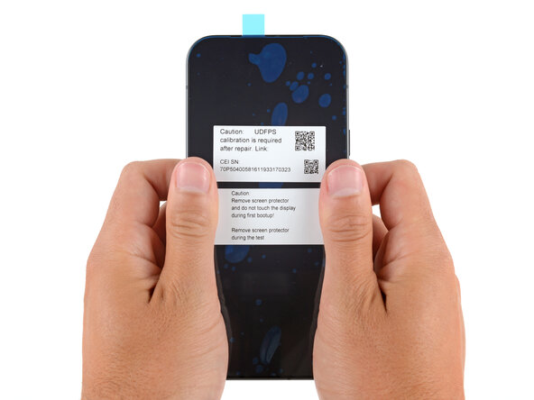

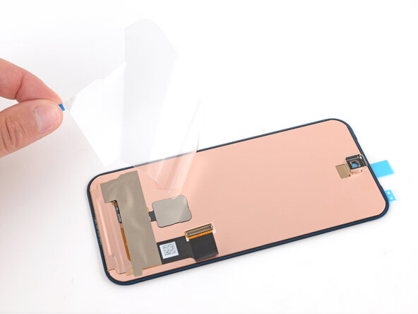

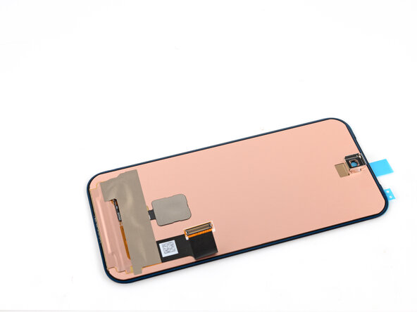

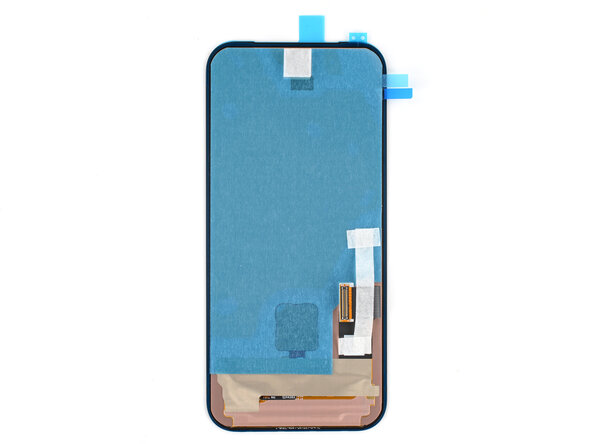

    27. Google Pixel 9a Screen Replacement, Remove the screen liners: crwdns2935265:028crwdnd2935265:01crwdnd2935265:03crwdne2935265:0 Google Pixel 9a Screen Replacement, Remove the screen liners: crwdns2935265:028crwdnd2935265:02crwdnd2935265:03crwdne2935265:0 Google Pixel 9a Screen Replacement, Remove the screen liners: crwdns2935265:028crwdnd2935265:03crwdnd2935265:03crwdne2935265:0
      • Your replacement screen has various protective liners and pieces of tape on the underside that must be removed before installing the screen. Your screen may have different pieces in different locations, so make sure to check carefully!
      • Tape may be covering the front camera and holding the screen cable in place.
      • There may be multiple protective liners covering the bottom of the screen.
      • Do not remove any of the liners from the screen adhesive around the perimeter yet.

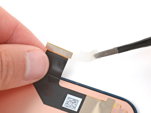

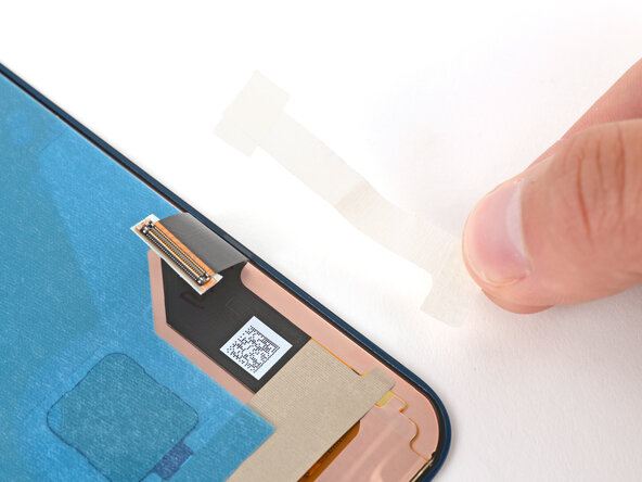

    28. Google Pixel 9a Screen Replacement: crwdns2935265:029crwdnd2935265:01crwdnd2935265:03crwdne2935265:0 Google Pixel 9a Screen Replacement: crwdns2935265:029crwdnd2935265:02crwdnd2935265:03crwdne2935265:0 Google Pixel 9a Screen Replacement: crwdns2935265:029crwdnd2935265:03crwdnd2935265:03crwdne2935265:0
      • Use your fingers to carefully remove any tape from the front camera cutout and screen cable.
      • If there's tape covering the top of the connector, use tweezers to remove it. Be careful not to pull on or tear the screen cable.
    29. Google Pixel 9a Screen Replacement: crwdns2935265:030crwdnd2935265:01crwdnd2935265:03crwdne2935265:0 Google Pixel 9a Screen Replacement: crwdns2935265:030crwdnd2935265:02crwdnd2935265:03crwdne2935265:0 Google Pixel 9a Screen Replacement: crwdns2935265:030crwdnd2935265:03crwdnd2935265:03crwdne2935265:0
      • Carefully remove any liners covering the bottom of the screen.
      • The exposed copper underside of your Pixel's screen is very fragile. Even a small scratch or dent can damage the screen underneath. Be very careful not to touch it with your tools during the remainder of your repair.

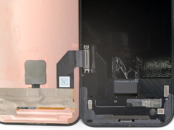

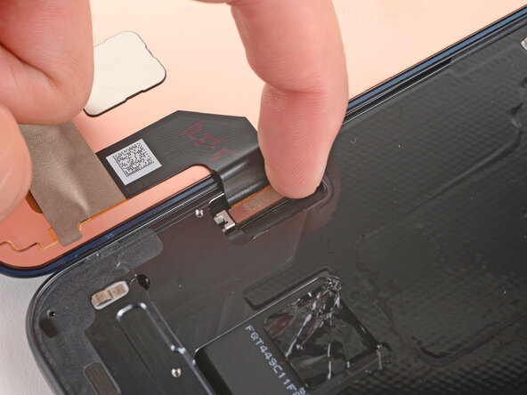

    31. Google Pixel 9a Screen Replacement, Reconnect the screen: crwdns2935265:032crwdnd2935265:01crwdnd2935265:02crwdne2935265:0 Google Pixel 9a Screen Replacement, Reconnect the screen: crwdns2935265:032crwdnd2935265:02crwdnd2935265:02crwdne2935265:0
      • Align the screen press connector over its socket and gently press down with your finger—first on one of the short sides, then on the other—until the connector clicks into place.
    32. Google Pixel 9a Screen Replacement, Install the cable cover: crwdns2935265:033crwdnd2935265:01crwdnd2935265:03crwdne2935265:0 Google Pixel 9a Screen Replacement, Install the cable cover: crwdns2935265:033crwdnd2935265:02crwdnd2935265:03crwdne2935265:0 Google Pixel 9a Screen Replacement, Install the cable cover: crwdns2935265:033crwdnd2935265:03crwdnd2935265:03crwdne2935265:0
      • Hook the bottom edge of the screen cable cover into its cutout and lay the cover into place.
    33. Google Pixel 9a Screen Replacement: crwdns2935265:034crwdnd2935265:01crwdnd2935265:02crwdne2935265:0 Google Pixel 9a Screen Replacement: crwdns2935265:034crwdnd2935265:02crwdnd2935265:02crwdne2935265:0
      • Remember: The battery is exposed through a small cutout near the screen cable. Be very careful not to damage it with your tools.
      • Use a Torx Plus 3IP screwdriver to install the 1.7 mm‑long screw securing the cover.

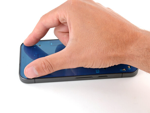

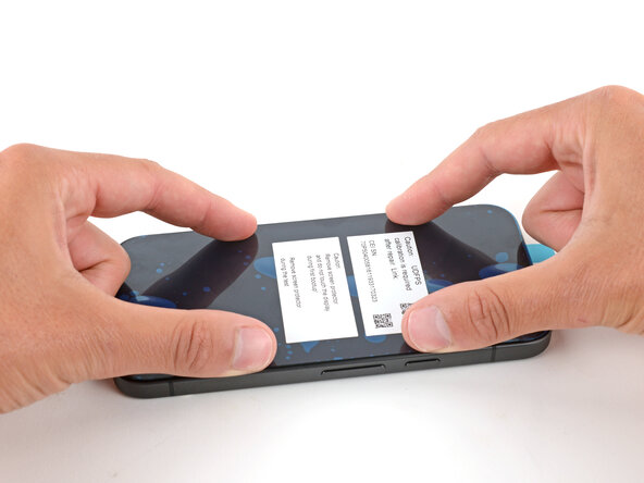

    36. Google Pixel 9a Screen Replacement: crwdns2935265:037crwdnd2935265:01crwdnd2935265:03crwdne2935265:0 Google Pixel 9a Screen Replacement: crwdns2935265:037crwdnd2935265:02crwdnd2935265:03crwdne2935265:0 Google Pixel 9a Screen Replacement: crwdns2935265:037crwdnd2935265:03crwdnd2935265:03crwdne2935265:0
      • Firmly press around the perimeter of the screen to secure the adhesive.
      • You can also hold your phone up and squeeze firmly around the perimeter to strengthen the adhesive bond. For an even more secure bond, lay your phone screen-down on a clean and flat surface underneath a few books overnight.

      • Lay the phone screen-side up on a clean, flat surface. Remove the plastic liner from the screen, making sure nothing touches the phone while you do so (fingers, screen protectors, or cases).
      • To calibrate the display’s fingerprint reader, use Google’s Pixel Update and Software Repair tool.
Congratulations on completing your repair!
To calibrate your display’s fingerprint reader, use Google’s Pixel Update and Software Repair tool.
To run a diagnostics test with the built-in Pixel Diagnostic tool, click here.
