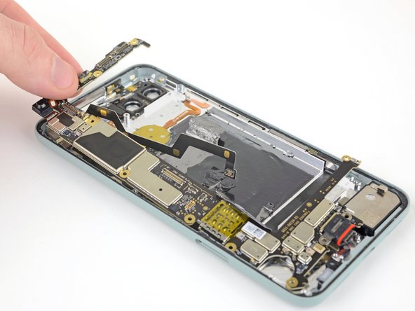

Google Pixel 5 Motherboard Replacement

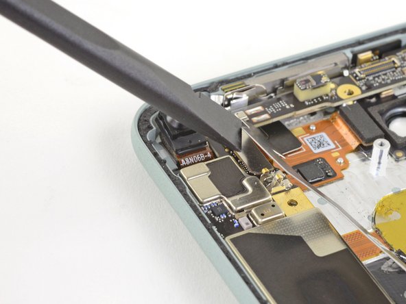

    12. Google Pixel 5 Motherboard Replacement, Disconnect the screen: crwdns2935265:013crwdnd2935265:01crwdnd2935265:02crwdne2935265:0 Google Pixel 5 Motherboard Replacement, Disconnect the screen: crwdns2935265:013crwdnd2935265:02crwdnd2935265:02crwdne2935265:0
      • Use tweezers to grip the screen connector cover securing the screen flex cable.
      • Push the clip in towards the connector to unlatch it.

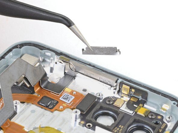

    13. Google Pixel 5 Motherboard Replacement: crwdns2935265:014crwdnd2935265:01crwdnd2935265:02crwdne2935265:0 Google Pixel 5 Motherboard Replacement: crwdns2935265:014crwdnd2935265:02crwdnd2935265:02crwdne2935265:0
      • Remove the screen connector cover.
      • Make sure to keep this component to reinstall it during reassembly.
    14. Google Pixel 5 Motherboard Replacement: crwdns2935265:015crwdnd2935265:01crwdnd2935265:02crwdne2935265:0 Google Pixel 5 Motherboard Replacement: crwdns2935265:015crwdnd2935265:02crwdnd2935265:02crwdne2935265:0
      • Use the tip of the spudger to pry up and disconnect the screen flex cable.
      • To re-attach press connectors like this one, carefully align and press down on one side until it clicks into place, then repeat on the other side. Do not press down on the middle. If the connector is misaligned, the pins can bend, causing permanent damage

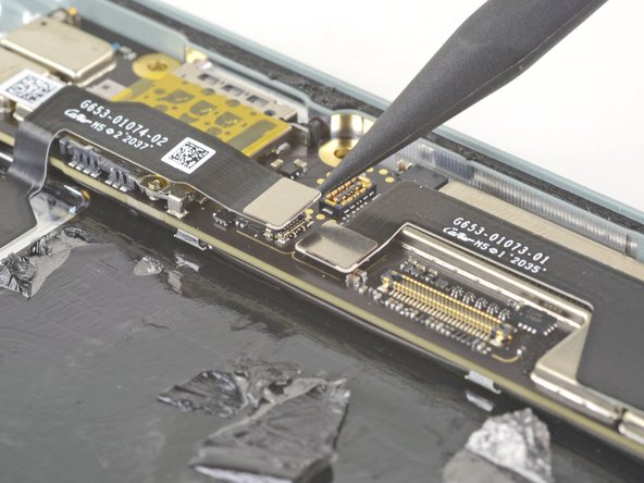

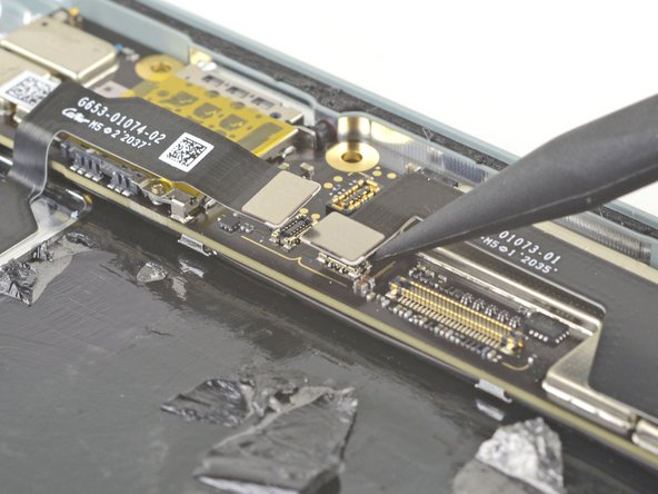

    7. Google Pixel 5 Motherboard Replacement, Disconnect the battery: crwdns2935265:024crwdnd2935265:01crwdnd2935265:02crwdne2935265:0 Google Pixel 5 Motherboard Replacement, Disconnect the battery: crwdns2935265:024crwdnd2935265:02crwdnd2935265:02crwdne2935265:0
      • Use the pointed end of the spudger to pry the battery connector straight up and disconnect it from the motherboard.

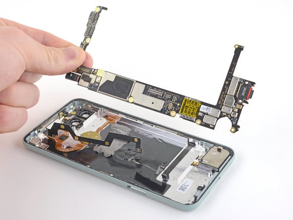

    1. Google Pixel 5 Motherboard Replacement, Remove the shouldered screw: crwdns2935265:025crwdnd2935265:01crwdnd2935265:01crwdne2935265:0
      • Use a T3 Torx driver to remove the 4.1 mm shouldered screw.

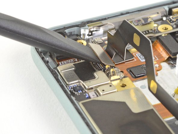

    2. Google Pixel 5 Motherboard Replacement, Disconnect the rear cameras: crwdns2935265:026crwdnd2935265:01crwdnd2935265:03crwdne2935265:0 Google Pixel 5 Motherboard Replacement, Disconnect the rear cameras: crwdns2935265:026crwdnd2935265:02crwdnd2935265:03crwdne2935265:0 Google Pixel 5 Motherboard Replacement, Disconnect the rear cameras: crwdns2935265:026crwdnd2935265:03crwdnd2935265:03crwdne2935265:0
      • Use the spudger to disconnect the two rear camera press connectors from the motherboard.
      • Use your finger to hold down the rear camera assembly and prevent bending the motherboard.

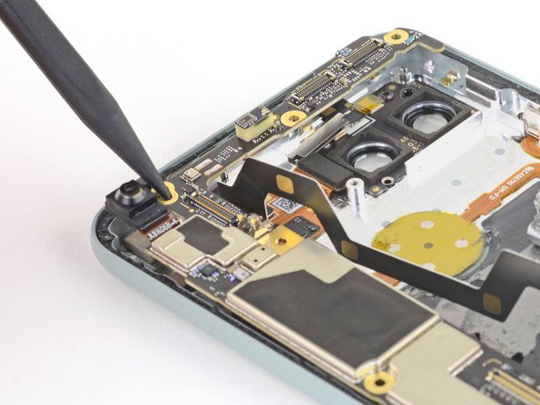

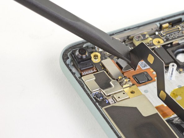

    3. Google Pixel 5 Motherboard Replacement, Remove the rear cameras: crwdns2935265:027crwdnd2935265:01crwdnd2935265:03crwdne2935265:0 Google Pixel 5 Motherboard Replacement, Remove the rear cameras: crwdns2935265:027crwdnd2935265:02crwdnd2935265:03crwdne2935265:0 Google Pixel 5 Motherboard Replacement, Remove the rear cameras: crwdns2935265:027crwdnd2935265:03crwdnd2935265:03crwdne2935265:0
      • Use tweezers to lift up on the rear camera assembly to remove it from its housing.
      • If your replacement camera module has a plastic spacer, be sure to remove it before you install the module.
      • Make sure the lens surface is smudge and dust free before you install the camera assembly.

    1. Google Pixel 5 Motherboard Replacement, Disconnect the press connectors: crwdns2935265:034crwdnd2935265:01crwdnd2935265:03crwdne2935265:0 Google Pixel 5 Motherboard Replacement, Disconnect the press connectors: crwdns2935265:034crwdnd2935265:02crwdnd2935265:03crwdne2935265:0 Google Pixel 5 Motherboard Replacement, Disconnect the press connectors: crwdns2935265:034crwdnd2935265:03crwdnd2935265:03crwdne2935265:0
      • Use the pointed end of a spudger to disconnect the two press connectors by lifting them straight up from the motherboard.

    3. Google Pixel 5 Motherboard Replacement, Bend the flex cable out of the way: crwdns2935265:036crwdnd2935265:01crwdnd2935265:03crwdne2935265:0 Google Pixel 5 Motherboard Replacement, Bend the flex cable out of the way: crwdns2935265:036crwdnd2935265:02crwdnd2935265:03crwdne2935265:0 Google Pixel 5 Motherboard Replacement, Bend the flex cable out of the way: crwdns2935265:036crwdnd2935265:03crwdnd2935265:03crwdne2935265:0
      • Use a spudger to gently fold the flex cable covering the rear case press connector out of the way.
    4. Google Pixel 5 Motherboard Replacement, Disconnect the press connector: crwdns2935265:037crwdnd2935265:01crwdnd2935265:02crwdne2935265:0 Google Pixel 5 Motherboard Replacement, Disconnect the press connector: crwdns2935265:037crwdnd2935265:02crwdnd2935265:02crwdne2935265:0
      • Use the spudger to disconnect the rear case press connector.
    5. Google Pixel 5 Motherboard Replacement, Remove the motherboard: crwdns2935265:038crwdnd2935265:01crwdnd2935265:02crwdne2935265:0 Google Pixel 5 Motherboard Replacement, Remove the motherboard: crwdns2935265:038crwdnd2935265:02crwdnd2935265:02crwdne2935265:0
      • Insert the pointed end of the spudger into the screw holes near the front facing camera.
      • Push the motherboard down towards the bottom of the phone, then lift up to free the top of the motherboard from the rear case.
    6. Google Pixel 5 Motherboard Replacement: crwdns2935265:039crwdnd2935265:01crwdnd2935265:03crwdne2935265:0 Google Pixel 5 Motherboard Replacement: crwdns2935265:039crwdnd2935265:02crwdnd2935265:03crwdne2935265:0 Google Pixel 5 Motherboard Replacement: crwdns2935265:039crwdnd2935265:03crwdnd2935265:03crwdne2935265:0
      • Use your fingers to pull the motherboard up towards the top of the rear case to free the charging port.
      • Do not bend or twist the motherboard.
      • If the motherboard gets caught on the case, use a spudger to go around the edges and loosen it up.
      • Remove the motherboard.
    7. Google Pixel 5 Motherboard Replacement: crwdns2935265:040crwdnd2935265:01crwdnd2935265:02crwdne2935265:0 Google Pixel 5 Motherboard Replacement: crwdns2935265:040crwdnd2935265:02crwdnd2935265:02crwdne2935265:0
      • After removing the motherboard, the top spacer will usually fall out. To replace it, reposition the midframe without screwing it down. Grasp the spacer with the tweezers and compress the interior foam to squeeze it into position. Then screw the midframe into place.
      • Grip the spacer by the body and not by the delicate end tabs.
