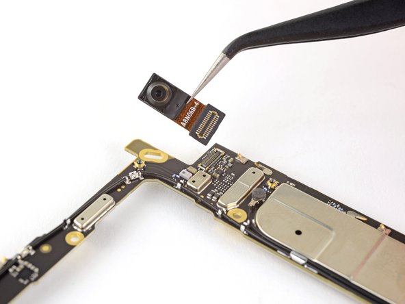

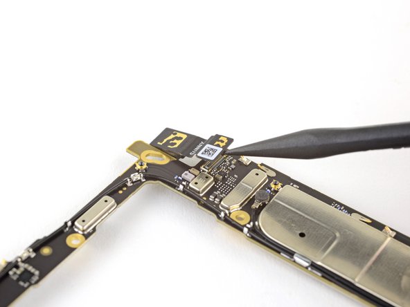

    2. Google Pixel 5 Front Camera Replacement, Disconnect the rear cameras: crwdns2935265:026crwdnd2935265:01crwdnd2935265:03crwdne2935265:0 Google Pixel 5 Front Camera Replacement, Disconnect the rear cameras: crwdns2935265:026crwdnd2935265:02crwdnd2935265:03crwdne2935265:0 Google Pixel 5 Front Camera Replacement, Disconnect the rear cameras: crwdns2935265:026crwdnd2935265:03crwdnd2935265:03crwdne2935265:0
      • Use the spudger to disconnect the two rear camera press connectors from the motherboard.
      • Use your finger to hold down the rear camera assembly and prevent bending the motherboard.
    3. Google Pixel 5 Front Camera Replacement, Remove the rear cameras: crwdns2935265:027crwdnd2935265:01crwdnd2935265:03crwdne2935265:0 Google Pixel 5 Front Camera Replacement, Remove the rear cameras: crwdns2935265:027crwdnd2935265:02crwdnd2935265:03crwdne2935265:0 Google Pixel 5 Front Camera Replacement, Remove the rear cameras: crwdns2935265:027crwdnd2935265:03crwdnd2935265:03crwdne2935265:0
      • Use tweezers to lift up on the rear camera assembly to remove it from its housing.
      • If your replacement camera module has a plastic spacer, be sure to remove it before you install the module.
      • Make sure the lens surface is smudge and dust free before you install the camera assembly.

    1. Google Pixel 5 Front Camera Replacement, Remove the front camera: crwdns2935265:041crwdnd2935265:01crwdnd2935265:03crwdne2935265:0 Google Pixel 5 Front Camera Replacement, Remove the front camera: crwdns2935265:041crwdnd2935265:02crwdnd2935265:03crwdne2935265:0 Google Pixel 5 Front Camera Replacement, Remove the front camera: crwdns2935265:041crwdnd2935265:03crwdnd2935265:03crwdne2935265:0
      • Use the pointed end of the spudger to lift up and disconnect the front camera from the motherboard.
      • Remove the camera.
