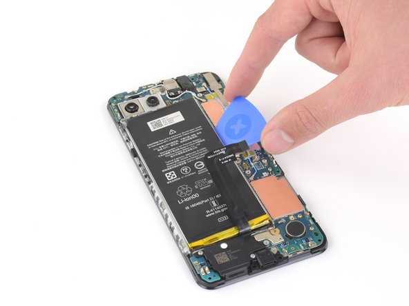

  18. Google Pixel 4a 5G Battery Replacement, Separate the back cover from the midframe: crwdns2935265:018crwdnd2935265:01crwdnd2935265:03crwdne2935265:0 Google Pixel 4a 5G Battery Replacement, Separate the back cover from the midframe: crwdns2935265:018crwdnd2935265:02crwdnd2935265:03crwdne2935265:0 Google Pixel 4a 5G Battery Replacement, Separate the back cover from the midframe: crwdns2935265:018crwdnd2935265:03crwdnd2935265:03crwdne2935265:0
    • Insert an opening pick into the seam between the midframe and the back cover, right above the SIM card slot.
    • Slide the opening pick along the right edge of your phone to release the plastic clips securing the back cover to the midframe.
  19. Google Pixel 4a 5G Battery Replacement: crwdns2935265:019crwdnd2935265:01crwdnd2935265:03crwdne2935265:0 Google Pixel 4a 5G Battery Replacement: crwdns2935265:019crwdnd2935265:02crwdnd2935265:03crwdne2935265:0 Google Pixel 4a 5G Battery Replacement: crwdns2935265:019crwdnd2935265:03crwdnd2935265:03crwdne2935265:0

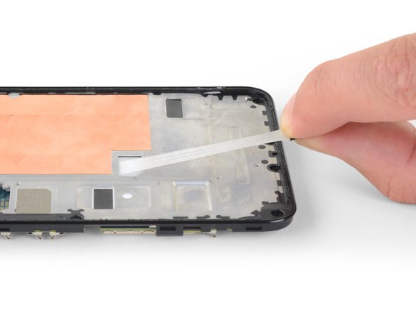

  30. Google Pixel 4a 5G Battery Replacement, Remove the stretch-release adhesive: crwdns2935265:030crwdnd2935265:01crwdnd2935265:03crwdne2935265:0 Google Pixel 4a 5G Battery Replacement, Remove the stretch-release adhesive: crwdns2935265:030crwdnd2935265:02crwdnd2935265:03crwdne2935265:0 Google Pixel 4a 5G Battery Replacement, Remove the stretch-release adhesive: crwdns2935265:030crwdnd2935265:03crwdnd2935265:03crwdne2935265:0
    • Use the flat end of a spudger to lift up the battery adhesive pull tab so that you can reach it with your fingers.
    • Try to keep the adhesive strips flat and unwrinkled during this procedure; twisted or wrinkled strips will stick together and break instead of pulling out cleanly.

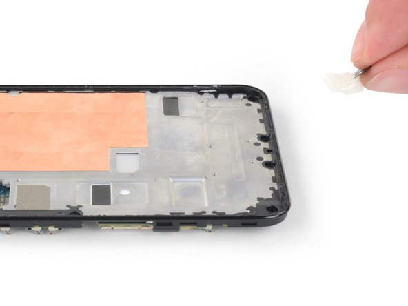

    • Slowly pull one battery adhesive tab away from the battery, towards the bottom of the phone.
    • Pull steadily, maintaining constant tension on the strip until it slips out from between the battery and the midframe. For best results, pull the strip at as low of an angle as possible.
    • The strip will stretch to many times its original length. Continue pulling and re-grab the strip near the battery if necessary.
    • If the battery adhesive tabs break during the removal process, use your fingers or blunt tweezers to retrieve the remaining length of adhesive, and continue pulling.
  31. Google Pixel 4a 5G Battery Replacement: crwdns2935265:031crwdnd2935265:01crwdnd2935265:03crwdne2935265:0 Google Pixel 4a 5G Battery Replacement: crwdns2935265:031crwdnd2935265:02crwdnd2935265:03crwdne2935265:0 Google Pixel 4a 5G Battery Replacement: crwdns2935265:031crwdnd2935265:03crwdnd2935265:03crwdne2935265:0
    • Repeat the instructions in the previous step for the second stretch-release adhesive strip.
    • If any of the adhesive strips broke off underneath the battery and could not be retrieved, apply a few drops of 90% isopropyl alcohol into the opening of the affected tab and tilt the phone towards the top edge so that the alcohol flows toward the remaining adhesive. Wait one minute for the adhesive to soften, then proceed to the next step.
